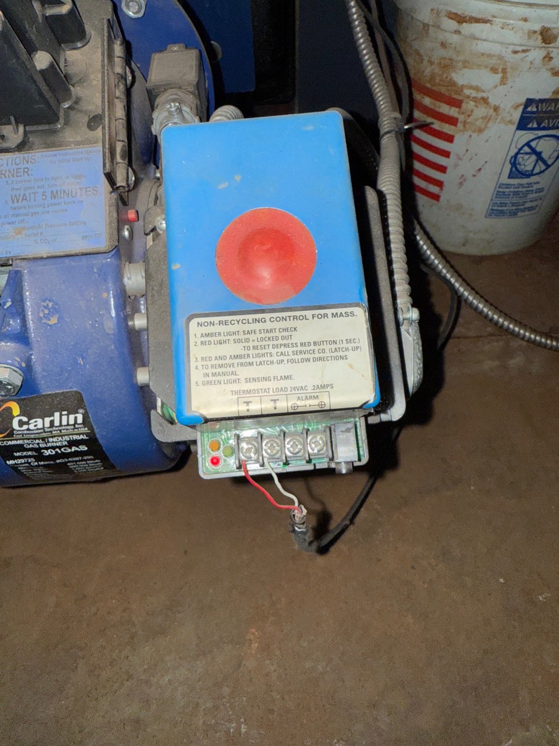

OK, another post about my boiler.
The Carlin gas gun has - within the last 2 weeks - gone into "lock out" mode 3 times. It's easily rectified by pushing the red button, but obviously there's a problem. Before I call a pro, is there anything I should check? Here's a photo, I can provide more if needed.
    HVACNUT Member Posts: 7,424
    Only advice would be for the pro to bring a 60200FR primary to upgrade the existing.
    It has diagnostics.

    Carlin gas burners are the best. If you having problems something else is wrong
    Steamhead Member Posts: 18,467
    That's an older primary and they have been problematic. We routinely upgrade to the newer one that @HVACNUT mentioned and this solves the problem.

    I didn't mean to cause a ruckus. I'm ordering the new control. The problem is so intermittent. I did find the carlin manual and checked the flame rod and igniter - both were misaligned so I aligned them according to the manual and reassembled. The problem came back though, so I think replacing the control is the next step and maybe it can tell me what the problem is at least.
  • GW
    GW Member Posts: 5,184
    it’s not a like for like swap out: you’ll have to read the instructions once or twice

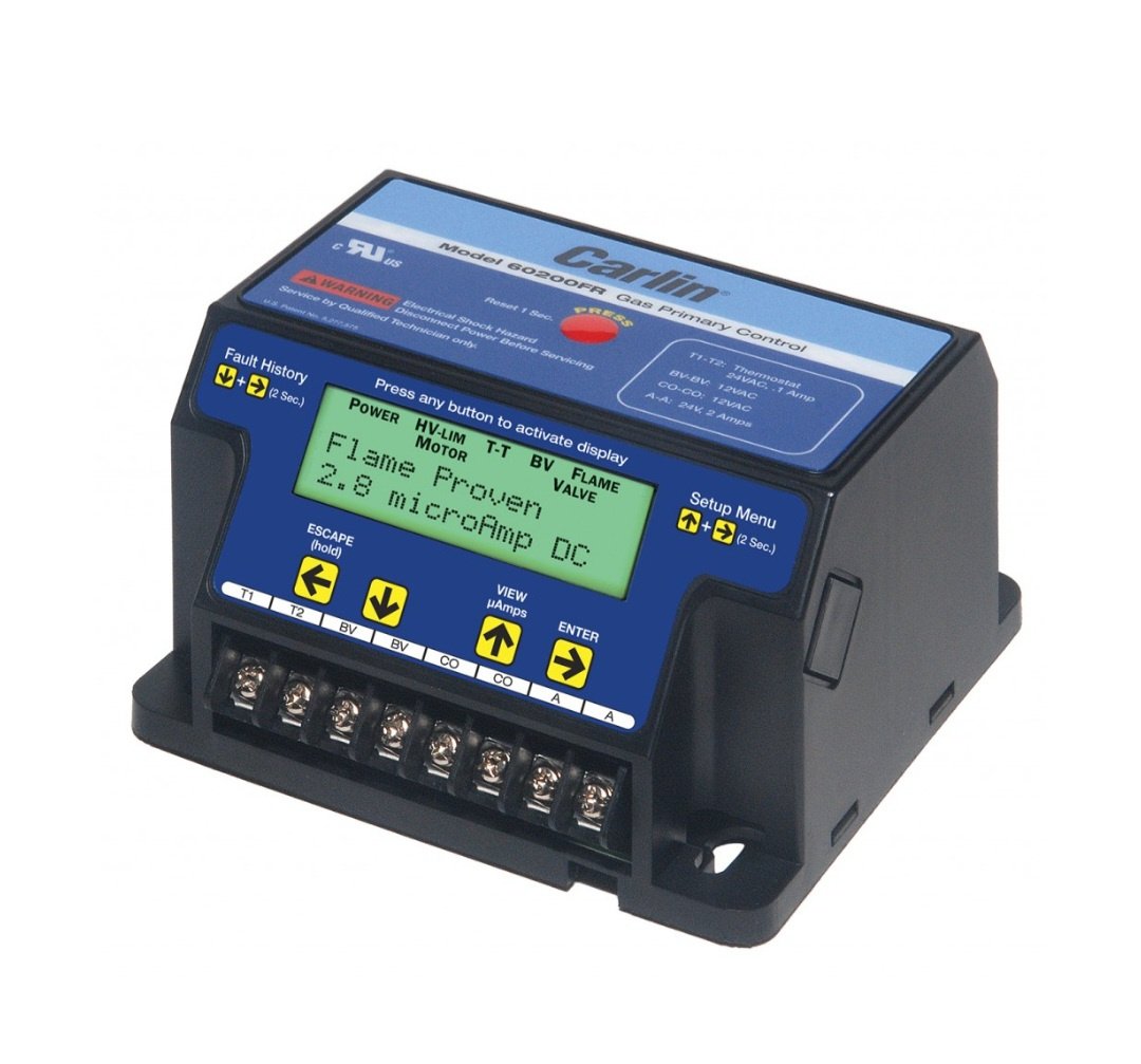

    I bought and installed the new control Carlin 60200FR. Unfortunately this seems worse than the old control.
    It initially worked but then gave a bunch of errors.
    Flame at post purge (twice) with uAmps 1.0 and 0.7
    eventually it got stuck giving a “no flame” error when I turned power off and on again. Pressing reset, then it gave a flame error with uAmps of 0.6. I disconnected the flame rod, still showed uA of 0.6.
    I cleaned and reinstalled the flame rod (taking care to adjust it per the manual). The errors persisted. I checked the connections but nothing changed.
    I reinstalled the old controller, it’s working. I guess I can push reset when I need to.
    Any idea what’s wrong?
    mattmia2 Member Posts: 16,673
    sounds like there's stray current somewhere
  • Dsisson
    Dsisson Member Posts: 116
    where should I look? Does this mean there’s a shorted wire? Bad ground? Another sensor that’s failed?

    I did clean the flame rod. The control is sensing 0.6 uA with the rod attached or detached.
    It’s something else I think

    with the boiler off, no flame at all, it’s sensing flame EVEN WHEN the flame rod is unplugged.
    I think it’s somehow seeing amperage from somewhere else.
    That primary control puts a small AC voltage on the sensing electrode so when the flame is established it can rectify it into DC. I suspect the electrode has failed.
