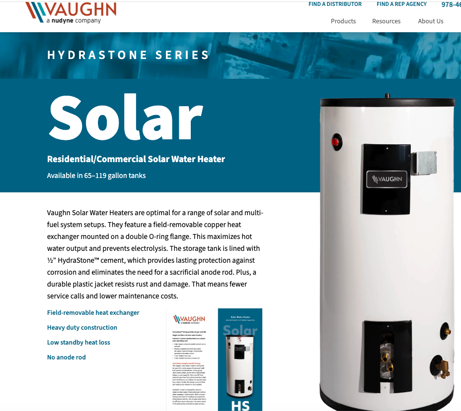

    I'm the #1 fan of ST, my first question is what the failure of the tank is.
    By far the longest lasting solar tanks I have seen are the stone lined, Ford, Vaughn and private labeled to US boiler and others. The stone lining counteracts some of the water conditions that take out other tanks.

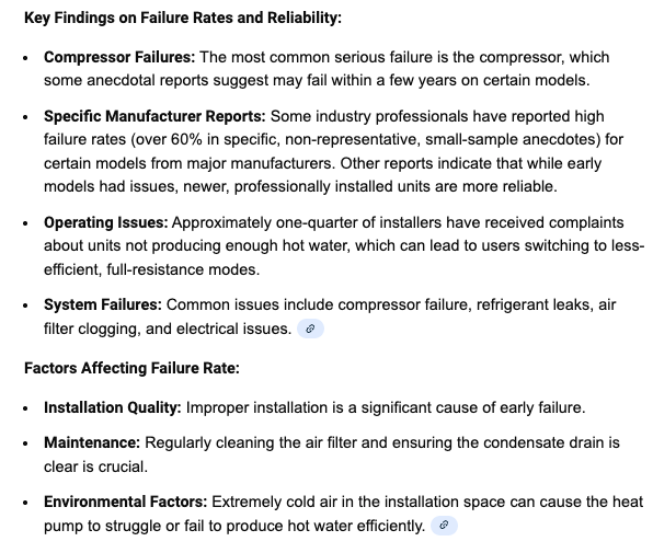

    I suspect the same brand compressor shows up in many different brands, so maybe just a "bad batch" 😲
    I like the concept of properly applied HPWH, I think they are still on an equipment, or quality control learning curve, however.
    AI knows 😀 which runs in line with what the service techs in trainings are experiencing.
