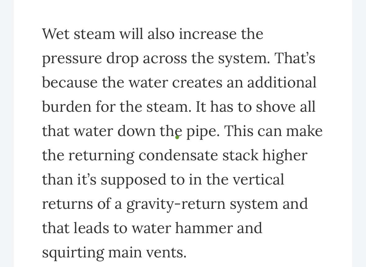

Wet steam increases system pressure drop (water burdens the steam) → longer run times, higher fuel use.
The term used here is "wet steam" but are we really talking about carryover? Tiny droplets of water do not "burden the steam" nor do they stay steamborne very long. They hit the wall of the pipe and join the rest of the condensate that is forming there. But carryover into the main I could see where people would think it "burdens the steam". But I have to ask how could it cause higher fuel use? I return to what I said before, where do the BTUs supposedly go? The burners heat the water, the water makes steam and even if it is carrying over, all that heat is in the steam system, there's no other place for it to go.
Poor piping on replacements leads to callbacks: wet steam causes water hammer, uneven heating, high bills.
Carryover causes water hammer, but little droplets of water don't. Carryover could cause uneven heating by preventing steam from getting to some radiators, but tiny droplets of water don't. I don't know about high bills…I guess if a single radiator near the thermostat were being crippled due to carryover and being full of water, for example, that could potentially cause a little higher heating bills, but I don't think it would be noticeable — far more noticeable would be the water shooting out of the vents or the LWCO continually kicking in.

With wet steam, the wetter the steam is, the higher the return condensate will stack up where it drops from the main to the wet return, due to the higher boiler pressure needed to overcome the additional pressure drop created in the pipe due to the fact that you don't have dry steam.
In my video I linked above to clammy my "A" dimension does go up, but this is only because I have dramatically constricted my steam supply out of the boiler. Both Peerless and Dan state that A dimension rises in normally piped boilers, either due to "pressure drop" or "wet steam" and that is completely mistaken.

I think instead of these misleading terms you might consider saying that sometimes it has carryover and sometimes it doesn't.
Carryover can't prevent the BTUs from getting into your house, but I could see how it might change which radiators get steam which could result in longer running times for you. But the heat is indeed going into your house regardless. Carryover is definitely undesirable as @EdTheHeaterMan mentioned above.
Your recent carryover was no doubt caused by the oils from your new piping. You should consider skimming. If your gauge glass level is dropping while steaming, that is definitely carryover—not "wet steam"
Carryover is relative, just like the term wet steam is relative. There are spectrums from mild to bad in both. They should be taken as synonymous. It's semantics. Mechanical carryover/wet steam is real as is the type caused by bad water quality. I think I have taken this discussion further than I intended to when I initially told you that if you disagreed I'd not waste my time.
Edit to add - You are mistaken that my steam main installation added any oils whatsoever to my boiler. Since I did the work myself I cleaned all the pipes and fittings prior to installation, and everything was fine as far as I could tell for about a month and a half after installation. And don't take this as an insult but I think you should learn the basic science involved in steam heating before you go on to teach people about it.
OK as you wish. We definitely disagree. I'm sorry to see you go, but for others I will summarize my thinking about wet steam:
- "Wet steam" is steam that is simply created by boiling water, without any additional heating. This is the scientific and industrial definition.
- Therefore, every bit of steam ever created by every residential (and many many commercial) boilers is "wet steam"
- "Wet steam" can't be reduced by proper near boiler piping—a few turns of pipe cannot change the water content in the steam—only the introduction of additional heat can change that.
- "Carryover" is different from "wet steam" and is a common problem in residential boilers, caused primarily by oil on the water, or also from other solids or substances in the water. It is large quantities of water getting thrown out of the boiler (similar to what we see in a coffee percolator—or in my videos). It can be indicated on most systems by a dramatic drop in the gauge glass level.
- neither "Wet steam" nor "Carryover" can "kill" or "remove" BTUs from the heating system. Even though carryover is not desirable, it does not cause inefficiency — all the BTUs go into the home regardless.
