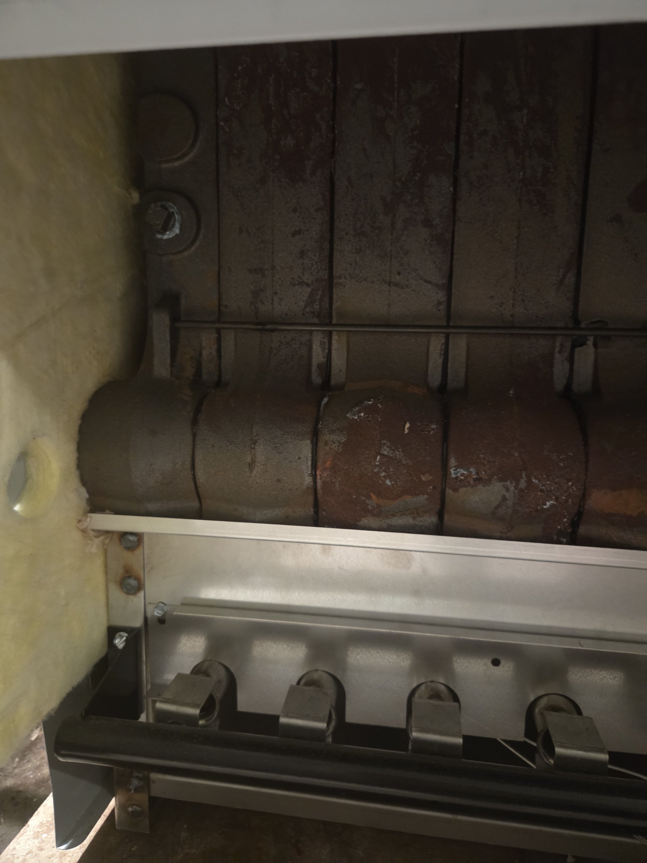

    No, not a failed well. Just adding a new well to add a aquastat for my hot water loop, so I can control the boiler firing better when just that hot water loop is calling for heat.
    Currently, there is an unused 1/2" tap below the LWCO line, which right now is sealed with a black iron plug.

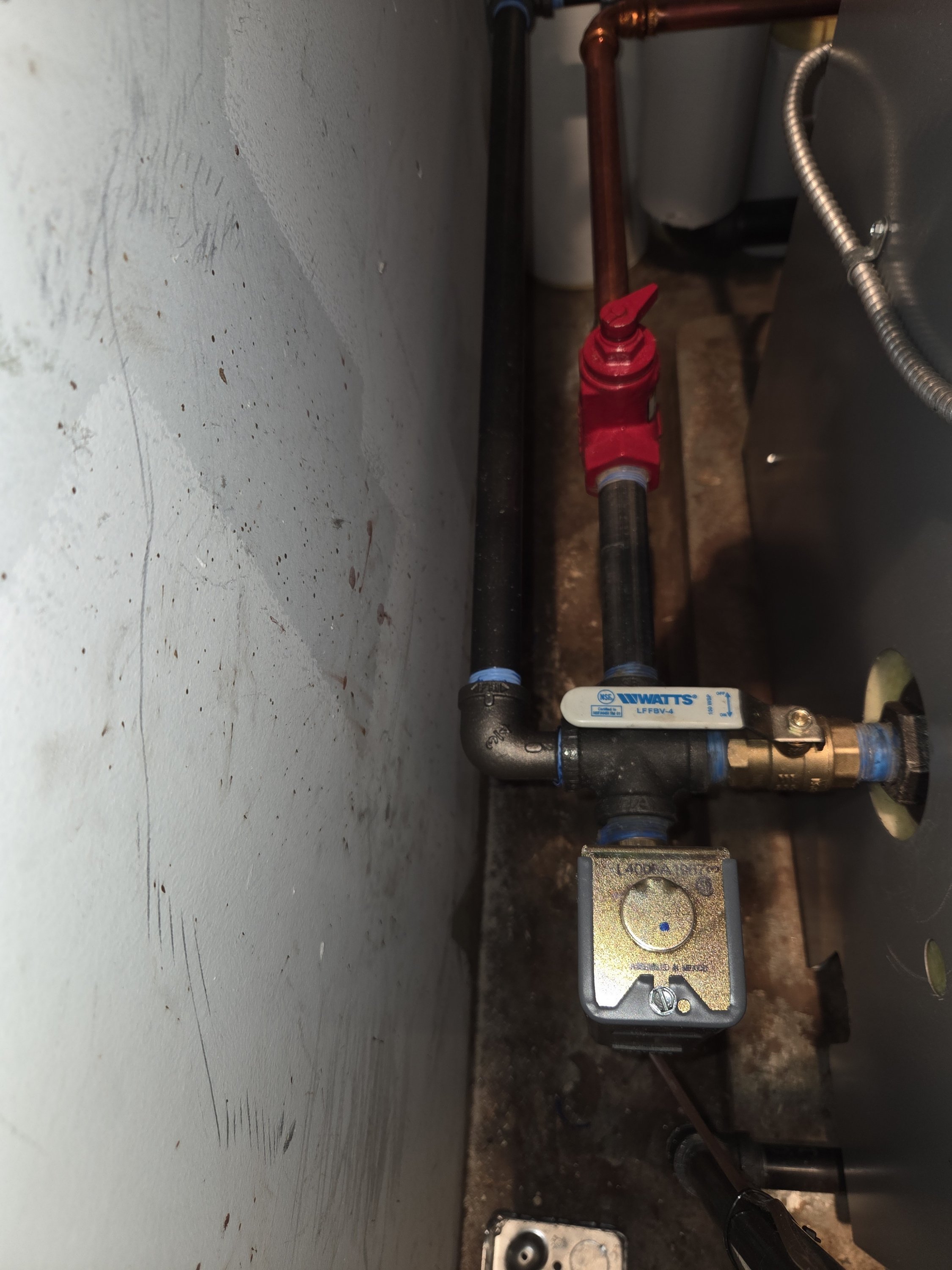

    Therenis an existing aquastat for the hot water loop, but it was installed on the pipe out of the boiler. Which would have been fine, but the plumbers had no idea I needed a bypass loop/mixing vale to keep it from flash boiling. When I called them, they insisted it was plumbed properly. It wasnt. I was getting loud flash steam in the hot water loop when the boiler was calling for steam for my main line.
    So I had to remove that drain, and plumb in that bypass loop myself.
    Now, that exisiting aquastat is right between the water flows, and the water temp at that junction is of course quite variable.
    I ordered a new digital thermometer/aquastat to plug into the boiler and measure the water temp there. unfortunately, I dont have anywhere else to put it without having to break into the copper lines. And I have no interest i doing that right now.

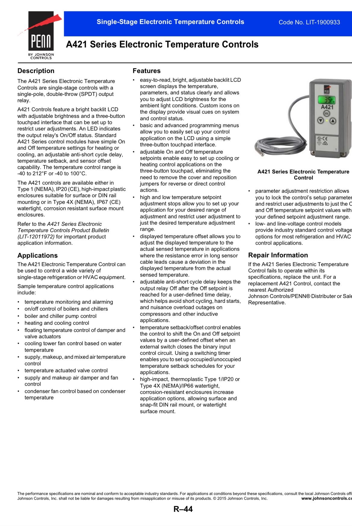

    Last question: How do I wire the White Rogers 16E09-101 to the boiler TT wires?
    I have the old aquastat wired inline with the Boiler TT wires (managed by a Taco panel), so it only fires when the Taco is asking for heat AND the boiler temp is low. (If the boiler temp is OK, the Taco just runs the pump, no call for boiler fire).
    Do I wire the boiler TT as the Load? And use a separate 24V transformer for power (or run additional wires from the boiler 24V transformer)?
