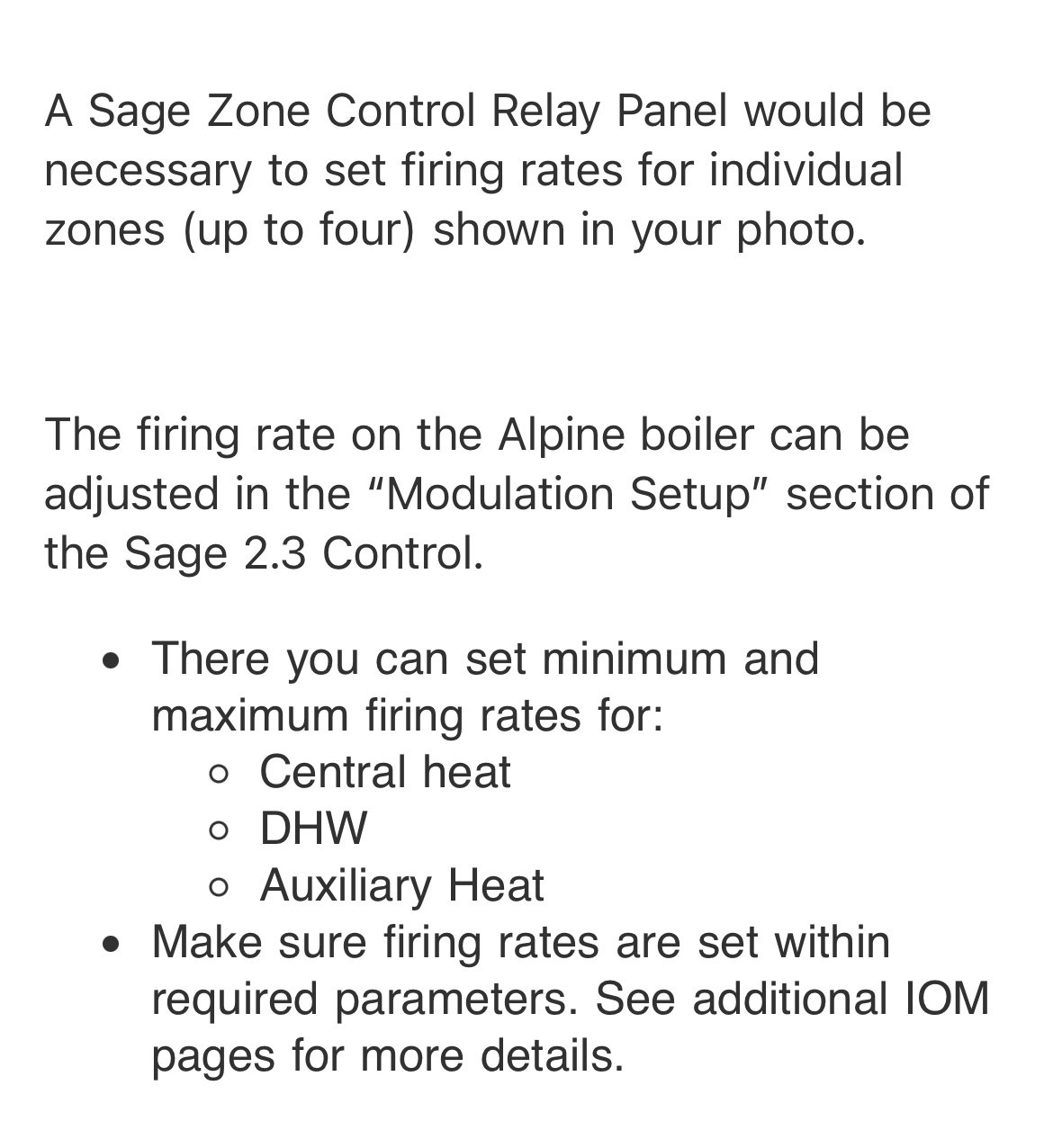

    I’ve already described all of the adjustable parameters in the modulation s/u section. There are 3:
    - min (1250 RPM)
    - max DHW (4000 RPM)
    - max Central Heat (4850 RPM)
    That’s all I can access from the front panel of the Alpine. I’m using the password protected “adjust” access to look through the software settings.

    I would adjust the max rpm down until it reads around 30,000 btu/hr, I don't know what rpm that will be.

    I’m reluctant to start adjusting the RPM down without a clear understanding of how it will impact the boilers operation. If I begin to lower it, what changes should I expect to see? How would I know when I’ve gotten to the optimal setting? How would I know when I’ve gone too low? I feel like I’m flying in the fog with no radar.
    hot_rod Member Posts: 28,076
    You would either want to know the heatload of the building and adjust the boiler output to that.
    Or just try a few different settings.
    An analogy, how far down do you depress you accelerator when driving? The same for the boiler, lowering the RPM, lowers the horsepower.
    You wouldn't floor your accelerator and use the brakes to control your speed??
    So running the boiler to full power for a load that is a fraction of the HP wastes fuel, shortens component life, is annoying to hear it going on and off every 8 minutes, etc.
    There is no exact answer, my suggestion is limit the heating output of the boiler to 50%. Does the home maintain temperature on a cold day r night. If so lower it another 5%
    The manufacturer puts all those settings and parameters in the control so the user or installer can adjust the boiler to the specific job. You paid for them, may as well use them.

    Your controller allows access to this parameter. The Central Heat parameter
    Use the down arrow to crank the rpm/ btu down to 1/2 of what it is now. If it is 4480 rpm, take it down to maybe 2500. It should then show what the boiler BTU output will be at that limited RPM, example below.
    No need to change any DHW settings, you just want to make the boiler smaller to match the low load.
    This should allow the boiler to run longer on cycles. Less on off cycles.
