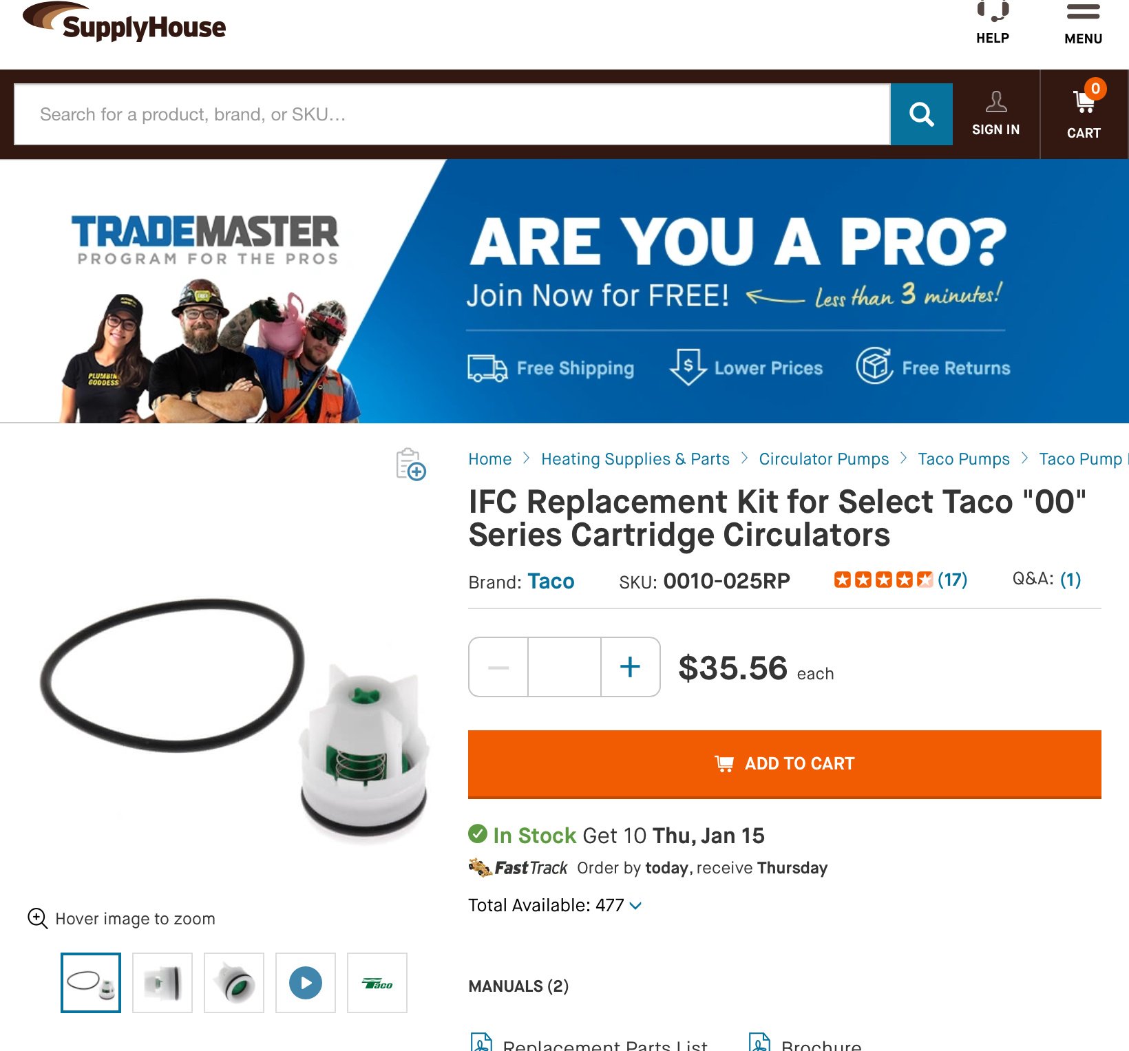

the pump second from left looks like a late model. It might take an internal check, check with Taco. Move it to the problem zone.
That would be a$40.00 fix.

2nd pump from the left is new. I replaced it a month or so ago. I do not believe it has an internal Flocheck but could be wrong.
new pump says 007-F5

I will put in circular pump with a built-in flow heck to see if that does it. That is a simple swap
