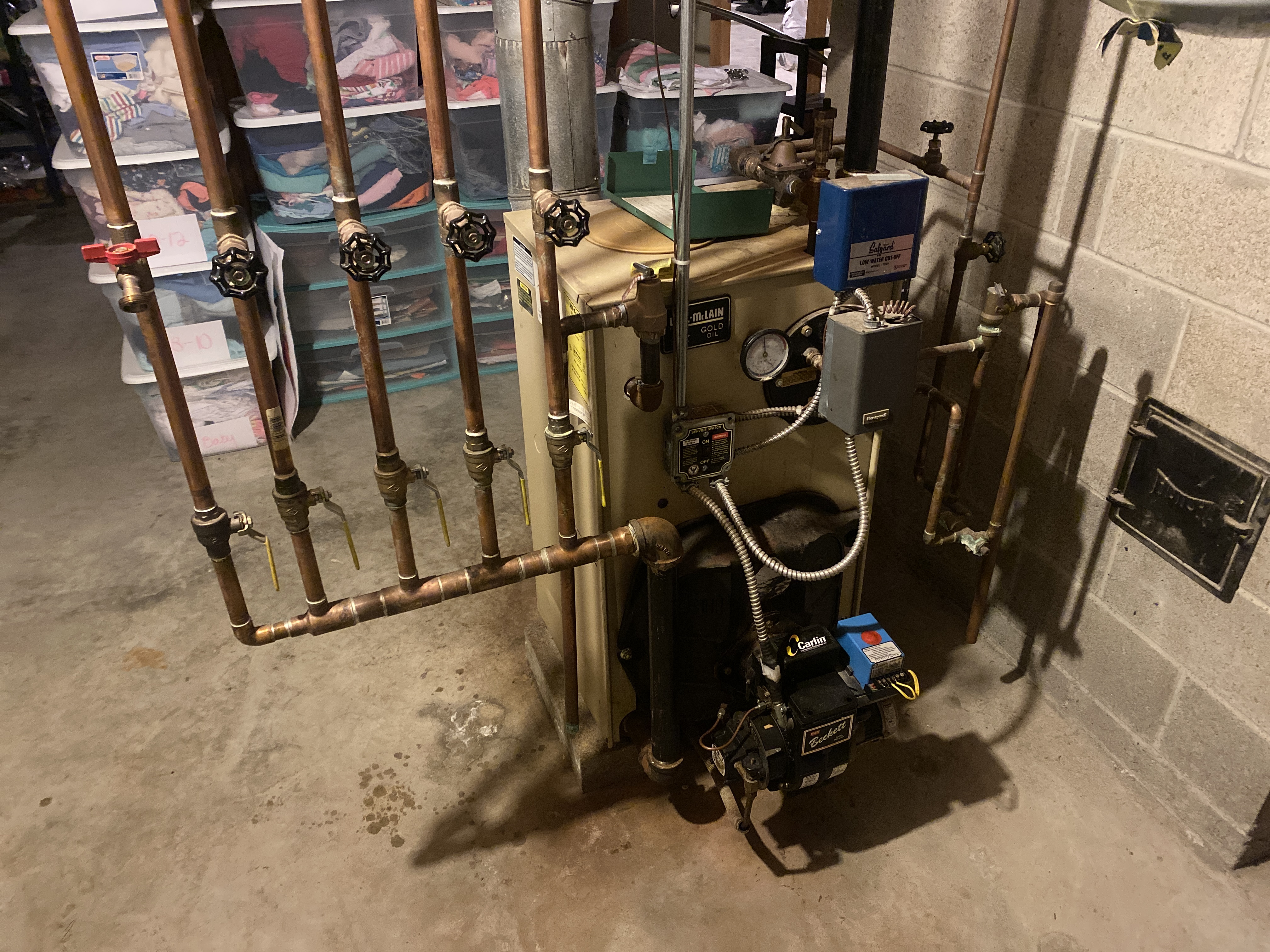

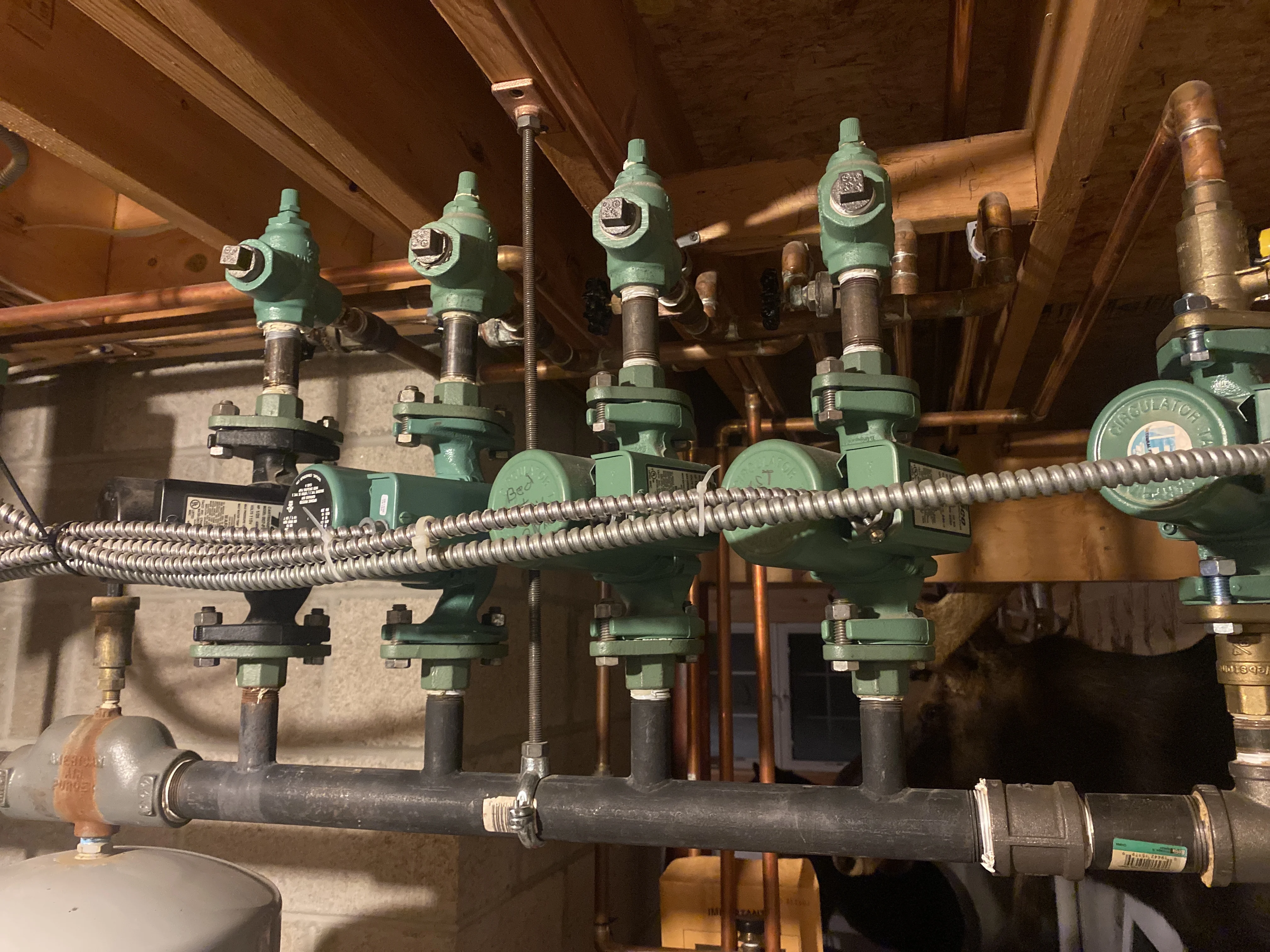

    The flo checks that you removed, when you inspect them, do they appear to be functioning well with a good seal?
  • plumbworker
    plumbworker Posts: 34
    edited January 11
    Isolating which valve stops the gravity flow? the supply, return or both? Believe it or not water can circulate (thermosyphon) through a single pipe without a direct return path. what's going on with the tankless coil that's not being used anymore right? maybe would help to set up the boiler for a cold start?

    the first new flocheck seemed perfect when I removed it. The valve would open if I turned it upside down and close when I returned it to correct position. There is a hot water tank that is still in use on the zone all the way to the right.
    bjohnhy
  • Barley12
    Barley12 Posts: 57

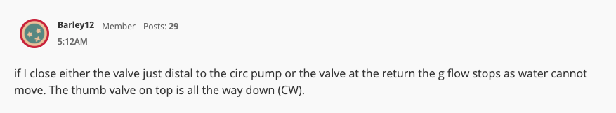

    if I close either the valve just distal to the circ pump or the valve at the return the g flow stops as water cannot move. The thumb valve on top is all the way down (CW).

    hot_rod Posts: 28,705
    That is highly unusual to see a check like that not be able to stop flow in an installation like yours. Be that as it may.
    Screwed down, arrow facing flow direction? There isn't another pump on the system, maybe at the boiler return?
    If closing those iso valves downstream of the flo check stops the ghosts, then… you choice is adding spring checks to the pumps if they can accept them, or remove the flow checks and replace them with hydronic type spring checks.
    Ideally check valves are installed about 10 pipe diameters downstream of the circ.
    Do not use swing checks!

    @plumbworker brings up a good point that a constantly hot boiler is going to exacerbate your ghost flow issues. Do you know what your low limit temperature setting is? High limit? Were these settings changed at the beginning of this heating season? Have this temperature settings been validated on your system with separate gauge?
    Adding an IFC in a circulator may help some but if the ghost flow is overcoming your current Check than you'll probably need something with more resistance to opening than the IFCs
    All circs would need the same check, not just the over-heating zone.
    Boilers with tankless DHW coils are hot all the time and those can and have worked with flow checks, something is not adding up here.
    At some point you get weary of the troubleshooting quest and just change to a different check.
    I believe the checks used in circulators ICF, are .35- .50 psi pop. So they could in fact be less pop psi than what those flo checks are? But there spring assures that they do in fact close.
    I don't see a spec at B&G or Taco for the "pop" of flow check. It would be equal to the weight of the plug if the opening it closes is 1 square inch.

    I would narrow down which valve stops the ghost flow.
    Is the valve downstream of the circulator and flow check?
    Or is it the valve on the return piping?
    Don't turn off both at once to determine the flow path of the ghost.
    That will answer where a new check may be needed.

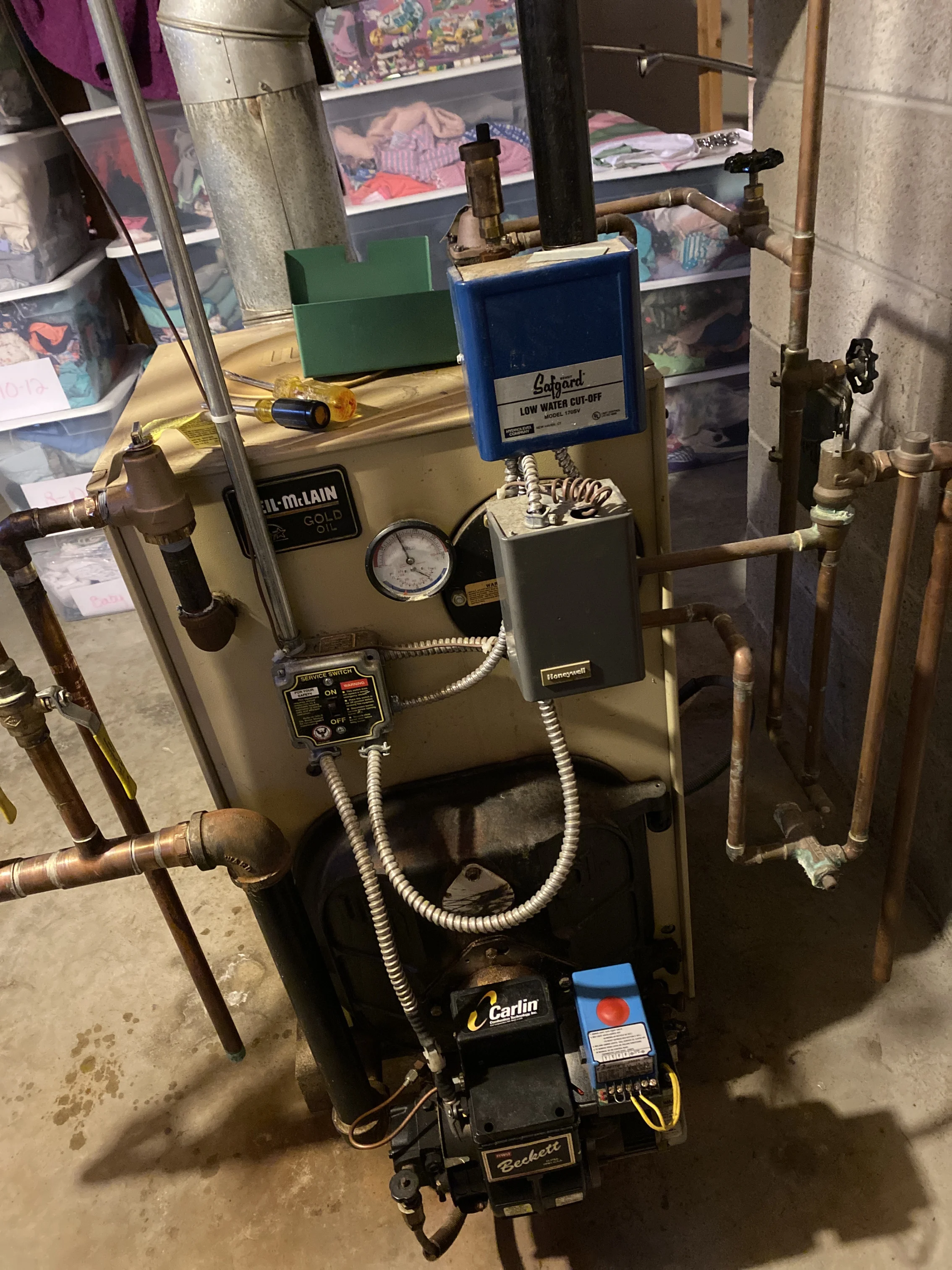

    @plumbworker astutely noticed was your boiler appears to have a tankless coil in it. Presumably this was used before the indirect tank was installed. When these tankless coils are used, it is common to keep the low limit temperature setting of the boiler higher than what is truly needed (even through the summer months). So, even though, you are no longer using the tankless coil, the aqua stat settings may not have been adjusted to accommodate the upgraded & efficient indirect tank.

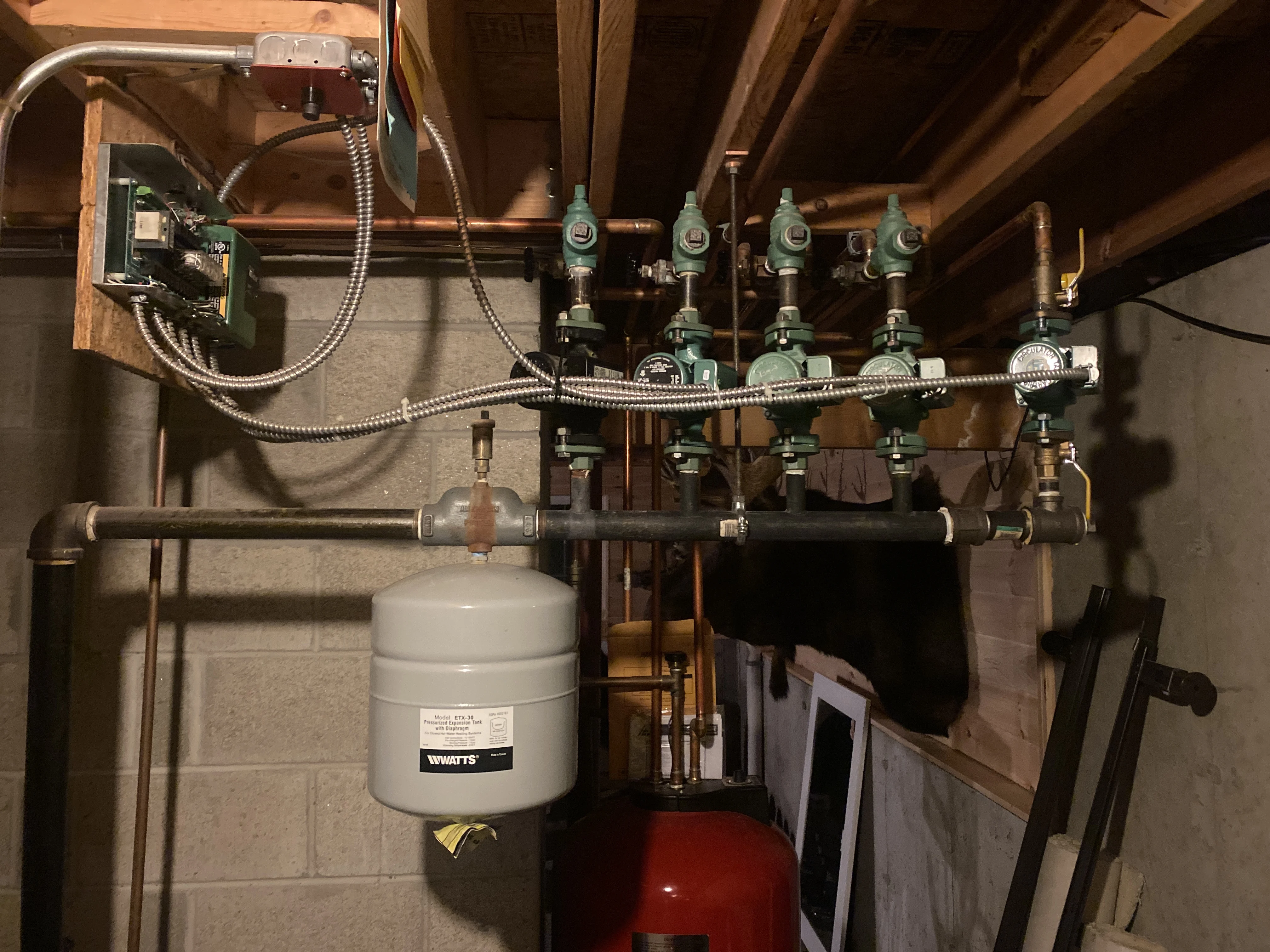

    The problem zone , is it just a single loop or does it split upstream ?
    After the flow check what is the rise to the radiation ? What size flow check being used that zone ?

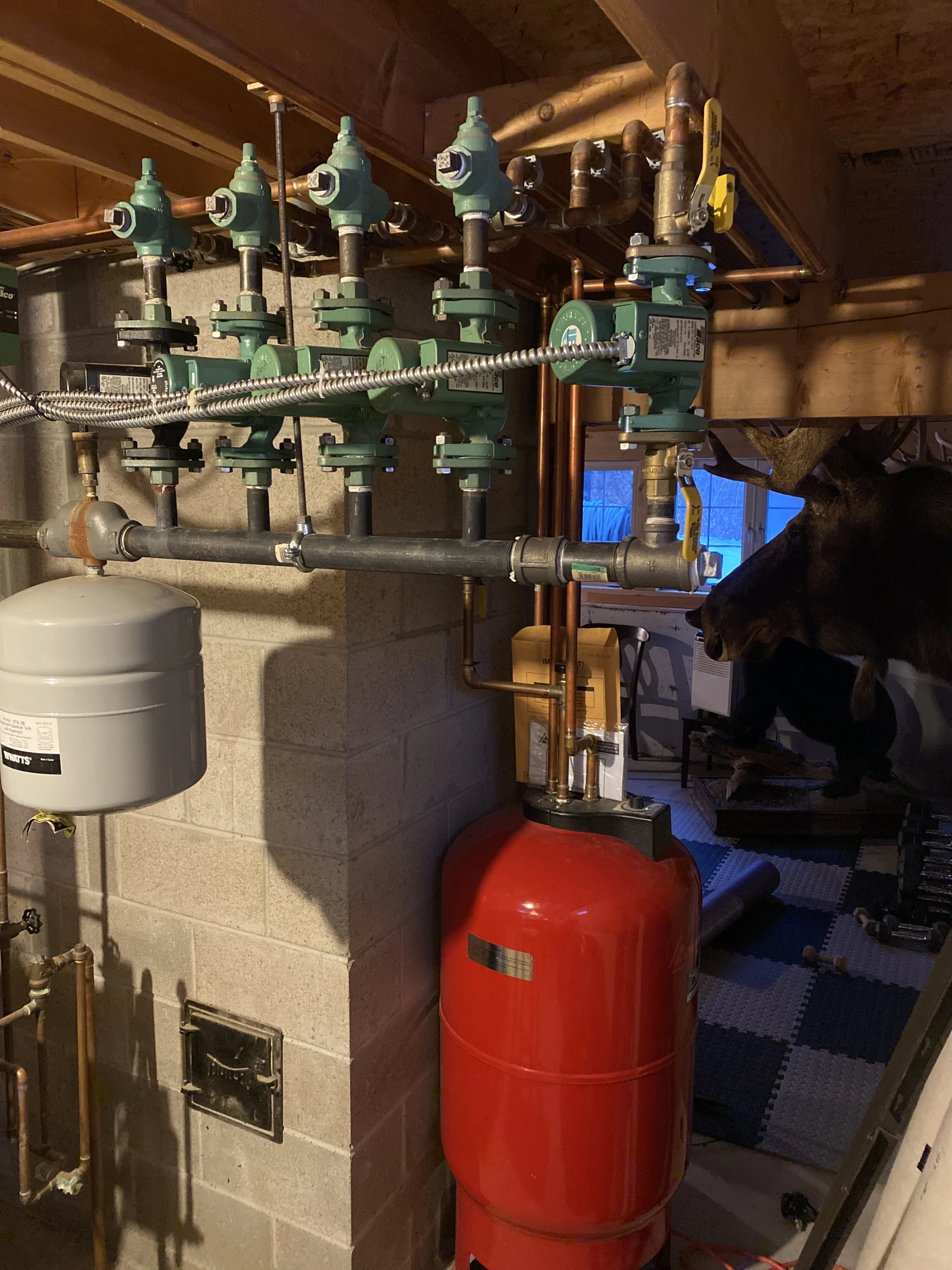

  • read through this tread, and the only thing that changed was adding 5th zone for DHW. It’s possible you’re creating a higher differential pressure overcoming the .5 psi to open check and allow flow into that zone. What negates my theory is it would happen in your other zones too. I like Hot Rod’s suggestion to take the power off the circuit to validate the thermostat. You can call Taco at 401-942-8000 for support.
    But if the supply check is not, you could have 2 directional flow, heat going up and cold coming down the same pipe. So a return check still may not solve the problem. A graphic of that concept.
    As silly as it sounds or looks we have had instances where we are told only a zone valve after the pump has corrected a ghost flow??
    If true I would rip, out all the zone pumps and use a single delta P circ and zone valves. Cure the problem and reduce energy consumption 50- 80-% Most zoned pumped systems are way over-pumped anyways. 007's moving 1 or 2 gpm as example

  • Barley12
    Barley12 Posts: 57
    if I close valve just beyond the taco Flo check the g flow stops. If I close the valve on the return at the boiler the g flow stops. If the valve beyond the circ pump is closed and the return valve is open hot water does NOT flow up the return.
    If either valve is closed then the loop is closed so water cannot flow.

    Any chance you installed that Zone 2 pump backwards? Which way is the arrow pointing on the volute? It looks correctly oriented from the pictures but I cannot say for sure.
    As I posted above a zone valve is the fix.
  • Barley12
    Barley12 Posts: 57
    arrow on the zone 2 pump points in same direction as the other 4
  • Barley12
    Barley12 Posts: 57
    to me it seems the Flocheck just isn't holding…which I agree does not make sense. All the others are holding.

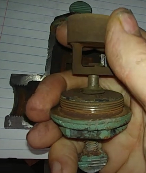

    makes no sense that only the one flo check is not holding but others are?
    I would disassemble it one more time before attempting any other piping changes or adding more checks.

    So you just replaced the internals of the flow control i'm i correct? maybe the valve body has pitting or corrosion at the seating surface? If so maybe then consider replacing the entire flo-check if you haven't already?
  • Barley12
    Barley12 Posts: 57
    The entire flocheck is new (x2). Taco 218-3 flocheck
  • Barley12
    Barley12 Posts: 57
    so today I'm going to swap Flochecks between zone 1 and 3 and see if the g flow moves

    The flow check could be too small for the rise….
    Be sure to disassemble and inspect inside
    The could be a forging or machine flaw. Maybe the plug doesn’t seat properly. There should be some seal marks on both pieces. The slightest of opening allows flow through
