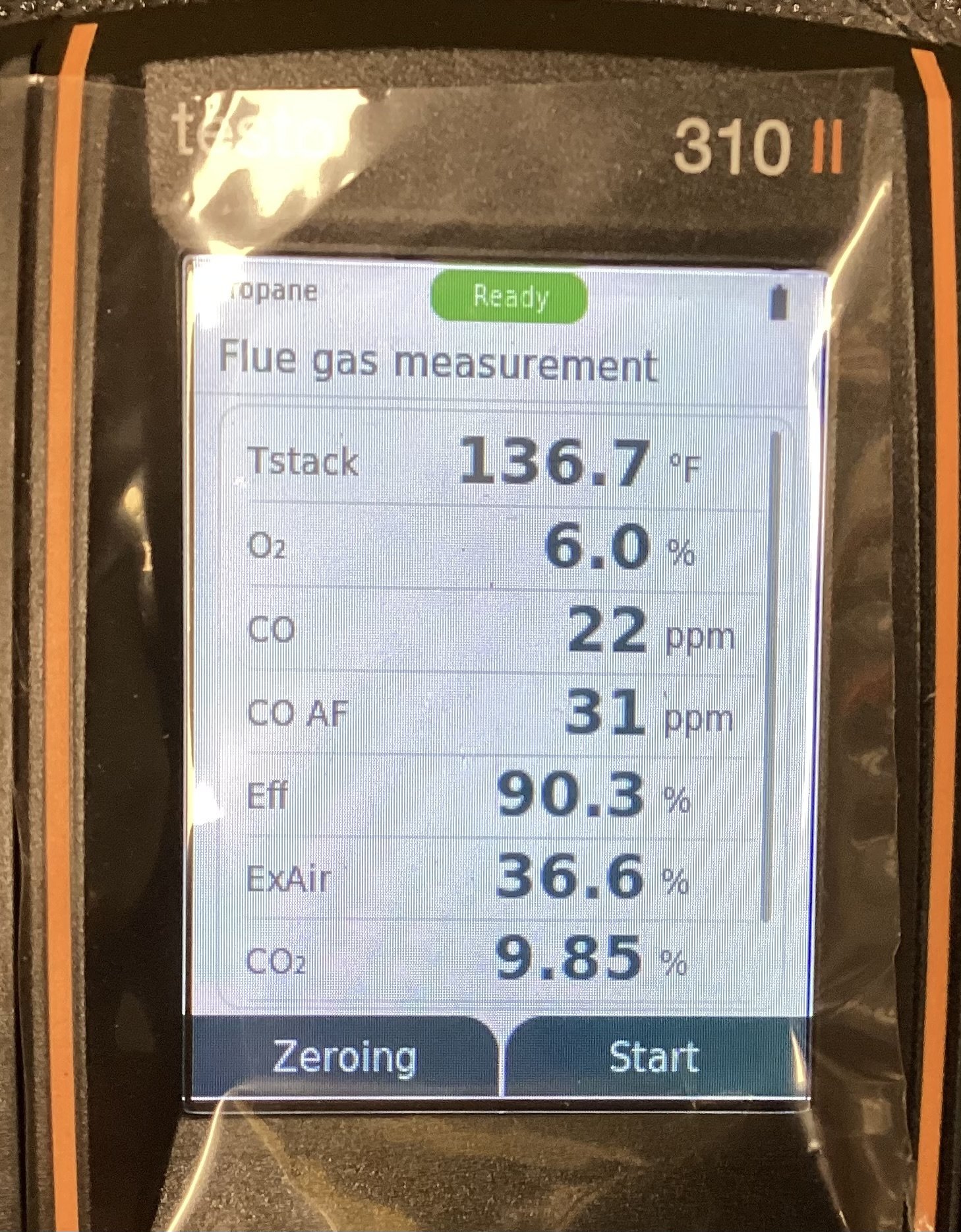

I’m stumped. The TL;DR is the thing ran for ten months just fine, now its under fired and doesn’t want to start reliably.
Here’s the long version: The boiler in question was hung on the wall in 2019 for a remodel and the project went dormant during Covid, never finished or fired.
Fast forward to Feb 2025, the gas company failed to bring NG to the street so it was It was converted to LP with the mfg’s kit, a new venturi and blocking plate. A 1000 gallon LP tank was buried and the boiler supplied with 1” Tracpipe, about 20 ft downstream of the second regulator. Intake and exhaust are approximately 10 feet of 2” pvc with several 90’s in each, all okay according to Lochenvar.
Unit was commissioned, gas pressure was 12” wc at high fire and combustion was within limits (don’t remember exact numbers but were as expected). Unit has been running successfully for ten months. Tank got down to about 200-250 gallons and the unit started throwing FLAME FAIL IGN faults about every other attempt to fire. It would recover and run okay for a day and then start failing again.
Tank was filled to 800 gallons but problem persists.
At high fire, Co2 is low at about 9.8% , O2 is 6.0%. Targets are 10.8 and 4.5. Gas pressure is good at 12”, in both idle and high fire. Gas value mixture screw has no effect on firing with a short, all blue flame.
Gas valve was replaced to little/no effect, actually the problem is a bit worse as start is even less reliable. Heat exchanger interior is soot/combustion particulate free, burner screen also clean. Igniter and sensor were cleaned, the very light buildup on them was whitish-grey.
I have checked for intake/exhaust blockages with an endoscope, I don’t see anything in the lines. I would check the delta-p across the heat exchanger but I have no idea of what it should be so I’m stumped and open to suggestions to troubleshoot further- and of course will answer any questions.

    Please note the unit ran successfully for ten months with the proper combustion readings. Now it’s quite lean and adjusting the gas valve mixture screw has no effect on the combustion analyzer, photo attached of the current condition. Installing a new gas valve did nothing.
    The only thing I can think of at this point is that there is a blockage in the heat exchanger that is reducing airflow thereby reducing gas flow. Am I barking up the wrong tree on that one? If not, how would I check that? Couldn’t I measure the delta-p across the hx? I know there is differential pressure switch that monitors for excessive pressure drop but that’s never thrown a fault.

    It was HomerjSmith for the win…
    His photo of the conversion kit got me to searching. Found my boiler was made shortly after some major change in 2018. It was either shipped the wrong conversion kit or parts were missing from it, it was so long ago that the actual evidence is long gone, as is the distributor that sold it to me, they were sold to Ferguson and my sales guy long ago retired.
    Ordered a new kit and installed yesterday. Of course that was the problem, the lack of the venturi. The only conclusion I can make is that the weather was warm when originally commissioned, once it got cold, it wouldn’t fire reliably. I do remember the tech adjusting the mixture screw on the gas valve when it was originally fired up (February ’25) but it was only providing DHW and did not provide space hearing until this heating season in the fall of ‘25. So, it may have been having ignition problems from the get-go and I never really knew it due to the indirect storage tank.
    Gas pressure at the valve is about 10.5 inches, it fluctuates a bit, maybe a 1/2 inch in high fire. I did have to open the mixture screw (turning counter clockwise) about three turns to increase the co2 to get it into range, not sure it that a sign of anything else in play as Lochenvar says it shouldn't need adjustment and to turn it only a 1/8 turn at a time. It doesn’t seem at all sensitive.
