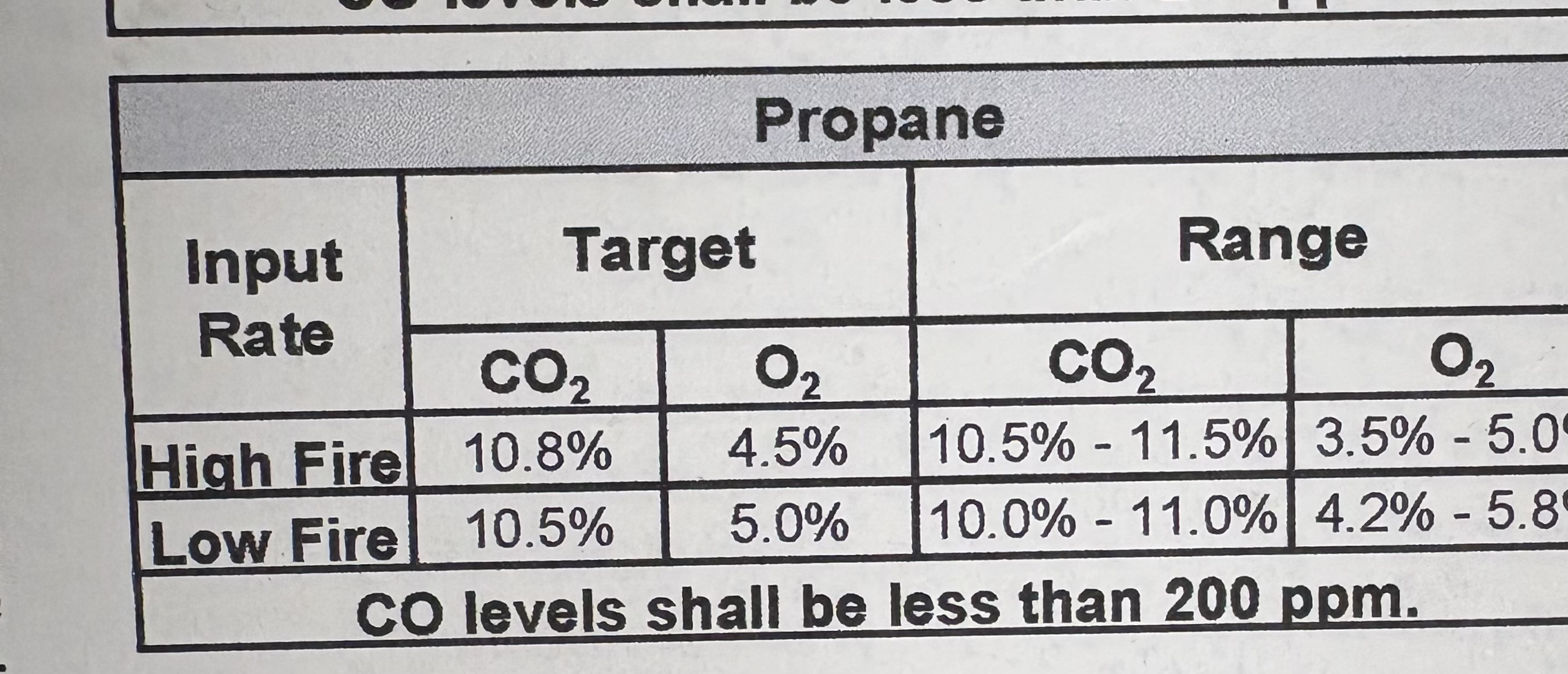

At high fire, Co2 is low at about 9.8% , O2 is 6.0%. Targets are 10.8 and 4.5. Gas pressure is good at 12”, in both idle and high fire. Gas value mixture screw has no effect on firing with a short, all blue flame.

    Your combustion numbers are indicating that your running lean. Lochinvar chart indicates it wants anywhere between 10.5 to 11.5 on the CO2 on high fire. Increase the gas

    You dont need more gas incoming to the gas valve. You need to increase the fuel/air ratio in the burner. This requires a combustion analyzer. You need to increase your CO2 which in turn will lower your O2 to the proper value

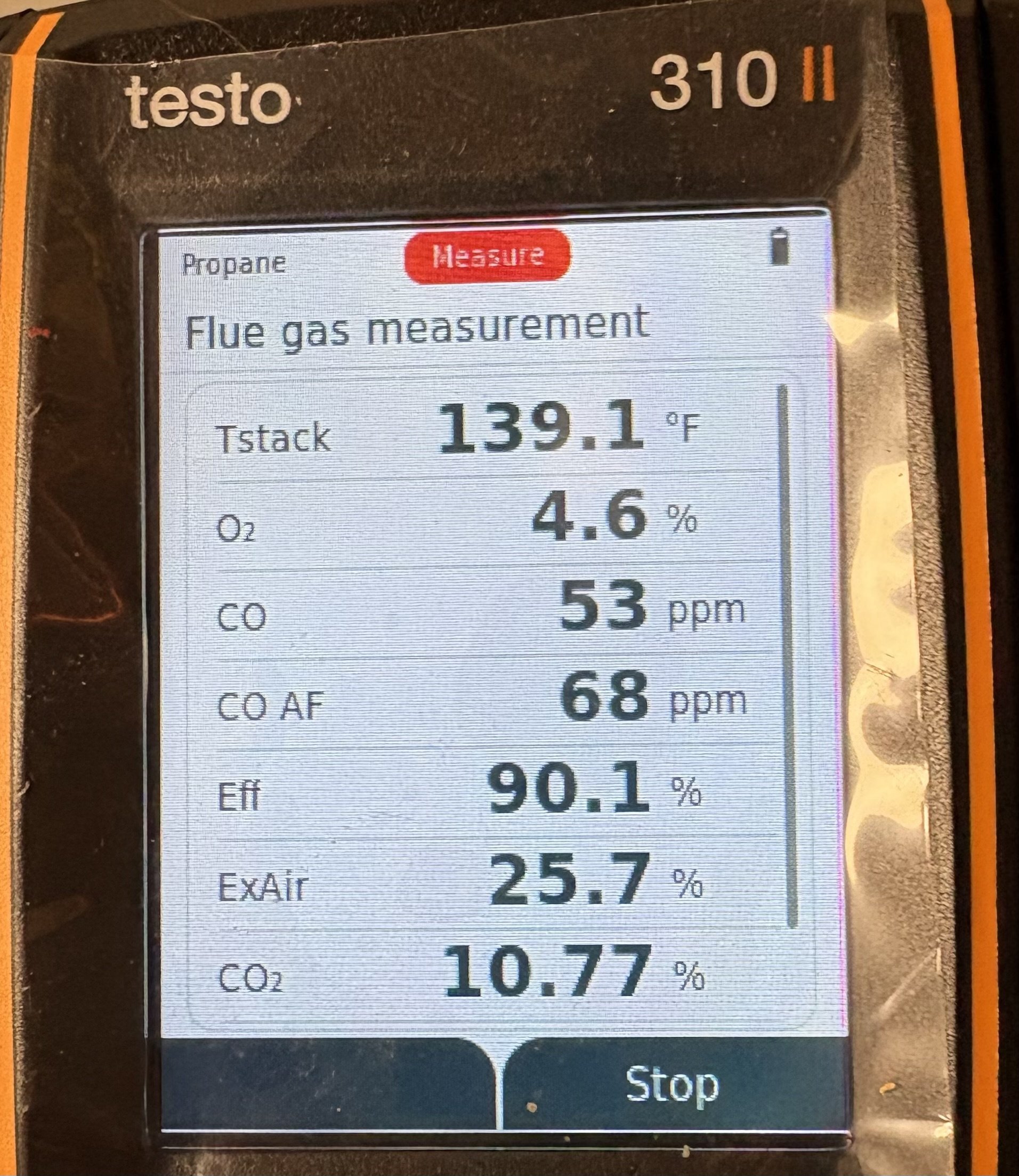

    Please note the unit ran successfully for ten months with the proper combustion readings. Now it’s quite lean and adjusting the gas valve mixture screw has no effect on the combustion analyzer, photo attached of the current condition. Installing a new gas valve did nothing.
    The only thing I can think of at this point is that there is a blockage in the heat exchanger that is reducing airflow thereby reducing gas flow. Am I barking up the wrong tree on that one? If not, how would I check that? Couldn’t I measure the delta-p across the hx? I know there is differential pressure switch that monitors for excessive pressure drop but that’s never thrown a fault.

    Ordered a new kit and installed yesterday. Of course that was the problem, the lack of the venturi. The only conclusion I can make is that the weather was warm when originally commissioned, once it got cold, it wouldn’t fire reliably. I do remember the tech adjusting the mixture screw on the gas valve when it was originally fired up (February ’25) but it was only providing DHW and did not provide space hearing until this heating season in the fall of ‘25. So, it may have been having ignition problems from the get-go and I never really knew it due to the indirect storage tank.
    Gas pressure at the valve is about 10.5 inches, it fluctuates a bit, maybe a 1/2 inch in high fire. I did have to open the mixture screw (turning counter clockwise) about three turns to increase the co2 to get it into range, not sure it that a sign of anything else in play as Lochenvar says it shouldn't need adjustment and to turn it only a 1/8 turn at a time. It doesn’t seem at all sensitive.
