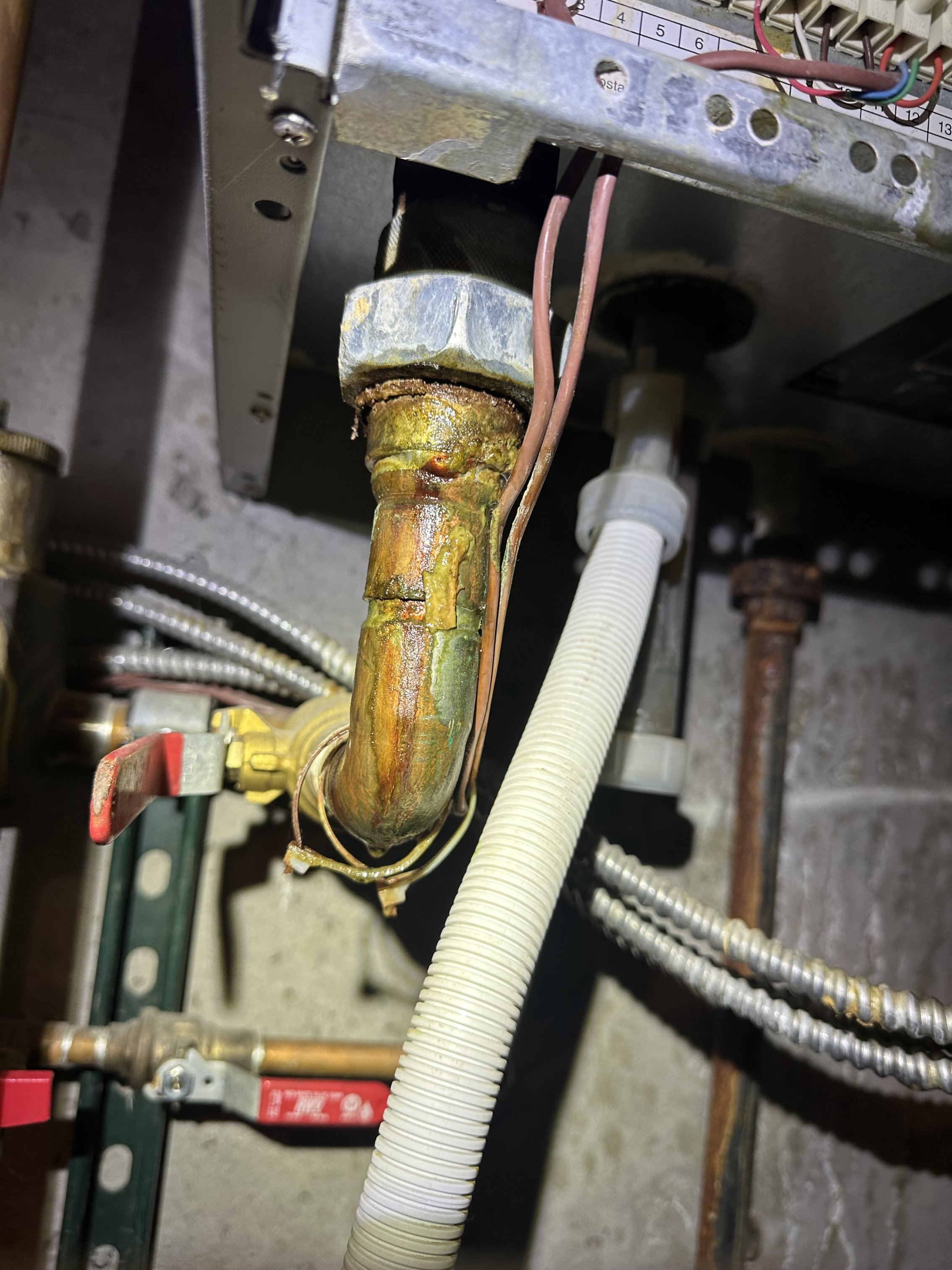

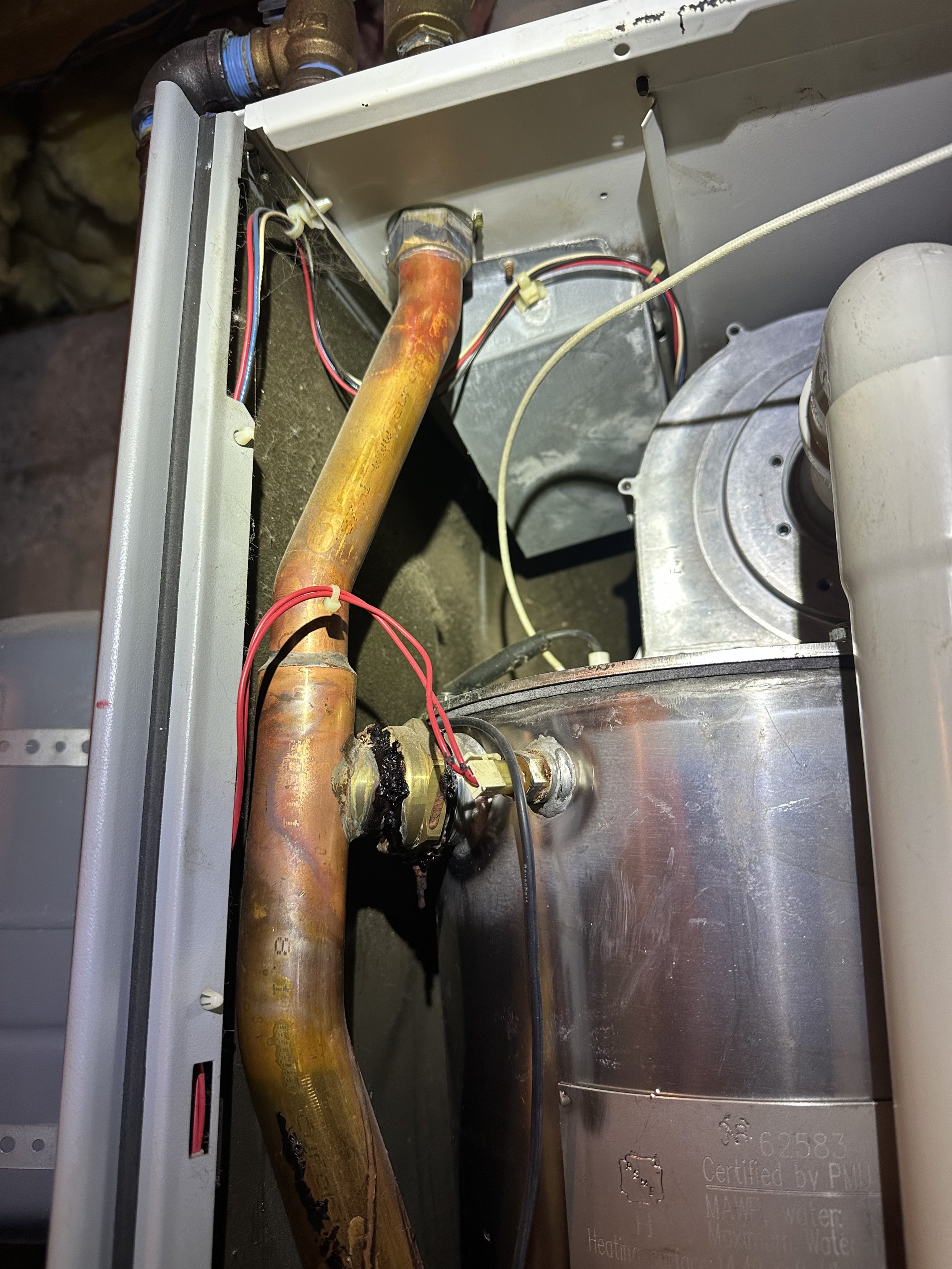

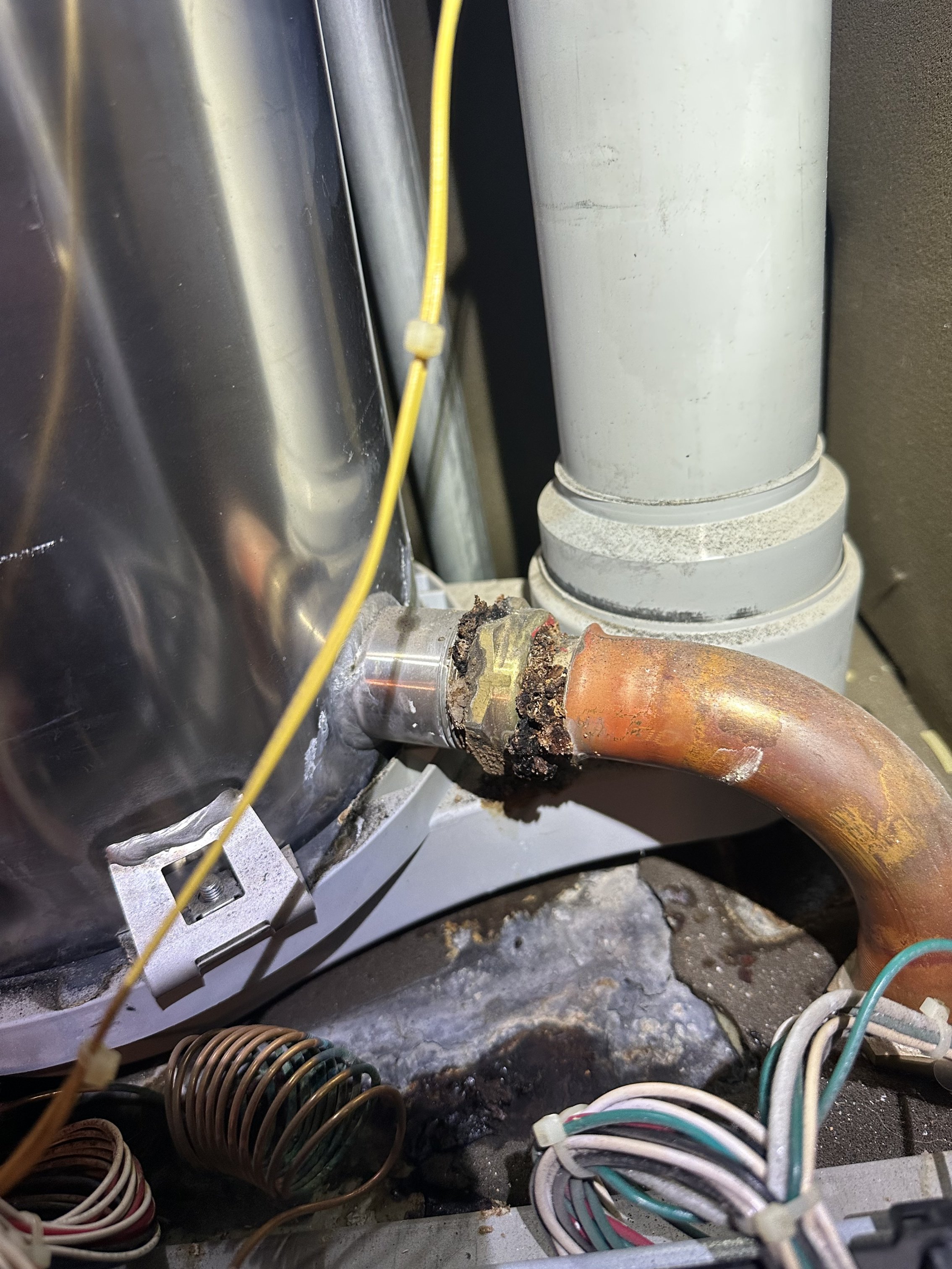

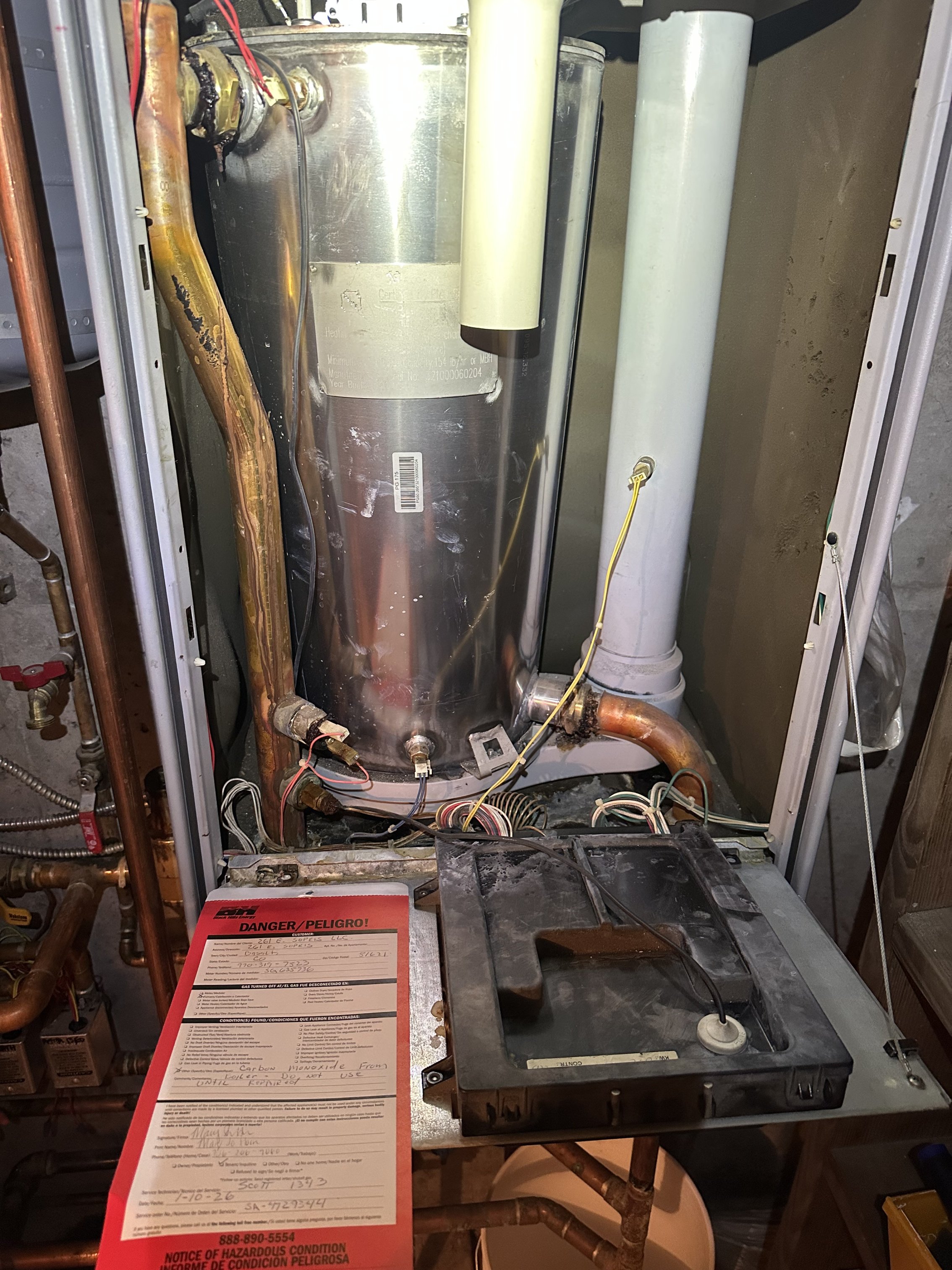

    Said it's one of the worst he's seen… these are my photos below so I'm not sure if I'm photographing the relevant part:
    tempImage55LqNR.jpg tempImage7qUbZF.jpg tempImageMmj0cn.jpg tempImageZ3cGVy.jpg
    hot_rod Member Posts: 27,301
    Does this system have glycol in it? Those leaks all look like the fiber washers, which can be replaced
    These are all water side leaks and would not cause a CO issue?
  • GGross
    GGross Member Posts: 1,840
    yeah the water leaks have nothing to do with the CO. the exhaust outlet you mention as the last item to be fixed is the one causing the unsafe condition. I would ask your contractor which recall kit they are trying to procure, there were possibly multiple depending on the boiler, one that had to do with CO leaking, which is a 5 minute repair for a DIY, and one that was an ignition update which would be not needed if just runing the boiler for a few months until demo. leaking water is less than ideal, but if the whole house is getting demo'd soon just patch where necessary, find and fix the source of CO, and handhold the thing through its final months. IF you buy a new boiler now you will spend a ton of money to fix everything, and then rip it all right out and re-do it again, if you re-use the new boiler it will technically not have any warranty if it's not in its original installation.

    is it possible the CO is blowing right out of the bottom of where the heat exchanger meets the plastic looking exhaust base? If you click on the photo provided and zoomin to the bottom where the stainless meets the plastic its pretty dark which to me looks a little like heat was blowing out there. I assume this has never been taken apart and I am not familiar with this device but it looks like there would have been a gasket or some other seal at this spot and it would have been thick enough to isolate the plastic from the steel. This thing may be really dirty inside and the heat has found a weakspot at the bottom and is exhausting some of the CO inside.
  • PeteA
    PeteA Member Posts: 317
    even the lining looks like it's deformed and bubbling off on the left hand side of the heat exchanger. This thing needs a teardown and a deep cleaning at the very minimum but I think there is more going on here than just one or washers, this thing looks like it got really hot inside the cabinet.

    I would see if the nuts on top plate where the fan is are loose. Make sure that the rubber gasket is compressed. There is a gasket between the fan and the top plate, too. Clean every thing up as best you can.
    Maybe an IR camera could pinpoint the leak. Look for a heat signature.

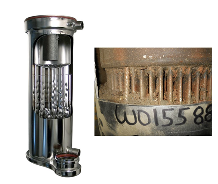

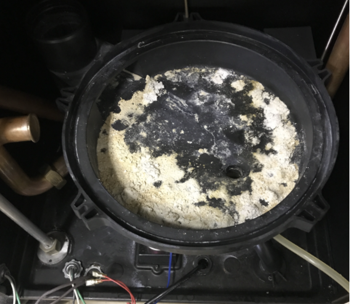

    I'm thinking something like this may be going on under the hood, causing all the high temperature issues.
    Any idea of when it was opened and cleaned last? Not just an external wipe down cleaning :)

    WOW Bob
    @hot_rod how long did that one run for like that? I had no first hand knowledge of how the equipment in the OP was assembled but I did imagine it was debris and a bottom gasket or some other seal leaking. Geez I never imagined these thing can load up that much junk in them.
    When the fire tube mod cons became available one of the selling features was they are "self cleaning" the condensate running down the tubes allegedly was going to keep them clean :(

    Plus bad water quality on the water side can cause over-heating tubes and and welds to fail.
    All boilers need servicing and they need good water and proper combustion adjustments.
    They are what they breath, if they suck in tree pollen, bugs, dust, etc that will show on the first cleaning often, alerting you to the fact something needs to be corrected.
    PeteA
  • tim smith
    tim smith Member Posts: 2,928
    Hot Rod, I agree that I would bet on the heat x tubes are blocked pretty well. We have cleaned so many of these but most don’t go far enough. They may vac out grounds from comb chamber and spray some cleaner in chamber and tubes then flush with some water. Problem is the grounds don’t break down with the cleaner. They then stack up in tubes where they are dimpled. Once too clogged they are virtually impossible to clear fully. Be that said someone should open and see. We have seen several blow out top heat x cover gasket and then the insides fry, this does not look lit that it seems.
    It’s amazing how they will run when so clogged. They shouldn’t. Also pretty sure that boiler falls in recall for flue connection modification. They should call recall program to verify. That is still in operation.
