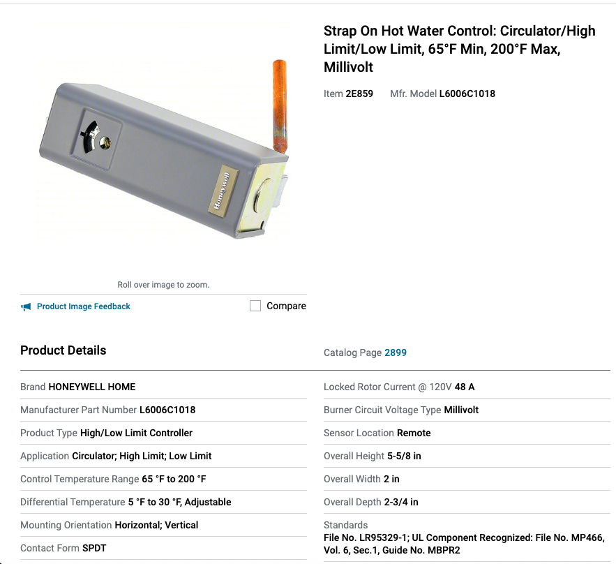

    Automatic . I was thinking to set the primary boiler to 180 and the backup to 160 this way if the primary stops working the backup kicks in.
    hot_rod Member Posts: 27,811
    check to see what the differential us on the oil noiler control. If it is off at 180 back on at 160, plus some heat loss through the piping, adjust the control that calls on the combi boiler accordingly
    A simple strap on type control on the piping to call on the combi, so it senses the oil boiler is not heating

    Here are some control options. This strap on has a good temperature range and adjustable differential for fine tuning.
    I prefer electronic type controls Ranco, Honeywell, Johnson Control, etc. you get more features and have the digital temperature always reading out.
