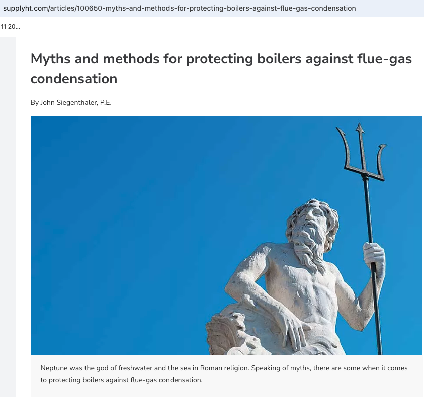

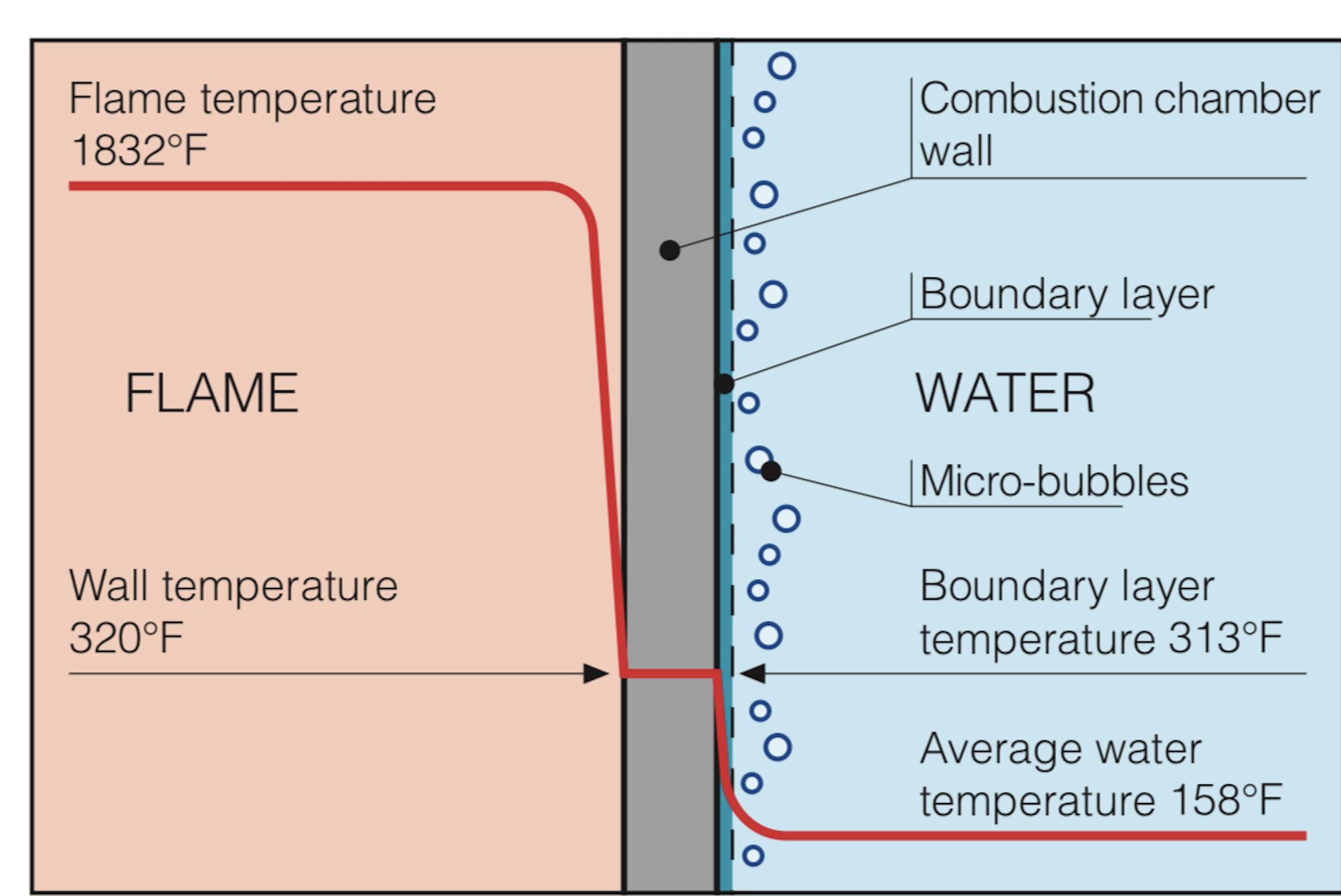

    hot_rod Posts: 28,708
    It's possible with very low flow conditions the condensation could evaporate ad not cause issues. The potential is job specific.
    I could put my temperature probe in the blue flame tip and record well over 1500° F and still be condensing on the boiler castings.

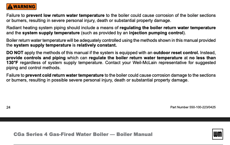

    My advice, as well as that of the people that design, manufacturer, rep, sell boilers, and educate the industry is to follow the boiler manufacturers guidelines. That is who you will be contacting if you have a warranty claim.
    I see the current manual for the Weil Cga series has this warning on three different pages now. Must be a reason? Similar verbiage in the US boiler manuals.
    Screenshot 2025-12-30 at 9.41.51 AM.png Screenshot 2025-12-30 at 9.51.57 AM.png

    @hot_rod Thank you for that info. I did read that Siegenthaler article. Just to be clear, I am not advocating that anyone should ignore mfr recommendations on return water temp protection when installing a new boiler. When I replace our boilers, I will follow those recommendations for installing a bypass on high water volume systems like ours.
    But I would just observe that the graphic you posted actually makes my point. It's important to remember that the only temperature that matters for flue gas condensation inside the boiler is the wall temperature on the hot gas side, where the lowest temps will exist from cooling by the water. The graphic shows temperatures that would be representative for a hot boiler running in quasi-steady-state conditions, by which I mean the boiler has run long enough that the boiler stack temperature is probably 350+ F and most of the heat generated is now being transferred to the water, not being absorbed by the exchanger itself in startup.
    The graphic shows that the wall temp on the hot gas side is 320F, far above the 105F dew point for oil burner combustion products with 10% CO2. It also shows that the water boundary layer can be 150+ F hotter than the average water temp. So, for example, if we imagine all temperatures reduced by, say, 50 degrees or so to represent an earlier point in the burn cycle, the graphic would show an average water temp of 100F, a water boundary layer temp of around 250F, and an HX surface temp of around 270F. Of course, the exact temps will depend on a given boiler and a given operating point, but from a heat transfer point of view, a temperature profile like that is entirely possible. The water side can be only 100F average, and yet the surface of the HX can still be well above condensing temps. And I contend that is exactly what is happening in my boilers.
    I apologize for digressing and will leave it there. Some day I'll figure out how to instrument one of our WGO-5's to show temperature profiles on the HX surface which, I contend, will show that all HX surfaces are well above condensing temperature within 10 or so minutes of startup, after which I could run 100F water through the boiler all day without causing it to condense after the startup transient.
