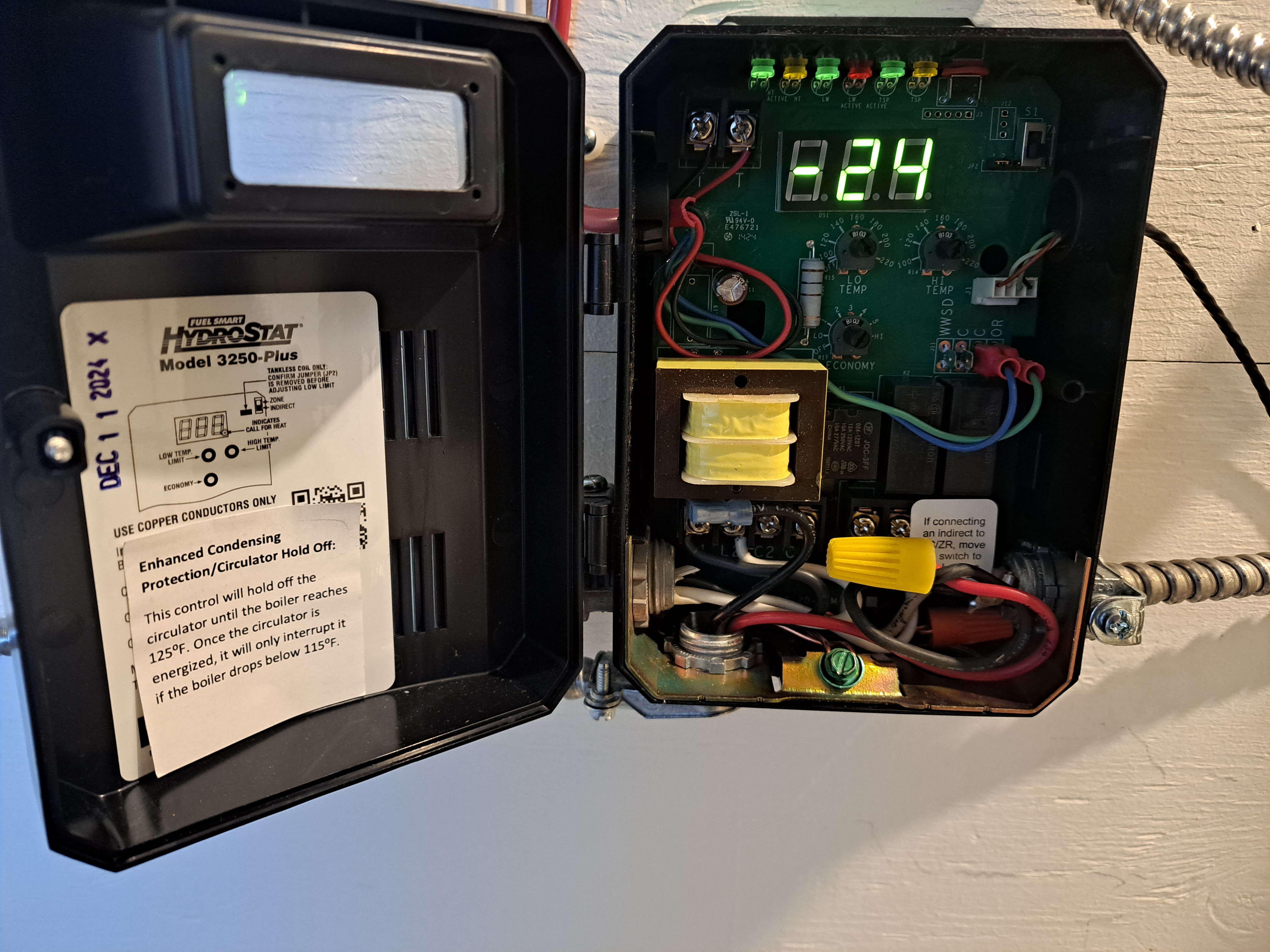

Hi all, was not sure whether to post here or in the oil burner section, but since the system is solely for radiant floor heat, I figured I'd post here.
I recently moved a 1100 sqft 1960s house onto a brand new ICF basement and added in-floor heat to the slab. I had the plumbers install a viessmann oil fired boiler and pumps/piping for the in-floor heat as well as DWH. The main floor is heated by an oil fired forced air furnace. The system is an injection mixing system controlled by a Tekmar 403 with only one zone plus DHW. The system drawings are shown in the pictures. All circulators are controlled by the Tekmar.
In the future (2-3 years time) I will be adding an enclosed solarium and a garage. Both heated with radiant heat from this system. I believe this extra heating load will help the system operate better, but I need to to function properly until those additions are built.
The oil burner is controlled by a hydrostat 3250+ which is controlled by the Tekmar. The problem I am having is that the boiler is short cycling. The burner will kick on, run for 2 minutes, then turn off. The 3250 has high limit set to 180, low limit set to 140, and economy set to 2. It was -24F outside when I took the pictures and the 3250's target temperature was 175. However, the Tekmar lets the boiler drop down to 135 before firing the burner, and then only brings the temp up to 160 before shutting the burner down. I do not believe the 2 minute run time of the burner is enough to get the chimney up to temp and prevent condensation. At least the furnace does run for 10 mins at a time, but I do not think relying on it to keep the chimney dry is a good idea.
Since the Tekmar is mixing the boiler water down for the floor heat, it does not care about having very hot water from the boiler, so the target boiler temp in the Tekmar always shows 140 as that is the low safety limit programmed in. The other issue is that on warmer days, when the furnace kicks in to heat the main floor, enough heat leaks into the basement to satisfy the boiler thermostat, and the boiler does not run for very long periods of time. This allows the boiler water temp to drop well below 135. According to my understanding of cast iron non-condensing boilers, I do not want this.
The problem is the 3250 will not fire the burner unless the Tekmar is connecting its TT terminals. But the Tekmar only does this when there is an active call for heat and even then it does not let the boiler get up to what I would think is a reasonable temperature for a -25 degree day.
I have read through the manuals for the Tekmar and 3250, but do not see what I can do to make this system operate better. The nozzle in the burner is already a 0.5 gph, so downfiring to increase the run time does not seem to be an option.
Any thought/opinions welcome. Does anyone know how I could set the controls better, or is it fine the way it is? The short 2 min run times does not seem right to me.

    The first thing I see in your description is that you may have the LO limit set to a number (140°). This LO is for a tankless coil DHW boiler. You have an indirect for DHW. Your LO should be set to OFF. That change may let the burner run for a little longer, but not that much longer.

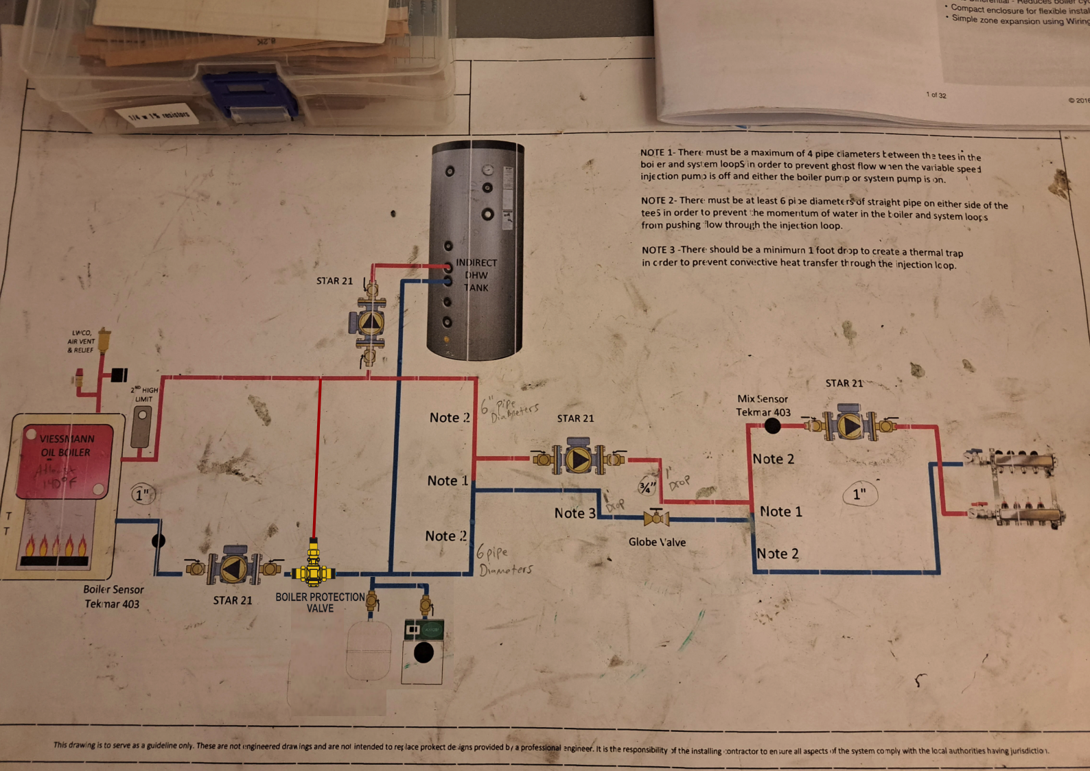

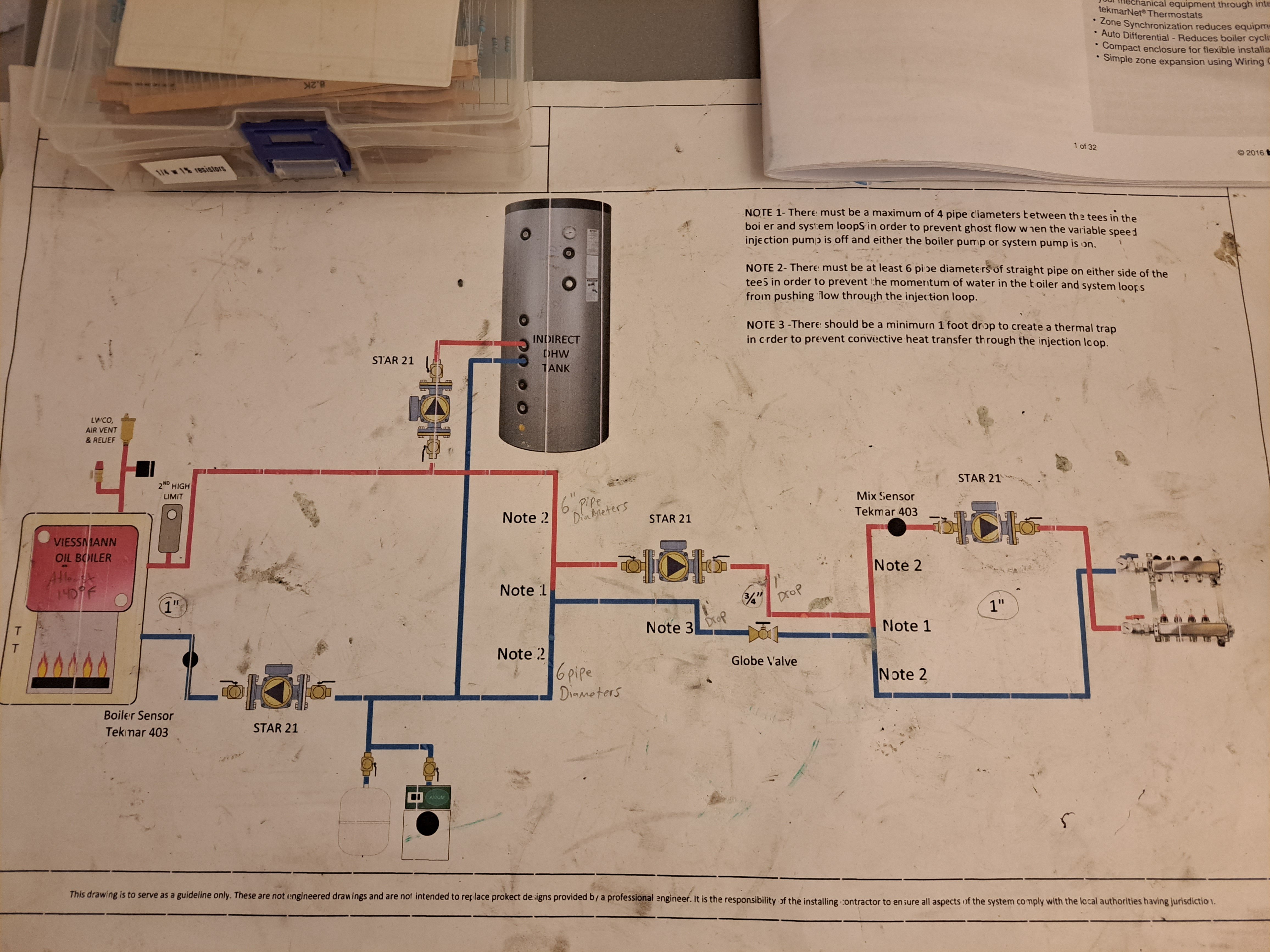

    In the piping diagram the boiler is pipes with a primary loop (the loop with the expansion tank) so the water can make a short run back the the return in order to get the return temperature up to the recommended minimum 135° is pretty short order.  Once that return water is at that temperature the amount of heat removed by the injection pump should not cause the return water temperature to drop below that minimum of 135°.  If it does the Tekmar is not  able to make the necessary adjustments to get that return temperature back up to the minimum since there is no boiler return sensor.   You may need to add a boiler protection valve on a bypass in order to accomplish that function.  Caleffi boiler Protection valve.  This would guarantee the boiler will reach the minimum return temperature every call for heat because the boiler will operate until the return reaches 135° before sending any heat to the zone or DHW Tank. This may end up using a little more fuel as a result of the extra heat building up before you actual start to heat the zone(s)

    Yes, I should have mentioned it was originally off and I had raised it to 140 to try. There is no difference in operation between the two settings.
    The boiler is 91k BTU. I am not sure what the heat load of the zone is. Before the system was running, a 4.8kW construction heater was able to keep the basement above freezing which would be around 16k BTU/hr. Yes, I do believe the boiler is oversized. However, this is the smallest oil boiler viessmann makes, and I need the capacity for future zones plus DHW demand.
    In the diagram, you can see the system actually has a boiler return sensor and a mix injection sensor. There is no boiler supply sensor for the Tekmar. I believe they may have set it up this way to make the Tekmar provide the boiler protection without the extra valve? Most applications I see online have the Tekmar connected to a boiler supply sensor.
    Some interesting ideas in that thread relating to calling for cirulators without firing the boiler. I wonder if an independent control that calls the 3250 to fire the boiler to limit and lets it cool to low limit would help extend run time. The tekmar could still be tied in to the 3250 to fire the boiler on a DHW call. This would allow me to keep the ODR on the 3250 as it would dictate the high limit.
    It seems to me I need some sort of additional control. Because if the system is short cycling on a -25 day, it will only get worse as outside temps increase and heat load is less. Plus the system still needs to provide DHW all summer when there are no zone heat calls

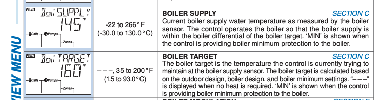

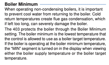

    I'm not familiar with that model 403, but it looks like it has a boiler return protection option?
    There is a lot to learn about that control and it's settings. Read the manual and maybe contact tekmar for any clarification.

    @hot rod. And that's part of the problem like I mentioned above. The control and the aquastat aren't working together. The aquastat needs to be relegated to basically a high limit device, higher than the setting on the Tekmar, and use the circulator hold off feature to protect the boiler, not the Tekmar.

    @skippy_ replied: "In the diagram, you can see the system actually has a boiler return sensor and a mix injection sensor. There is no boiler supply sensor for the Tekmar. I believe they may have set it up this way to make the Tekmar provide the boiler protection without the extra valve? Most applications I see online have the Tekmar connected to a boiler supply sensor."
    I took a closer look and see the return sensor. but I do not see tghe option in the Tekmar to select that boiler supply sensor as a return mounted sensor as other Tekmar controls have. But I didn't look at the entire manual either. So if that is the case then toy have no other option for prolonging the burner on cycle since you don't have a large enough load to cause the burner to operate more than a minute and a half. The only other option is to use a buffer tank and draw that small load from that tank for as long as it can offer enough heat. When the tank reaches a low temperature then charge the tank again with a 8 to 10 minute burner on cycle to heat up that larger mass of water to start the process all over again.
    As you add more load, the cycles will get longer. You can try to add a hot water duct coil to the furnace and stop using the furnace burner in leu of the boiler providing enough heat with its additional capacity.
