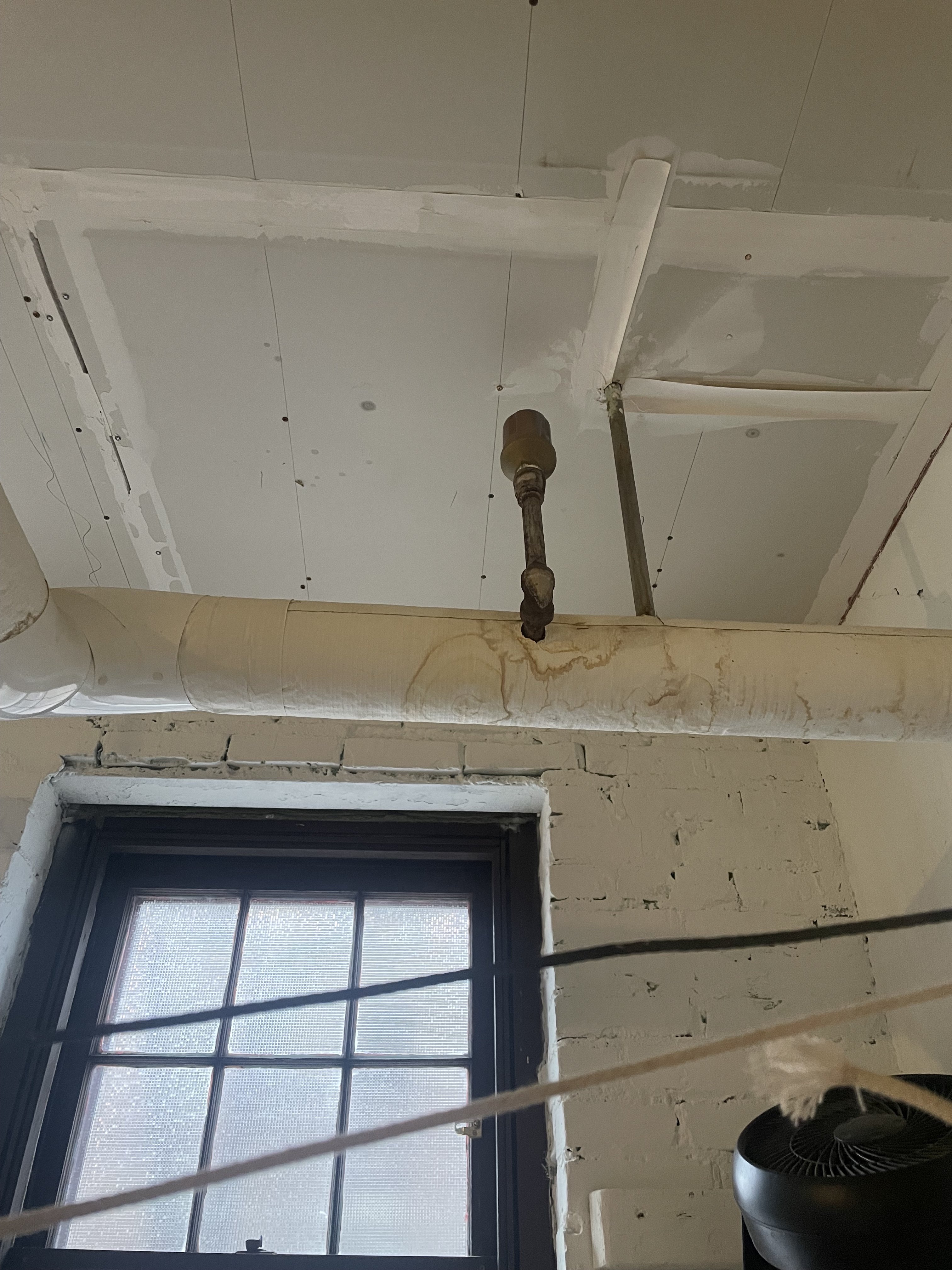

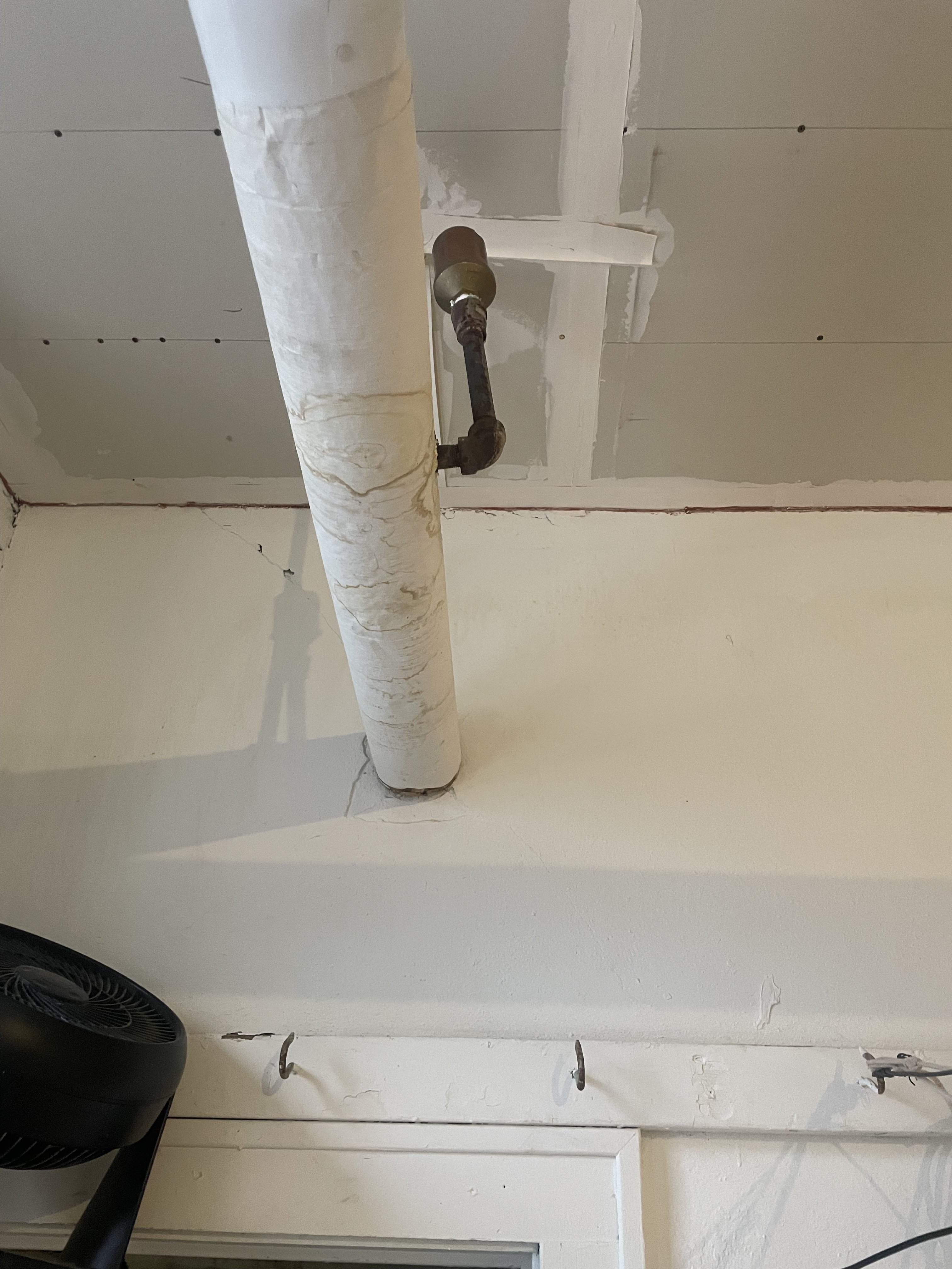

    Here are pictures of the two vents. They are on different lines (one on each side of the building), both in the basement. The one in the last two pictures was replaced last week and is still releasing steam.

    Vent tapping's on the side of the pipe are not the best but thats what you have.
    I don't know if this will work but it may be worth a try.
    Take the vent nipple and elbow off and just leave the short nipple coming out of the main. Put a tee like a 1 1/4 x 1 1/4 x 1/2 " with the branch on the short nipple coming out of the main. Put a 1 1/4 nipple and a reducer and the vent on as long as possible to get the vent up to the ceiling. On the bottom of the tee put a reducer and a valve to be able to blow the rust out occasionally.
    It may not help but it will reduce the velocity going to the vent so any water will drop to the bottom. Cheap $$$ to try it. The vents belong on top of the pipe

    Are the side tappings a problem because particles get caught in the elbow?
    EBEBRATT-Ed Member Posts: 19,891
    I would be more concerned about water getting into the vent. If the vent keeps getting slammed with water "water hammer" they will leak and fail.

    No. We think it is the position of the vents coming off the side of the main vs the top along with the velocity of the air and possibly problems with water hammer.
    Steamhead Member Posts: 18,319
    Those side tappings will work, as long as everything else is OK. My guess is the mains did not have vents originally, and someone drilled and tapped the pipe to add them. It's also possible they tapped a smaller hole (maybe 1/4") and increased the pipe size going to the vent. Cut the insulation away to check this, as long as it's not asbestos.
