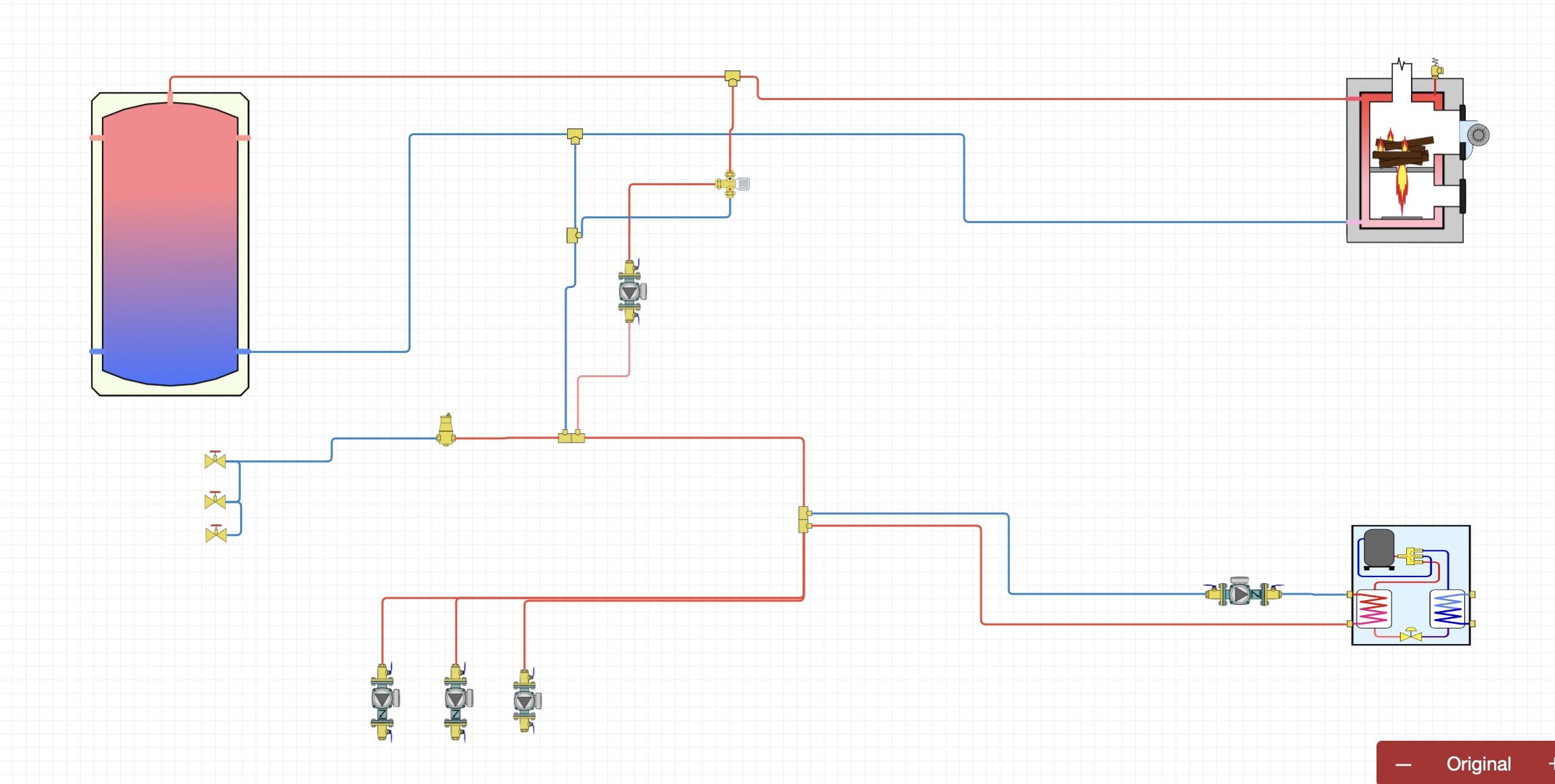

Recently I was asked to put a wood boiler system on to an existing water to water system. The current heat pump works fine, but it was piped into an electric 50 gallon tank. They wanted the tank removed, and this is the final concept. There are actually 3 storage tanks, and a lot of other valves, and miscellaneous items but for you to understand here it is.
Now, the ONLY issue is when the heat pump comes on because a small zone is calling like a bathroom, the flow coming down the 11/4 primary loop is not enough, so the heat pump pulls a lot of its own heat back in through the closely spaced tees and it cycles. on off, on off, of off… so you may say put in a tank. The problem is the whole system is run on a control system that is 20 years old and they dont want to spend the big money to upgrade since its working, so we only have a couple sensors to make everything happy. One sensor sees the wood boiler temp and holds off the geo, and the other is placed at the closely spaced tees on primary where the wood boiler connects to fire the circ pump after mix valve.
I am probably not giving you enough info, but my question is: Would a new variable speed heat pump solve my issue? Would it ramp up slowly and not cycle? The bathroom loads are with in the spec that unit goes down to. But I am not sure how the heat pumps work. I know with a mod con I can ramp up after it initially fires, so it would be great, but I am limited in knowledge with heat pumps and cant find much info. They are looking at the GEOSMART NETZERO 22.

    Your diagram for the wood stove needs a pump to move the heat from the stove to the buffer tank unless it is set up for very efficient thermocycling. That would mean larger sized pipes for gravith flow from the wood stove to the buffer tank. @hot_rod would have more info on that point. Also, there is a complete Idronics on Geothermal, #9… I believe, and another on wood stoves. You can get them online.

    There is no provision of thermal protection for the wood-boiler (i.e. Thermovar etc.) which needs its own circulator.
    Jamie Hall Member Posts: 27,357
    I'm not quite sure where to begin…
    First, as said above,, there is no protection for the wood boiler. Those things can, and will, get carried away from time to time. It needs to have its veery own dedicated circulator to the main buffer tank and back, and it also needs to have a gravity circulation dump zone. The buffer tank could be the dump zone, if it is big enough and if but only if, it is arranged with enough elevation difference for gravity circulation.
    The way that is arranged is flat out dangerous.
    Second, the heat pump also needs to feed the buffer tank. There is no particular reason why it couldn't be controlled by the buffer tank temperature with a simple aquastat set for the best performance from the heat pump.
    Then the rest of the system can pull from the buffer tank. Since the wood boiler is quite unpredictable, however, you will need thermal mising valves and individual pumps for the various zones so that they get the water temperature they need.

    As I mentioned. I left out ALOT of things in the schematic because I didnt think you would be looking for a ESBE Series 1-1/4" 3-Way Thermic Valve. Yes it's installed, Yes the pump is installed. Everything works great except the HP. The current HP is old and doesnt do variable speed. My lack of knowledge with the HP's is why i am asking if the pump on the heat load side also slows when it ramps down? Thats the number one question. If it doesnt, then it wont help my issue at the closely spaced tees.
    We stole the sensor that would typically sit in the buffer tank and tell the heat pump when to come on, and put it in the storage tanks so the heat pump would know not to come on. It's an older control system and cant be added on to without an upgrade. Which is apparently very expensive.

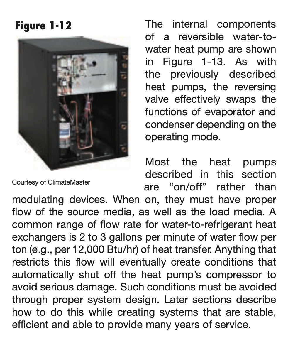

    I think a fixed speed compressor like that will need a buffer
    There is a rule of thumb, so many gallons per ton of hp capacity

    EBEBRATT-Ed Member Posts: 20,164
    Not a HP expert but I have done a lot of water chillers for both comfort cooling and for process cooling.
    For comfort cooling where the load is more or less stable Carrier recommends a Minimum of 3 gallons of system water/ton of cooling.
    For process cooling (which I would use for this job) they recommend MINIMUM 6 gallons of system water /ton of cooling.
    I n this case your heating so I would take the heating capacity of the heat pump in BTUs and this would be the heat rejection and use that.
    But in reality I agree with a fixed speed compressor you need a buffer tank to prevent short cycling the more water in the system the better.
    Trane and others use a different method of calculation but if you work the math it comes out the same as Carrier

    hot_rod Member Posts: 27,446
    An outdoor reset control, sensor in the tank is one option to fire the HP on/off.
    The buffer tank formula is similar to that of a heating buffer tank size.
