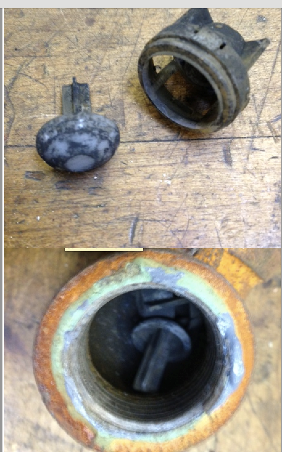

    Pump getting hotter than water by 50 F.I destroyed the check valve. What's the risk of running my floor heat system without it?
  • They only way to remove them is to destroy them.
    I'm going to add a pump to that loop and remove the Caleffi power heads, making sure the checks are installed. I think Grundfos sells checks by themselves.
    @goodend If your pump is that hot, check the amp draw to make sure it matches the rating. If it's different, you may have to replace the cartridge (Taco?) or the motor and impeller.
    hot_rod Member Posts: 27,307
    The very first Grundfos checks were loose in the box, and came with a sticker indicating check installed. But they could be pushed in backwards, and they could spit out and get into the flange or piping!
    The newest ones are larger diameter and I believe Grundfos pre- installs them. They can be removed with a needle nose pliers.

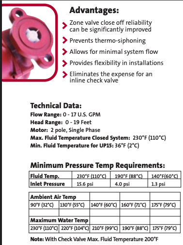

    The checks are rated to 200°F. I don't like the checks close to the pump discharge. I think they get rattled to death in the turbulent conditions there.

    If you remove the actuator the paddle inside the valve body will be floating, it's the spring tension in the motor that allows it to be manually locked open. Although flow should push it and keep it open, I have never tried it to confirm.
    No harm in leaving the ZV in place, I think it is more reliable than a check in the pump body.
    Reports from the field indicate 3- 5 years some of those IFC checks fail. This video shows how the checks rattle around at the pump discharge.
