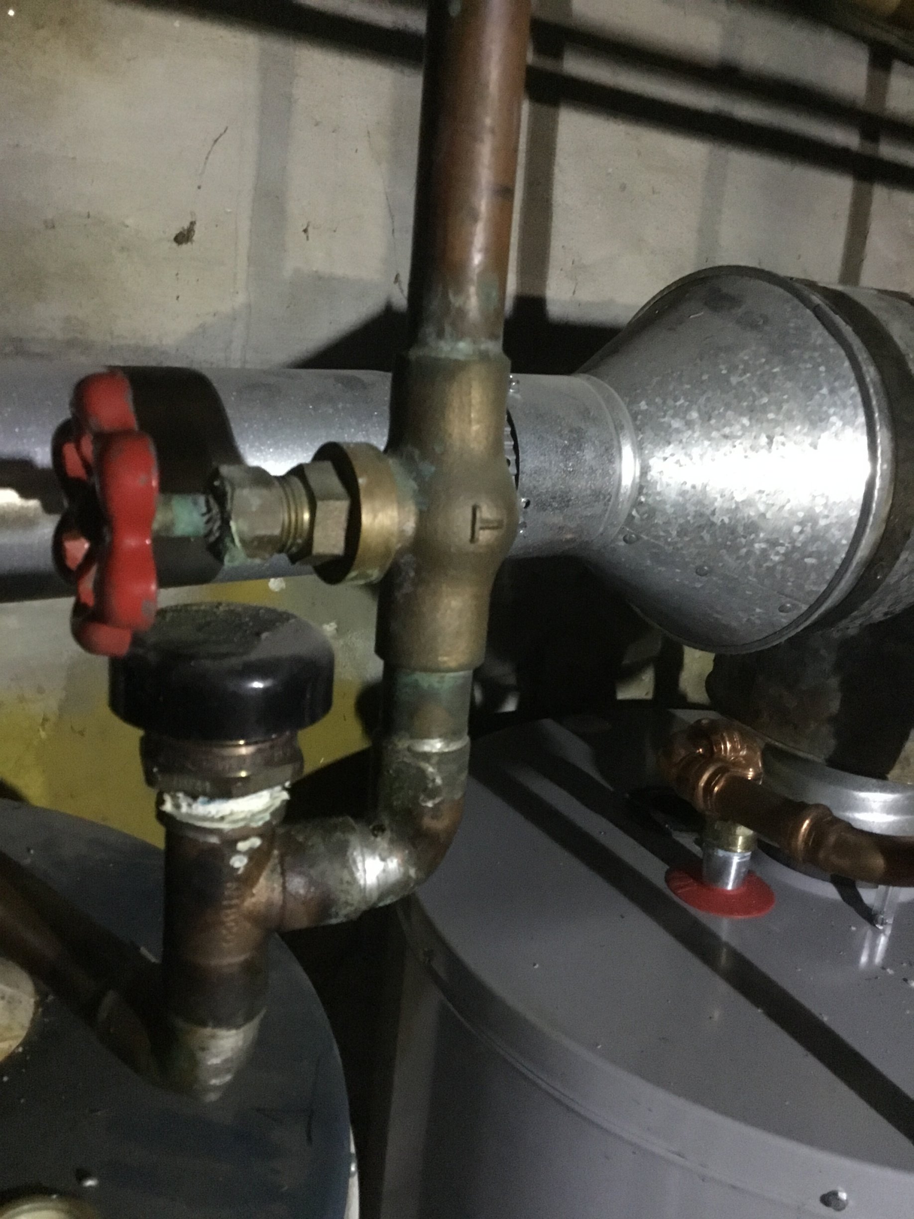

My wife and I spend most our time in a large condo we bought a couple years ago. It is a brick building built 1820’s. Plumbing seems to have been done first half 20th century, plus refits and configurations over time. All units shares cold water but have separate gas hot water boilers and stand alone gas domestic hot water tanks. Our unit is unusual in that it is two units that were combined about 50 years ago, so we actually have two separate heating boilers and two separate hot water tanks. DHW tanks are about 20 years old. Condo rules is that each unit responsible for maintaining their own systems.

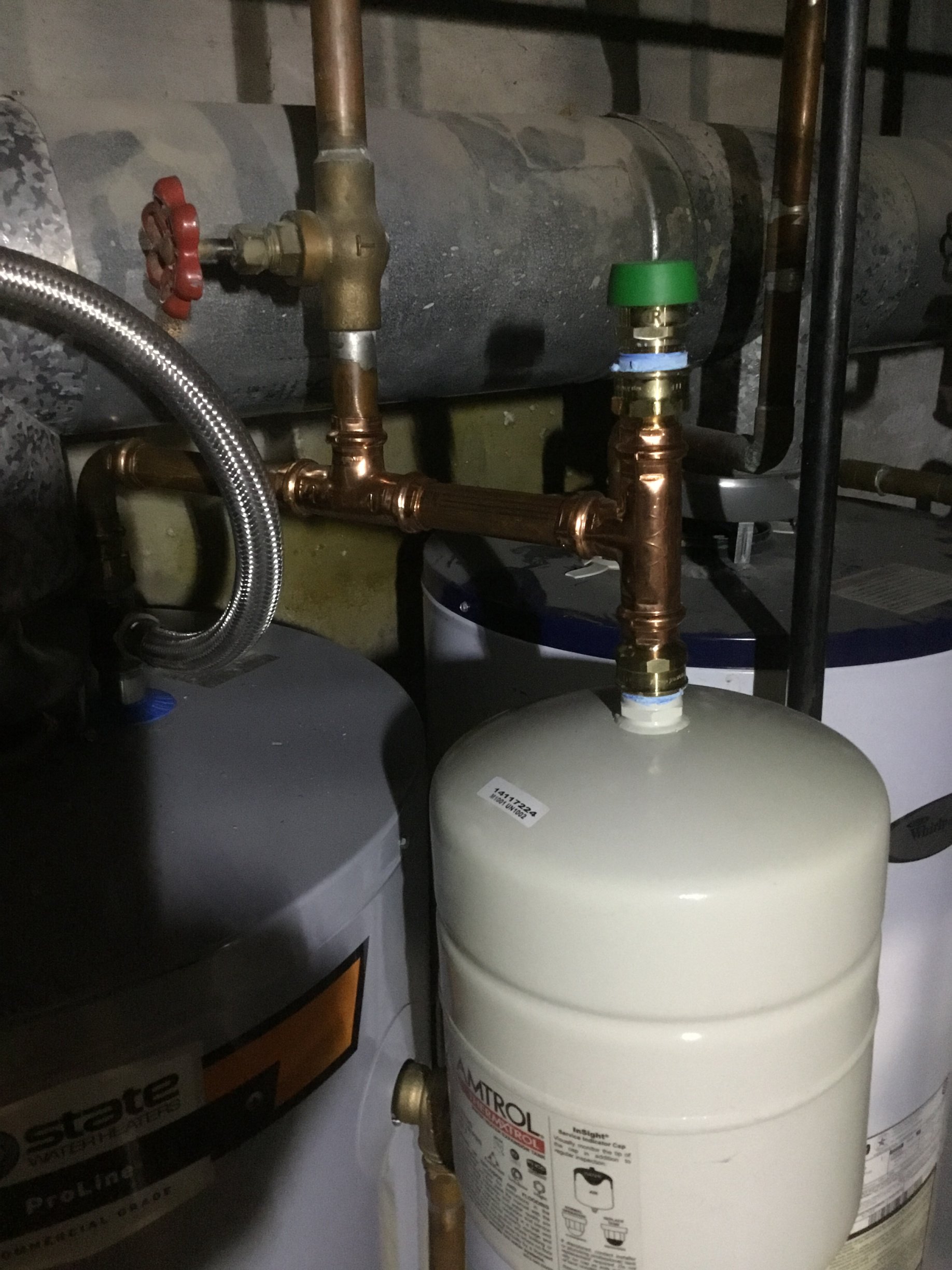

At the time these were installed code did not require any expansion tank, but new code requires it for replacement systems. One of the units replaced their hot water tank a year ago, so this one added a smallish expansion tank.

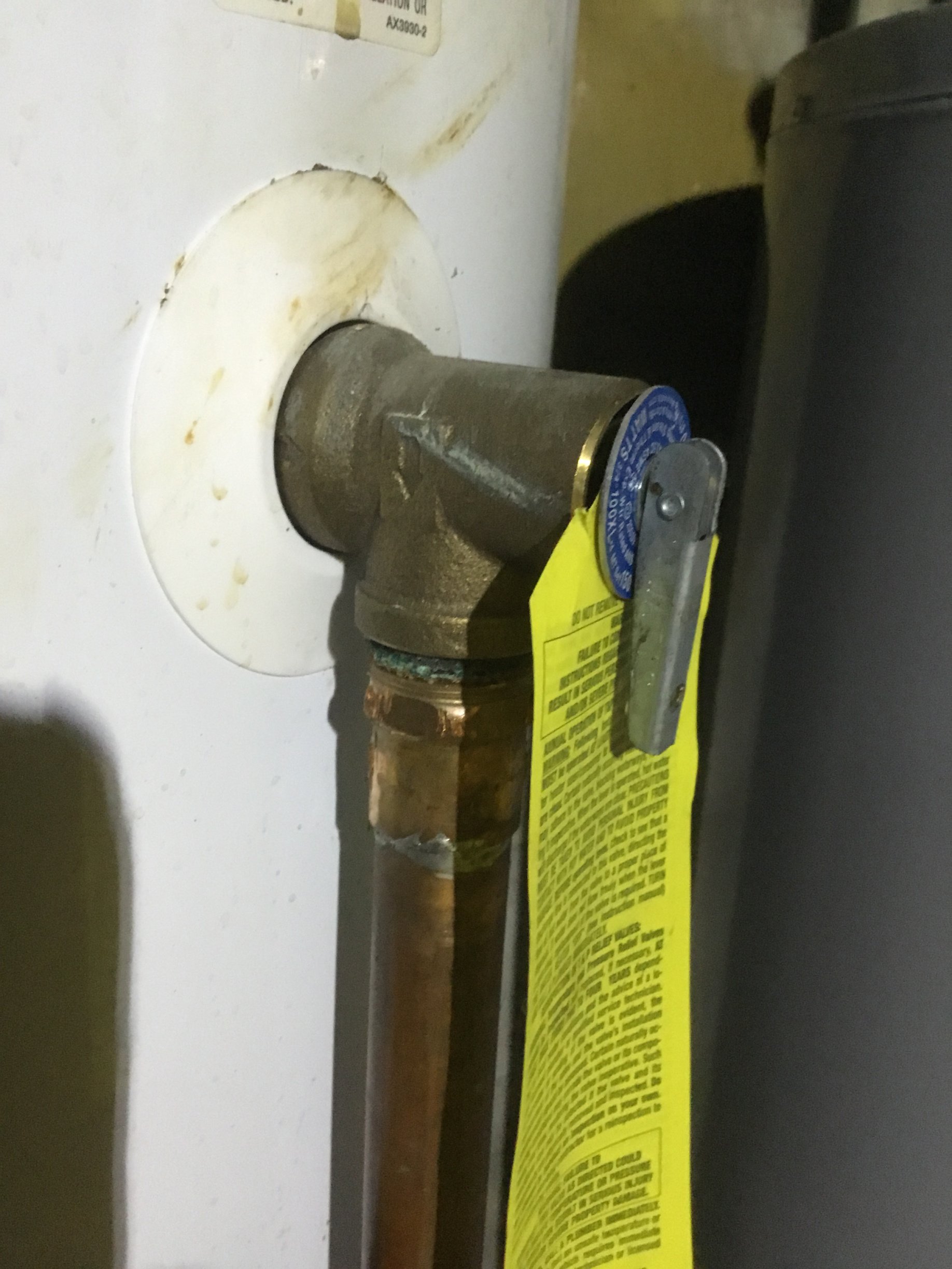

One of our units domestic hot water tanks is producing hot water fine, but occasionally it blows a couple gallons through its temp pressure relief valve then returns to normal mode with no dripping. Occasionally means no leaking for a week or two, then next trip to the basement shows a couple gallons purged into collection pan.
Is it reasonable that this could be a fault in TPR valve, so screw on replacement would be sufficient until we finally need to replace whole water tank? I will attach a couple pics but can take more.

    A T&P valve doesn't usually seep or discharge unless temperature or pressure has exceeded the limits.

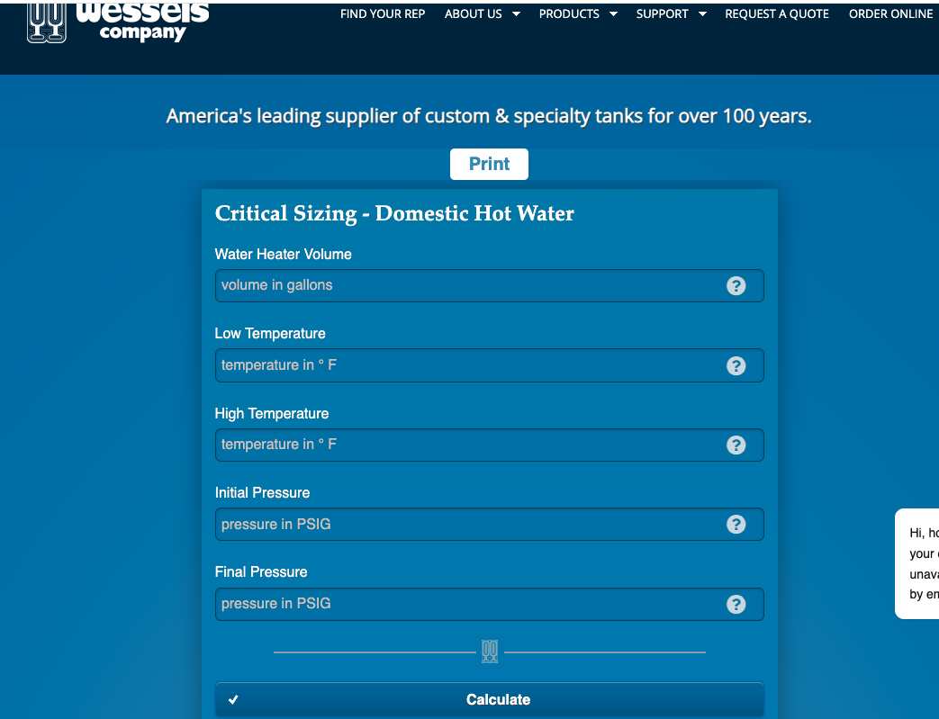

    If there is a back flow device on the main line to the building, no BFD in individual units, in the units, then the expansion tank needs to be sized to accomodate all the expansion. Add up the total water heat tank volume.
    Here is a tank sizer
    https://www.westank.com/calculator/

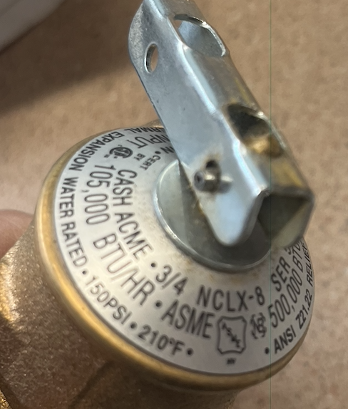

    Two conditions that cause the valve to discharge, temperature over 210°F, or pressure over 150psi.
    They start to seep at the 150 psi, full discharge as pressure keeps rising.
    Sometimes if the discharge on temperature, over 212°F they may not reset.
    There is also a BTU/ hr rating, this is how much the valve can discharge, Of course that number needs to be higher that the water heaters input, more of a concern with commercial sized WHs.

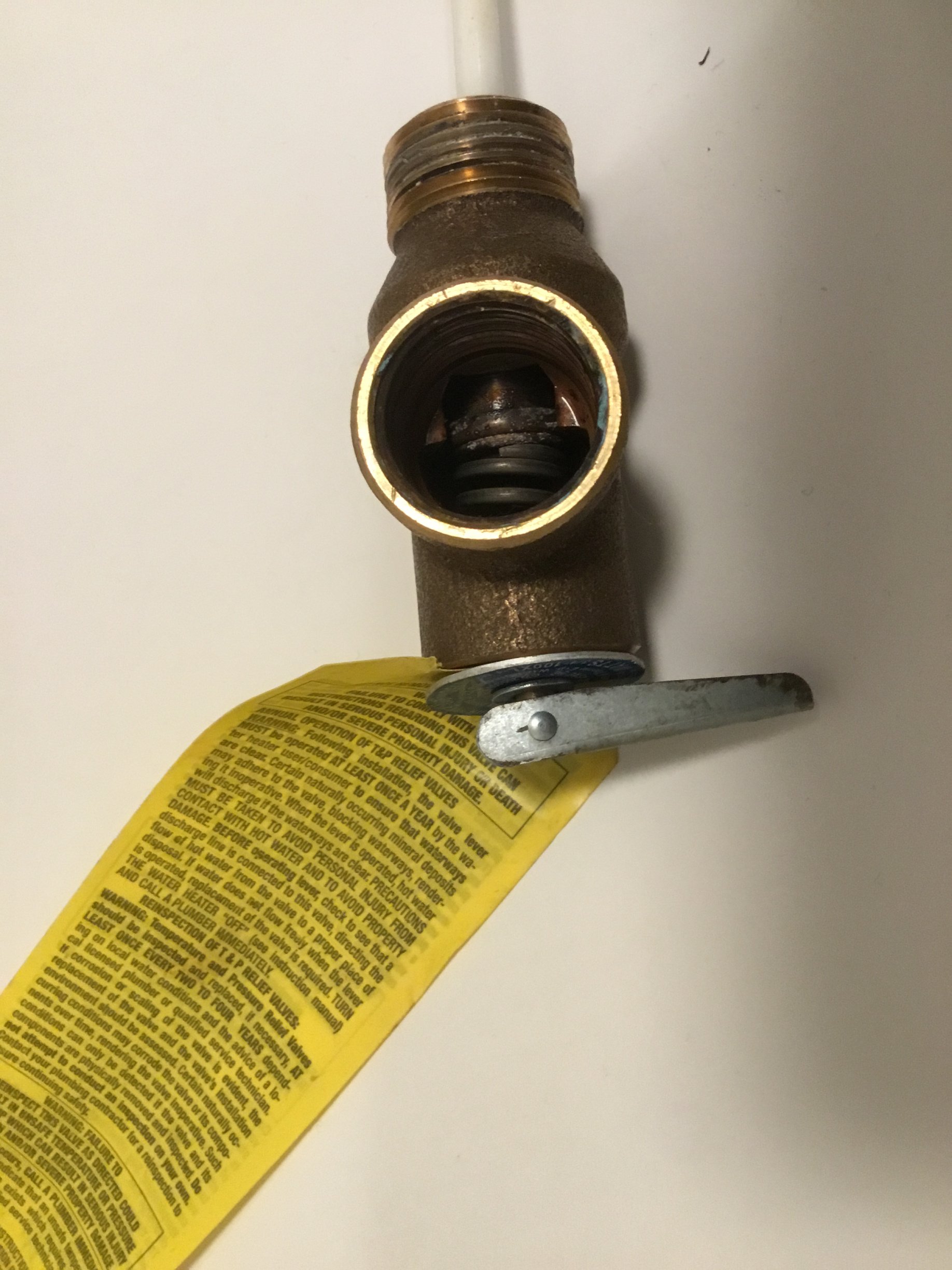

    Hi, Residential relief valves don't cost all that much, so I'd replace it. I have tested many thousands of these and about 1/4 of the valves fail the test in some way. Of those one in ten was plugged, so the valve could not work. It's risky to not check them!

    my experience is T&P failures are most often failure to release. Plugged, disc stuck closed.
    Rare to see one discharge at a lower pressure than indicated.
    Not much intelligence inside, a spring, washer and thermal element.
    More often than not when you test them they fail to reseat.
    It is one of the least expensive but most critical safety valve on a plumbing system. Most pros just replace them on an inspection.

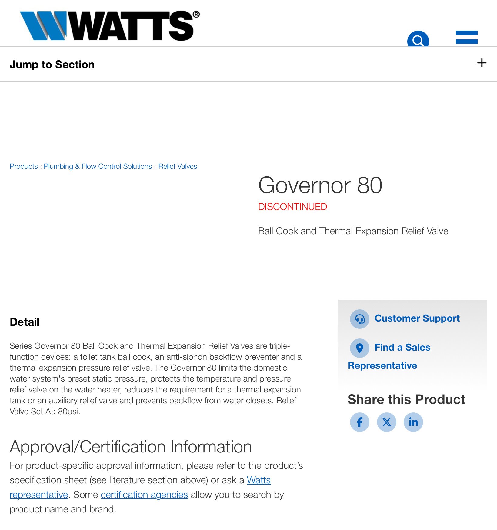

    The plumbing code states a thermal expansion device is required, it doesn’t have to be an expansion tank, other options are available. Either absorb it in a tank,or discharge it somewhere safe, but that could be a huge water waste!
    Watts used to make a “governor 80” ballcock for toilets that had a pressure relief function. It dumped flow down the overflow tube as a thermal expansion device. You can still find them for sale, e bay occasionally, but production has been discontinued.”

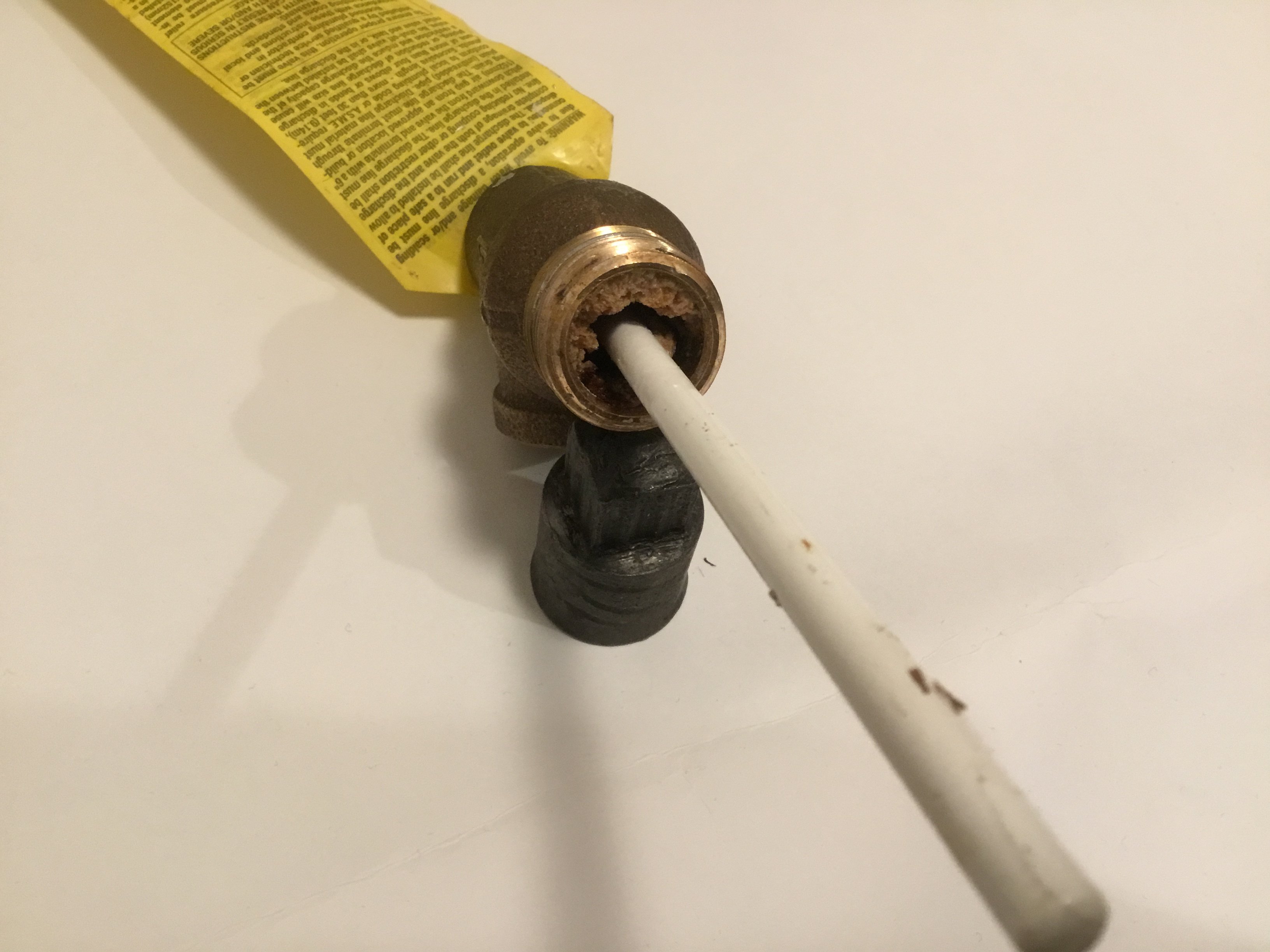

    Anyway, I bought a replacement TPR valve at HomeDepot because Lowe’s doesn’t seem to keep them in stock. I don’t know how retailers can keep Amazon at bay if they don’t stock a common part like this.
    Here is the one I removed, dated 2008, so 17 years not 20. Crud visible, but no obvious reason for it to be leaking on its own. Still strange. At least the new one is not actively leaking, but need to watch the new one for eventual leaks, and hook up the pressure gauge when it arrives.

    Do you know for sure that the pressure in the expansion tank was checked? It might not be set for the correct pressure needed for your system. Also, I have had new bladder tanks where the bladder was stuck to the side of the tank, and therefore not working. One way you can possibly check that is to close the feed valve to the water heater and open a hot faucet. If you have good pressure for a few seconds, and then it just dies, then the tank is probably fine.
