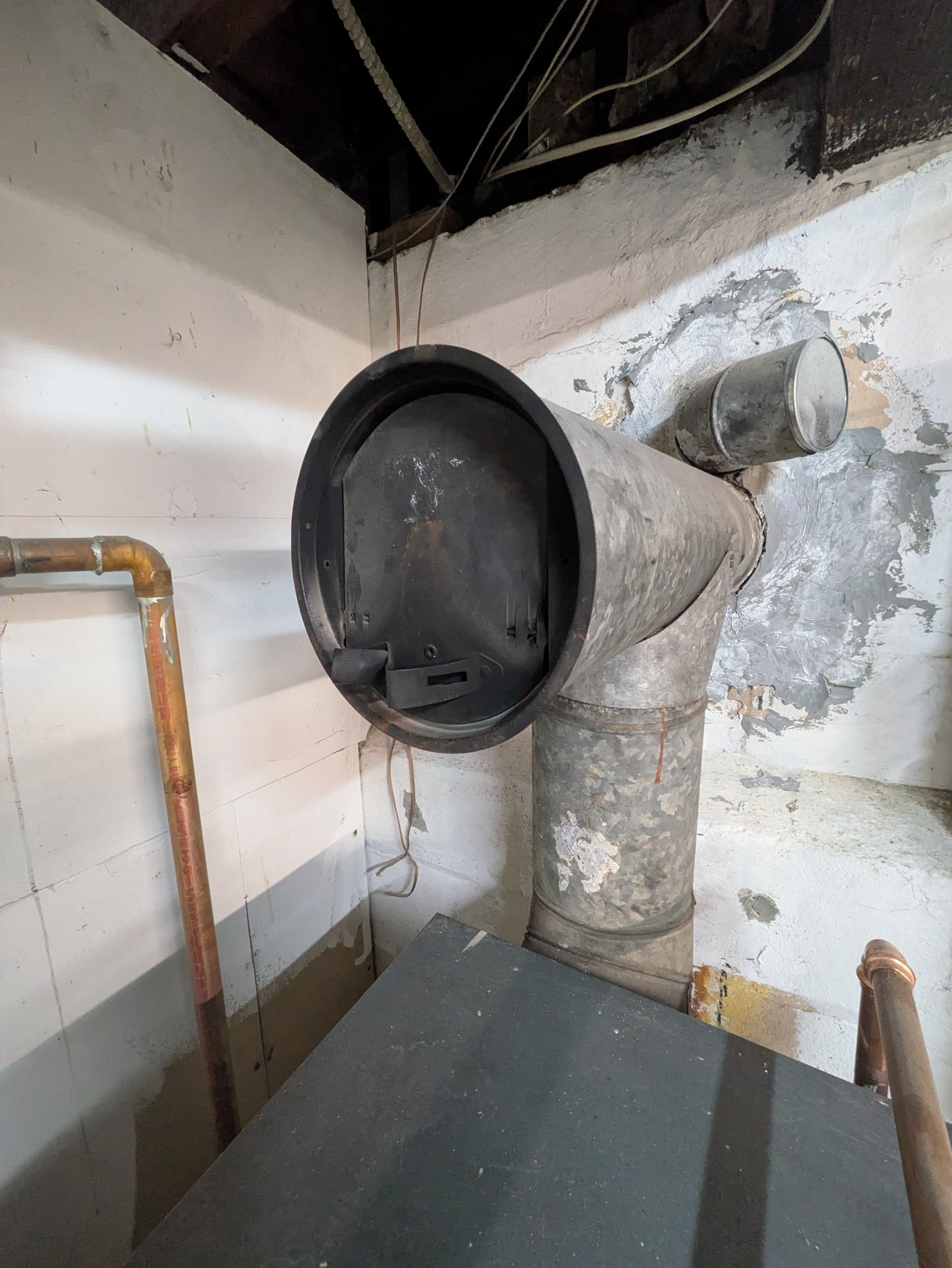

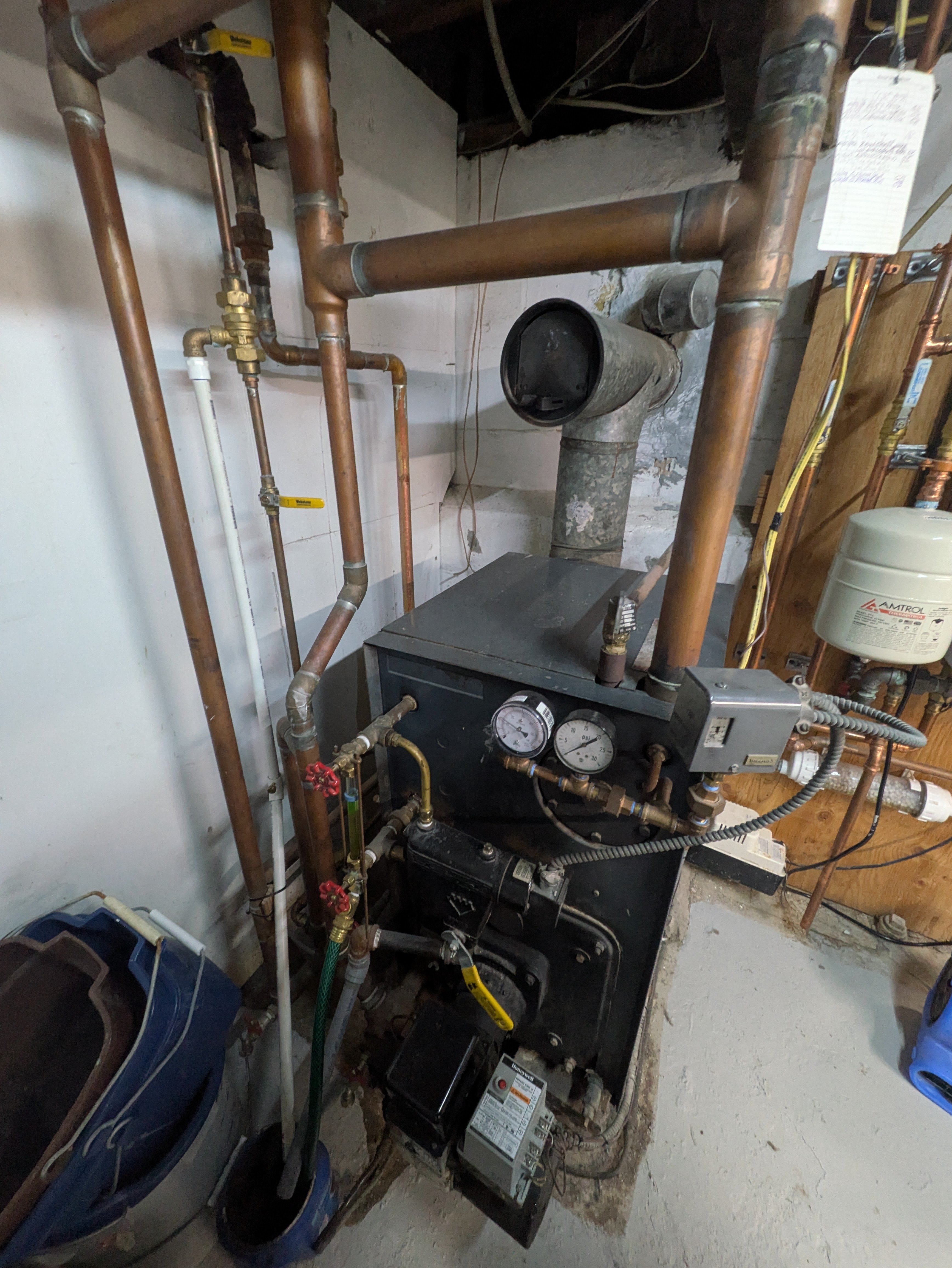

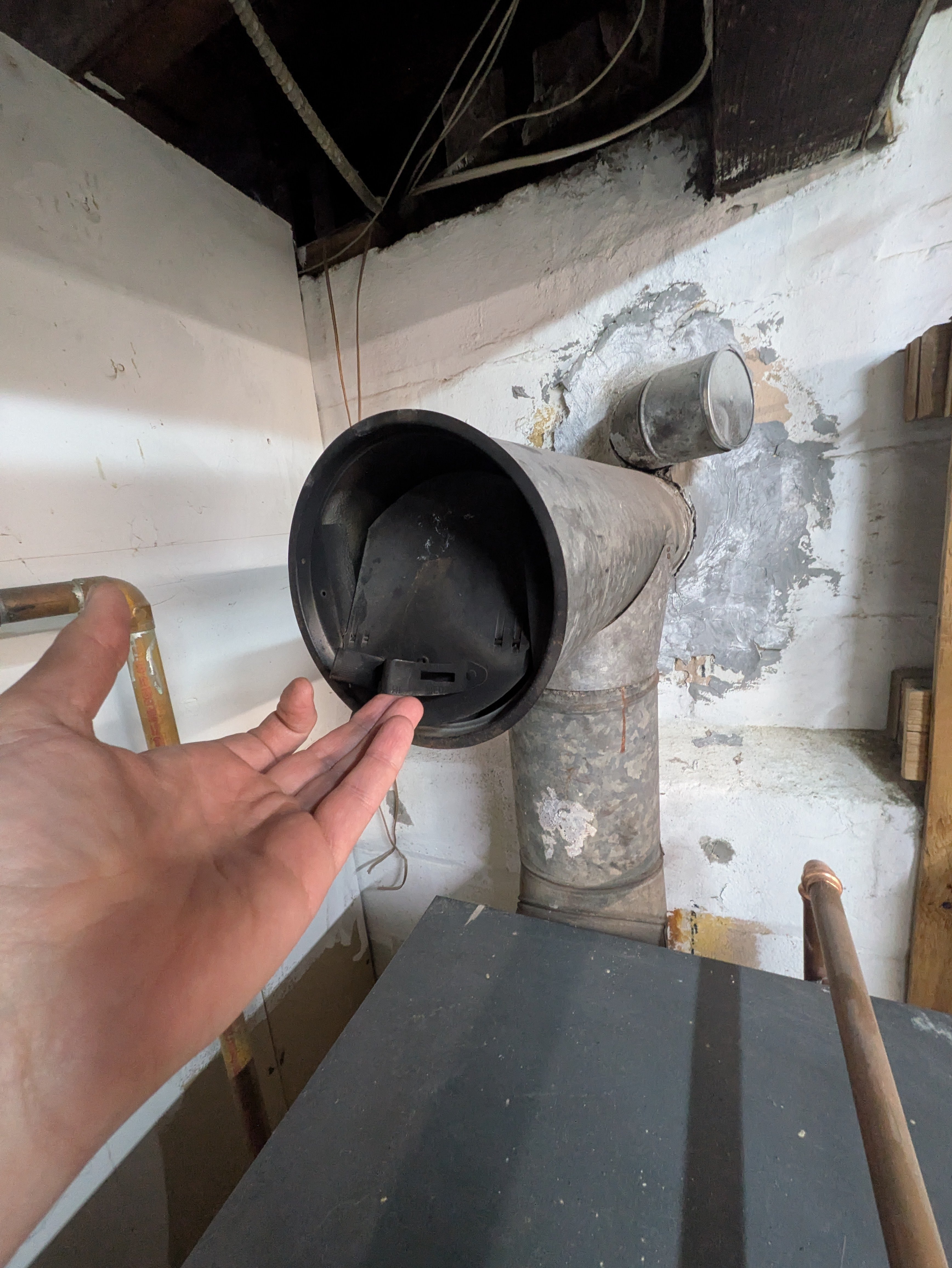

Residential one pipe steam fuel oil Weil McClain boiler installed ca 1974. I've owned the house since 2005 so have been caretaking this system for 20 years and eking a year of life at a time from this old timer. Y'all have been incredibly helpful over the years. Thanks again.
This time I'm asking about my draft regulator or draft control (not sure which I have or is they're synonymous). The flapper is hinged toward the bottom of the unit. Chimney is straight up in a two floor house plus basement about 30 feet. Only discharge into chimney is this boiler. 7" diameter. One of the hinge pins on the flapper works loose about twice a season and jams the flapper to a fixed position--often closed but sometimes open. I'm tired of checking and jiggling the pin back into place. What do I replace it with? Or do you have a better idea than replacing?
I found Field Controls offers a top hinged draft regulator available on supply house and they offer a bottom home draft control. Are either of these the right unit? If not what am I looking for?

    Jamie Hall Member Posts: 27,239
    either one will work
    EBEBRATT-Ed Member Posts: 20,085
    edited December 2025
    Either will work but I think the RC is easier to adjust and is used on oil more often. The face of the draft control should be Plumb and the gate should be horizontal

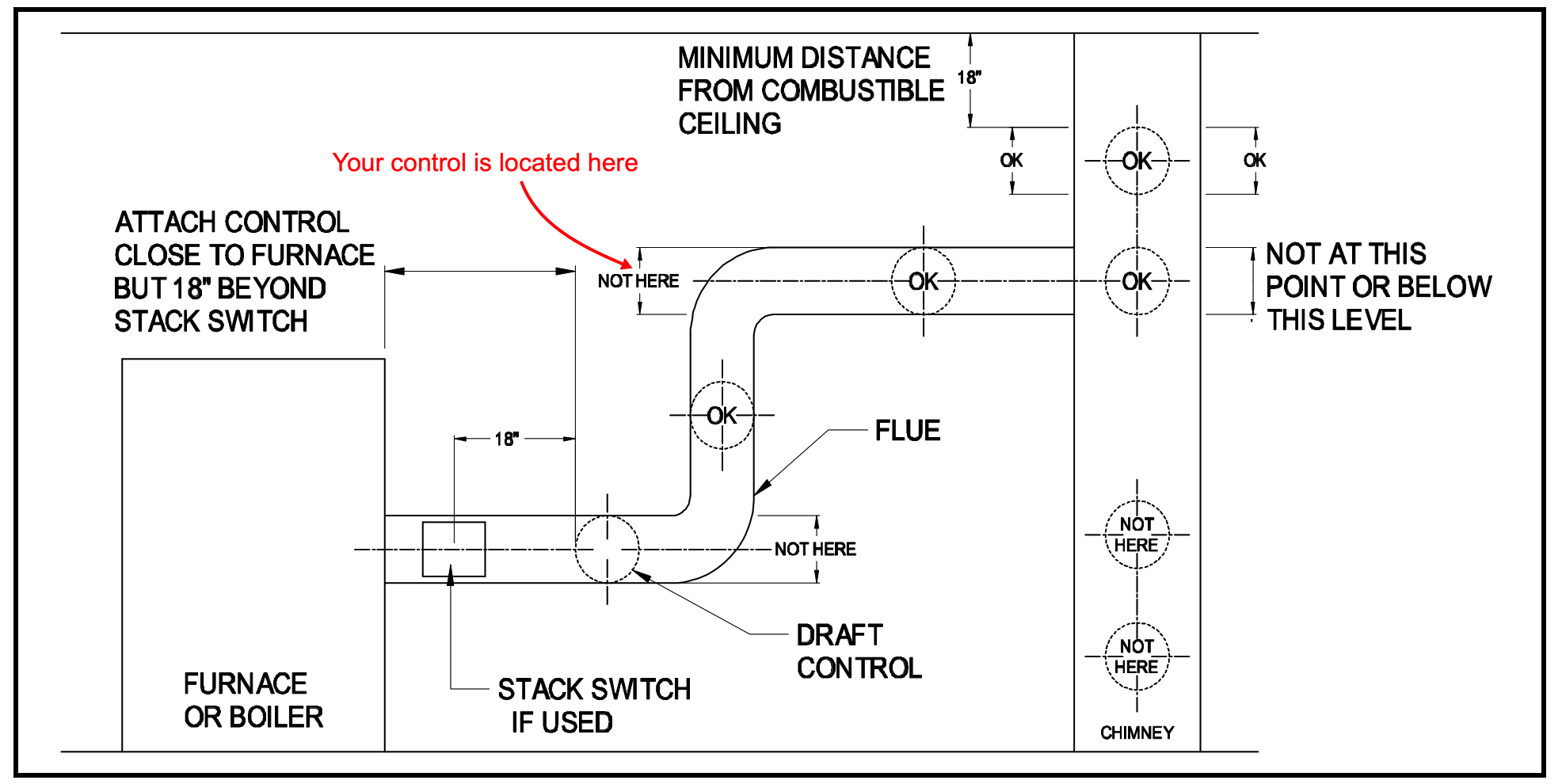

    Actually that existing draft regulator is in the wrong location.  You should probably replace all the sheet metal vent connector pipe (smoke pipe) and install the draft regulator properly.
    After collaborating with some of the world's foremost experts in the study of combustion, the highest self proclaimed authority in the land,  and an intensive discussion about the proper ways to install barometric draft control devices in all different types of fossil fuel burning appliances I have learned that the manufacturer may not always be absolutely correct when detailing the DOs and DON’Ts of their product in actual field applications.  This has led me to retract my original recommendation to redesign the flue pipe connector.  Your barometric damper’s location is an acceptable location.  The following illustration from Field controls has Five “Not Here” locations indicated.  Four of those locations are not considered to be a proper location.  The one that I have indicated with a red arrow IS an acceptable location.  There is no need to change your vent connector.

    Nothing wrong with the present location. Have been doing that on oil and gas equipment for over 35 years. All of my customers test and verify operation with combustion analyzers and draft gauges.

    I have noticed many barometric draft controls installed the way also. The question I have is: why would Field Controls and other manufacturers specify that as a wrong location? Do you know something that the folks that make the item don't know? ( a kinder response might be to just say yes) Could it possibly be that the barometric is less accurate when placed there? Have you ever placed a draft manometer in the over fire position and watched the over fire draft under different drafting conditions when in that position versus the recommended position? I know that I have not since the time it would take was not available when on a job site to monitor that type of test.
    So I just take the manufacturer's recommendation since they have the time and laboratory to do such testing.  I would hope they know better. But that is not always the case as Honeywell and other manufacturers have proven in the past.  I am not doubting your expertise on this subject.  I know that you and @bobharper are the go to guys for this info and would like to know if I was wasting my time all those years when I could have used that Tee configuration many times , but took the time to incorrectly “Do It Right” by the manufacturer’s I/O sheet.

    From what I know I thought that location is incorrect for oil but may be ok for gas. Some conflicting information from
    Field.
    See the attached

    Sorry I didn't see the Field Controls catalog. Barometrics can never face toward the flow. So all the wrongs are correct except one and the is the O position. Did that in our field test with AGA.

    Wow! A lively little discussion here amongst some people I highly respect. Ok, before I discuss the baro. allow me my usual diatribe on the chimbley and chimney connector (vent connectors connect to vents/ chimney connectors connect to chimneys regardless of fuel). This is overdue for a level II inspection. All those years of oil burning will have rotted this chimney from the inside-out. The mortar and brick will be infused with soluble salts formed from the acids reacting with the lime in the mortar. If the chimney proper is sound enough, install a listed liner sized to the boiler. Use a smooth-wall type 316ss liner. It does not need to be insulated- it will be air insulated. It will contain the condensate, heat up quickly and contain the CO, CO2, water vapor, and stack heat.
    The connector is old and rotten on the inside. It is not supported. As for the layout, straight beats curves and up beats down or flat. Go up as soon as you can, get as much vertical rise possible before turning horizontal, then slope up to the chimney. 3 screws min. per joint, no screws or seams btw 5-7 O'clock, pitched up, supported.
    The Field Controls RC is the most popular for oil that I see. You want the baro. at least 1.5 duct diameters downstream of the appliance connection, stack control, stack safety switch, or confluence of other common vented appliances and any offsets or tees. In other words, look for the best straight away closest to the appliance if possible. The other locations will work. The locations amount to minor degrees of response to pressure changes. My #1 thing with baros. is if I see soot in the gate or not, and if so, just burping in the gateway to the Combustion Appliance Zone (CAZ) or the gateway into the flue. Soot in the CAZ gateway is bad. That constitutes prima facie evidence of backdrafting. Soot in the intake gateway that should be air-washed clean is worser (technical term) meaning there has been a very powerful, sustained backdraft. If youz have a backdraft/ depressurization condition, fix that before waking up dead or playing with this mess further.
    Ok, let's ASSume you have a peachy chimney, all guten tite. You have resolved any CAZ depressurization issues so there's sufficient MakeUp Air(MUA). Anywhere you attach a baro. you need a tee. A tee introduces cold CAZ air into the hot stack. This creates a flow restriction due to the turbulence. A better approach would be to use a siamese (erroneously referred to as a 'wye' fitting). Think of an entrance ramp onto the highway versus a side entrance road at a right angle. If you use a bullhead tee, the stack gases collide with the far wall of the tee then look for directional arrows to determine which way to go. Seeing everyone else going up the stack, the mixed air/ stack gases begin sorting out who goes next, take turns and merge into the main flow. If the other direction is enticing you may get some errant flow bass-ackwards out the baro. IF there is a CAZ issue predisposing it the flowing in reverse. If the leg of the tee btw the baro. and the confluence of air and stack gases (Times Square) or intersection of the tee and snout/ bull, is short, it will assist spilling the errant burp of stack gases. Having a few inches of extension can help contain stack gases recirculate back into the intended flow direction.
    If you want to prevent spillage or backdraft, use low sulphur oil, set up and fire the burner properly, You don't just want the proper draft pressure setting as a snapshot- you want a stable draft. That's what a properly set up baro. does. If you are finding yourself closing or sealing a baro. to force enough draft pressure, fix the chimney and CAZ and the appliance will work. Hot, stinky stuff wants to rise up once you remove the local hindrances thereof (Count Rumford, 1795 paraphrased). I always envisioned a kazoo or party whistle on a bullhead tee as a backdraft indicator. Perhaps a spill switch would be more effective…
