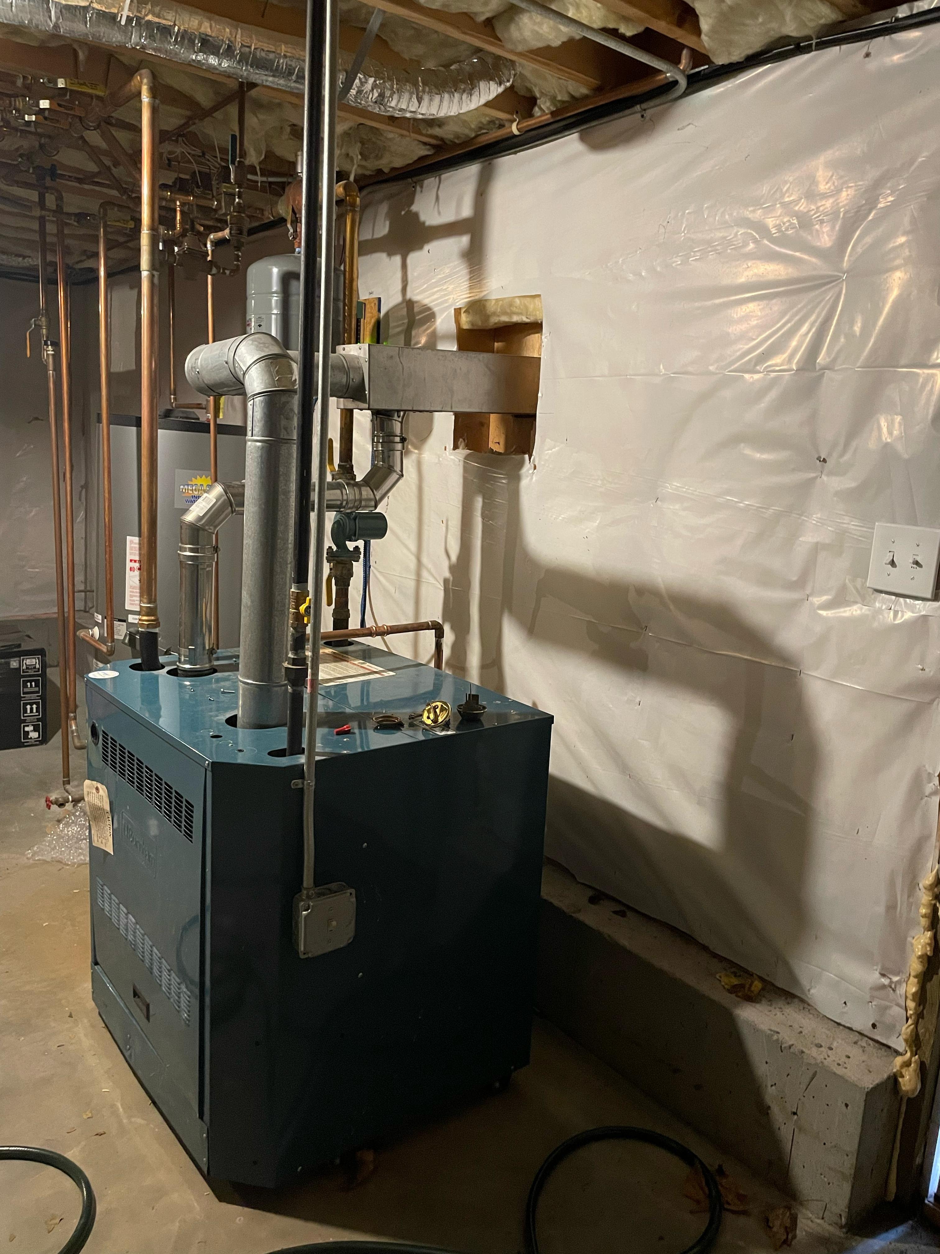

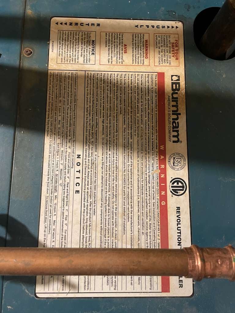

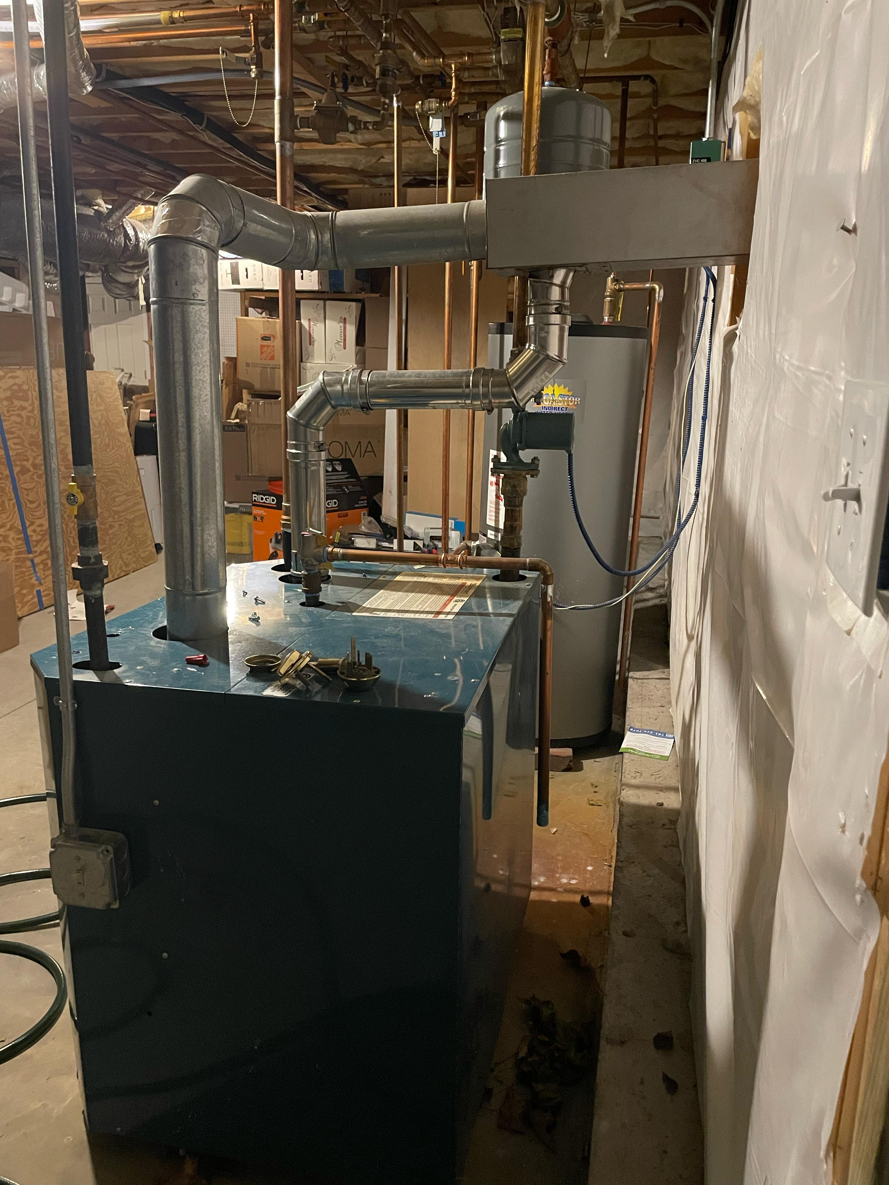

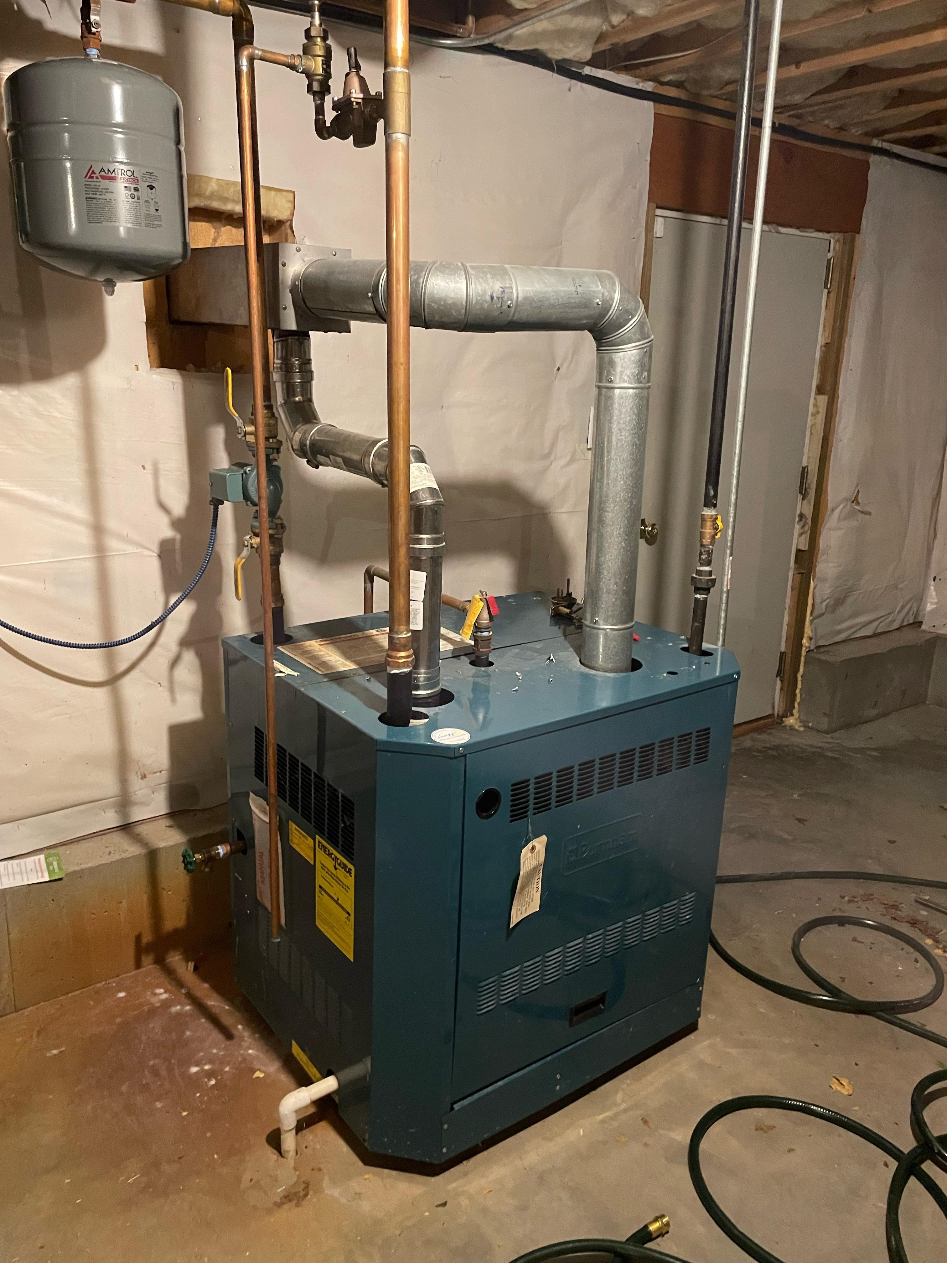

I have a Burnham Revolution Gas Boiler and I'm at my wit's end as to how to get the house warm. It's an old boiler (about 24 years old). We are located in Massachusetts (cold weather) and bought the house earlier this year and immediately did some renovations before moving in. In the early days of the renovation (Dec/Jan timeframe), every time I visited, the house was very hot (the workers used it quite a bit). By mid-January, it had stopped heating up and I had a plumber look into it. We moved in in March and it was better but the weather wasn't too cold either.
The house is about 3000 sq ft (400 sq ft in finished basement, 1500 first floor, 1200 second floor). Now that the cold is back, the boiler can't keep up. When it's below 20F outside, the rooms can't get above 63F.
The boiler has 5 zones (1 basement, 1 first floor, 1 upstairs and 1 master bedroom upstairs and an indirect hot water tank). There is 1 TACO cast iron circulator pump, 1 TACO 6 zone valve controller, and I have 5 TACO zone valves. The thermostats are fine and the relay calling for heat lights up when the thermostats call for heat. The boiler temperature gauge typically heats up to 220F anf the pressure gauge still gets to between 20F and 25F. The supply pipe on the boiler seems to get hot (although it never feels scalding and can leave my hands on it for about a minute). However, the baseboard radiator pipes don't get as hot (feel warm at best) and the air coming out doesn't feel hot. Even my basement with its smaller sq footage and proximity to boiler doesn't get hot.
I've had a few plumbers come to take a look but it's still not fixed. Things tried so far:
  1. Draining each zone: I drained each zone (except the water heater) for about 30 minutes and it made no difference
  2. Replaced circulator pump: One of the plumbers did this and no difference
  3. Replaced Air Vent Valve: Mine had leaked so another plumber did this but also made no difference
I'd have thought it'd make sense to replace the boiler at this point but it seems to be working fine i.e. supply pipes are getting hot. The plumbers I've used don't have answers. Would appreciate any guidance here please.

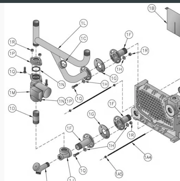

    that is an unusual boiler and it has a pumped bypass inside. Could be that pump has failed
    Down load the manual and go through the troubleshooting steps

    here is what they look like under the hood and there were a few different versions of the beast.
    Manual attached below
    https://bostonheatingsupply.com/Burnham/Burnham%20Revolution%20I%26O%20Manual.pdf

    Based on the manual that Hot Rod (Bob) linked it appears there is some sort of factory bypass. Like others mentioned, maybe there are two circulators? Maybe the system circulator is fine and the boiler bypass circulator (Taco 007 as per the diagram) has failed?

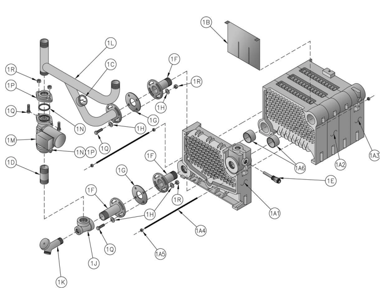

    That boiler has both an internal bypass circulator and an electronic injection controller that operates it. Either can fail and cause the symptoms you have noted, and since they are inside the boiler cabinet the failure is not obvious to those not familiar with that particular model.
    This happened in a building where I lived in Boston. The boiler techs were mystified until I told them about the extra pump and controller, after which they were able to fix it.

    if the internal circ is not running, or the control for it is bad, it will not flow properly. It’s a simple fix.

    the circ inside the boiler needs to be a non ECM type
    It has a tekmar variable speed control operating it, so only the old style PSC pump will work
    Grundfos 15-58, 007, Wilo Star 21, etc
    In a bind you could jut wire a cord to the pump inside the boiler and let it run until you troubleshoot the control

    Yes the way the installed that circ inside on rigid pipe makes it a job to get out and a new one and new gaskets in.
    I would have just swapped out the powerhead with the allen bolts, leave the old body in if you had an exact replacement.
    The Revolution was Burnham's answer to the very popular Weil GV series, but it was a beast of a boiler to install, had a one off control system, had a weird factory vent termination, and I think some came with Honeywell Smart valves which added insult to injury.

    I hard wired the pump for now and that resolved the issues. I've also ordered a new control board and would replace it once that arrives.
    I have a new issue though unfortunately. My house has 4 zones (excluding the hot water zone). 3 of the 4 zones get very hot (touching the pipe from the taco zone valve for a second is scalding). However, the upstairs zone valve pipe gets very hot but not scalding. Because it's upstairs, the baseboard heater never actually gets hot.
    I've replaced the taco valve head but that didn't make any difference. I've also manually opened the valve but no difference either. I'm beginning to think there might be something wrong with the zone valve.
    Any thing else I can try to single out the issue? Thanks

    Did you introduce air in the system with the work you did? Must have if you changed the circulator? Did you do a thorough purge? Air tends to get stuck on the highest part of the system.
  • yoyotogblo
    yoyotogblo Member Posts: 26
    I haven't purged since replacing the circulator pump. Let me do that now then. Thanks
  • yoyotogblo
    Yeah, just started purging the upstairs zone again and there's a ton of air (water barely coming out actually , mainly air) and the water is very dirty. Must have introduced a lot of air when I changed the circulator pumps. Going to purge all zones now.
