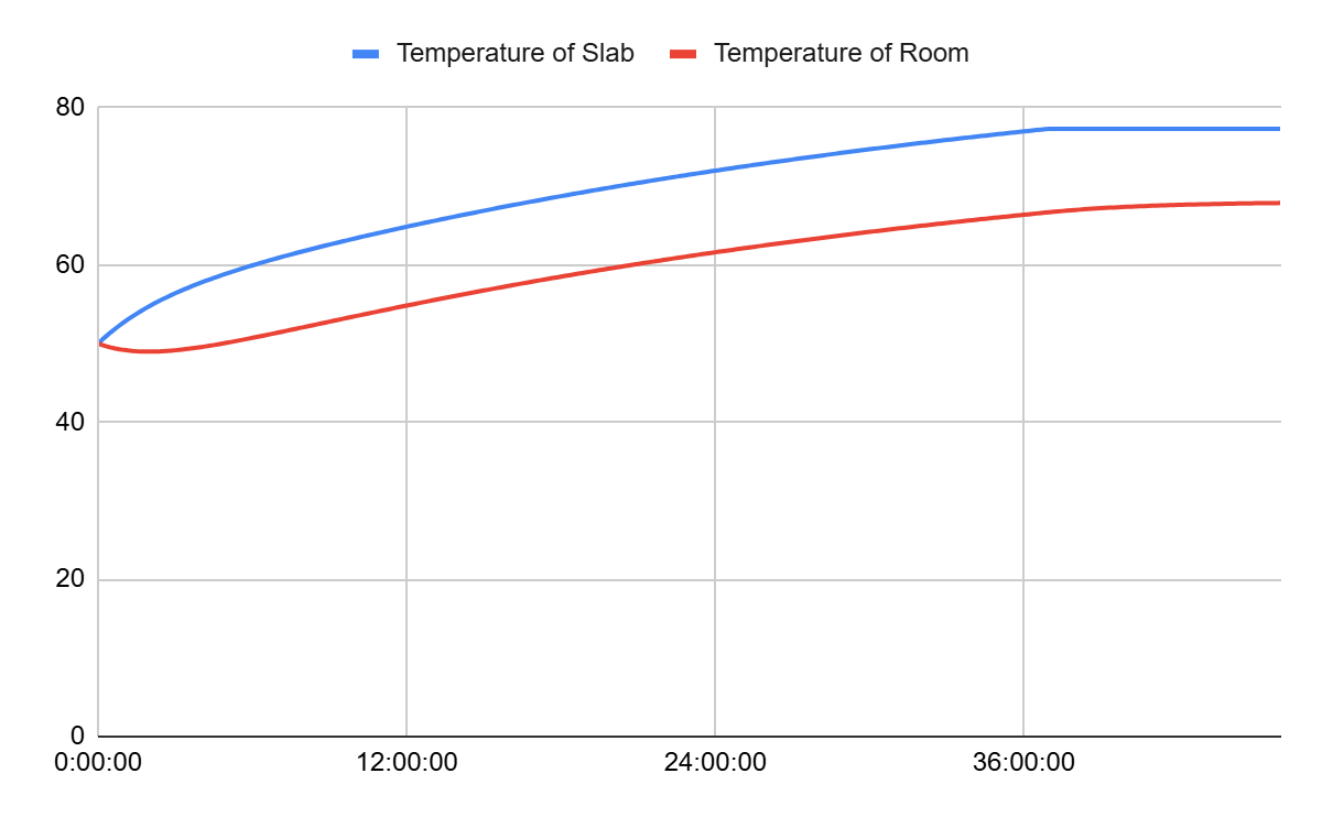

    Luckily I'm a hermit with no social life on a Saturday night, so I was able to make up a spreadsheet using the methodology I outlined a few posts ago. Here is the chart of slab temperature and room temperature vs time:
    Under these assumptions, it takes about 48 hours to get the room up to 68F from 50F.
    At 77.3F the slab is meeting the heating load at 68F, so once the slab hits that temperature I have it stop warming, as if there were a thermostat in the slab.
    You can see the spreadsheet at:
    https://docs.google.com/spreadsheets/d/1gMnJk1cb1Uu5sqHQaLTGZq7U2L-QWI-rOVC-gJxWy4g/edit?usp=sharing

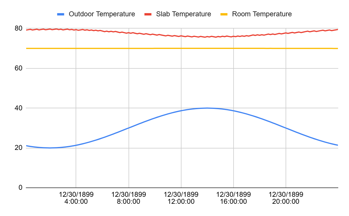

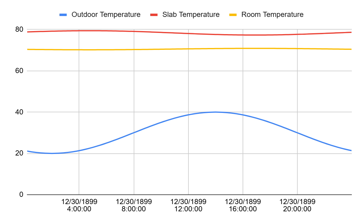

    OK, control strategy #2: slab thermostat.
    At each outdoor temperature, calculate the slab temperature needed to meet the heating load. If the slab temperature is above that, turn the boiler off, otherwise turn it on.
    This gave the best temperature stability, staying at 70.0 throughout the 24-hour period. Notice that the boiler cycles on and off a lot more than the air thermostat method, as evidenced by the jagginess of the slab temperature line.

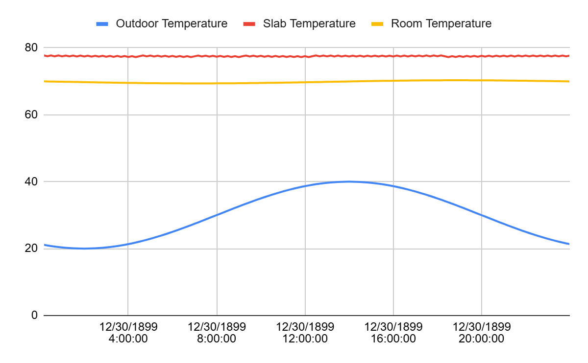

    OK, one more control strategy: keep the slab at a constant temperature.
    This is very simple, imagine an on/off thermostat in the slab, turn the boiler on if the temperature is below the set point, otherwise turn it off. I ended up with a setpoint of 77.5F just by plugging in numbers.
    This has the biggest range of any strategy yet, a minimum of 69.4F and a maximum of 70.3F. But it's still not that extreme.
    If you look at the jaggedness of the slab temperature line you can see that the boiler cycles frequently.

    Based on this analysis, it really seems to me that the best control strategy is the thermostat in the air, the other strategies don't seem to offer any advantage. Conceptually this strategy has the advantage that you're measuring the thing you actually care about, which is the temperature of the air in the room.
    With any of these strategies, if your heating load changes faster than the slab can change its output, you need to have some sort of supplemental heat that is more responsive.

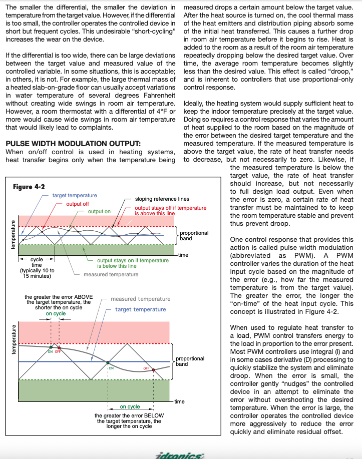

    hot_rod Member Posts: 27,492
    Thermostats like tekmar the use PWM or PID add some accuracy to the temperature control.

    You're going to get better temperature stability if you have a thermostat that can report gradations rather than just on/off. That's the special sauce of any heat pump with a modulating compressor, if you can run a compressor at a speed that exactly matches the load rather than cycling on and off it's going to be more efficient and deliver better comfort.
    But in addition to a modulating thermostat, you need an emitter that can vary its output and change rather quickly. Which brings us full circle to the beginning of this conversation, because the problem with slabs as emitters is that they can't change their output very quickly. Going back to the 1500 square foot slab with a boiler capable of delivering 45,000 BTU/hr to it, when that slab is at 77.5F and the room is at 70F it's delivering 22,500 BTU/hr to the room. If you run the boiler full out for ten minutes the slab temperature increases by 0.3F, which increases the output to 23,400 BTU/hr, an increase of 900 BTU/hr or 4%.
    On the other hand, if you have that same boiler feeding a hydronic coil in an air handler, the output will be zero when the fan speed is zero and the full capacity when the fan speed is at maximum. Simply by controlling the fan speed you can get any output between zero and full in a matter of seconds. So if you connect a variable speed fan to that modulating thermostat you can match the output to the load.
    Many people prefer the feel and quiet of radiant slab, so the ultimate in comfort is to have the slab to do what it does best, but also have the air handler for times when the heating load changes more quickly than the slab is capable of handling.

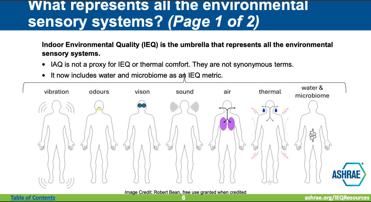

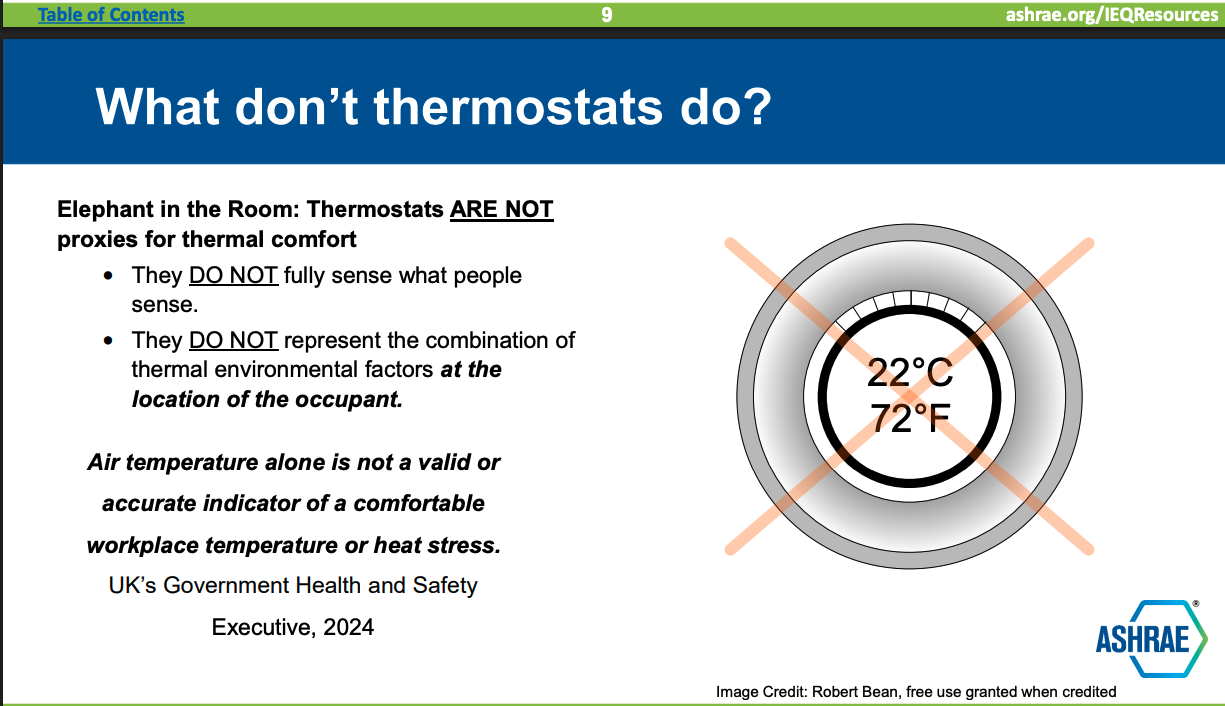

    At days end, the temperature is but a small part of comfort. Robert Bean offered this up for the group. Permission granted by owner.
    https://www.ashrae.org/file%20library/technical%20resources/ieq%20resources/thermal_comfort_ieq_resources.pdf
