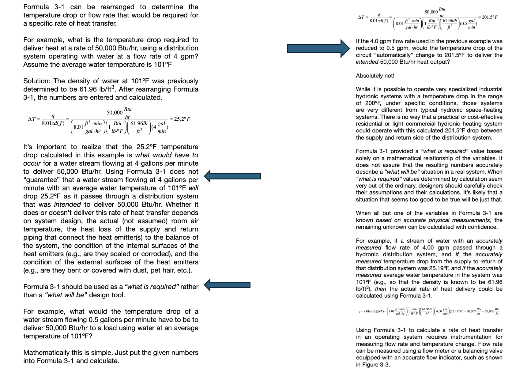

    The delta T on a system is a moving number. We choose a ∆ for a design but a system may never operate at the exact number. The delta varies based on the load of the space. In a cold room expect to see a wide delta on start up.
    As the room warms the ∆ will tighten up.
    The determine the actual operating delta the system needs to get to thermal equilibrium. This is the point where the supply and return temperature have stabilized. 10- 25° is a typical fin tube design ∆.
    Fin tube spec sheets usually show BTU output at two different flow rates. Slantfin shows a 1 and 4 gpm.
    Here are some graphic of how various ∆s effect the heat output of a strip of fin tube. As flow increased the ∆ closes up. That equates to a higher AWT average water temperature across the heat emitter, higher BTU output. For 3/4" fin tube, 4 gpm is about the max, without getting velocity noise.
    What is the temperature at the first fin tube on the loop? Two ways to increase heat output are to raise the supply temperature, or increase the flow rate.
    low flow: high ∆.png higher flow= lower ∆ more output.png

    hot_rod Member Posts: 27,073
    Conveniently leaving the "f" out of an example is always suspect :) Sounds like something a member of the alternate reality ∆T club would say:)
    No you cannot just raise the SWT and cause the ∆ in a loop to increase.
    The ∆ that a system operates under is driven directly by the load at any given point. Further the operating condition of the boiler is driven by the load on the system. You cannot force the delta to be what you want it to be with a basic fixed speed circulator.
    Archimedes allegedly said " give me a lever long enough and I can move the earth". Sounds good, could probably even put some numbers to it, but.
    While the universal hydronic formula can predict most any possibility, not all will be attainable.
    500 X 2 gpm X 5∆= 5000 btu/hr
    500 X .01 gpm X 1000∆= 5000 btu/hr
    Anyone care to build a working model of the .01 gpm flow example?

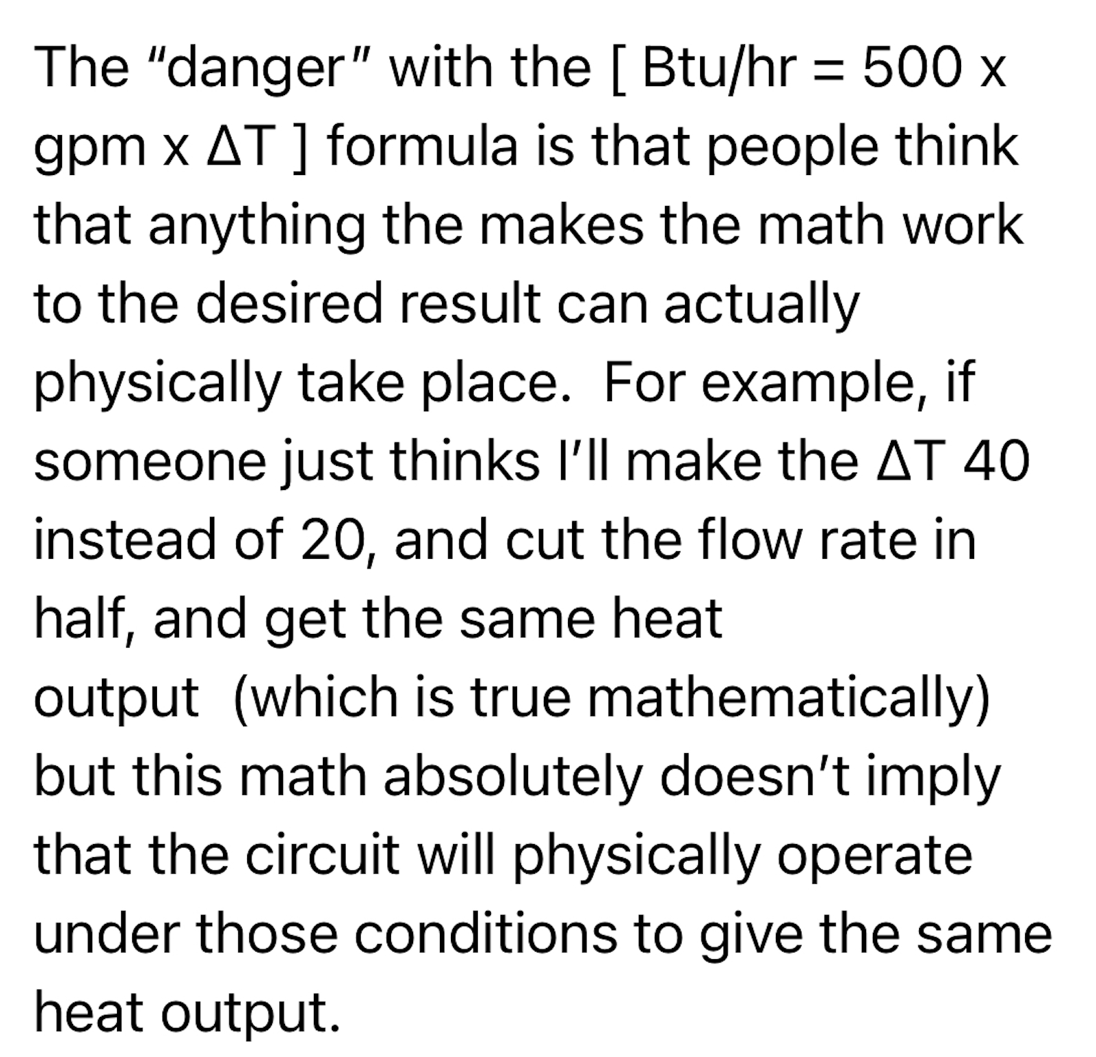

    A wise man told me
    The “danger” with the [ Btu/hr = 500 x gpm x ∆T ] formula is that people think that anything the makes the math work to the desired result can actually physically take place.  For example, if someone just thinks I’ll make the ∆T 40 instead of 20, and cut the flow rate in half, and get the same heat output  (which is true mathematically) but this math absolutely doesn’t imply that the circuit will physically operate under those conditions to give the same heat output.

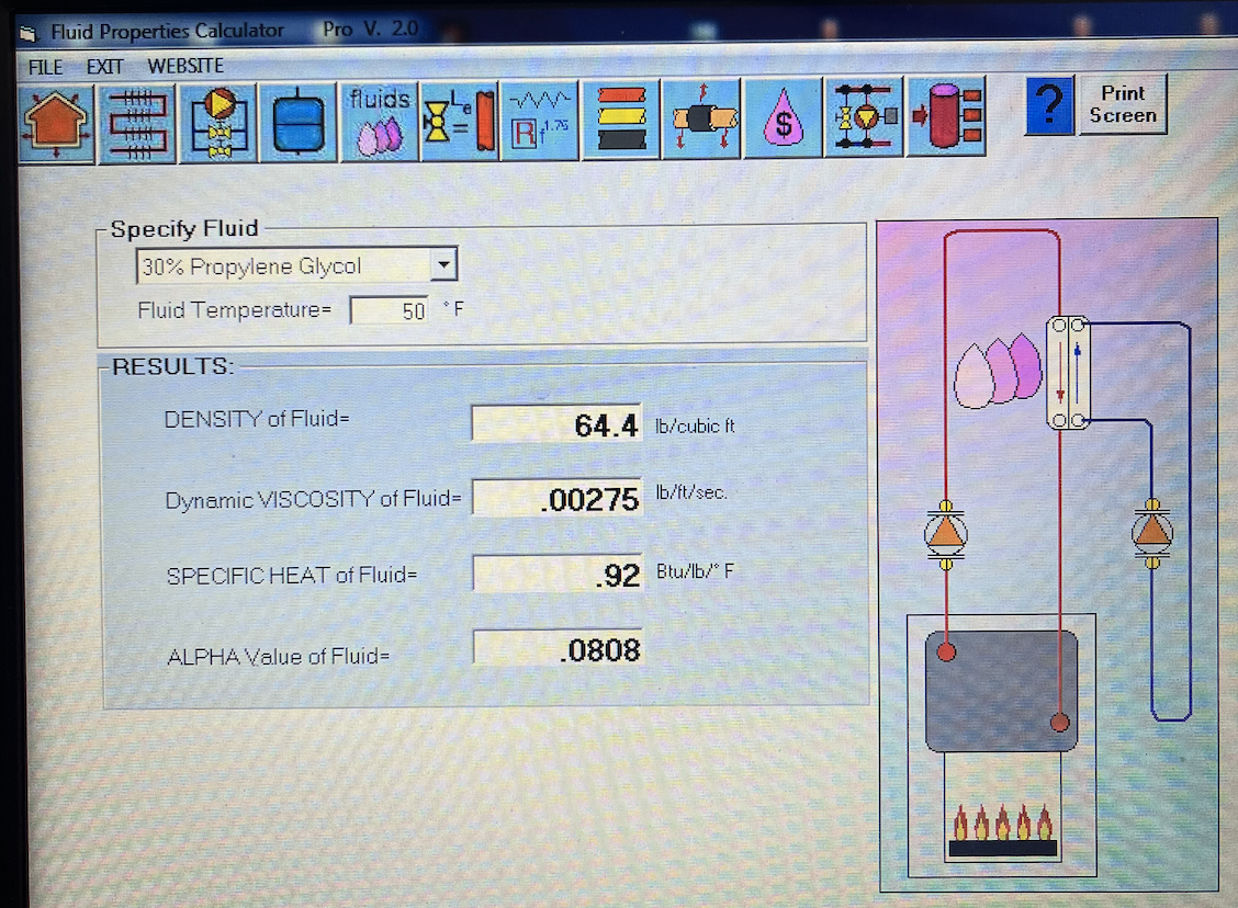

    477 for 30% PG glycol, and that changes a small amount based on the glycol temperature
    temperature of the glycol effects heat transfer and pumping capacity
    water 500 X 3 X 20= 30,000 btu/hr
    30% PG 477 x 3 X 20= 28,620 btu/hr
    The HDS software has a fluid calculator if you want to drill down to exact numbers.
    This is why very transient conditions exist until the system reaches equilibrium
