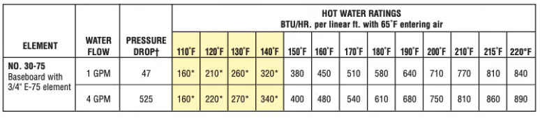

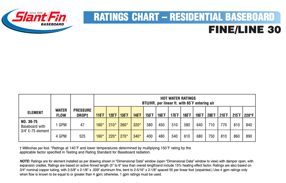

    Fin tube spec sheets usually show BTU output at two different flow rates. Slantfin shows a 1 and 4 gpm.

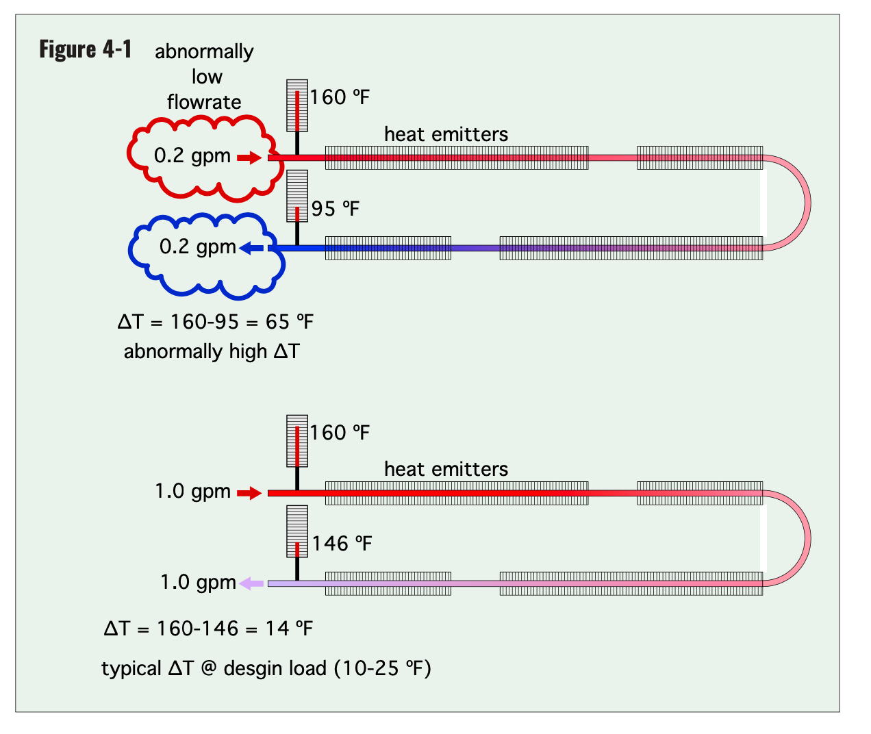

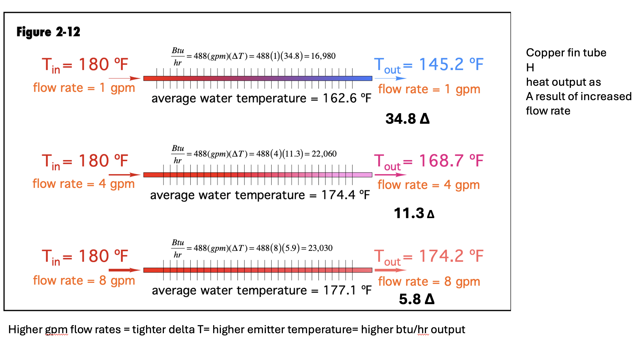

    Here are some graphic of how various ∆s effect the heat output of a strip of fin tube. As flow increased the ∆ closes up. That equates to a higher AWT average water temperature across the heat emitter, higher BTU output. For 3/4" fin tube, 4 gpm is about the max, without getting velocity noise.
    What is the temperature at the first fin tube on the loop? Two ways to increase heat output are to raise the supply temperature, or increase the flow rate.
    low flow: high ∆.png higher flow= lower ∆ more output.png

    hot_rod Posts: 28,705
    Various brands of residential fin tube will have similar out put. 150 SWT isn't giving you much BTU output. and that temperature drops along the series. Most fin tube designs are, were, based on 180 SWT

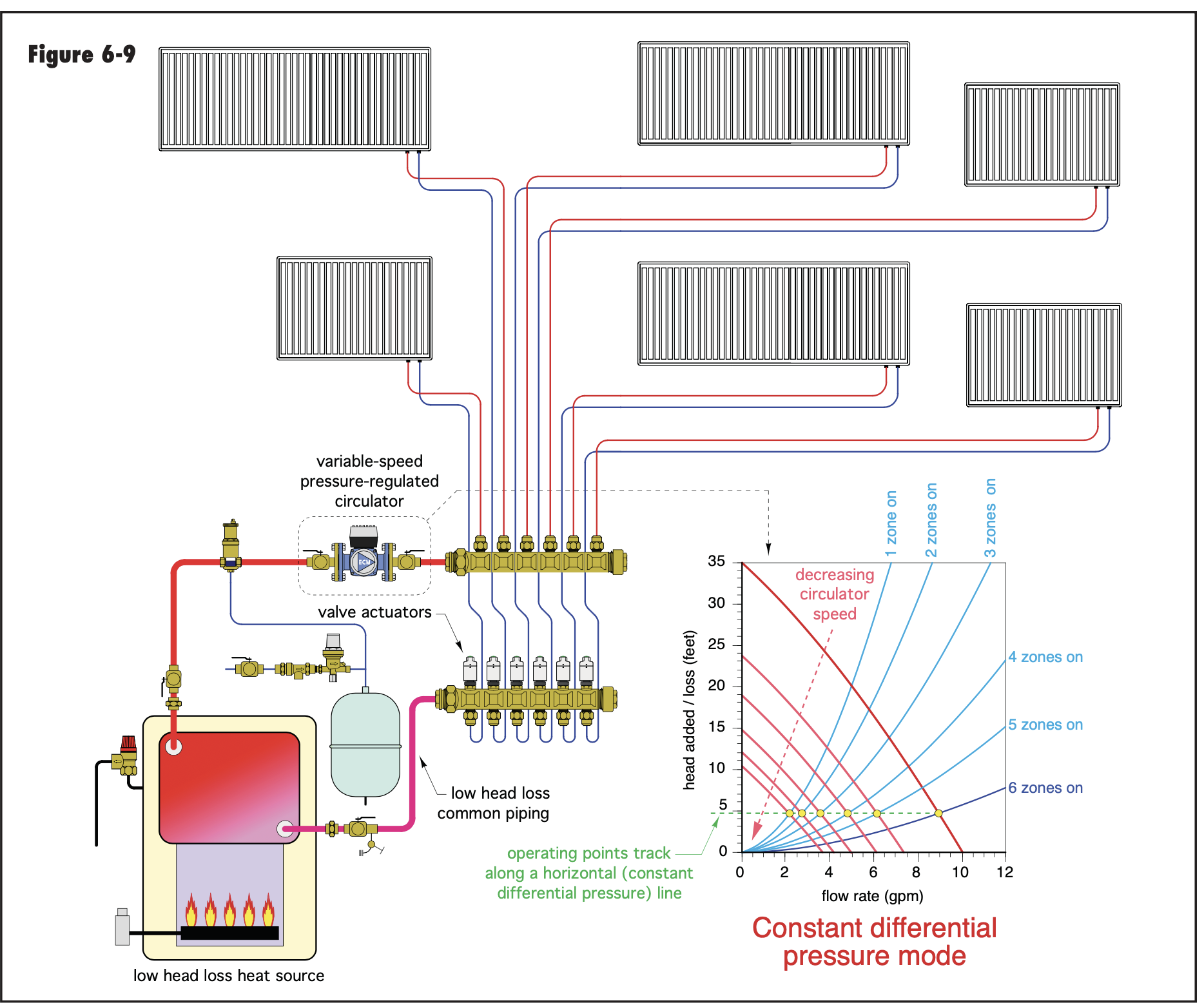

    The ∆P circulators that adjust flow do so based on zone valves opening and closing, so a multi-zoned system, is that what you have?
    It will not make any flow adjustments on a single loop circuit.
    Here is an example of how delta P circs looks/ works
  • bauer
    bauer Posts: 85
    yes, two zone system controlled by Taco zone valves
    If the pump is programmed properly you should see, hear it modulate as the valves open and close. Some pumps have a display that shows you the change in W or gpm.

    Flow is not your issue here, if the delta t is low, the flow is high and more than enough.
    It looks like you had a very deep setback of the air temp in the house and with the boiler only making 150F, the response time was slow. If your boiler is running with an outdoor reset controller, deep air temp setback is not what you want to do with the boiler operating at lower temps. you can do air setback, just not 15 degree setbacks.
    So what you experienced is normal for a not normal situation.
