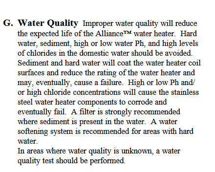

    Water quality is really important and should be mineral free.

    Scale is probably thru your whole sys, not just the Munchkin HX. The domestic water side of the indirect HX has probably scaling, too. You might want to descale inside the tank. Stop using well water in the heating sys. Distilled water buffered to about 8 PH would be more preferable in the heating sys. The only thing that may help the domestic water supply is a water softener or maybe one of those electronic descaler. Hard water is hard on everything.
