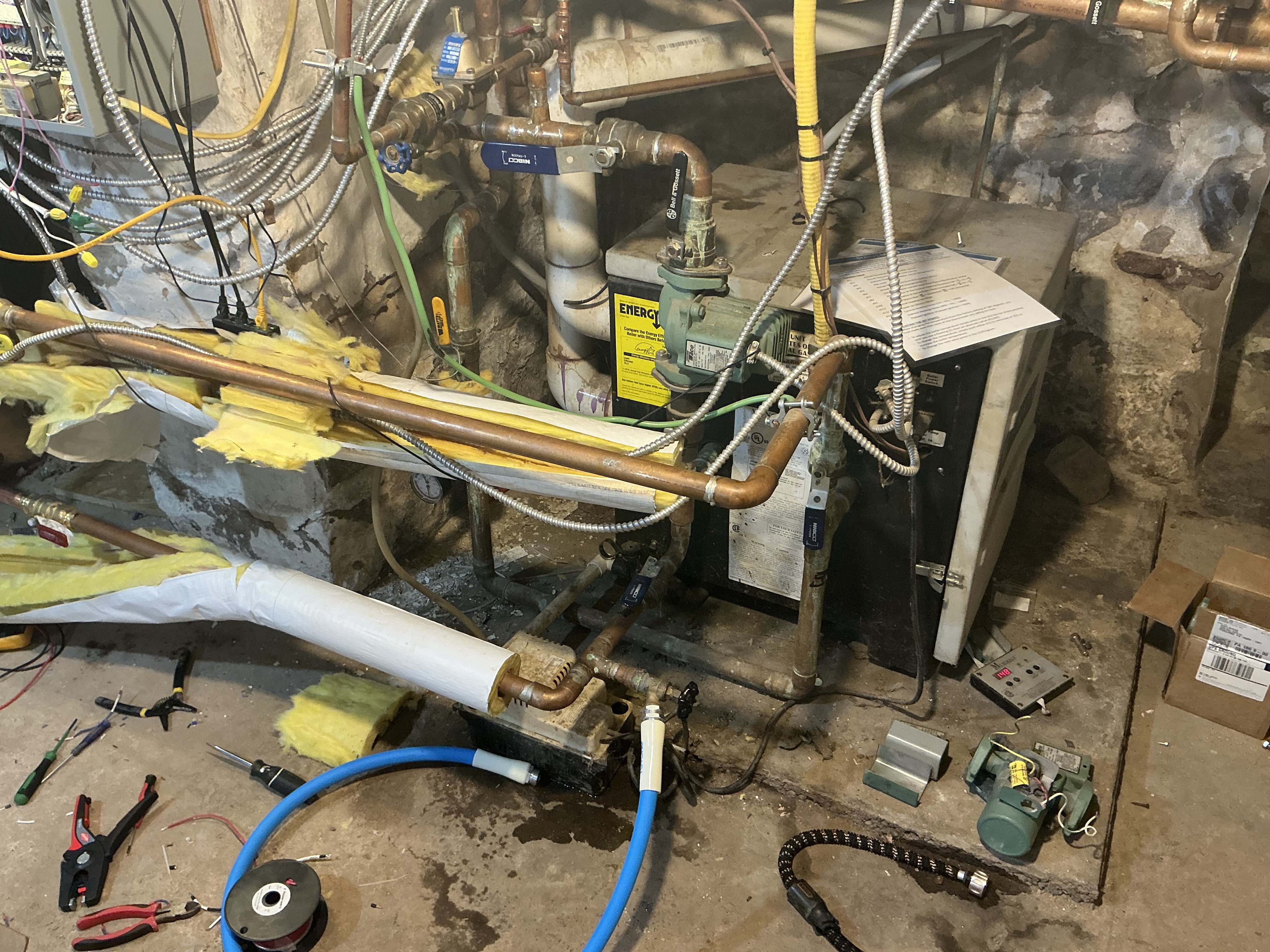

    i know i’m late to respond but i’ve been doing tests and replacing pumps. I have a taco 015 on high running and used purge valve to confirm i’m getting at least 8 gpm through dhw circuit. I also reduced the dhw supply setting (19) to 160. so now on dhw mode the boiler fires rapidly to 180ish and then shuts off. then the supply temp drops within 20 seconds back down to 140ish before firing up again. so i’m short cycling but at least it’s not triggering the high temp fault. i’ve also replaced my indirect tank to a weil-mcclain 45 which expects a 8gpm with 1.5” head.
    here’s a picture of my piping which seems to follow the munchkin manual as spec’ed. it’s using 1” pipe and yes I have a separate pump for dhw and primary loop. dhw is T’ed off the primary loop near boiler.
    maybe munchkins just short cycle or perhaps I have a control board issue? I did replace the board recently…

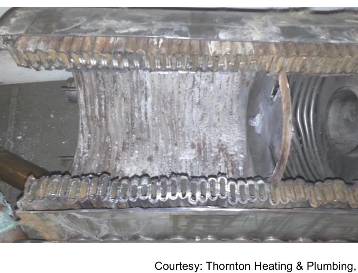

    hot_rod Posts: 28,708
    here us a cut open Munchkin, as the tubes scale up the heat transfer drops and you see symptoms like yours

    but my 7 heating zones behave just fine? i’m seeing good heat transfer, deltas around 20, etc?
    if the hx was scaled up wouldn’t I be seeing symptoms outside the dhw zone?
    that said this munchkin is from 2008 and I have very hard water. can I descale the hx?

    You know, that the Munchkin should be piped primary/secondary even tho one diagram on the installation booklet shows a direct piping method. A mistake. A 0015 one speed is too big a pump and a steep curve. A 0010 has a flatter curve and is the recommended boiler pump for P/S piping. A mod/con requires three pumps, a boiler, distribution, and indirect pump. The problem I come across with the Munchkin is the direct piping, having the boiler pump do distribution, too. With zone valves, the chance of boiler cycling and pipe erosion is enhanced with high head pump doing boiler and distribution.
    One picture doesn't make it easy in understanding your setup.

    Thanks Homer….thats not a great picture but I have a primary loop with closely spaced tees powered by a 010 on the return side. I then have a secondary loop with the zone supply and return with 007s per zone. The indirect is T’ed off the boiler supply and return and has the 015 on the supply side. I’m pretty sure this is how the munchkin manuals i’ve seen for the 140m specifies.
