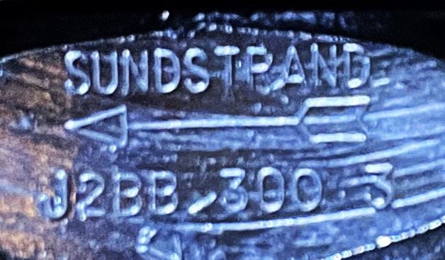

My old Beckett RWB burner with Sunstrand J2bb 300-3 pump and Sid Harvey t1-15 ignition transformer has lived a long life. I see these new Beckett burners with more modern pumps and ignitors. But will any just any AFG burner fit? What specs need to be aligned? My neighbor switched to gas and left me a "new in the box" AFG. Is it as simple as having a technician swap these out?

The boiler is a Crown Model UPCS-4. It would be nice (peace of mind) to have a spare for the pump (Sunstrand J2BB 300 3) in case I have a service call and they tell me a replacement pump is not available.
You can get a 1725 'A' pump. You'd have to replace the coupling as well.

You can use an "A" 3450 pump at 1725 rpm. No issue. See the attached
