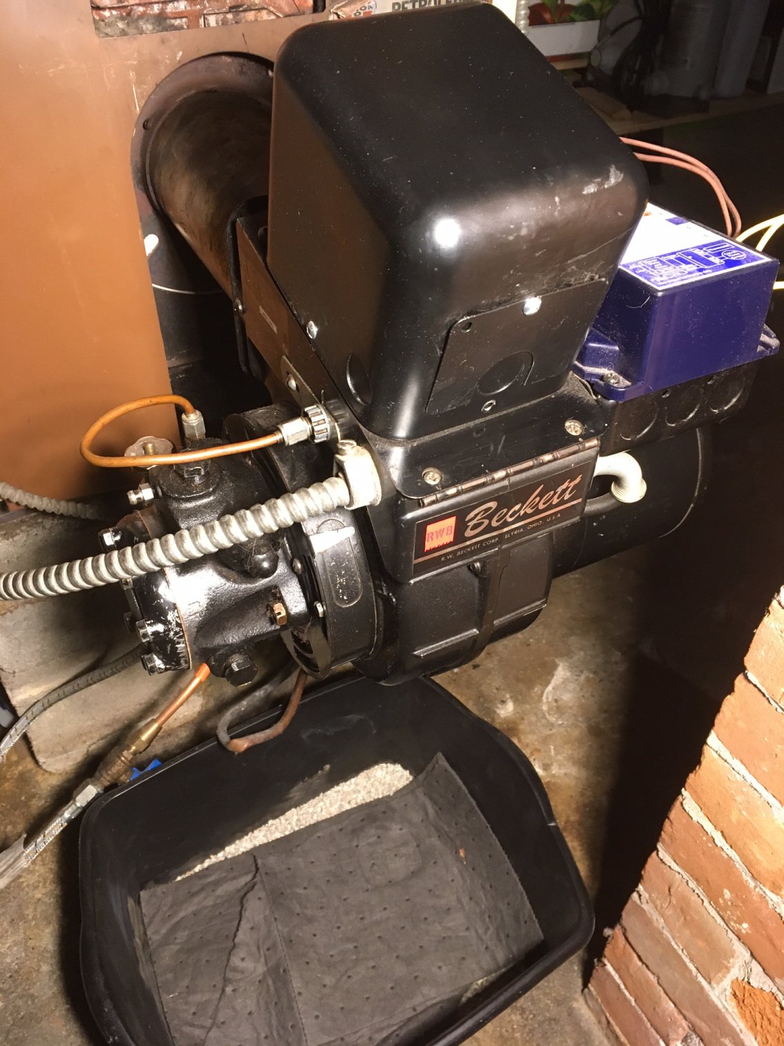

Are Beckett burners interchangeable or device-specific?
My old Beckett RWB burner with Sunstrand J2bb 300-3 pump and Sid Harvey t1-15 ignition transformer has lived a long life. I see these new Beckett burners with more modern pumps and ignitors. But will any just any AFG burner fit? What specs need to be aligned? My neighbor switched to gas and left me a "new in the box" AFG. Is it as simple as having a technician swap these out?

    That "new" burner is 20 plus years old, that being said, yours is at least 50. You need a flange, airtube and someone who knows what they're doing. It is an upgrade

    EBEBRATT-Ed Member Posts: 20,481
    As @EdTheHeaterMan said the old burner is a Beckett SR 1725 RPM burner sold around 1970s. Different animal from the new burner you have.
    The SR is a flame retention burner so upgrading to the other burner isn't going to save fuel

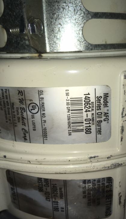

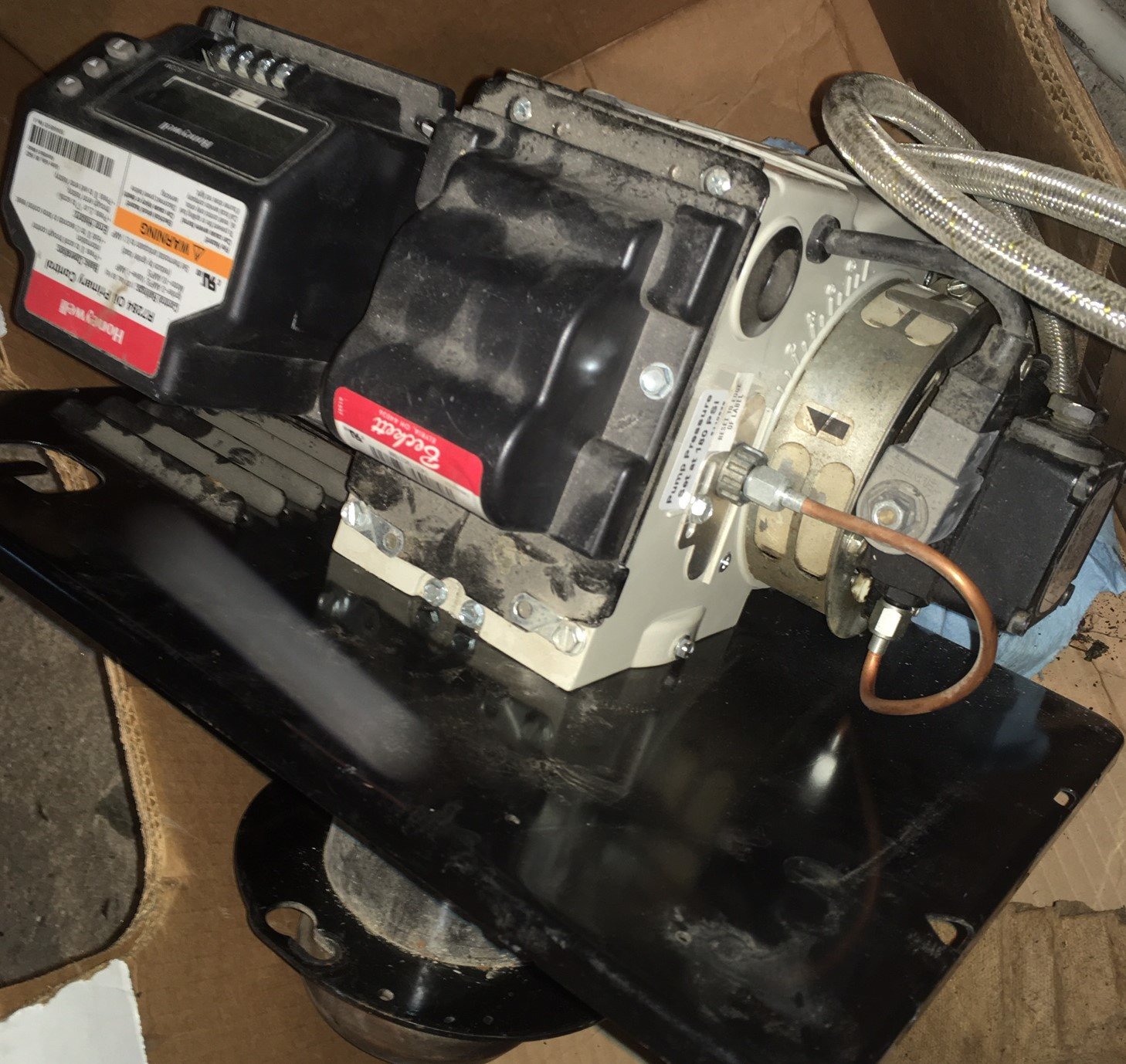

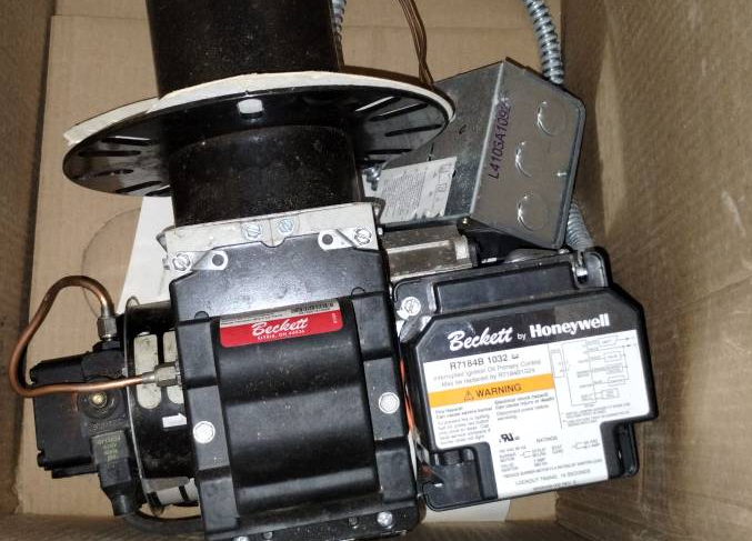

    The other burner the neighbor gave me looks similar. However, this one he had used. It looks similar to the other Beckett and says "AFG" and is set to 150 PSI. Must be another hot water heater burner I suppose. He did have an oil-fired boiler before the upgrade, these must be from his hot water system.
    EdTheHeaterMan Member Posts: 12,506
    The oil burner with the serial number that ends in 01180 came from a Burnham MPO boiler that was rated up to 87% AFUE and may have been energy star rated when it was installed in your neighbors home. the welded flange means that you can not adjust the insertion depth. If you remove the SR oil burner using. the three bolts that hold the flange on to your heater, you can measure the insertion depth of the SR burner. if the insertion depth is the same or within 1/8" in or out, you could most likely use that burner on your heater.
    You will still need about 5 years experience with combustion testing instruments in order to select the proper nozzle, and make the proper adjustments for your heating appliance. still not a DIY job if you have no oil heat experience.
    I would venture to say that the primary control on the newer burner that came with the Burnham MPO boiler is a better primary control than the primary control you have on your existing SR burner. So hold on the that Honeywell R7284 control. There are diagnostic features available that are not on your existing blue primary control

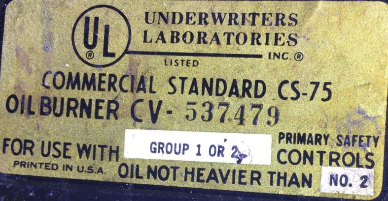

    Yes, this 2.6 amp Emerson S60KXD motor is rated at 1725 and 1/8 hp. I looked through the service tags for the last 20 years and they all reference the Becket Burner as "Model S"

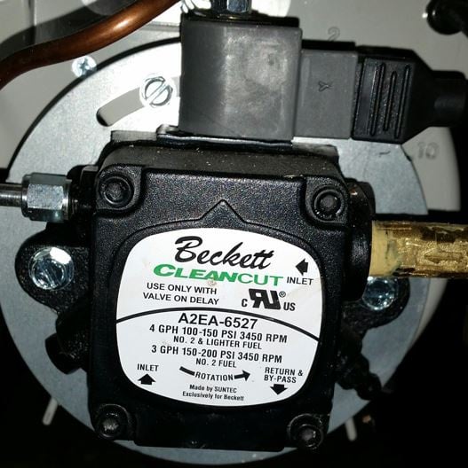

    Is this an "A" pump? It has the letter "A" in the part number. The RPMs
    Seems too high at 3400 compared to the old Sunstrand's 1725 rpm.

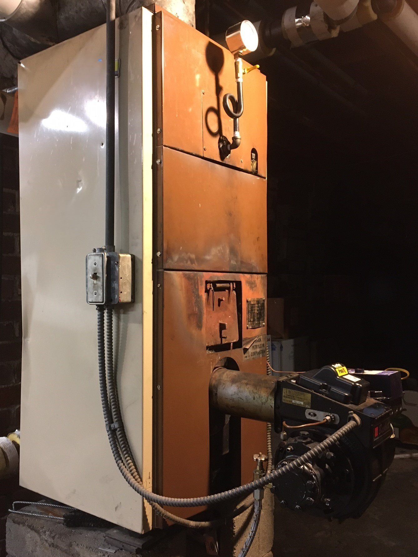

    Here is a photo of the boiler from a few feet away. The previous owner bricked over the cellar hatch to build an addition. The service tech said the old boiler (and oil tank) in the basement would need to be broken into pieces to be removed. I have no idea if the replacement would arrive in the same way. Here is a photo with the newly installed ignitor (the old one just died). The efficiency has dropped from 80 percent to 74.7 for some reason.
    mattmia2 Member Posts: 17,469
    stack temp is a little high, if whoever is setting up the burner could get it down a little i think the efficiency calculation would give you a higher number but those with experience adjusting combustion without a computer can comment more on on how that number is calculated.
    Steamhead Member Posts: 18,709
    I think that's a re-branded Utica or Dunkirk.
    It is a Dunkirk. Those were good boilers. I installed quite a few of those back in the day including one with a Beckett SR. Nice and quiet and burned well.
    @Jack M
    You can use an "A" 3450 pump at 1725 rpm. No issue. See the attached

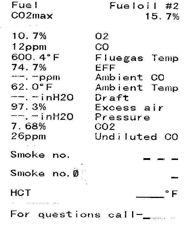

    10.7% O2 on that combustion test seems ridiculously high. I normally find a true zero smoke at around 4-6% O2.
    mattmia2Robert_H
    Something wrong with his test equipment. Its not possible to have 7.68Co2 and 10.7O2 at the same time.
    600 flue gas we don't know if that is gross or net. If the basement is 70 degrees then the stack would be 530 which isn't terrible.

    Your efficiency is down because the burner may be misadjusted. Co2 should be around 10%

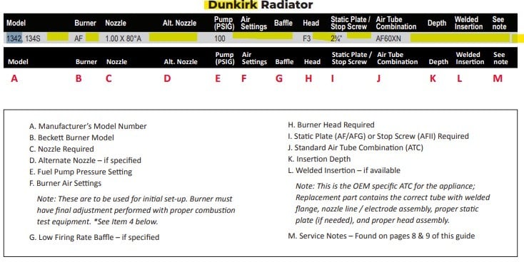

    The Beckett OEM Spec Guide shows the following setups for the 1352:
    Burner- AF Head- F6 or F12 Static Plate- 2-3/4” Nozzle- Delavan 1.35 X 80°A at 100 PSI
    The F6 head would easily support the 1.35 firing rate, not sure why they also mentioned the F12. @Jack M , what firing rate is shown on your boiler's rating plate?
    Note that the spec calls for a HOLLOW nozzle. If someone put a solid one (as Delavan "B") in, that will degrade the combustion.
    I suspect this boiler originally came with a different burner and the SR was a retrofit.

    The "handwritten ticket" that goes with the computer printout reads "net stack temperature" is 537 degrees F😀. I reviewed annual service tickets for the last 15 years, all are 500 (net) except for two that are 550. Took the front cleanout plate off, and it is immaculate, no soot at all. It was just vacuumed out as part of the annual service. I pull that cover off every once in a while ( it is usually clean) because one time the air mixture was set incorrectly and the whole thing sooted up (you can see from the discoloration on the front of the boiler what a mess this one event caused to what was pristine). As I mentioned, having "backup" parts on hand allows me to have a prayer of getting the system up and running in the event a part breaks and the oil company says "these old parts are impossible to find, we don't carry things like this on our fleet of trucks, this is a huge ask, we are a big company and do not have time be sourcing parts" (note: we don't talk about prices for any of this on this forum) I don't begrudge anyone, this is all fair, I am just one small insignificant customer fortunate to have a oil company to service my boiler (and a forum like this to learn). The steam heat is very comfortable (like standing in sunshine), the floors are warm, and endless showers for teenagers. I would add that there are never any problems, but I'm afraid to say that because I will jinx myself. My "converted to heatpump" friends cannot say anything like this.
    The boiler is rated for 315 square feet of steam and a capacity of 1 gallon per hour. The service person wrote '85 x 70 B" at the top of the sheet, and the nozzle description has been labeled the same with the word "solid" on the sheets for the last 15 years (at least).
    edited November 2025
    That's probably a rebranded 1342 then, it has that firing rate. F3 head, 2-3/4" static disk, and believe it or not, either a hollow or solid 80° nozzle. Go figure………………
    What I'd do is try both nozzle types and see which gives the best results.
