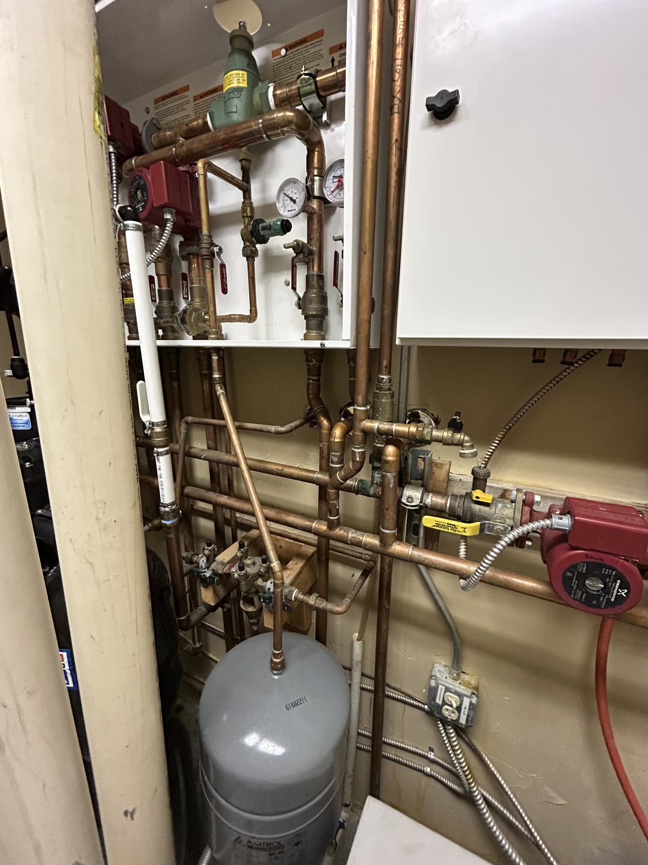

Okay, I ordered one from Supply House. Swapped out the cap and the internals of the existing one because of the design of the air scoop (see picture), and I'm thinking we are done here. That was 2 days ago and we are not done here. Started leaking again last night. This seems to be a pattern too. I think this is when the first of the zones upstairs are calling for heat the boiler comes on.
Anyway, does anyone know why this air scoop/air vent combo is now trying to identify as a water feature??
My system pressures seems normal (15-20 psi when hot). My temps are in the 120-125 range. Both manifold pressure and temp gauges appear to be working and normal. Gauges at the boiler all reading normal. My expansion tank bladder seems fine (water on top, air on bottom when doing the knuckle test).
I'm going to call the company that I use to come back for yet another 'service call', but I have very low confidence at this point on their diagnostic abilities.
Thanks for any help or advice. I've posted some pics. If anyone wants any other views or closer pics of components, etc. just let me know.

    Munchkins typically had high head circulators. In some cases the float can be pulled down on the inlet side of a circ IF the expansion tank is mis placed. It looks like the tank is connected to the bottom of the air purger? If so it should not see a negative pressure that allows the float to drop.
    Push in the valve under the cap on the expansion tank, air should come out. If water comes out the tank is waterlogged and could be

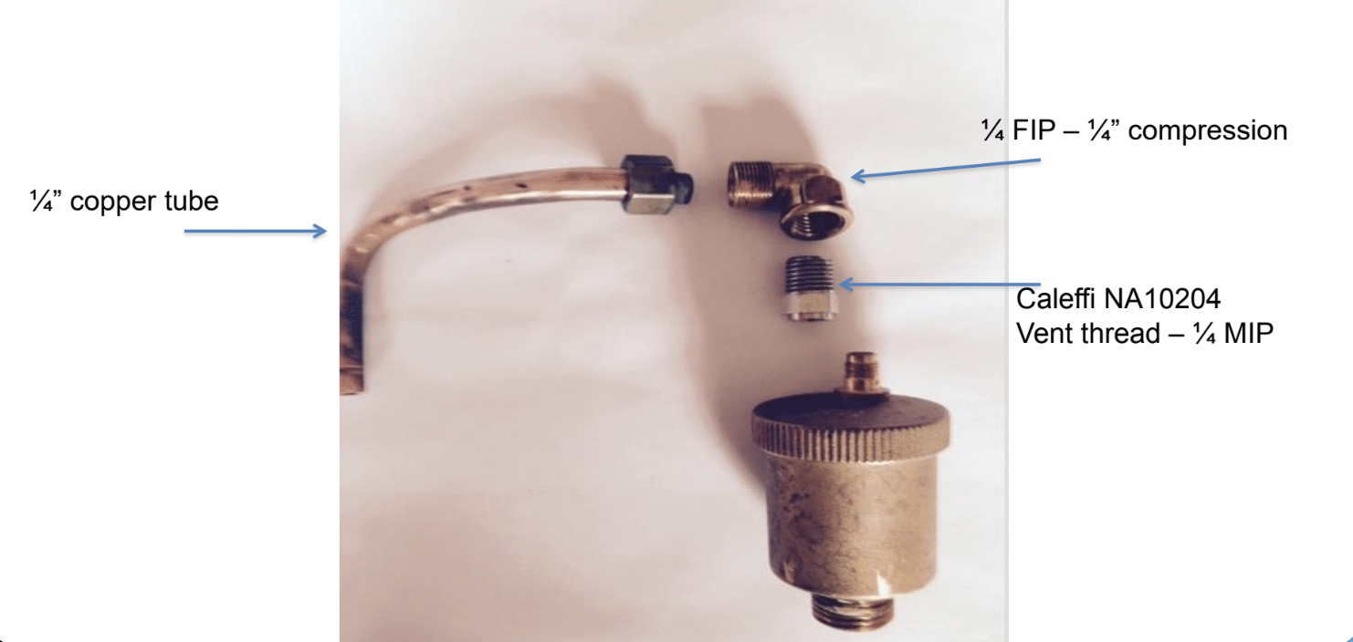

    Some arounds from Taco or Caleffi :) you can get this thread adapter to NPT that allows you to run a tube down out of harms way for when it leaks. Not the best fix!

    As far as the expansion tank placement, it was replaced when we first moved in back in February 2020. The tech noticed it was water logged. He replaced the tank in the exact same location as existing. I'll attach a pic of how that line goes into the system, but again, all has been functioning as intended since then. The tank appears to be good, or should I say the tank bladder. If I push the valve on the bottom, air does come out so I think this is not an issue.

    That's an interesting workaround with that copper tubing. Not sure I could pull that off unless I changed out the scoop entirely and switched to another vent like the one you showed.

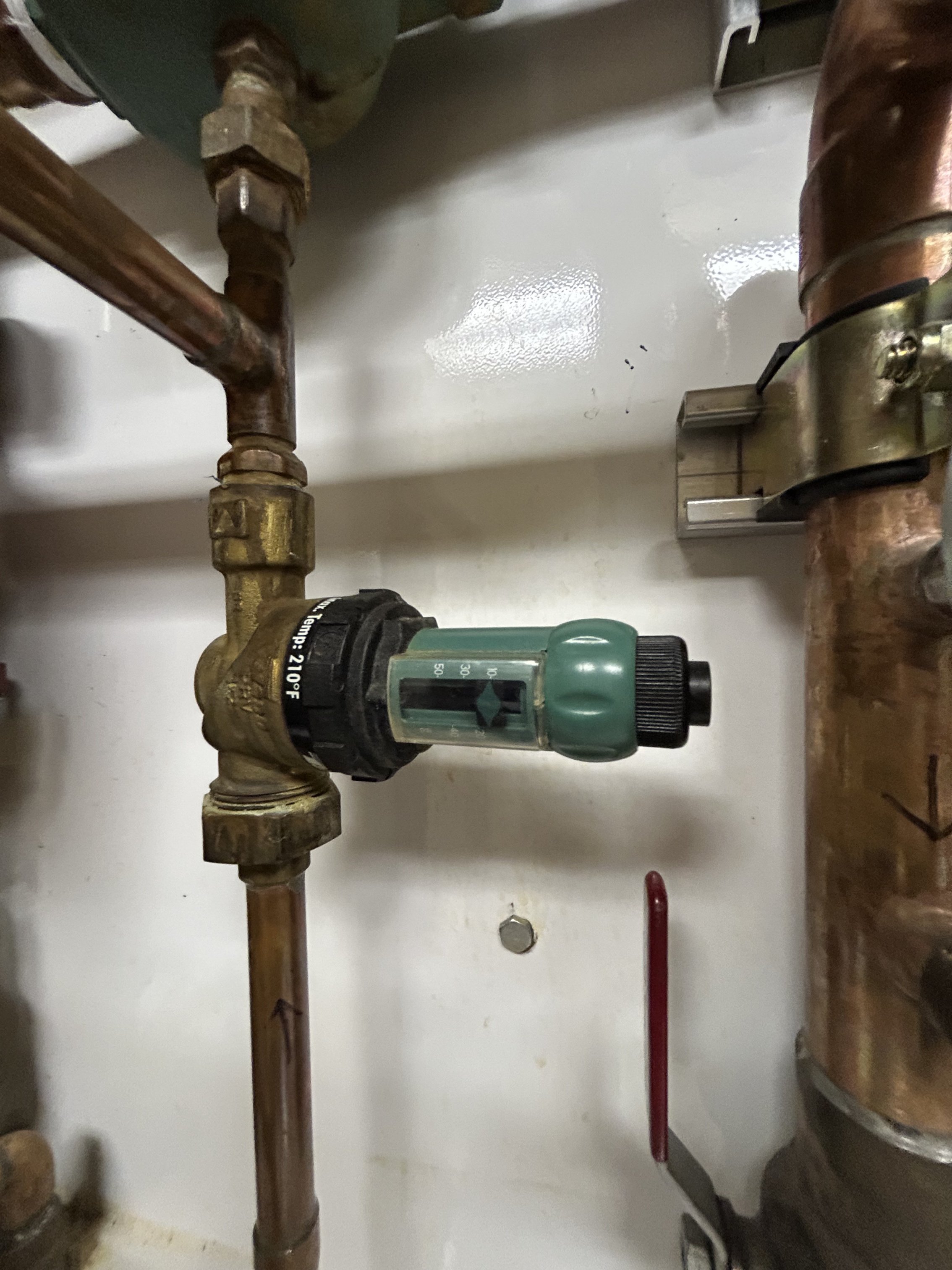

    Here are a few more pics. Also, what is this horizontal green device?? Do I need to change anything on it? Appears to be set to 10-ish? Pressure? Anyway…

    hot_rod Member Posts: 26,645
    yes, if you do ot have air issues , noise or lack of heat, close all the vent caps. Maybe the cap on that air purger has always been closed?
    The green valve is the system fill valve, a pressure reducing valve, basically
    Usually there is a backflow valve next to it to prevent boiler water from backing into the water system
