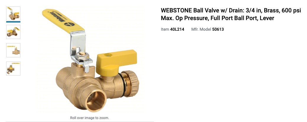

    If you have the room, you can do something like this.
    Screenshot_20251027_191230_Samsung Internet.jpg Screenshot_20251027_191115_Samsung Internet.jpg
    Just close the valve when done. Or leave one open to always eliminate air.

    @HVACNUT is that a 1/8" npt valve? I didn't think that existed, but I also didn't look that long. Can you draw out what you're suggesting? I'm trying to understand how you're suggesting to replace an existing coin vent with a valve and an auto air vent. What fittings would you use and how would you drain (npt → ght?)?

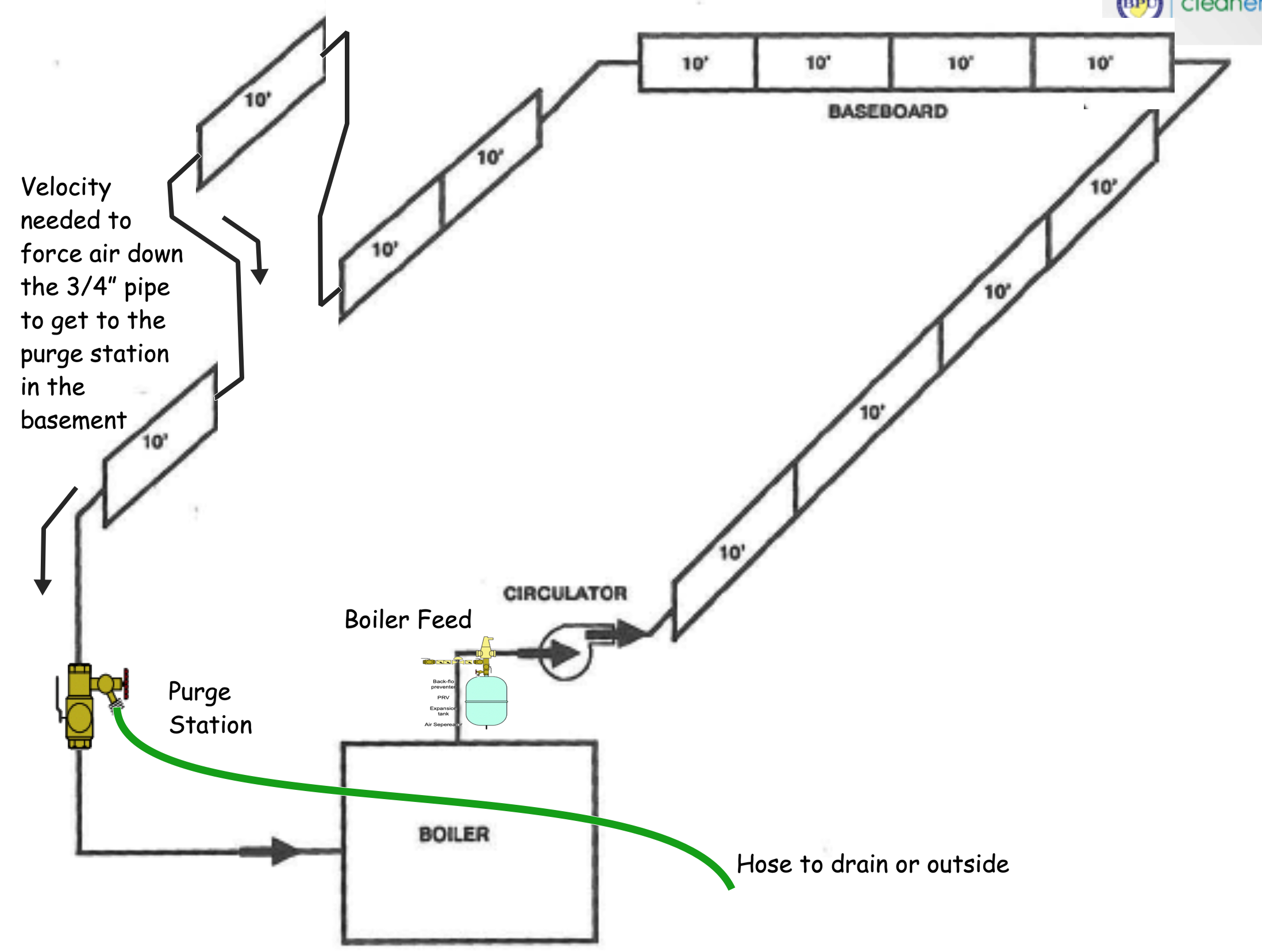

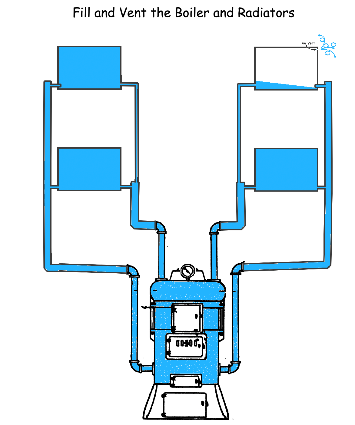

    When you want to remove air from a gravity hot water boiler system you need to add enough water pressure to the boiler in order to lift the water higher than the highest radiator.  This is called static pressure.  In a 2story home that might be about 12 PSI in the basement to get about 2 PSI at the top radiator to force the air out.
    The typical way to remove the air from the radiators in this system is called VENTing.  We actually called it Fill and Vent the System. We needed to do that when a replacement boiler was installed.
    You VENT the radiators individually by opening the loose key air VENT on each radiator to let the air out until water comes out. That way you know that the radiator is full of water.  You then make sure the water pressure at the boiler is at  12 PSI and continue to the next radiator air VENT and repeat the process first floor first then the second floor and so on, until all the radiators are full of water.  No Air Left in the radiators.

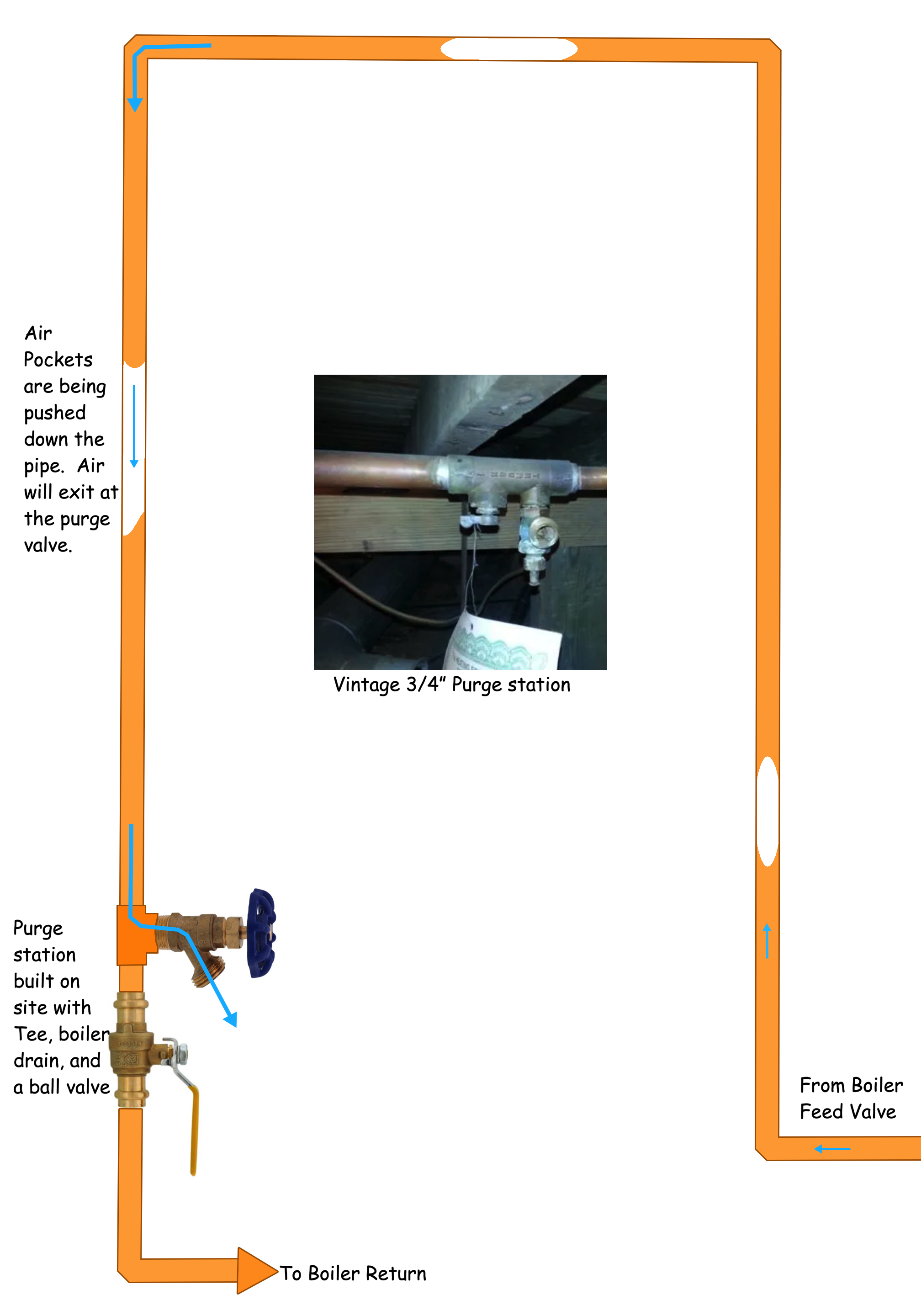

    When you have a series loop of baseboard you can not depend on this venting method to get all the air out because the nature of a series loop means that sometimes the baseboard pipe and the connecting pipe will drop down below the floor and rise above the floor at another radiator several times in the loop.  As a result the air pockets in the center sections of the baseboard loop will not have a way to allow the air to vent at one end or the other.  That air will be trapped and that entire radiator loop will not heat.   The typical way to remove air from that series loop is to purge the air from the loop.  This is usually done in the boiler room where each series loop zone will have a purge station or be connected to a central purge station.
    To purge the air from a series loop you increase the pressure in the system to a pressure that will force any air in the pipe to be entrained in the water flow that will force the water through any vertical pipe where the water needs to flow down to the basement.  Thai defies gravity since the air is lighter so the force of the water must be great enough to take the air along with it as it flows to the purge station in the basement.
    This rapid flow will ensure that all the small vertical pipes between each radiator will not collect enough air to stop the flow of heated water through the radiators.   If you design the piping system properly with the proper air elimination devices strategically located, you can actually design an air free system that will purge any small amounts of air as the system operates.

    For your system, you can add a ball valve on the end of the loop that is opposite of the side where the fill valve is located.  For example if your fill valve for adding water to the boiler system is located on the supply side, then place the purge station on the return side.  If your boiler fill valve is located on the return side of the system, then place the purge station on the supply side and force the air out in reverse direction.  Either way will work.
    This is only a guess at what you may have from my experience of 40+ years in the trade. This is typical of the mistakes that others have made, that i have come across in my many years.

    Finally, to vent the baseboard loop you must have a valve to shut off one side of the series loop.  Then you need a drain valve that opens to a garden hose to direct the air and water out of the system.  That is called purging.  If you only have the bapp valve and no purge or drain valve that can be opened, then that valve must be added.
