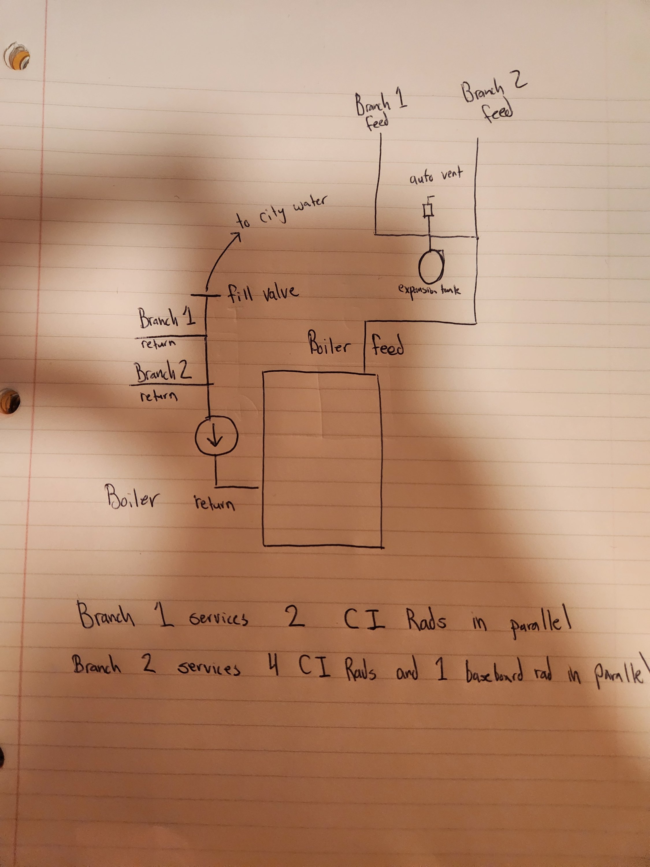

Hi all,
I'm about to take my second stab at purging the air from my boiler. I did it once last season and I remember struggling on one section that had several poorly placed coin vents (not at highest points in heating loop) on a baseboard loop. The technique I used to purge the air from this section was to effectively drain the water in the loop from one of the coin vents to remove some of the air pockets that were causing the blockage. It was difficult in that the coin vent was in a really tight space and I would get water everywhere since the vent was located above me. Can I attach an air hose line to a 1/8" npt coin vent and if so, what size would this even be or can I swap out the coin vent for a 1/8" valve type fitting that a hose can be attached to? I haven't seen any products like this.
I was originally planning on installing a purge and fill valve, but I have run out of time (cold out) and I don't want to risk messing up some bigger solder joints and having to find somewhere that stocks 1 1/4" copper pipe.

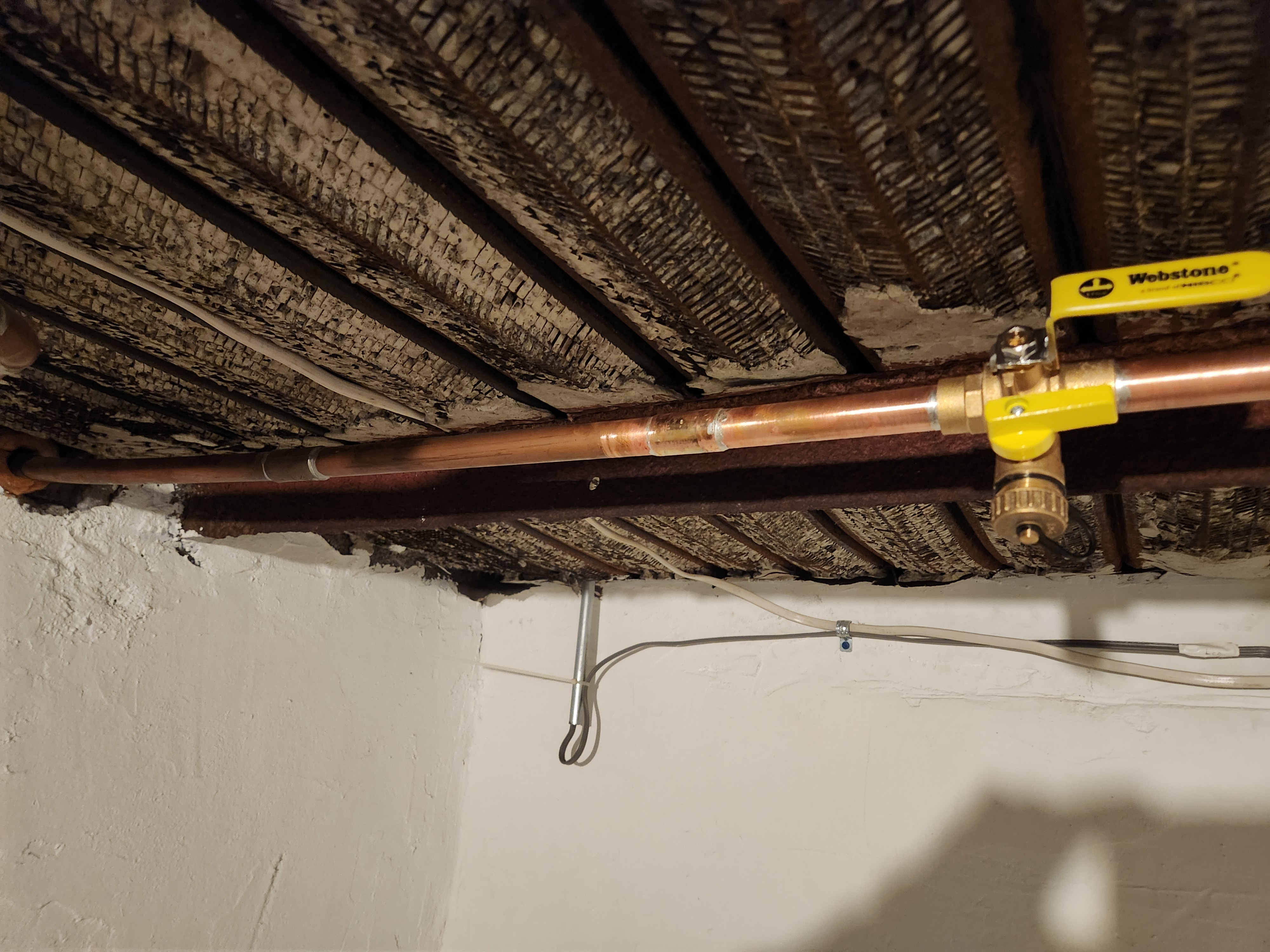

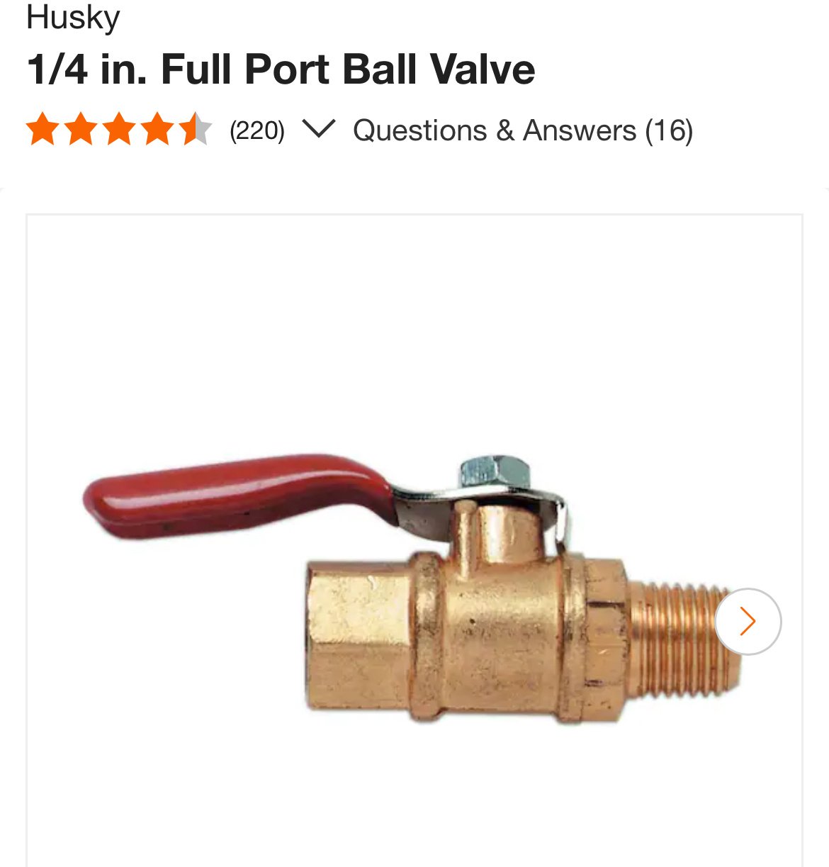

    If you have the room, you can do something like this.
    Screenshot_20251027_191230_Samsung Internet.jpg Screenshot_20251027_191115_Samsung Internet.jpg
    Just close the valve when done. Or leave one open to always eliminate air.
  • @Big Ed_4 This is a converted gravity-fed system (100 year old house). The boiler services several cast iron loops in parallel. This is the only loop that is base board and it is servicing three baseboard radiators that are piped in series. The pipping on this loop goes up and down between floors, so it's challenging to purge. There is a coin vent located on the three baseboard radiators, but they get even more water everywhere, so I believe that's why I purged from the basement for this loop.

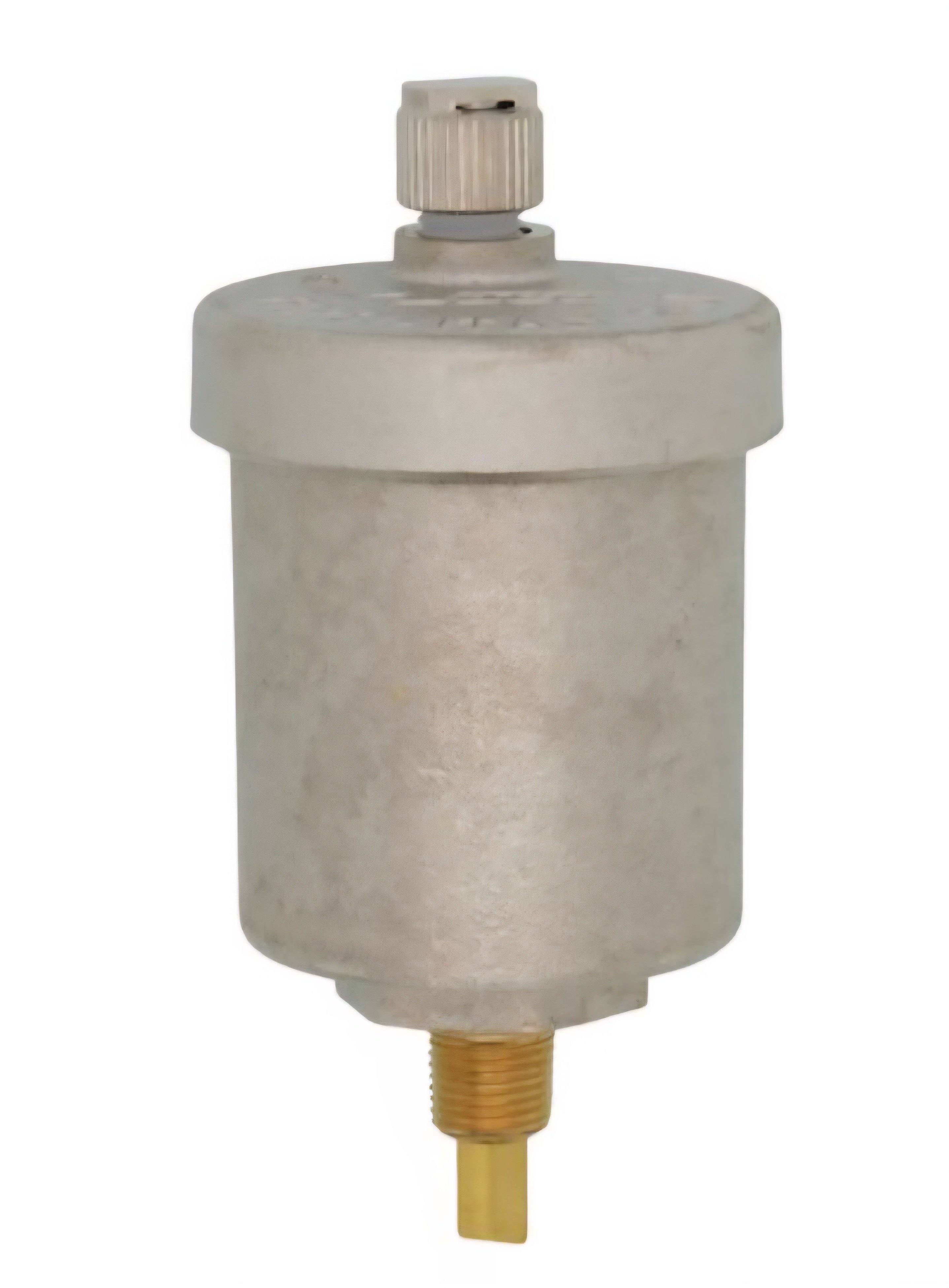

  • @HVACNUT is that a 1/8" npt valve? I didn't think that existed, but I also didn't look that long. Can you draw out what you're suggesting? I'm trying to understand how you're suggesting to replace an existing coin vent with a valve and an auto air vent. What fittings would you use and how would you drain (npt → ght?)?

  • @Big Ed_4 You're 100% correct. The plumbing on this system is a hack job and I try to do my best with it before I rip it all out. It should not be plumbed with the cast iron rads, but it was. I suspect it was done some time before zones were well adopted. There are no zones on this boiler system. The air separator isn't even located in the correct spot. The balance is way off on the baseboard rads (scalding hot). An idea I had before adding zone heating was to add a trv valve to the start of the loop to balance the baseboard heat output. I currently have no ability to control the flow through the baseboard rads, so I am slightly worried with some of the changes I made this offseason (more trvs on cast iron rads that previously had no flow control) that they'll be even hotter this season. The reason I haven't completely repiped everything is because it's a massive job. Massive 100 year old cast iron piping all throughout the basement. I plan to address it, I just need a free summer…

  • @mattmia2 @Big Ed_4 I understand this is the ideal solution and I already have that planned. The issue right now is that it's getting cold out and I'm looking for an easier way to purge air out of the system that doesn't require me putting the boiler down for several days. I was thinking of doing something clever with one of the coin vents and I actually think @HVACNUT had a good idea. I could put a 1/8" npt valve (if it exists) in line with a hyvent. This would allow me to hot swap the hyvent with a ght / hose line adapter if the system has air in it. I also could just keep the coin vent if a 1/8" npt exists.
    HydronicMike
    hot_rod Posts: 28,708
    sometimes called gauge cocks 1/8 and 1/4
    Most valve manufacturers offer them
    Or Home Depot

  • I ordered the 1/8" valve from supply house with an npt to barb adapter. I'll hook up pvc vinyl tubing to the adapter and when I feel I've purged the air from the baseboards, I'll swap out the adapter for either a plug or a coin vent. I think this will definitely help me purge air from this loop without getting water everywhere. The valve is hidden in a laundry room, so it won't be an eye sore on top of a radiator anyway.

    even someone with mediocre soldering skills could sweat in a purge station in a couple hours so that you could purge most of the air out. or you could do it with compression fittings.
  • @mattmia2 I've soldered a bunch already, but I'm less comfortable trying my hand at 1 1/4" soldering and trying to find copper piping for 1 1/4". I'd basically have to use a sawzall and then debur and sand. It's just something I haven't done before and it's getting pretty cold without heat. I already ordered everything I need to solder in the purge station, I'm just not feeling confident about sweating in on 1 1/4". I could try. I've definitely soldered in more gnarly spots than behind the boiler. I'm more worried about finding places that stock 1 1/4" pipe if I mess up.
    a couple of the real hardware stores by me will sell you cut pieces of 1.25" pipe. I would do it with npt adapters and a coupler, the mass of an adapter is a lot less and it is a lot easier to sweat than the body of a 1.25" valve and if you screw it up sufficiently you haven't ruined a $75 valve. Looks like the big box stores have 1.25" pipe although a 10' piece is a bit of an investment.
  • @mattmia2 yea, that was pretty much how I was planning on doing it. I bought a 1.25" dielectric union (which I don't think I needed — could've used a standard union), two brass nipples and a 1.25" purge and fill valve and a 1.25" C to NPT fitting. My circulator is on the return side, so I was going to plumb in the purge and fill before the circulator on the return. I was going to go circulator pump → copper pipe → union (sweat) → nipple → purge and fill → nipple → C to NPT fitting. I would start by sweating in the adapter fitting and the sweat side of the union then wrench the rest so I know I won't melt anything. Like I said, this is a 30 year old boiler and I feel like the issue is more so finding parts if I mess up (e.g. can I damage the circulator pump if I solder too closely).

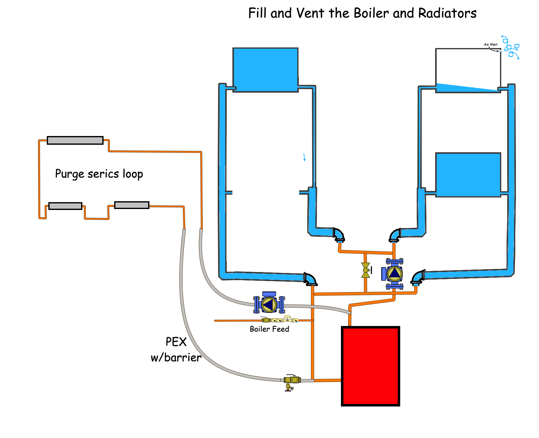

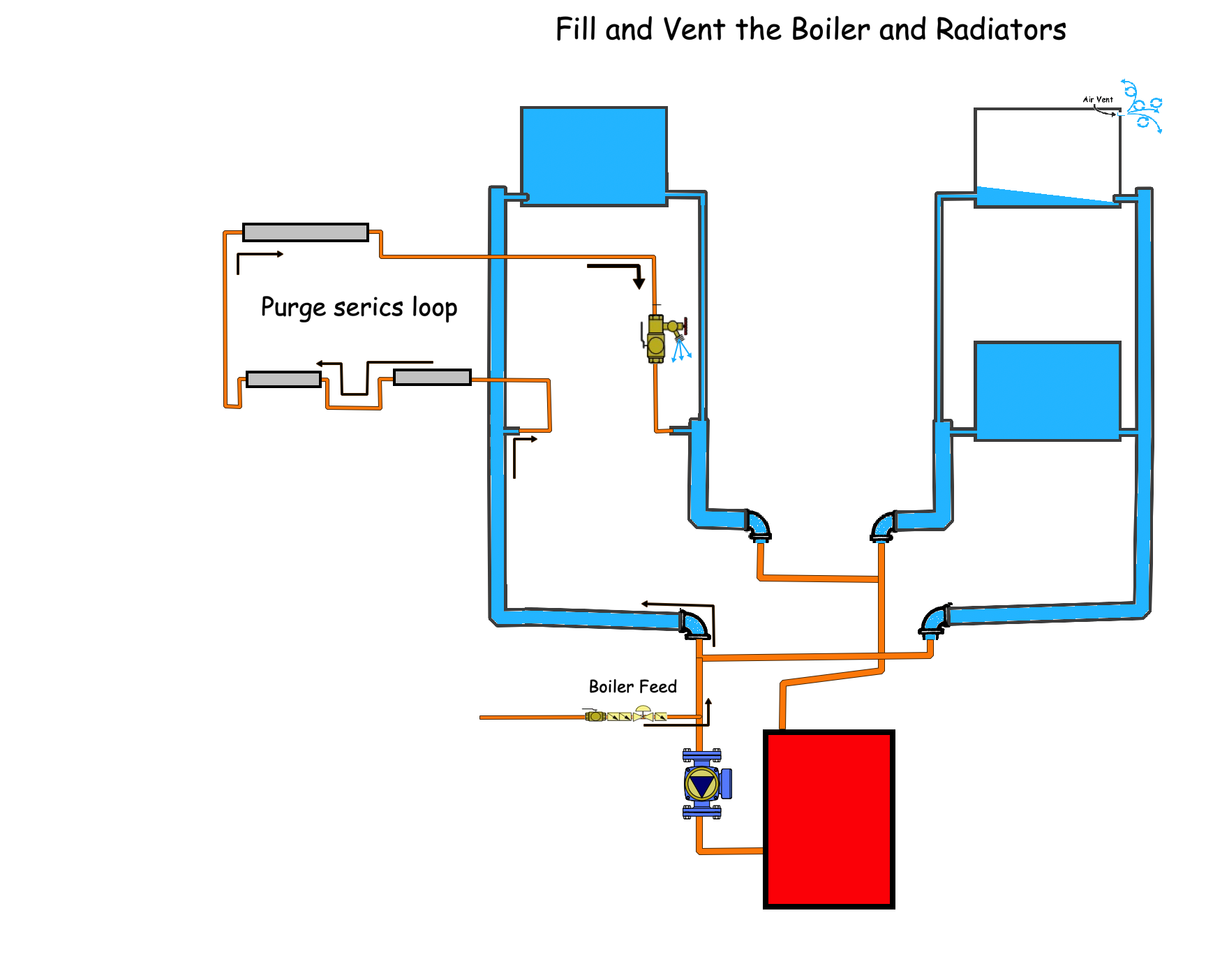

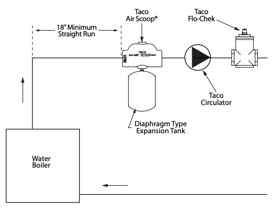

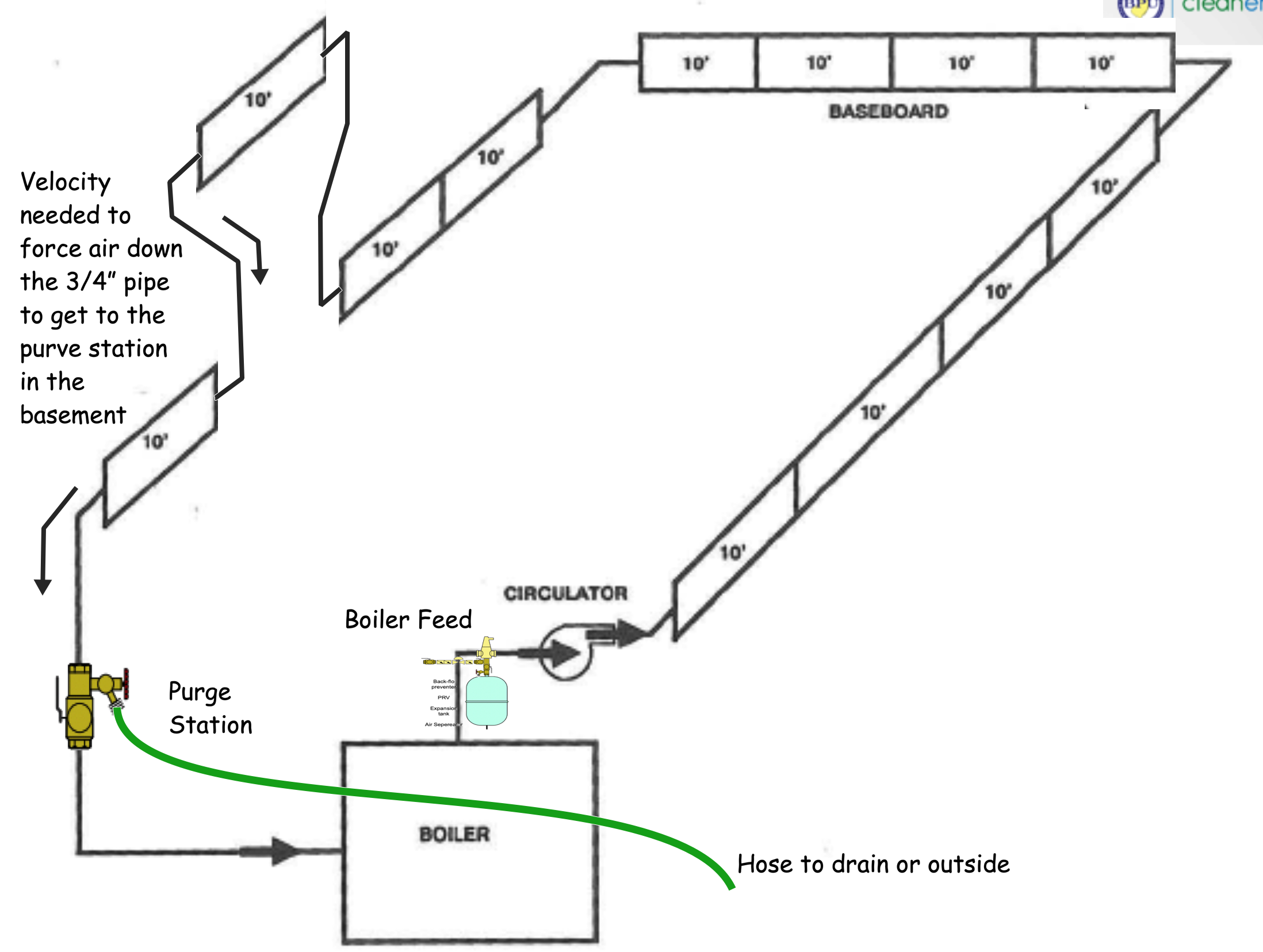

    EdTheHeaterMan Posts: 12,950
    edited October 2025
    When you want to remove air from a gravity hot water boiler system you need to add enough water pressure to the boiler in order to lift the water higher than the highest radiator.  This is called static pressure.  In a 2story home that might be about 12 PSI in the basement to get about 2 PSI at the top radiator to force the air out.
    The typical way to remove the air from the radiators in this system is called VENTing.  We actually called it Fill and Vent the System. We needed to do that when a replacement boiler was installed.
    You VENT the radiators individually by opening the loose key air VENT on each radiator to let the air out until water comes out. That way you know that the radiator is full of water.  You then make sure the water pressure at the boiler is at  12 PSI and continue to the next radiator air VENT and repeat the process first floor first then the second floor and so on, until all the radiators are full of water.  No Air Left in the radiators.
    When you have a series loop of baseboard you can not depend on this venting method to get all the air out because the nature of a series loop means that sometimes the baseboard pipe and the connecting pipe will drop down below the floor and rise above the floor at another radiator several times in the loop.  As a result the air pockets in the center sections of the baseboard loop will not have a way to allow the air to vent at one end or the other.  That air will be trapped and that entire radiator loop will not heat.   The typical way to remove air from that series loop is to purge the air from the loop.  This is usually done in the boiler room where each series loop zone will have a purge station or be connected to a central purge station.
    To purge the air from a series loop you increase the pressure in the system to a pressure that will force any air in the pipe to be entrained in the water flow that will force the water through any vertical pipe where the water needs to flow down to the basement.  Thai defies gravity since the air is lighter so the force of the water must be great enough to take the air along with it as it flows to the purge station in the basement.
    This rapid flow will ensure that all the small vertical pipes between each radiator will not collect enough air to stop the flow of heated water through the radiators.   If you design the piping system properly with the proper air elimination devices strategically located, you can actually design an air free system that will purge any small amounts of air as the system operates.

    @EdTheHeaterMan This is the same heating system and this is exactly how I was planning on purging the system. I'm not sure why you think I don't know how my system is piped. I've spent a while on this system and have filled / drained it, balanced and purged it several times already. I'm just reiterating what I've already had to do with this system. I'm trying to make the act of purging air from the series plumbed baseboard heating easier and not a process of popping up a ton of water that comes out of the coin vents on the baseboard rads. I have no zones and no isolation valves because this was all plumbed before I ever bought the house, so I'm trying my best to work with a hacky heating system. My aim to begin all of this was to purge the air more easily from the baseboard section which is plumbed in series. I believe that by introducing a shut off valve to close this loop, it is effectively acting as an isolation valve. I can then install a drain before this shut off in the loop to purge air as you described. I'm trying to find the easiest way to do this on a system that is a nightmare to work on, but the history of the system is correct. I have no intention to fix that incorrect installation until it's warmer out — I need to work with what is here.

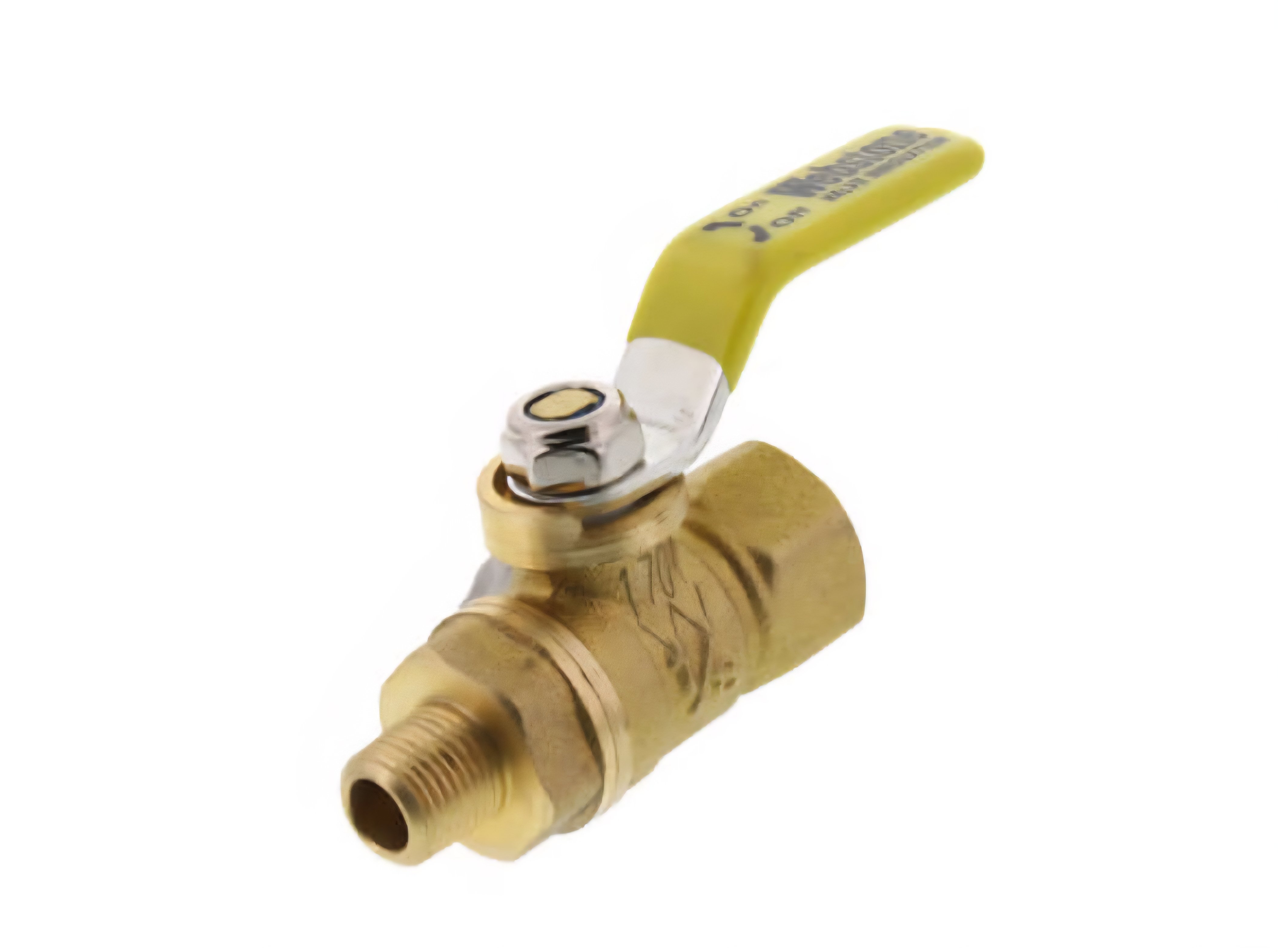

    A valve like this at the end of a series fin tube loop should be all you need. Or build one with a tee, hose bib and ball valve.
    The cost of these and simplicity of just two connections make it an easy decision. Threaded sweat or press versions available.
    The parallel rads will be harder to purge. A pump cart with 12- 15 gpm flow rate will generally blast enough flow to push enough air to get the circulator and air purger finishing it off.
    A plastic garbage can and a cheap plastic pool pump is an inexpensive way to build a high flow pump cart. Mount the pump on top of the can with a piece of plywood, use the largest hose you can get to connect into the system.
    That clear vinyl hose from Home Depot works fine for a hose, get 1" and adapt into the system somewhere.
    HVACNUT Posts: 7,784
    In the event the Hy- Vent leaks or fails, no need to drop the pressure on the boiler to replace it. Just shut off the valve.

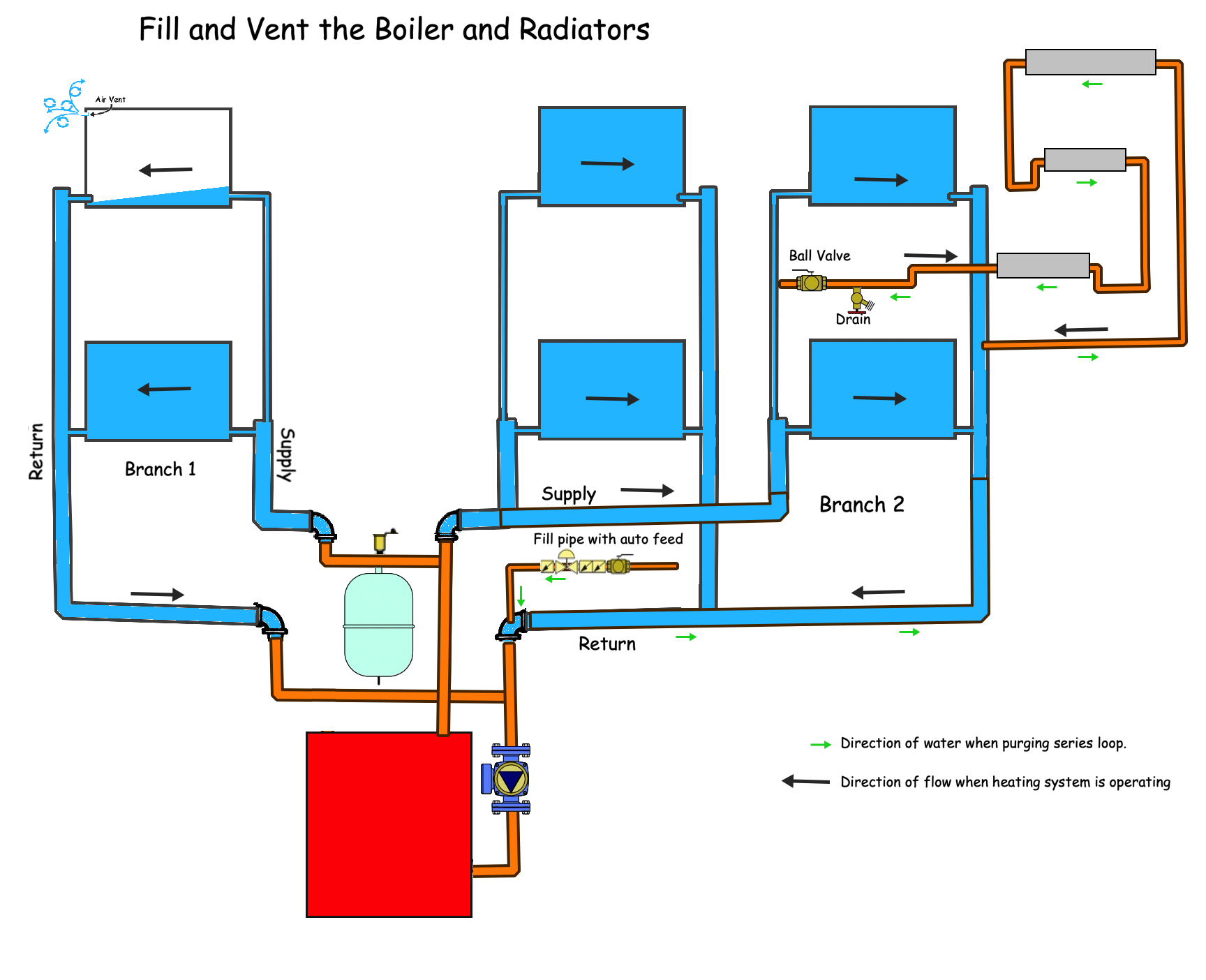

    As far as my previous comment, I have added the illustrations with the different air removal methods in detail in order to make the concept of purging and venting more clear.
    For your system, you can add a ball valve on the end of the loop that is opposite of the side where the fill valve is located.  For example if your fill valve for adding water to the boiler system is located on the supply side, then place the purge station on the return side.  If your boiler fill valve is located on the return side of the system, then place the purge station on the supply side and force the air out in reverse direction.  Either way will work.
    This is only a guess at what you may have from my experience of 40+ years in the trade. This is typical of the mistakes that others have made, that i have come across in my many years.
    This would be the proper piping for two temperatures and two flow rates. the near boiler piping has been rearranged to create a bypass for the lower temperature radiators and the hither temperature radiators are piped without a bypass to get higher temperature water at a faster flow rate (no bypass)

  • @EdTheHeaterMan from your diagram, if I have a valve at the end of the in series baseboard loop that has a drain and it's on a circuit with a bunch of CI rads that are vented. What would be the best way to purge the air? If I start by purging the air from the top level CI and work my way down and then purge the air from the baseboards, there still might be a section of piping that has air trapped in it. How will air travel between the two modes of purging? E.g. if I install a shut off valve at the end of the in series baseboard loop and I close that valve, what will happen to air that is outside of that loop at the end of the loop after the valve? Will it seek to travel up because it is less dense than water or will it be trapped by the hydrostatic pressure of the water from the returns of all the other CI rad loops?
  • First of all, is my guess at how the baseboard was added a close approximation of your system?
    next. Always vent all the CI rads from the bottom floor, then the second floor, then the top floor last. Be sure you have all the air out of the mains and the radiators this way. Bottom first to top last.  You will need the boiler pressure to be high enough to vent all the radiators on the top floor.
    Finally, to vent the baseboard loop you must have a valve to shut off one side of the series loop.  Then you need a drain valve that opens to a garden hose to direct the air and water out of the system.  That is called purging.  If you only have the bapp valve and no purge or drain valve that can be opened, then that valve must be added.
    If you are going to the trouble of draining the system to add a valve, you can decide if it is worth the trouble to correct all the problems or just stick with the quick fix.  The quick fix will not get you completely where you need to be, but you can get all the air out.

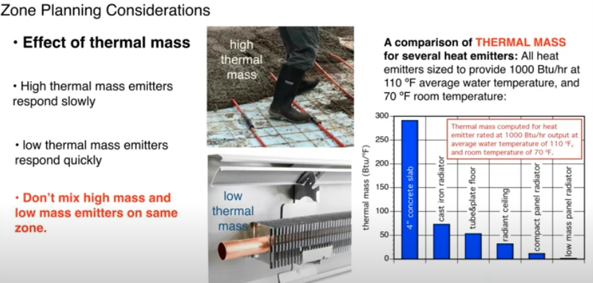

    here is a graphic of mixed emitters

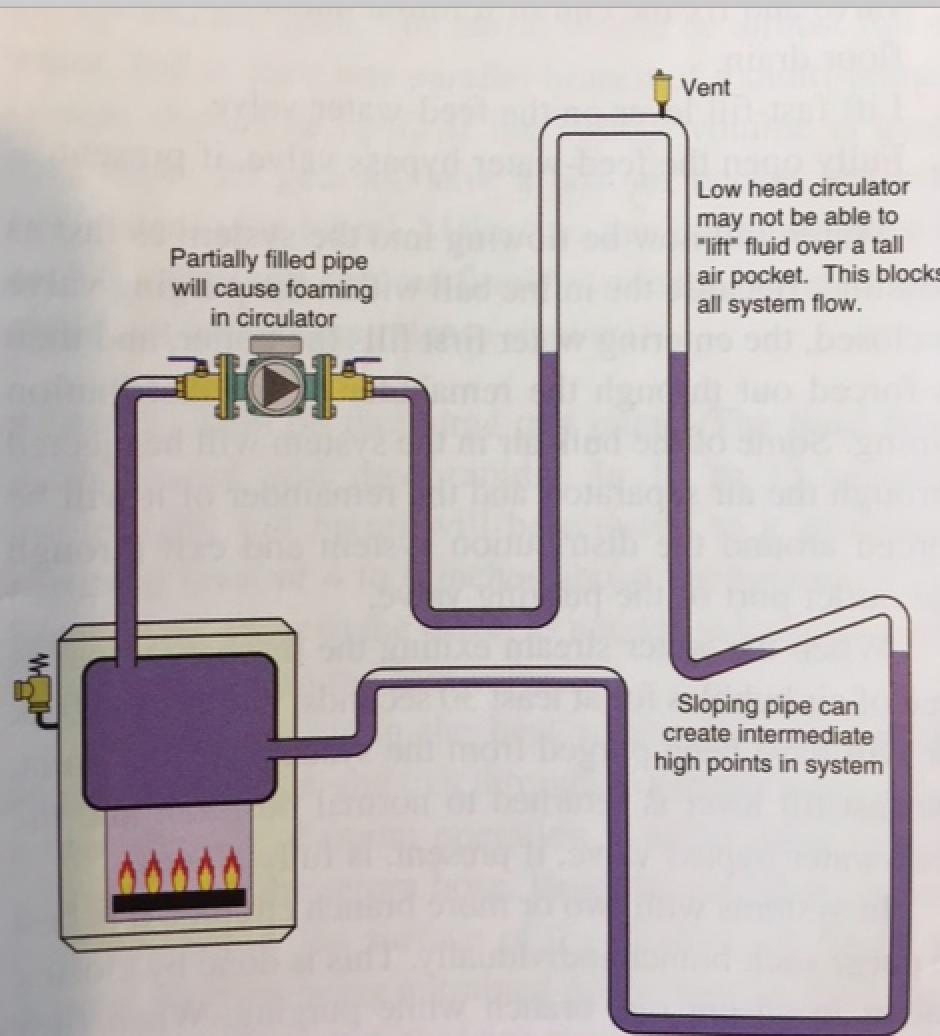

    And the challenge with up and downs in the piping
