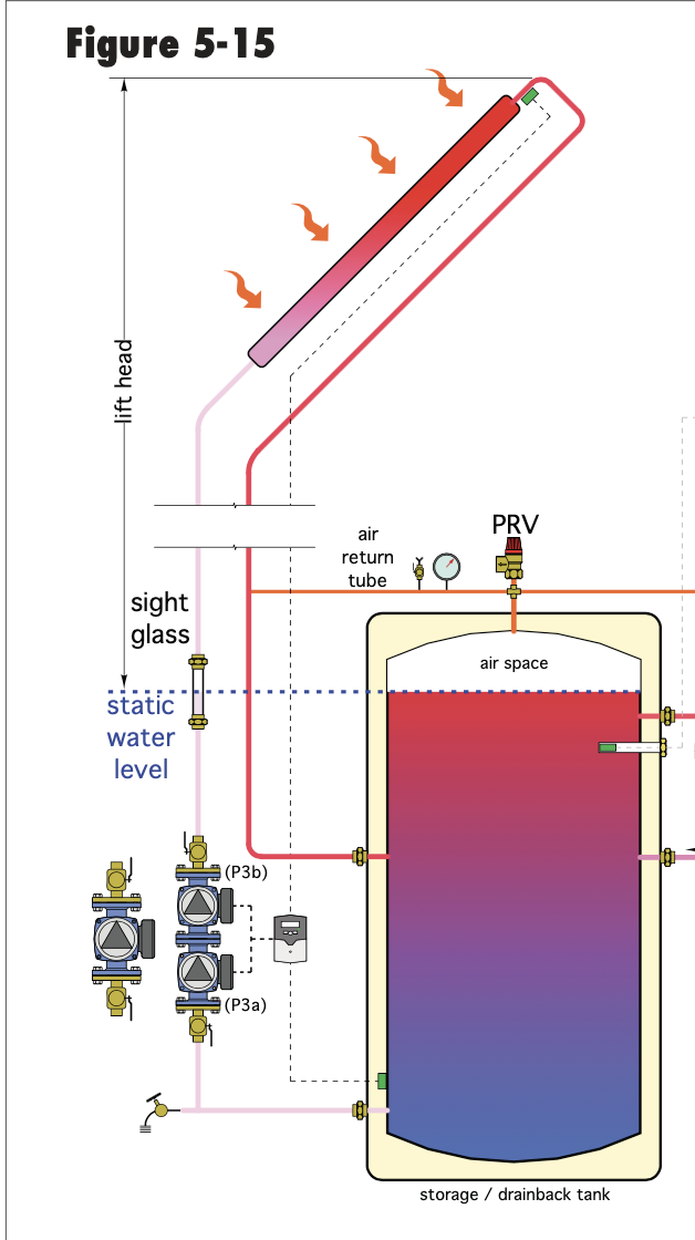

    hot_rod Member Posts: 27,302
    A few thoughts, I agree circulator pump is the best description.
    A DHW recirc pump morphs between a closed and open loop to some extent.
    A circulator used on solar drainback starts out as a "lift" circulator pump. Able to lift water to whatever the head capability. So "lift head" as opposed to head.
    I think any pump could be used as a circulator? It's pump curve would indicate it abilities
    Head - the mechanical energy contained in a fluid
