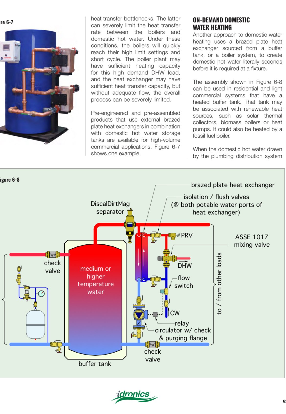

    hot_rod Member Posts: 26,619
    here is the common way to use a hx for dhw
    A small flow switch on the cold feed turn on the pump or zone valve
    Sika and Harwill are two brands I have used. Trigger point at .35 gpm flow
    Of course the boiler will need to be maintained hot all the time. With a solid fuel boiler you cannot wait 20-30 minutes to fire it
    You can generate 120f hot water with boiler temperatures around 140f. Even lower if you up size the hx

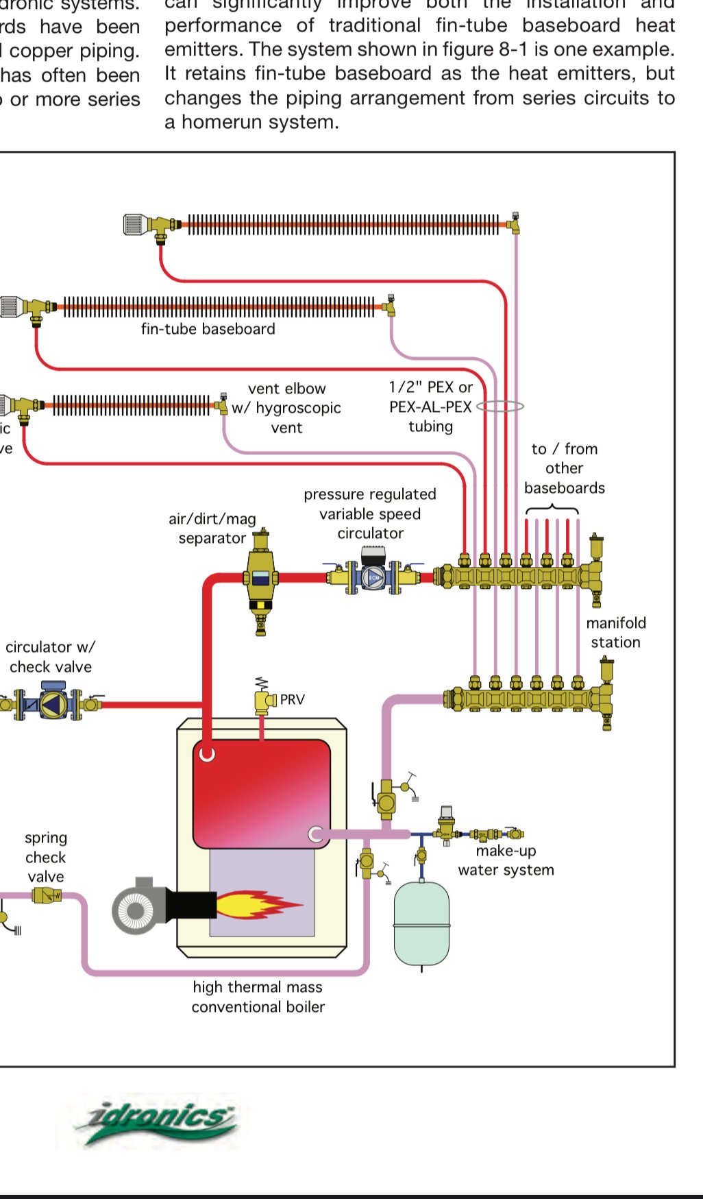

    I would suggest a home run system with 1/2” pex to every radiator. It could be zoned with TRVs or with electric actuators. This is in the realm of most DIYers
    An example with fin tube
    The plate HX just after the pump before the manifolds

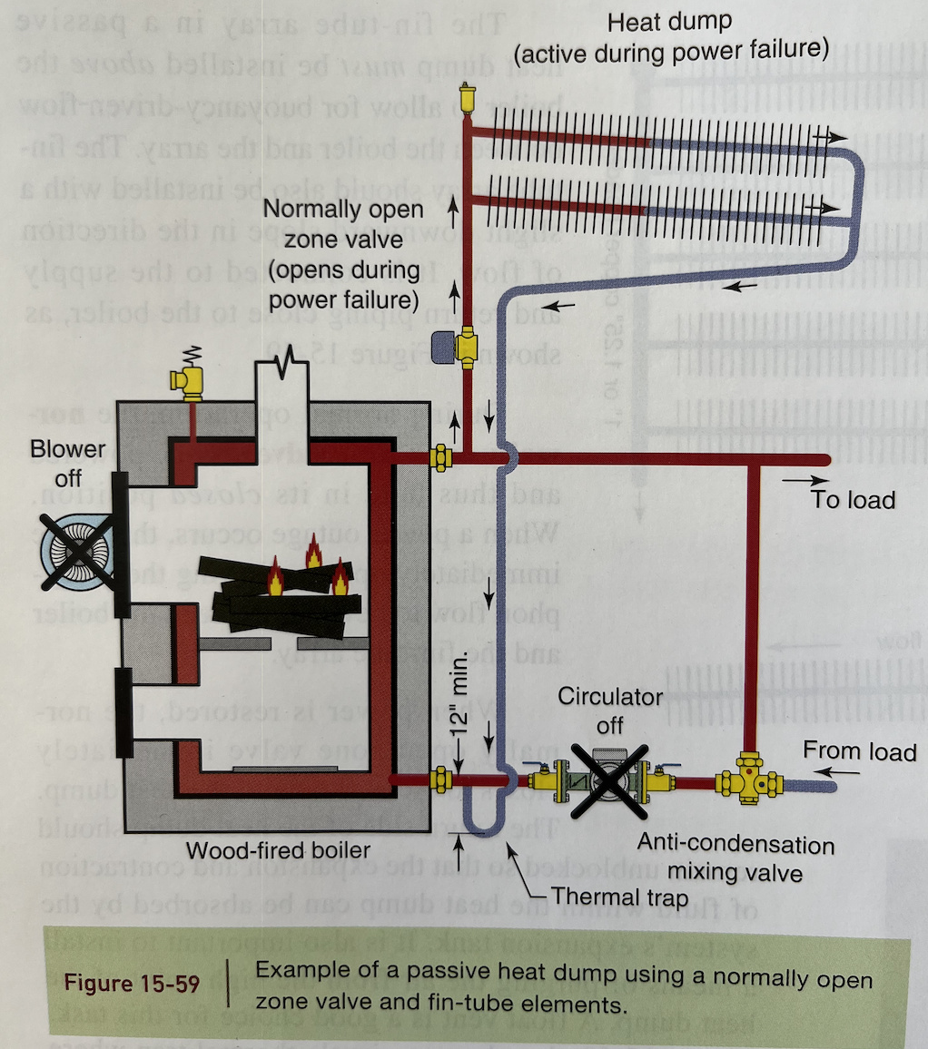

    The piping could look something like this. A single delta P circulator, zone valve for DHW hx, manifold distribution. Trvs on radiators.
    A dump zone with a N.O. zone valve could be added. Some large diameter fin tube works well for a power outage gravity dump. Or a IPS to run the pump for maybe 4 hours.

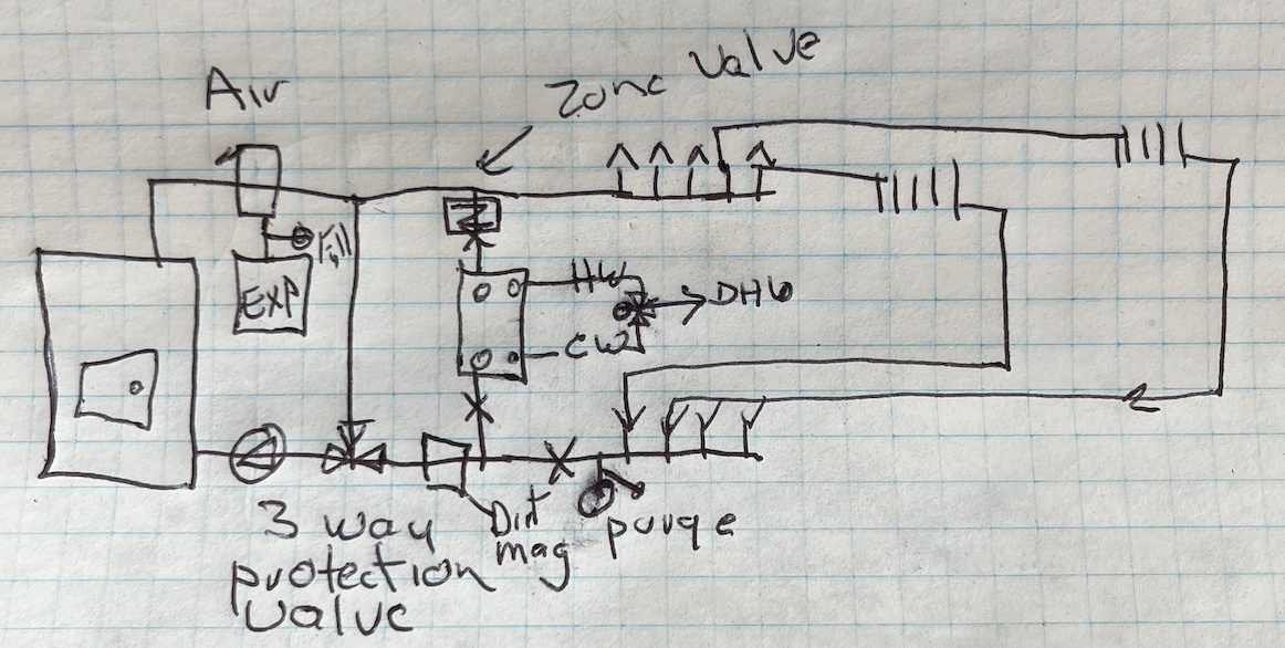

    Forge_Fixer88

    Forge_Fixer88 Member Posts: 18
    My end goal is a wood boiler supplying heat and dhw with some type of fossil fuel backup. I want to plumb it in such a way that I can add storage in the future and is not impossible to convert to fossil fuel only. Will parallel piping keel from sending heat up the unused heat sources chimney.
    Parallel piping shown on the cover of Idronics #10. Flow only goes through either boiler when it is running, so no flow through a boiler that is off. There are two check valves also one in the pump, one on return so no gravity flow if the boiler is mounted above as shown.
    Piping depends a bit on the type of boiler and buffer size.
    IF you end up with a mod con for backup, and a large tank over 150 gallon, then I would pipe the mod con to the tank so it only heats the top portion, just enough for the DHW production.
    Since a mod con can modulate, no need to always heat that large tank.
