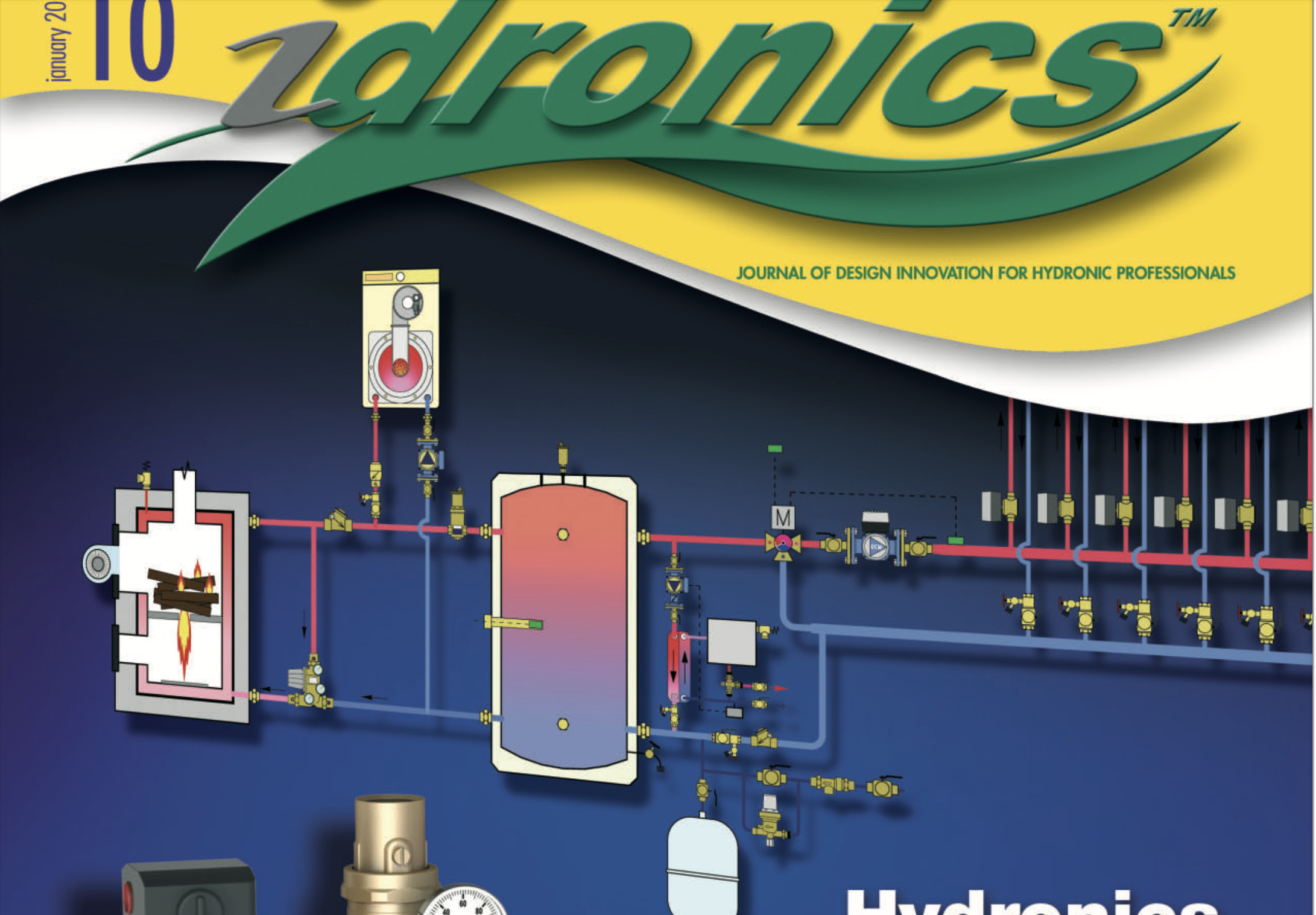

    Some piping ideas here.
    https://www.caleffi.com/sites/default/files/media/external-file/Idronics_10_NA_Hydronics%20for%20wood-fired%20heat%20sources.pdf

    If you read that Idronics we suggest D I mp handle a full fire box of fuel, same with the power outage dump zone

  • My end goal is a wood boiler supplying heat and dhw with some type of fossil fuel backup. I want to plumb it in such a way that I can add storage in the future and is not impossible to convert to fossil fuel only. Will parallel piping keel from sending heat up the unused heat sources chimney.
    hot_rod Posts: 28,705
    Parallel piping shown on the cover of Idronics #10. Flow only goes through either boiler when it is running, so no flow through a boiler that is off. There are two check valves also one in the pump, one on return so no gravity flow if the boiler is mounted above as shown.
