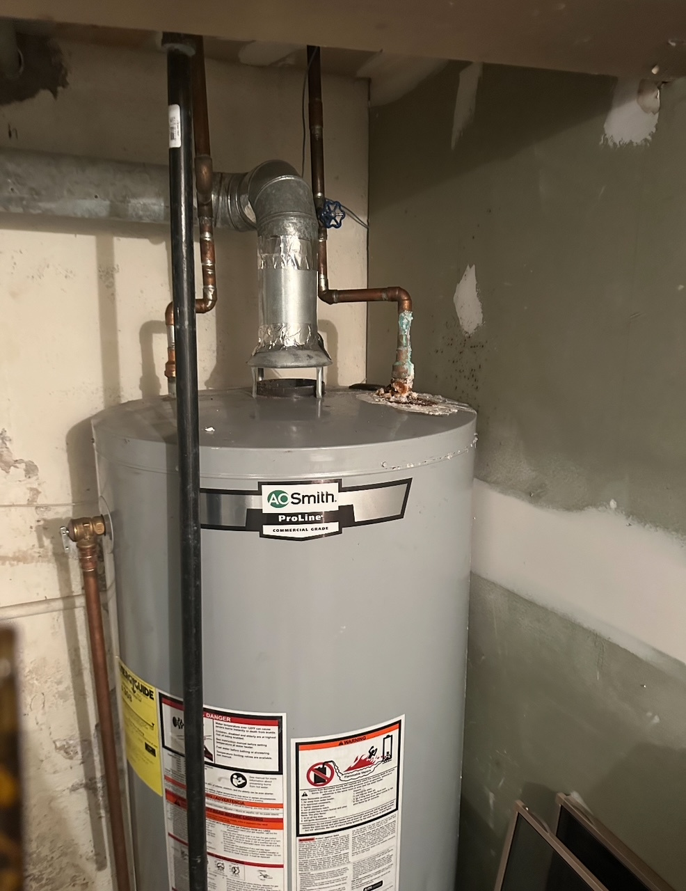

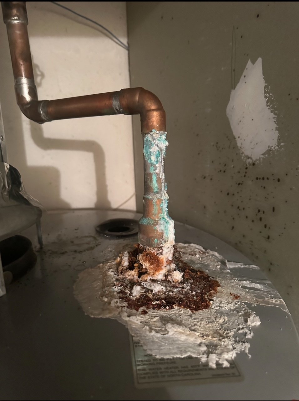

A family member is dealing with a water heater issue. There is a significant amount of calcification and rust that has developed on the cold water side of a 75 gallon AO Smith ProLine installed in 2021. The plumbing company that installed the water heater claims that the tank has corroded and needs to be replaced through the warranty. They want what feels like an extremely high price to perform the labor to replace the water heater, including a shipping and handling charge from the supplier. The question I have is, does this look like a tank corrosion problem? Or does it look like someone didn't sweat that elbow properly when the company originally installed the tank, resulting in a pinhole leak and then the corrosion, rust and calcified water? I think it's the latter, and I'm concerned that this company is trying to pass the buck on their poor install to AO Smith.
Can anyone give me advice on how I should assist my family member in fixing this issue? A new tank would be great, but it feels like this company is scamming AO Smith, and asking for almost the original cost of tank and install to swap in the new warranty tank. Or am I totally off base and the tank could have caused this? Can you initiate a warranty tank swap using a different plumbing company than the one who installed the original tank?
Thanks for any help you can provide.

    there could be more than one issue but you can look right at it and see it's leaking at that elbow. wild that nobody stocks the regular AO smith 75 gallon tank around and you have to pay shipping in addition to labor? AO smith brands also do a program through distributors that will cover a portion of a contractors labor fees, not going to post a number here as its prob market based and might have changed but at the time it covered maybe half of our more expensive contractors hourly rate. But yeah they don't cover 100% of labor rates, you can try contacting AO smith directly to see if they have a better solution, I know when I had a contractor complain about the labor rates they offered to have one of their partners come do the job and we all agreed we didn't want to have someone do the replacement that worked so cheaply. This may have changed in the past couple of years, it's usually just not a huge deal, water heater changeouts can be pretty quick

    Hi, Is the tank itself actually leaking? If not, I'd replace the cold-side plumbing down to the tank, replace the anode rod and keep going. I'd also use a different plumber. The old gate valve should have been replaced, along with having unions at the hot and cold connections. In the West, we almost always use flex connectors, which would have prevented any strain on the copper sweat joints and given unions. 🤠

    If the original installing plumber (company) was reputable and ethical, they could clearly see that they did a less than stellar job soldering that connection. Although 4 years is a long time, If I was that contractor, I would fix that for free and ask you if you wanted a service agreement that covered routine maintenance on that water heater and the heating system. If you declined the service agreement, I would still fix that for free, then use a wire brush to clean up all that calcification and rust. Spray paint the rusted portion of the water heater and tell you to keep an eye on that connection to see if more corrosion formed in the following 6 months or year. Then we can address the warranty issue at that time. It is clearly an installer workmanship failure and this guy sounds like he is in it for the money, not for the satisfaction of a job well done at a fair price.

    Yeah i just can't wrap my head around charging a handling fee to replace a water heater under warranty when you sold the original equipment, it's just not customer friendly at all. seems so clear that 90 was leaking, just fix it and keep the customer happy, clearly an install error.

    I think the plumbing supplier charges the fee. Not the plumber. At least that's how it works around here. New York City / Nassua. Typically $300 to $400, depending on the size of the water heater. Regardless, I would doubt that's covered under warranty. That's almost 100%, a piping issue and not a water heater issue.
    Larry WeingartenEdTheHeaterMan
    pecmsg Member Posts: 6,523
    I see an installer defect not a heater manufacturer defect!

    Larry, The tank is not leaking. I suppose its possible that the inner tank has been damaged by this leaking water and is rusting or corroding but I doubt it. I offered to clean it up with a wire brush and re-pipe the cold water side but they want the plumbing company to do it/pay for it.

    That is not an AO Smith issue! The installing contractor has a bad fitting that leaked and caused the damage. Its all on them and not the manufacture.

    Hard to tell. The leaking sweat job was an install issue no doubt. Did the leaking elbow cause the dielectric nipple to corrode or was the dielectric joint also not made up properly?.
    And on another note, why would AO smith cover a WH replacement for an installer hack job.
    But the damage is done if AO will provide the tank then just change it out.
    I think the original plumber is trying to pad the bill

    I do think that you can salvage the tank. Replace the nipple and female adapter.
    I would add a vacuum relief valve while you are at it…

    or make them fix it for free. that didn't happen by itself, that has existed since it was installed.

    is the packing for the valve for the tank loose too? i see a drip off the next ell too
