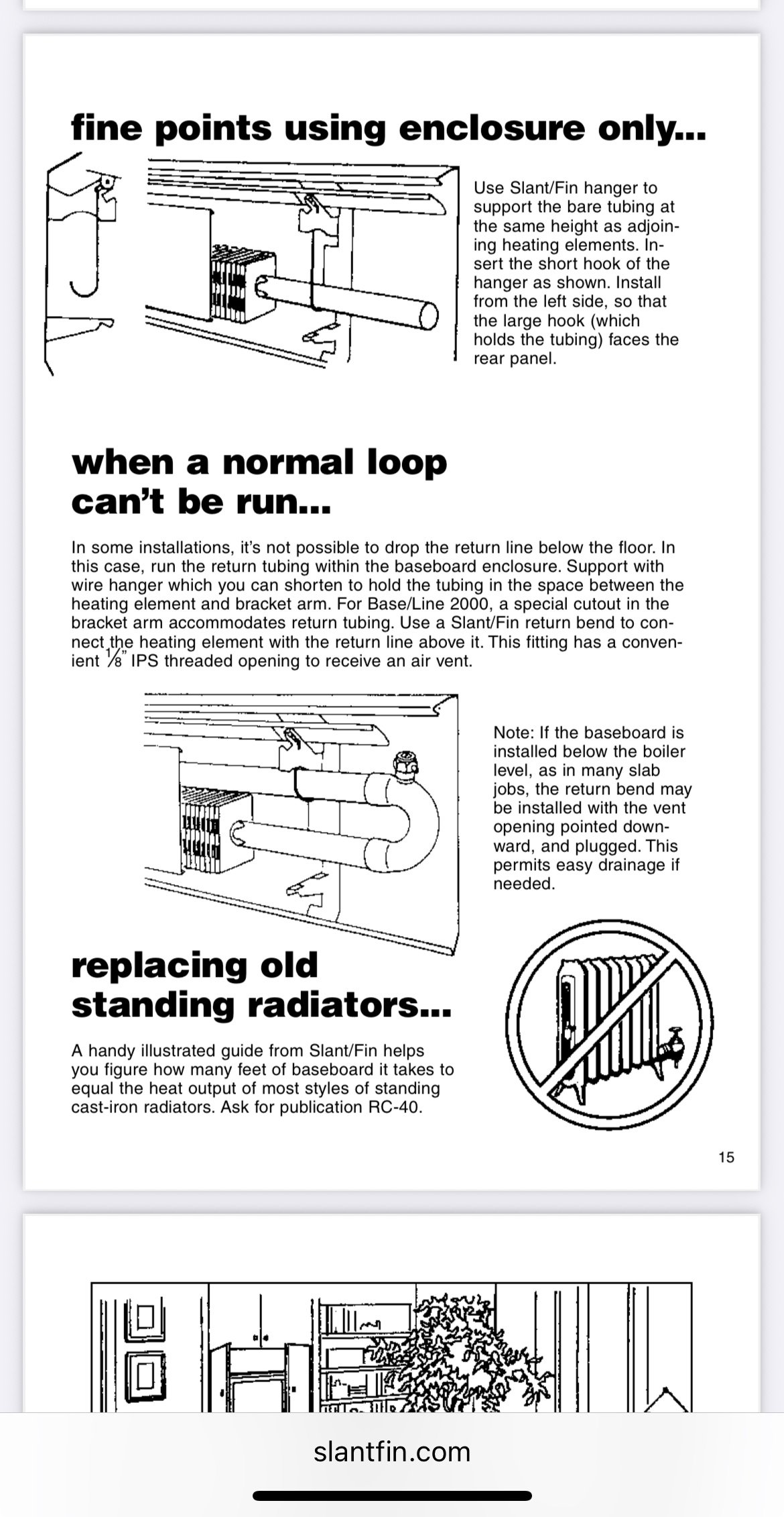

    @EdTheHeaterMan I have seen contractors run the supply on one side of a baseboard and then on the opposite side use a 90 and a street 90 and bring the pipe back over the top of the fin tube hidden inside of the baseboard cabinet so both pipes come out on one end? My only question to that is how well does it put out heat piped like that due to the air gap needed for convection. And Thank you for the diagram and your time

    I was just going to suggest that. This will save a lot of cutting. Some profiles even have a chase for the return pipe. The pipe is typically against the back side where the louvers cover it anyways so won't effect output. Adding a vent/bleed elbow on the return will make it much easier to get the air out.

    the Viega FostaPex in straight 20’ lengths was good tube for running inside the fin tube enclosure.
    The return tube can also run below the fin if you make some hanger wires.
    Regular pex or pert in straight lengths will work but needs more supports and expands/ contracts more.
    Look for a brand of tube with the outer UV layer

    Installing a U turn at the end of the baseboard to loop the return back to the same side as the supply has no adverse effect on performance. That will reduce the amount of trenches needed by half. I would not use PEX for that return because it will want to flop around inside the enclosure, but that's just me. I want to look inside the louver and see a straight piece of pipe. If your return pipe is below the element, then that may cause some air flow blockage especially when the carpet installers redesign your heating system by blocking the bottom air inlet with extra padding and thick plush carpet. I have told 3 different customers that the carpet is blocking the air flow. This is usually on the coldest days in the winter when you need the radiator to perform at its best. A radiator that is blocked will offer partial heating capacity, and in the mild weather all you need is partial capacity. You only need full capacity when it is the coldest outside.

    the SlantFin brand had the carrier brackets designed to leave room for the tube up top

    Sterling also ran the return over the top of the element with little U shaped wire hangers.
    To avoid any issues I would pipe the return with 1 street elbow and 1 regular elbow (so it lines up correctly) and pipe it in copper to the other end where both supply and return connect to the pex. No drooping pex or hanger issues.
