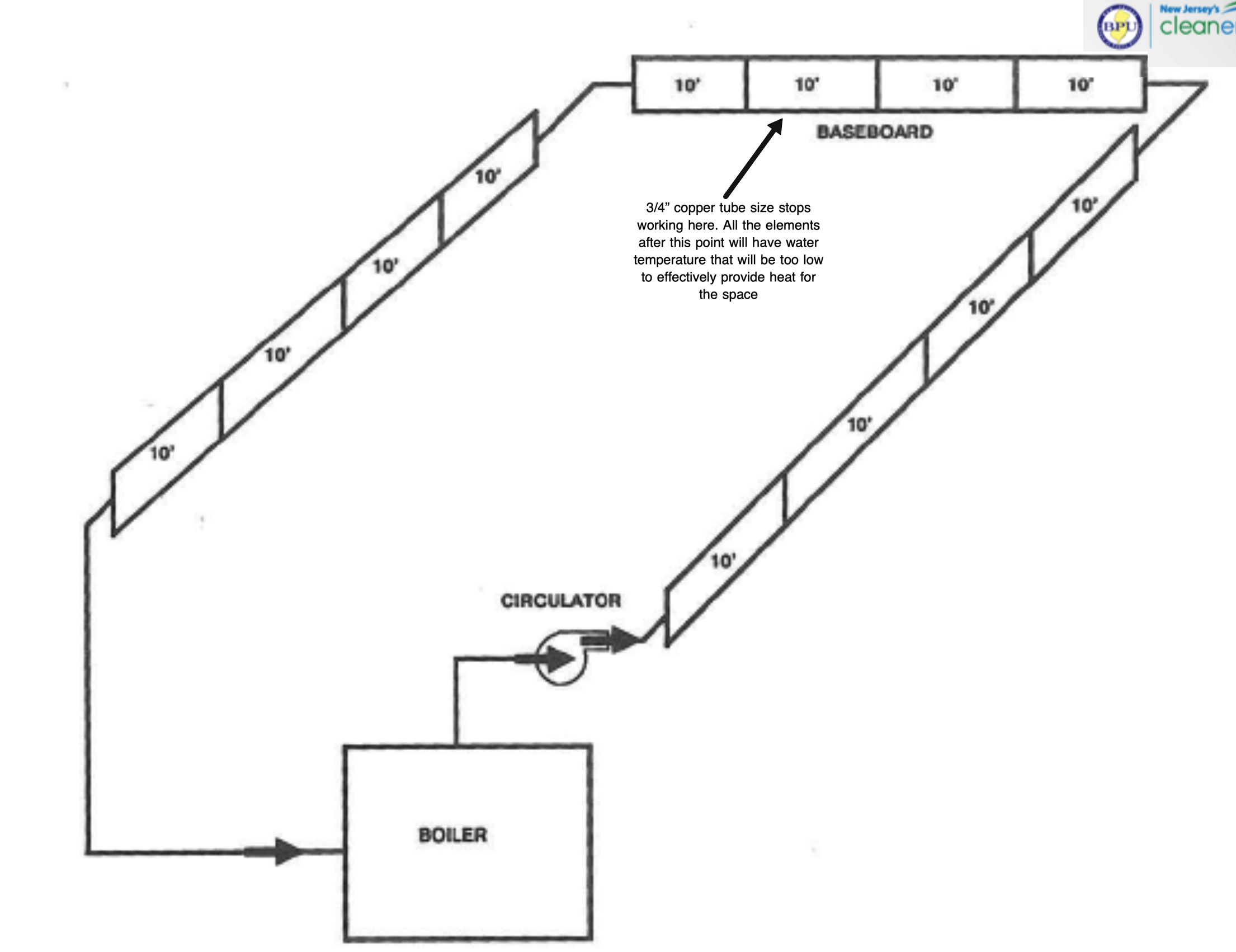

    This is a slide that I used to teach Hydronics for the Eastern Heating Cooling Council.
    It illustrates that running 120 feet of 3/4" baseboard in a series loop will not work past about 78 feet. So the service call might be not enough heat in the last three rooms on the system but the rest of the house is just fine. This call will happen only on the coldest days of the winter. The milder days will eventually get heat form that poor piping design.

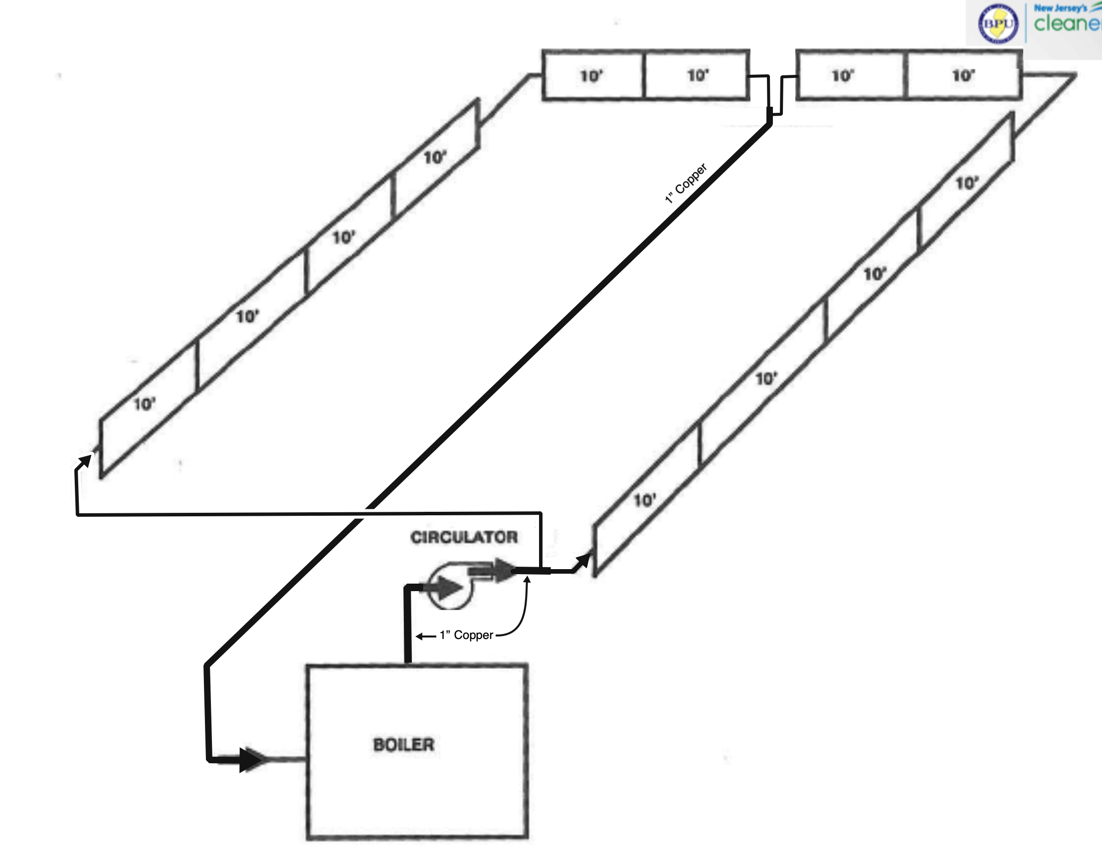

    This next slide shows how to fix the problem without a major repiping of the entire system. Take the radiators that are connected to the return and place them on the supply side of the boiler. Increase the common pipe from the boiler to the circulator to 1" and use a 1x3/4x3/4 tee fitting to connect both loops to the supply. Take the mid point of the system so that there are about 60 feet on each loop and run a common 1" return back to the boiler.
    I actually did this for a customer that called me up for a price on a new boiler because the old boiler was "too small". Three other contractors bid on the replacement boiler without thinking about the fact that a new boiler with this top illustration's piping arrangement would not solve the problem. For less that 10% of the cost of a new boiler I was able to solve the "too Small" bpoiler preoblem by increasing the pipe size and splitting the series loop into two series loops.

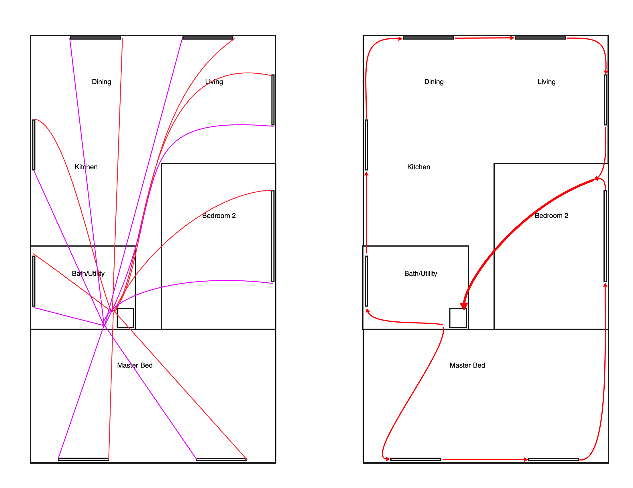

    If you are operating one boiler for the entire building and this is just one of the apartment units then you can run 3/4" from the manifold location back to the central boiler room. Just look at this mockup of a 950 sq ft two bedroom layout with 8 baseboard radiator units. there is a lot of cutting needed for the home run system even if you can get a lot of them to a central "shared" trench for a part of the distance from each radiator to the manifold location.
    There is a lot less concrete cutting with the series loop design.
