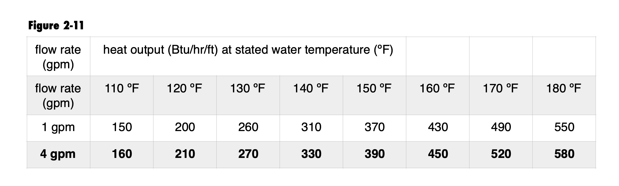

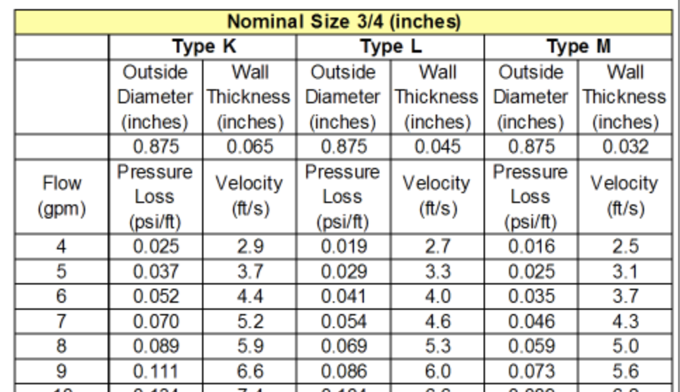

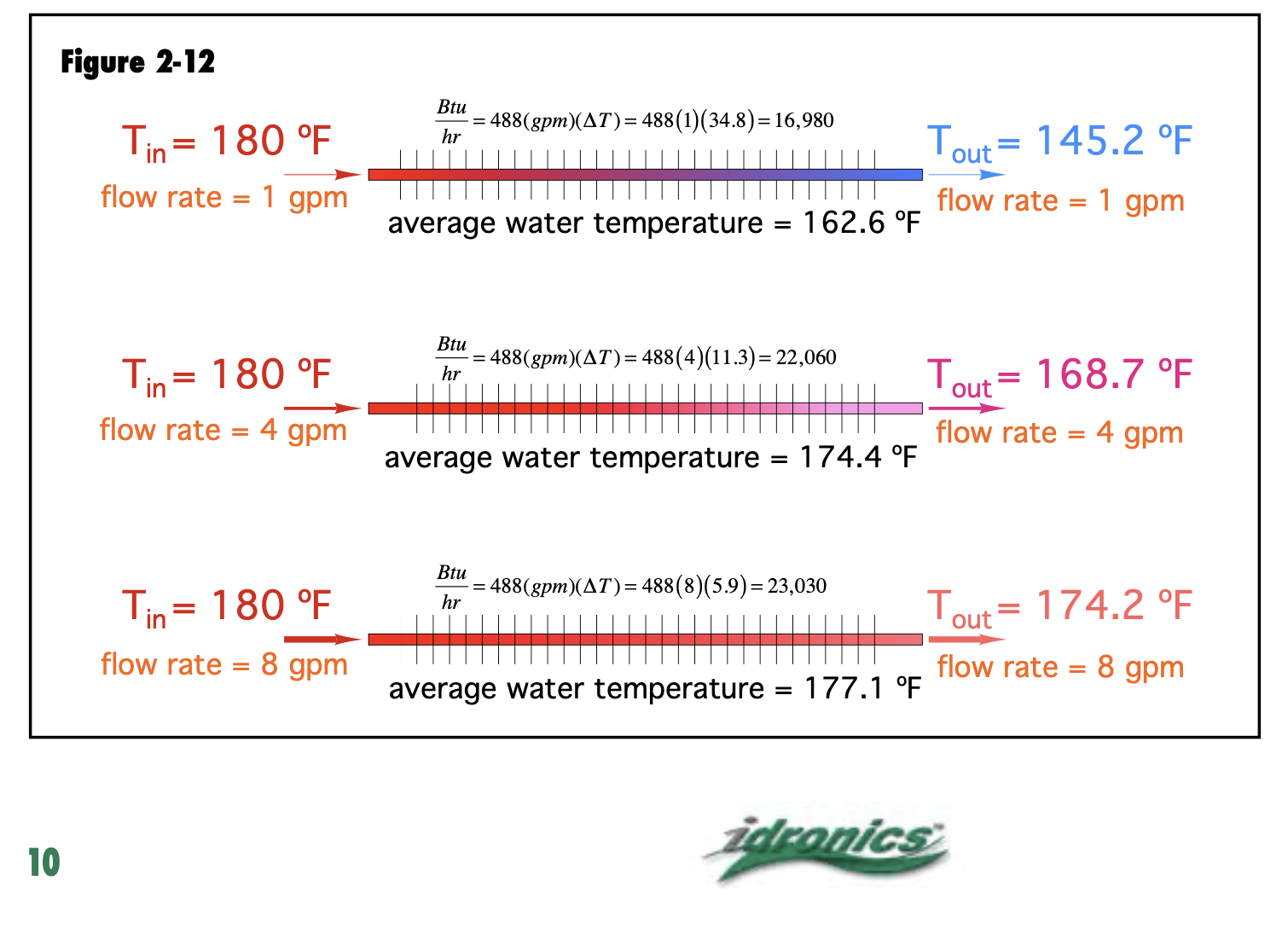

    .Not to worry about that ∆. The delta is always moving a bit until you reach thermal equilibrium. The point when temperature has stabilized, not increasing or decreasing across the loop. At that point you should be at design ∆. Probably most systems never are, as @Kaos suggested. It is rare that an installer checks these numbers. It could take hours, days, for a large concrete slab to reach thermal equilibrium on cold start up.
    Lower delta= higher heat transfer rates. It does cost a small bit more pumping, and you want to stay below 5 fps velocity to keep things quiet.
    Here is the rational for the increased output:
    Screenshot 2025-10-06 at 8.23.19 AM.png Screenshot 2025-10-06 at 8.26.48 AM.png Screenshot 2025-10-06 at 7.54.55 AM.png Screenshot 2025-10-06 at 8.18.53 AM.png
    You would need to get up around 8 gpm in 3/4 M copper to exceed 5 fps
    Idronics 23 is a good read for understanding heat transfer in Hydronic systems

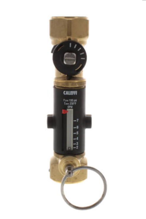

    Lots or residential insyallers that want to know or check flow rates install Quicksetters as you do not need a $3000.00 B&G delta P meter to read them :)

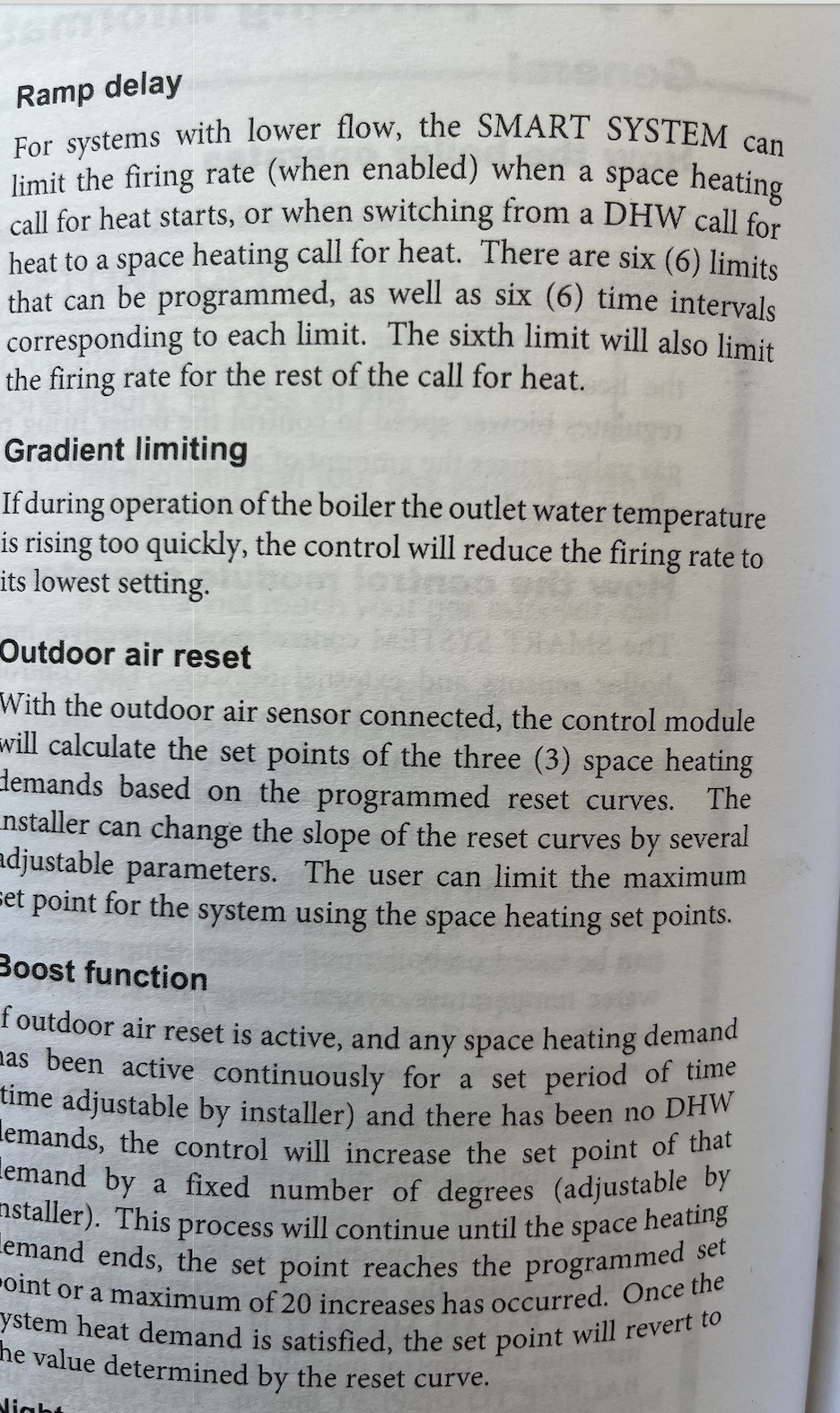

    I've used all; these functions on my Knight. It takes some trial and error to get it set exactly to your application. I really like this control.
    Properly dialed in you can get close to continuous firing, a very efficient operating mode.
    The ramp delay takes some practice, don't get too aggressive or you delay heat.
    I know the boost overides the ODR, but not sure if it over rides the ramp delay?

    I would be careful with telling owners to mess with boiler settings, I know of only a handfull of people that should. Set the reset target to what the system used to run at before and call it a day. If the fuel is expensive like propane and the owner wants to get that couple percent extra efficiency out of the system, they can pay for half a day during a cold snap to watch paint dry while dialing the settings in.
    I would be careful with those advanced settings @hot_rod linked to. The one that is worth while to set up is the boost function, the rest I would leave alone.
