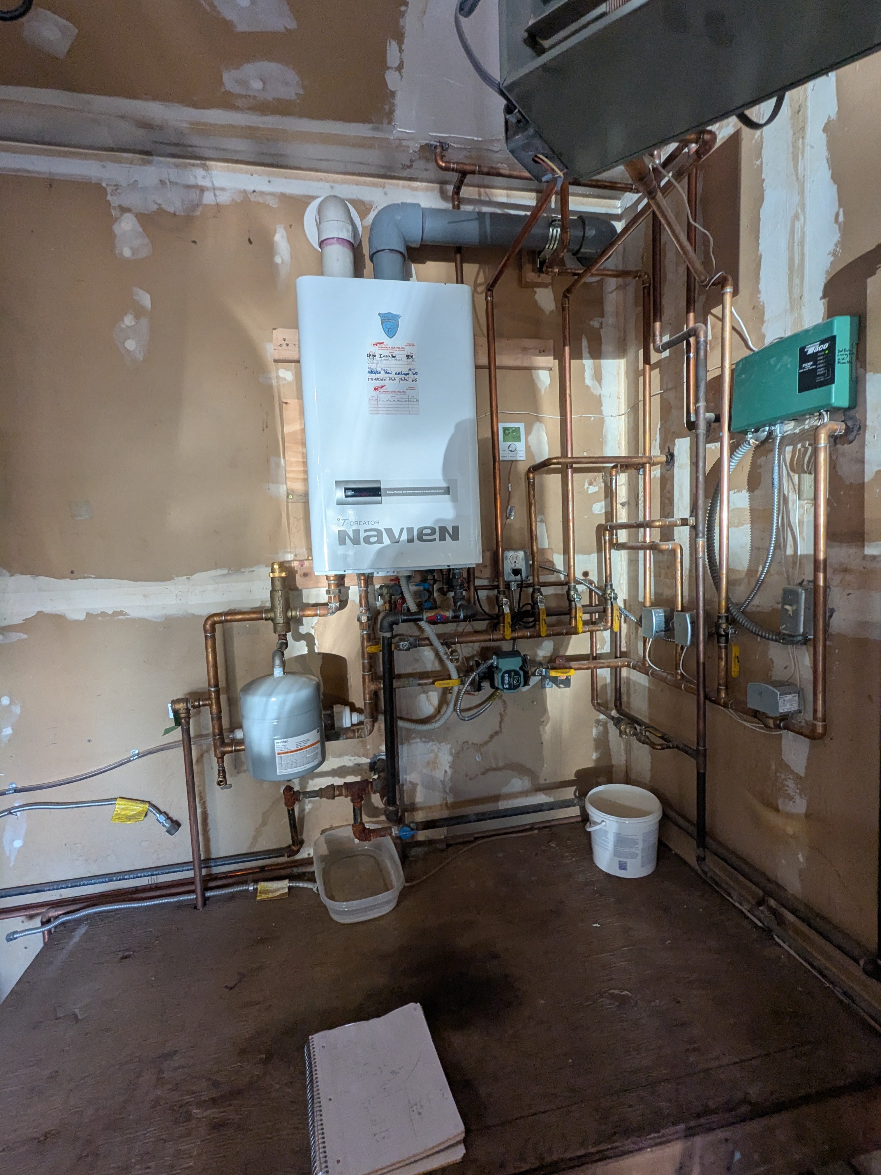

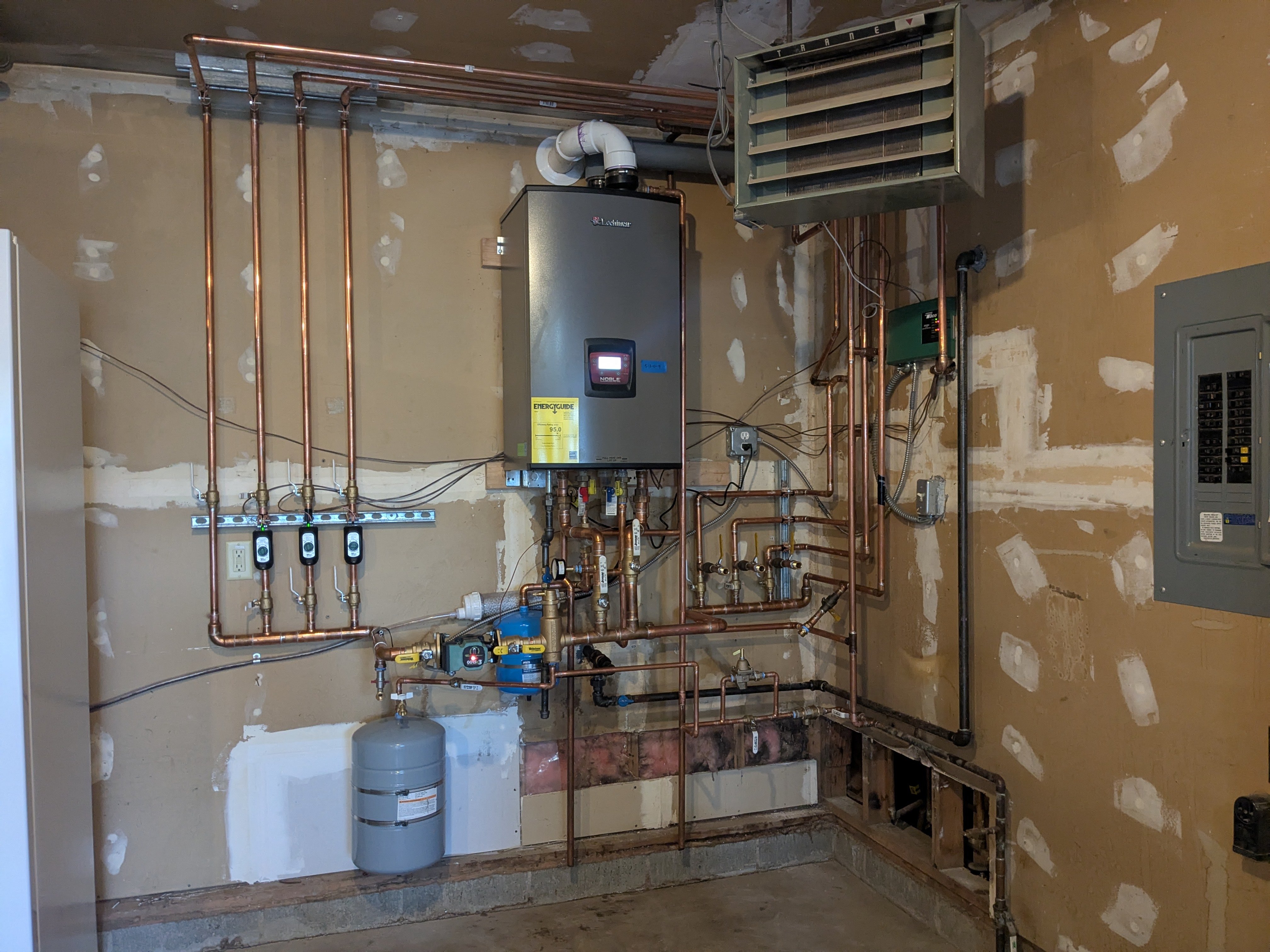

Hello all,
I am new to the mod con, combi world. I moved from an area that had fuel oil only so this is my first go at installing these new units.
I have a before and after picture here of a Navien that I replaced with a Lochinvar.
I'm looking for feedback on if I accomplished the goal of primary secondary. The Lochinvar has an internal system pump so the boiler loop is the primary.
I got the idea for the "moose antler" installation from either a Taco after dark or coffee with Caleffi webinar where it was suggested.
I made the primary and manifold piping 1-1/4" because the boiler is 199,000 BTU.
I have more of these installs lined up so please let me know what I can do better. Thanks!

    Why would the water flow out through the system instead of through that bypass?

    I think your neutralizer is upside down, the outlet wants to be high to hold back a reservoir there, for more neutralization time,

    Very clean install, easy to service. I find manifolds add a lot of value and save significant install time. If you need more flow than the typical ones, Watts has high flow series that will do 4GPM per port.
    Besides the correct hydraulic circuit, the other important bit is the setup and configuration. Is the outdoor sensor installed? A reasonable reset curve to match emitters? Space heat limit set to a reasonable value above expected space heat load? These bits are just as important as it will effect the actual efficiency of the unit and how much it will cycle. Short cycling is the silent killer of modcons. Also a bit of education of the home owner to understand that with outdoor reset recovery will be slower so they have to change the programming on their thermostat.
    One small improvement with any combi or tankless unit. A small 5 gallon plug in tank with 3/4" ports on the outlet of the unit will eliminate any wait time without having to keep the boiler running by enabling combi pre-heat.

    When installing these, one thing to do is allow as much room as possible for serviceability. All too often these things get crammed into tight spaces.

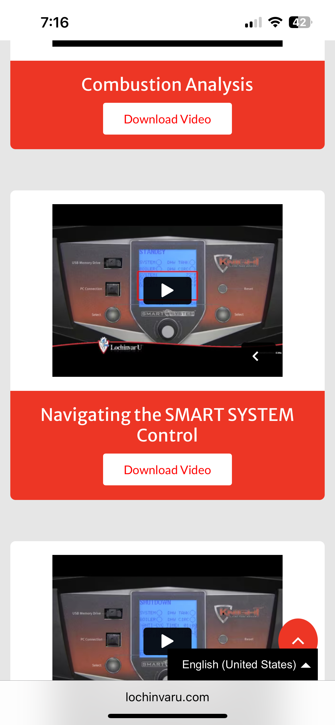

    There are tutorials at the Lochinvar site and plenty of installer you tube demos
    https://lochinvaru.com/videotutorials/models-kh-055-285/
  • I think it looks great. The only thing I would have tried to do if I had the time would have been to paint the wall behind the piping. Love Lochinvar though.
    Rick
