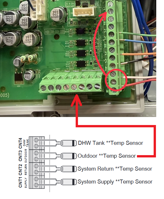

I recently had an NFB 175H boiler installed along with an indirect water heater. My question is about the installation: the installer connected the indirect water heater thermostat to zone three instead of using the dedicated DHW block. Zones one and two are used for my baseboard radiant heat. When I asked why it was done this way, the installer responded, “We prefer to pipe it as a heating zone because it simplifies troubleshooting in the future. We could have piped it directly off the manifold, but that can make it harder to diagnose a failure of the primary pump. That’s why we did it this way.” Does this make sense?
    109A_5 Member Posts: 3,684
    edited September 2025
    Well, is seems it is more than just moving the two wires in your annotation, but not enough to avoid it. How does the boiler (or the system) control the water flow through the indirect water heater ?
    IMO doing it the way they seemed to have installed it (can't see the whole DHW loop in your pictures) you are loosing out of features the boiler has built in like DHW priority and maybe DHW temperature control by the boiler's user interface.
    I'm not sure I buy their explanation. So for ease of their (maybe future) troubleshooting you loose features and functionality, seems lame to me. They could close the isolation valves to the indirect water heater if that is messing up their troubleshooting strategy.
    Kind of seems like it is not piped per the instruction manual either (however I did not read the whole manual).

    Sorry, I did not see you added a picture, it seems Edits don't push the thread to the top of the queue or trigger notifications.
    It looks like they used a Zone Valve instead of a circulator for the DHW zone. Maybe a cost savings strategy on their part. If I understood the manual correctly. The way I believe the boiler is set up electrically (and logically) if you use the DHW thermostat input you need a DHW circulator. Since I suspect the boiler will not turn on the "Boiler Pump" or the "System Pump" circulators, it wants to turn on the "DHW Pump" circulator. (there are ways around that, but that just complicates things)
    It looks like the way they piped and configured the system, for you to have DHW the Boiler Pump AND the Zone 3 Pump (System) both have to be running and the DHW zone valve needs to be open. It may work but you probably loose the DHW priority and maybe other features and you are powering an extra circulator and a zone valve for your DHW.
    I would venture to say that is not what Navien intended.
    It seems when the DHW thermostat input is used it is the same as Zone 1 but with different features / functionality for DHW service.
    As far as troubleshooting (at least from a newcomers point of view) If you build the system different from what the manual shows that may add confusion, not making troubleshooting easier. Like a "not enough DHW" complaint in the middle of the Winter.

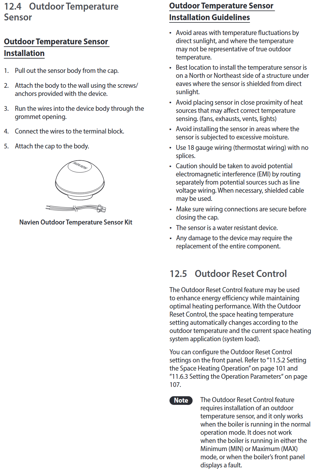

    As @109A_5 has indicated, you can set the system for the energy saving features but they may not work if there is no outdoor temperature sensor connected. Ask the contractor to connect the outdoor sensor so you can use the energy saving features the are listed in the manual. If they do not comply then ask for a refund for the inability to ues those features. If they are difficult, then start a social media campaign. I got results for a problem I had with handicap accommodations I booked 7 months in advance and with my less than 500 facebook friends, I got the hotel to solve the problem.

    Your pic of the boiler wiring doesn't have the outdoor sensor wire on it. So apparently they skipped it. That saved them time on the install!😏

    Get the installer back and have the wire properly with an outdoor reset and DHW on priority zone. As is, your boiler will probably run maybe 5-8 years before it dies an early death from cycling.

    Yup no wires there. And according to the manual the boiler comes with the Outdoor Sensor.
