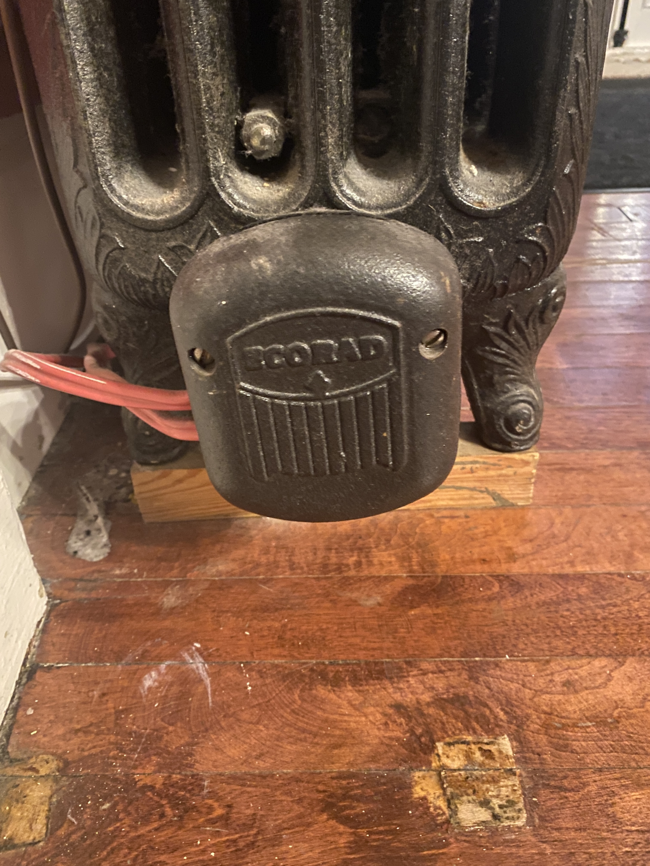

I spotted these attached to radiators in an AirBNB in Quebec City, I would guess they are some kind of electric heaters for water contained in the radiators.
Anyone know anything more about them?
Curious,

    I’ve not seen in the wild but here’s link to company.
    https://ecoradinc.com
    mattmia2 Member Posts: 16,043

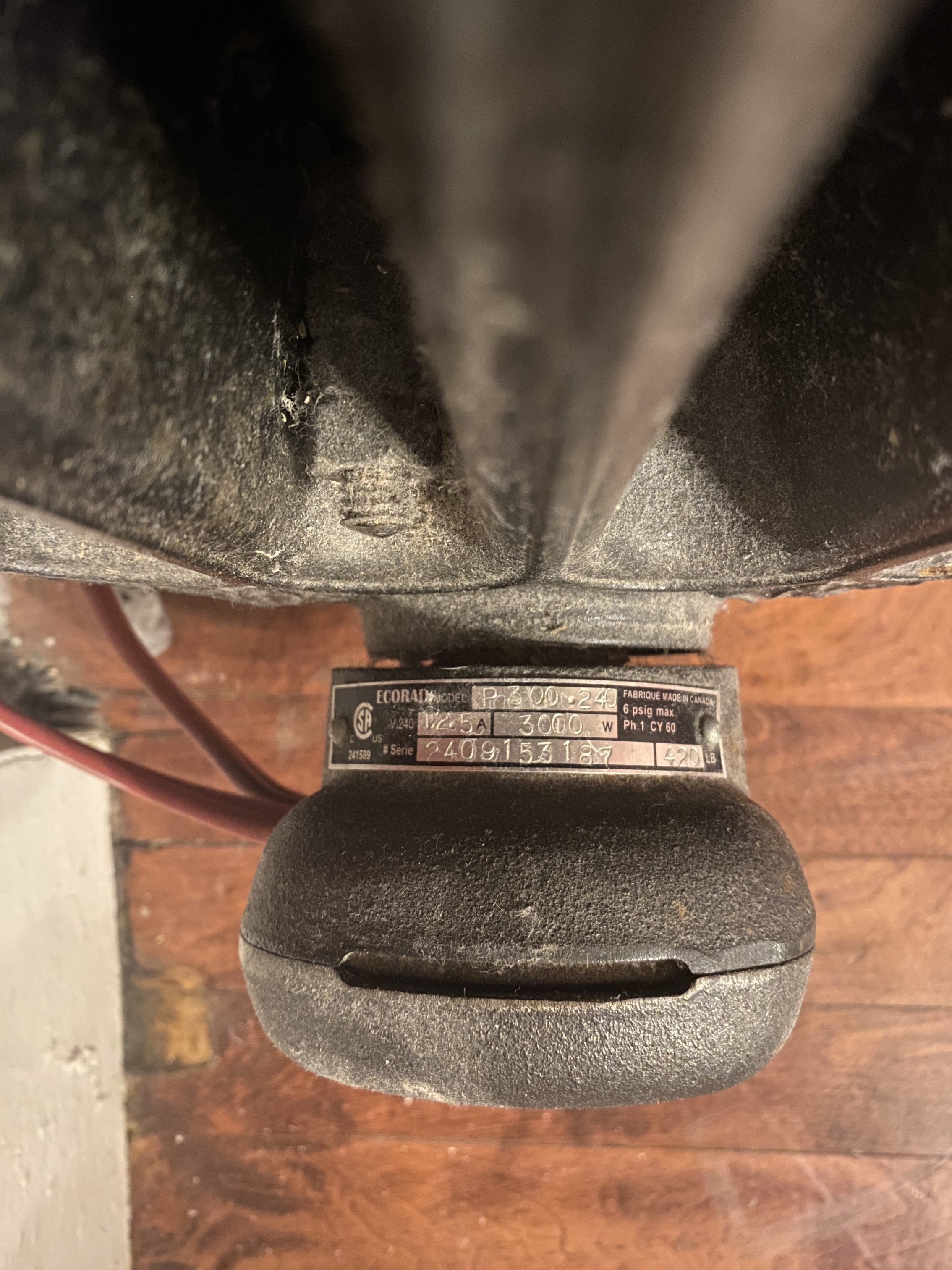

    right on the label, ecorad.
    interesting names for radiators that were made by the millions with other names, mostly by arco
    109A_5 Member Posts: 3,692
    Looks like an electric retrofit for Cast Iron radiators, maybe oil in them so freezing is not an issue.

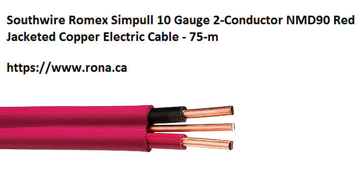

    Wonder if that is some type of factory supplied cable? Hope it isn't Romex. I suppose down low it shouldn't get overheated, but I don't like the looks of that.

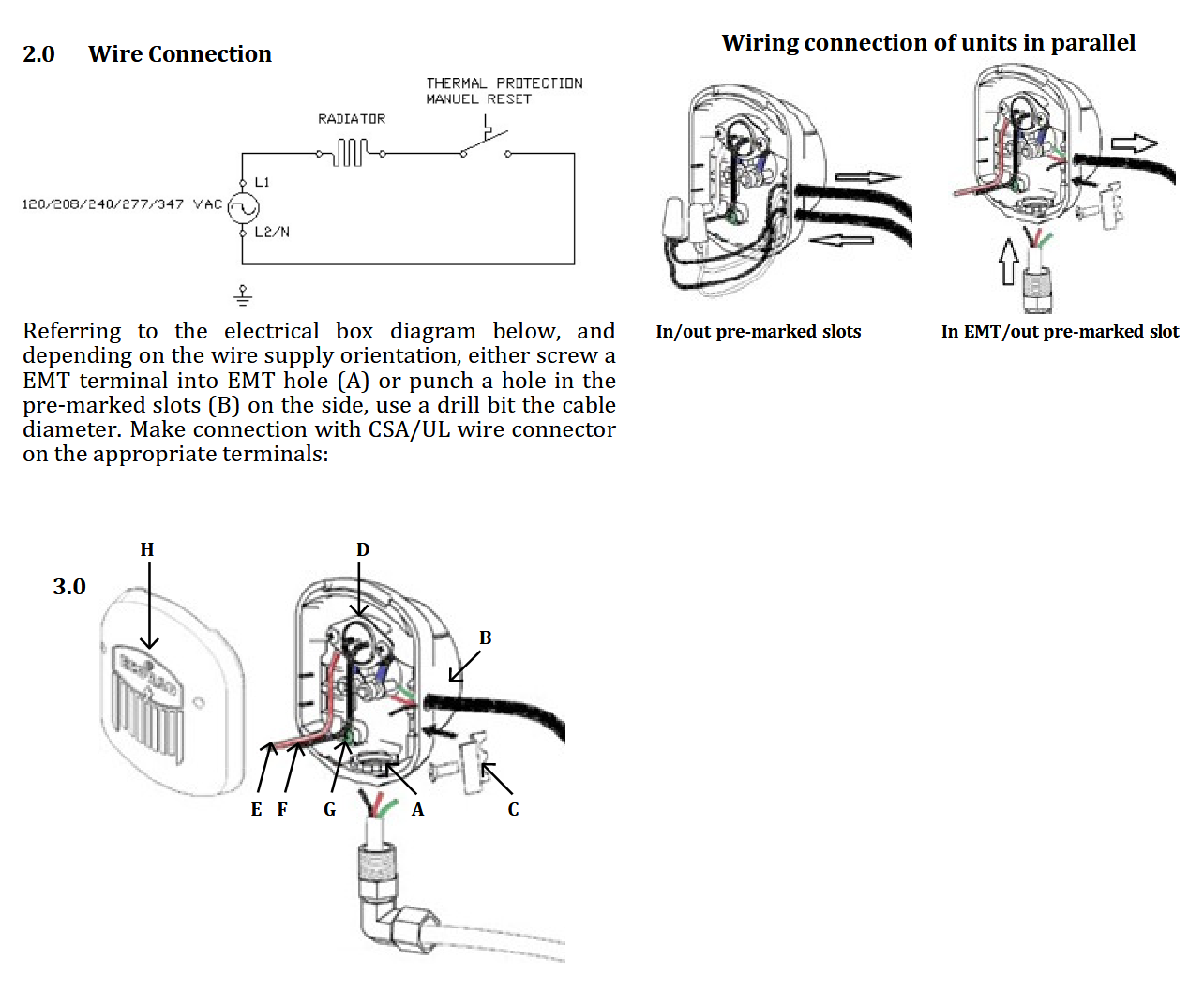

    he has a bunch of u tube videos. They refurbish rads. You can get them with the electric element only or use electric element and a HW boiler or boiler only.
    Says with electric you need 1 watt per cubic foot of room volume. I guess that is their heat loss calculation.

    No oil just water and antifreeze.

    looks like big zip cord. hope it is at least silicone or neoprene
    so not just the 3 conductor nm can get cut by the cable clamp because of its irregular shape that has corners the clamp can concentrate force on.

    I'm going for the 347 VAC version. Oops MND90 is only good for 300VAC.
    EDIT: Switching the Neutral… Brilliant !!!

    With regard to that cable I have never heard of "NMD" I think this is a Canadian spec.
    One difference between Canada and the US is that our Romex since the 80s the wire inside is "THHN" even though the wire itself is good for 90 deg C it is not marked as such and The NEC does not allow it to be used as such so it limits the cable temp to 60C.
    So #12 is limited to 20 amps and #14 to 15 amps etc.
    Why does this matter?
    Many electricians (including me) in the past have wired a 2 1/2 ton condensing unit where the MCA (minimum circuit amps) is 20 or under and the condensing unit calls for a 25 amp breaker and have used #12 Romex to go from the panel to the outdoor disconnect.
    This is no longer allowed in the US with Romex
    Over fusing is only allowed for motor circuits and AC units and has been done forever with no issue because motors and AC units have thermal protection to protect the circuit.
    Even though you can legally oversize the breaker compared to the typical wire size (#12 on a 20 amp) now you can only put #12 on a 25- or 30-amp breaker if the unit nameplate allows and you can only do it if the branch circuit is THHN and not Romex.
    However, the Canadien Code allows Romex to be used at its rated temp of 90C so it can be over fused.
    Some have petitioned the NEC to get rid of the stupid requirement of limiting our 90C Romex to 60C but the wheels turn very slowly
