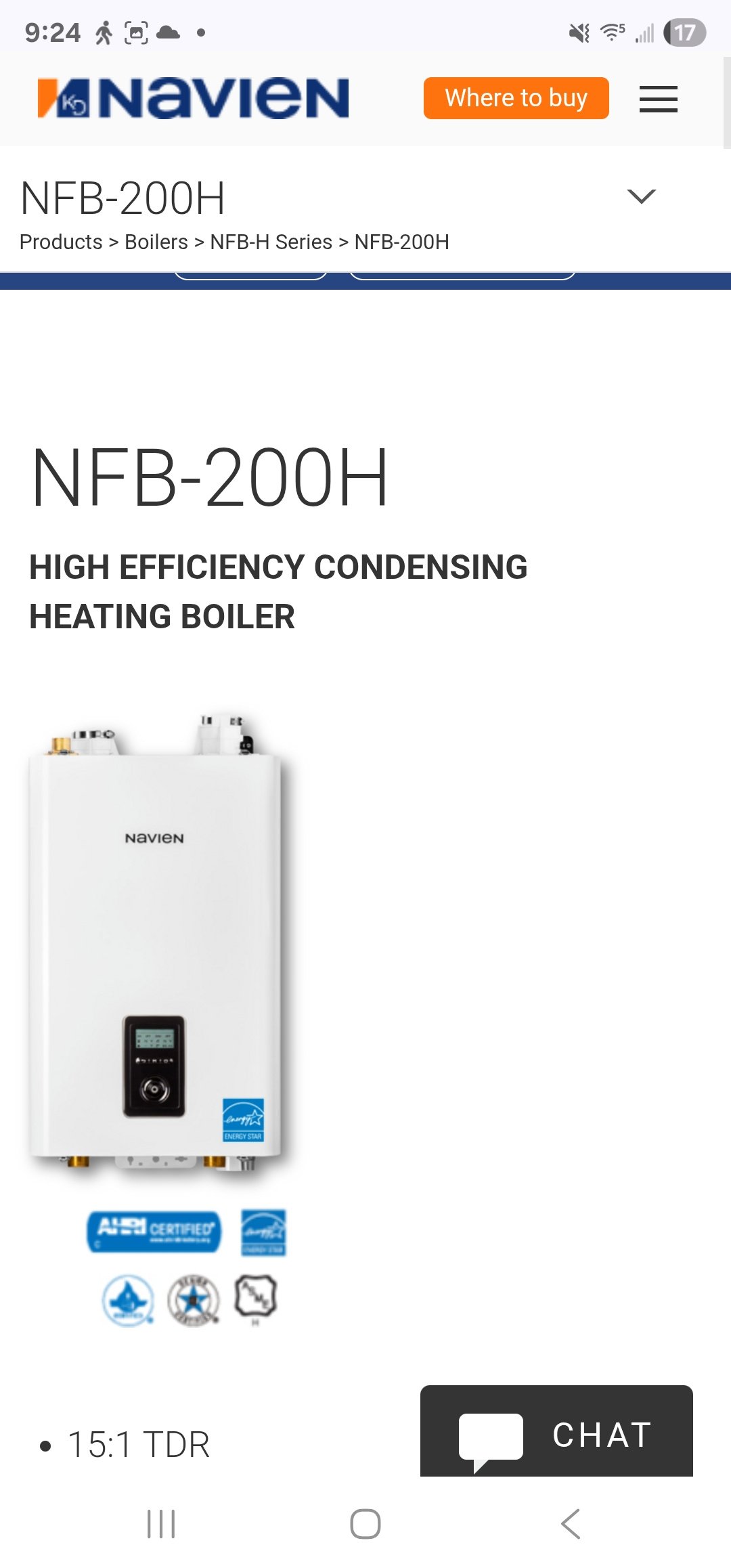

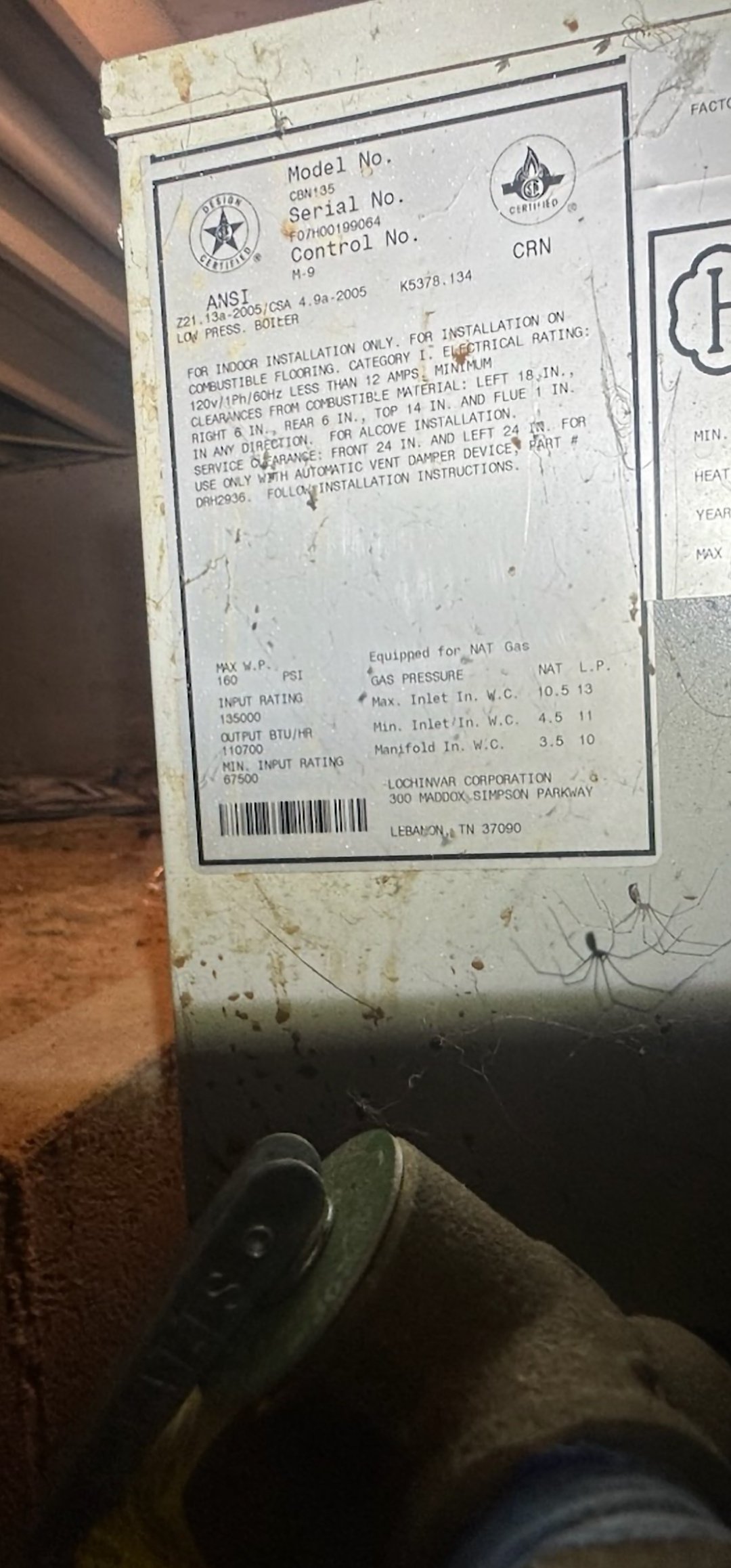

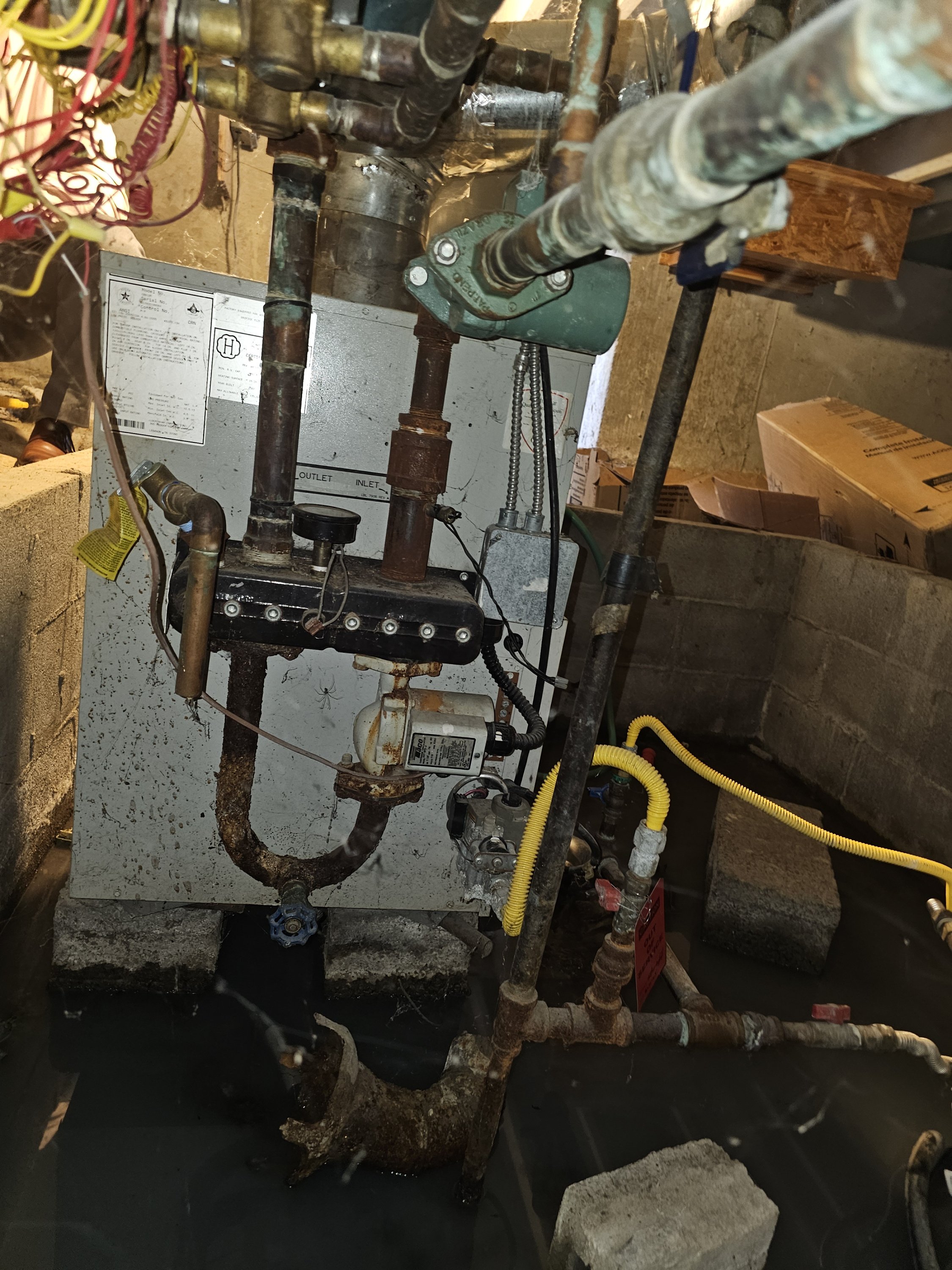

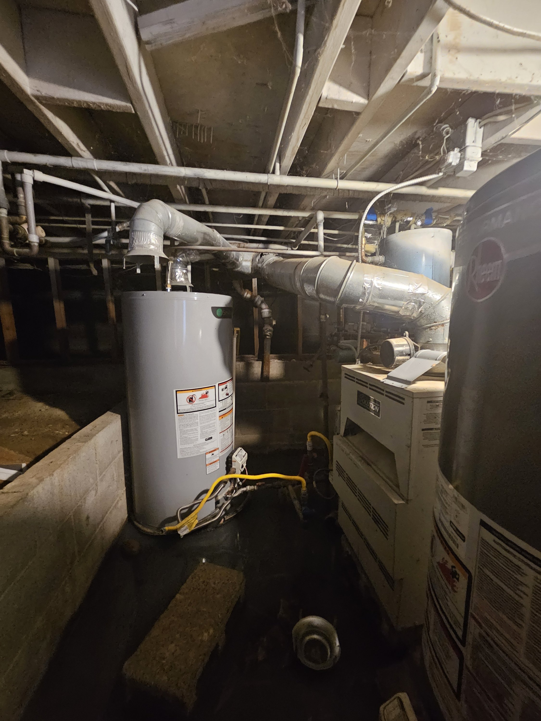

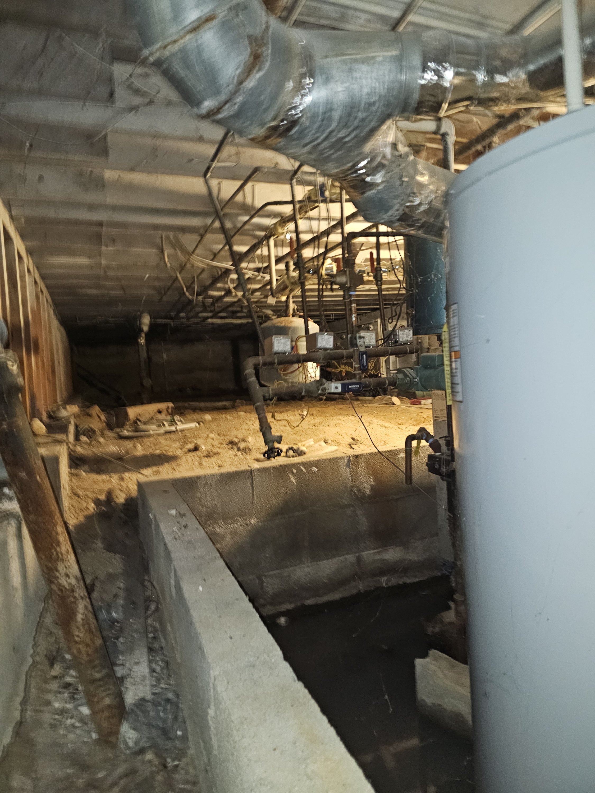

Hello!
1000024257.jpg 1000024256.jpg 1000024267.jpg 1000024251.jpg 1000024468.jpg 1000024255.jpg

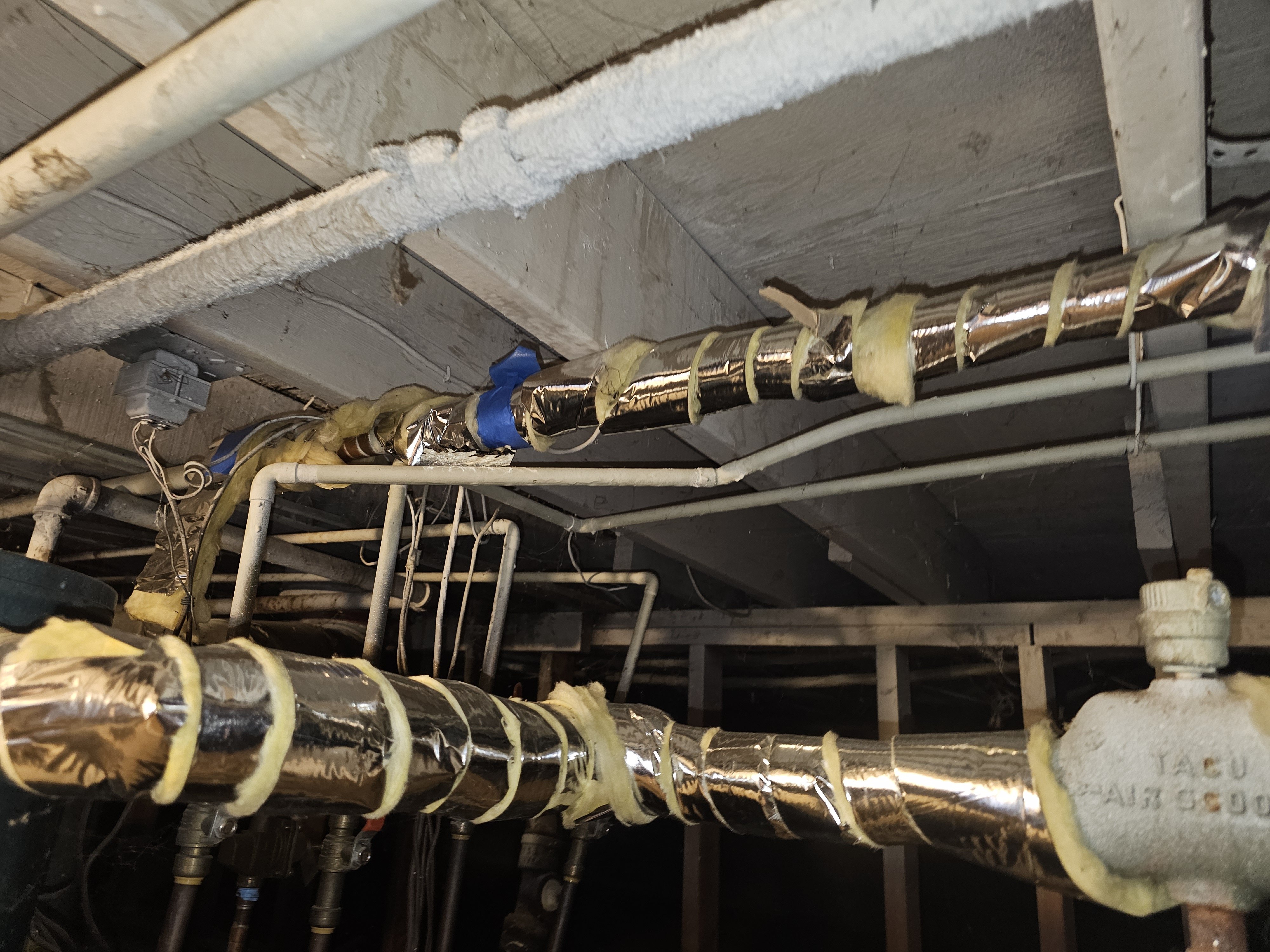

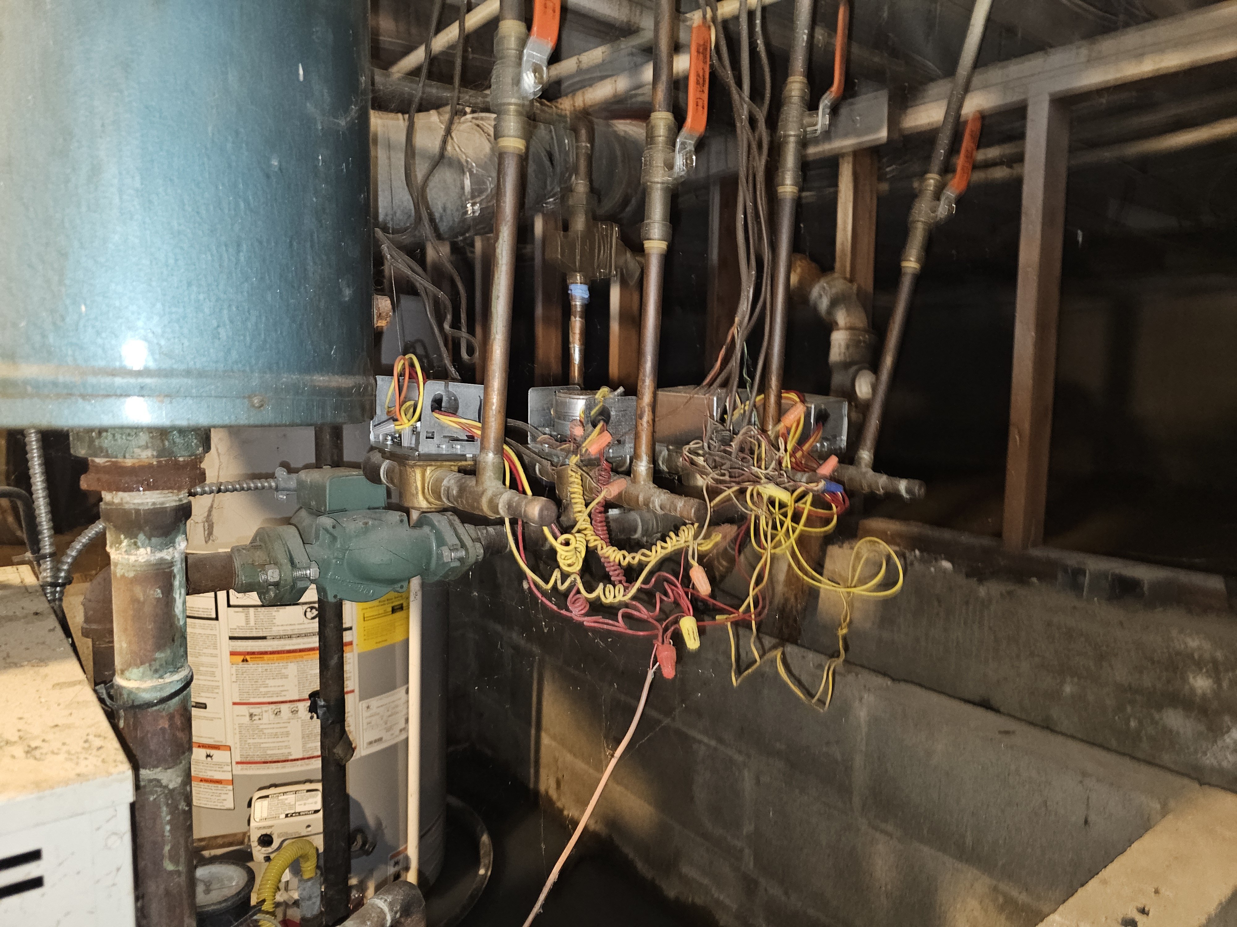

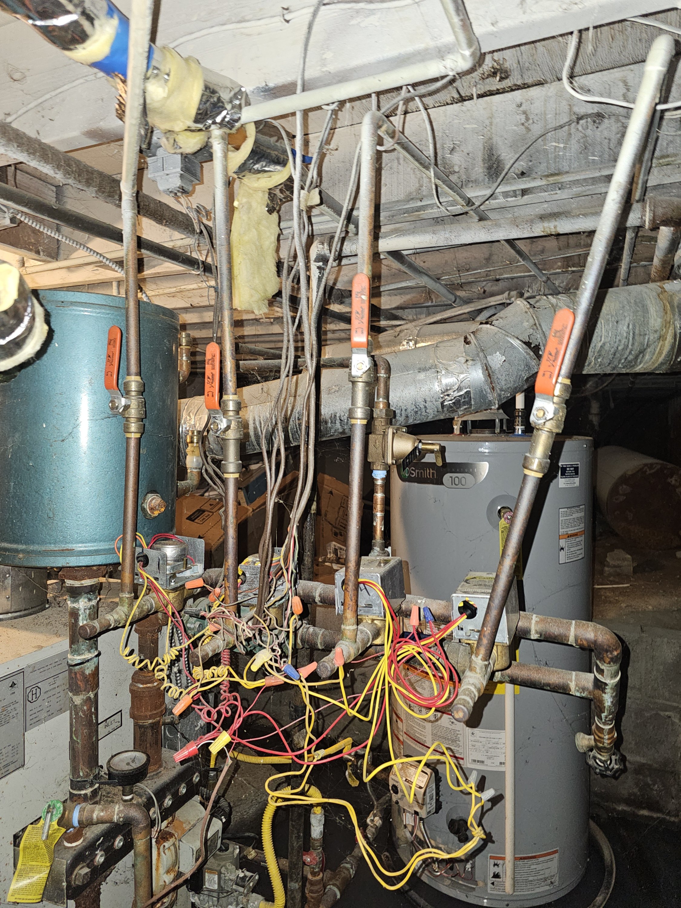

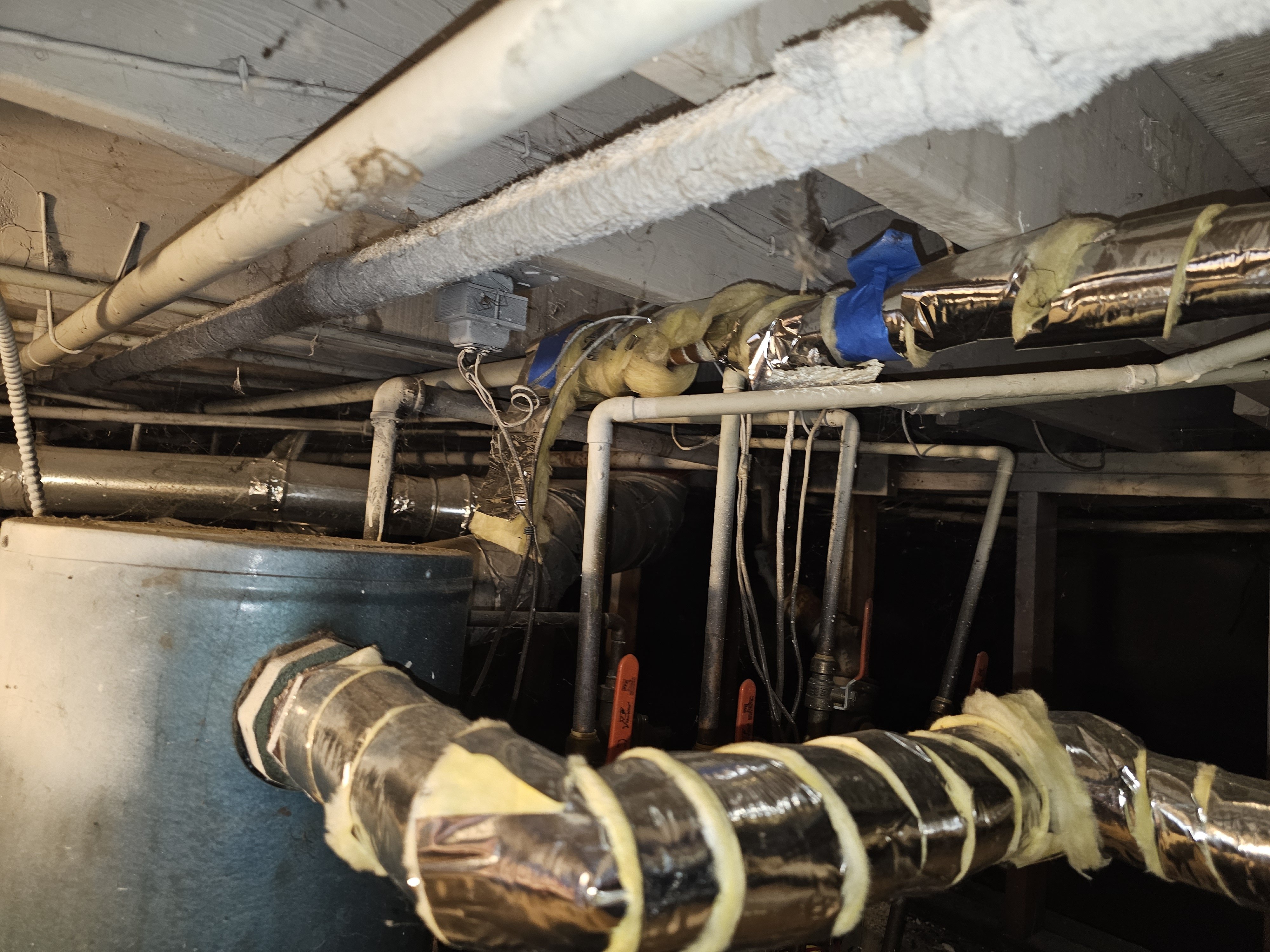

I am going to replace an old lochinvar solutions boiler with a new NHB 200H Navien Boiler. The existing system is piped as a series loop zone supply and return system. I am going to be converting it to a manifold system with individual supply and return runs. I need advice on what's the best way to do this. The original system has 4 zone valves. The boiler supplies 20 baseboard registers in a 4 apartment building. My setup with the new boiler will have 2 pumps, a 1558 pump on the return side of the boiler and a 2699 pump on the supply side of the boiler. Can I stick with the 4 zones and have each apartment ran off one single thermostat? I will install new t stats in each apartment if so with new wire. Also need some help on the wiring side of this. Zone valves to transformer? 4 Zone valves = 1.28 A with a single 24V Transformer? Control wire to boiler from transformer? Pumps wired into boiler? Any thoughts on the naviclean kit? New venting, new gas line connections. I will be installing two new non side arm water heaters as well. So this boiler replacement is only for baseboard heat.
    Jamie Hall Posts: 27,819
    EEEK. Is that poor boiler really sitting in a pit? Asking for trouble.
    Step 1. Make sure you have the sizing right. Mod/cons are wonderful gadgets, but they do need to be sized correctly for the load. So… a building heat loss is in order.
    I'm curious. Why two pumps in series like that? That makes no sense at all. You are going to be running primary/secondary, I hope, so two pumps will be needed — but not in series as you suggest.

    the boiler you have is a 135,000, 107,000 output. If that has been been adequate, why are you considering a 200?

  • Assuming that a load calc has been done and that BTU range works for your load there's a few things to consider.
    1. Not a fan of Navien and their heat exchanger design. There are better boilers in the price range give or take $. Viessman , Burnham / Velocity Boiler Works are my go to. When compared to Navien it's a much better product. Both manufactures have similarly price ranged products. Might spend a few bucks more but it pays in the end. Choose a brand that's well repped in your area.
    2. I would flush the system prior to installing a modcon such as sentinel or similar product.
    3. Definitely install a mag filter when installing a new boiler to help further filter the system and protect the heat exchanger.
    4. Hydraulic separator makes easy work of primary /secondary piping. You can get one with a mag separator if you like.
    5. Get a zone control panel such as a Taco,Tekmar, etc. Cleans the wire up and makes troubleshooting much easier.
    6. If you stick with zone valves Taco sentry are a great upgrade from the honeywell and easy to override if needed.
    7. Follow and read the install instructions.

    Yes boiler is currently sitting down in the cinder blocked out pit. Im going to be adjusting / Framing a support wall for the new boiler to be hung

    I believe the boiler wasn't properly sized, not pushing enough, so the client im working with has his mind set on the navien 200
    Contrary to popular belief, the client isn't automatically correct. That said, try at least to be sure that the installed radiation can support the full output of the chosen boiler.

    hot_rod Posts: 28,350
    At the very least count up the heat emitters in each unit
    If you have 50’ of fin tube in each unit X 550 per foot you can only put 110,000 into the units
    Even a 1 million btu/hr boiler would not add more heat The heat emitters are what you might size to, if they have been adequate in the past

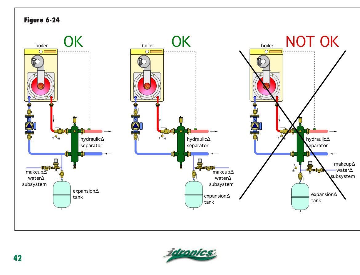

    Here is a multi function hydraulic separator, Sep 4
    It does air, dirt, magnetic and hydraulic separation in one unit
    This shows zone pumps, it could be one pump and 4 zone valves

  • Can you elaborate on the low header loss common piping. Where the autofill connects
    the expansion tank and fill could connect at any of the 4 connections
    Most often at one of the bottom, return connections
    But not right off the bottom as it collects debris from the dirt separator inside
    pump and zone valves on red line, the upper right
