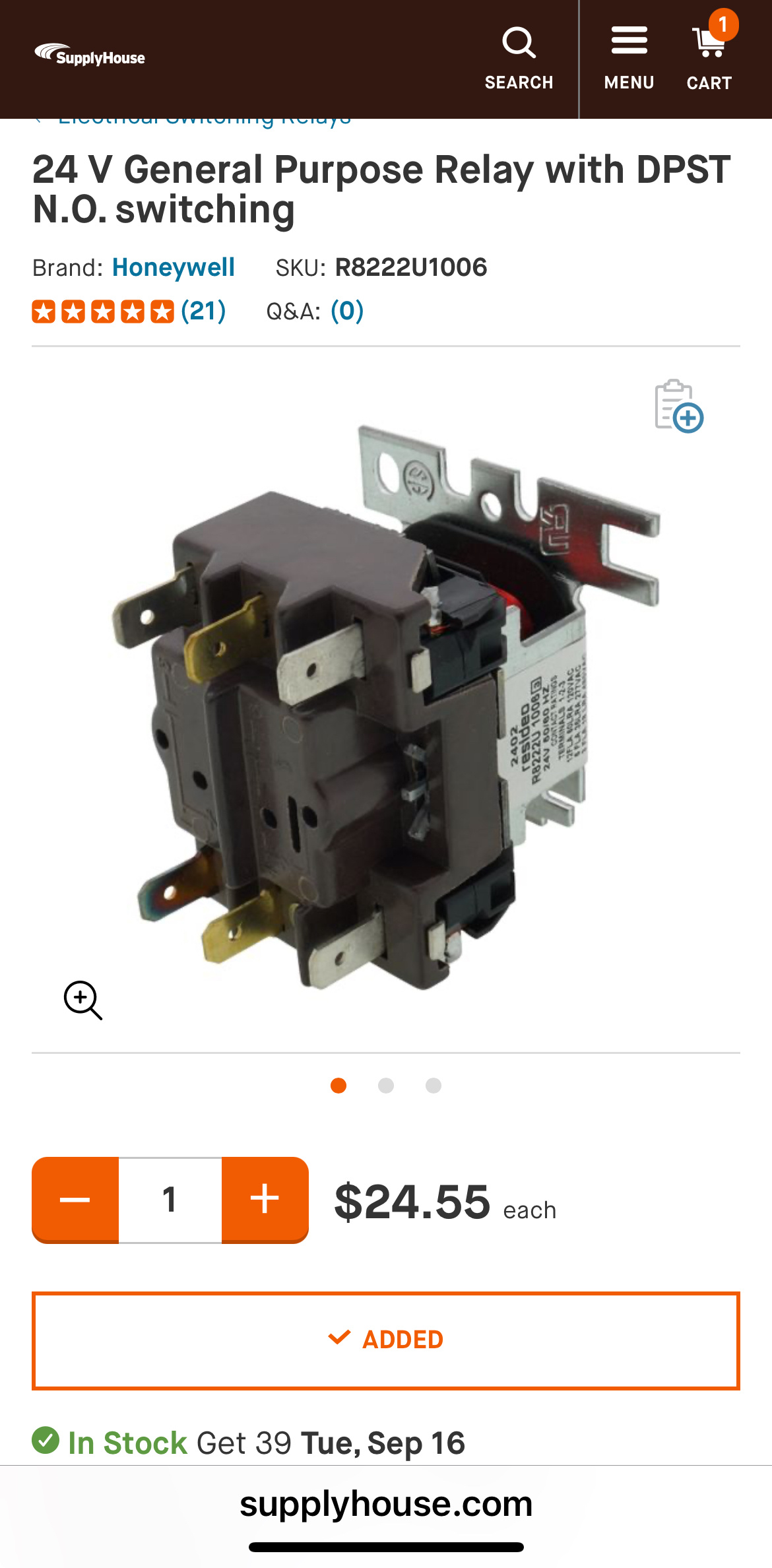

    That relay is available from any HVAC or Plumbing supplier. Here is the lowest cost one I could find that will do the job. Jard 24v. coil GP relay. If you want a name brand like White Rodgers or Honeywell you can spend another $10.00. If you purchase the OEM relay from the manufacturer you can really over pay for the same part. Here is an example of that from Weil McLain: 510-350-221
    Lets hope that it is just that simple and you can get the part for under $20.00

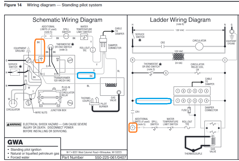

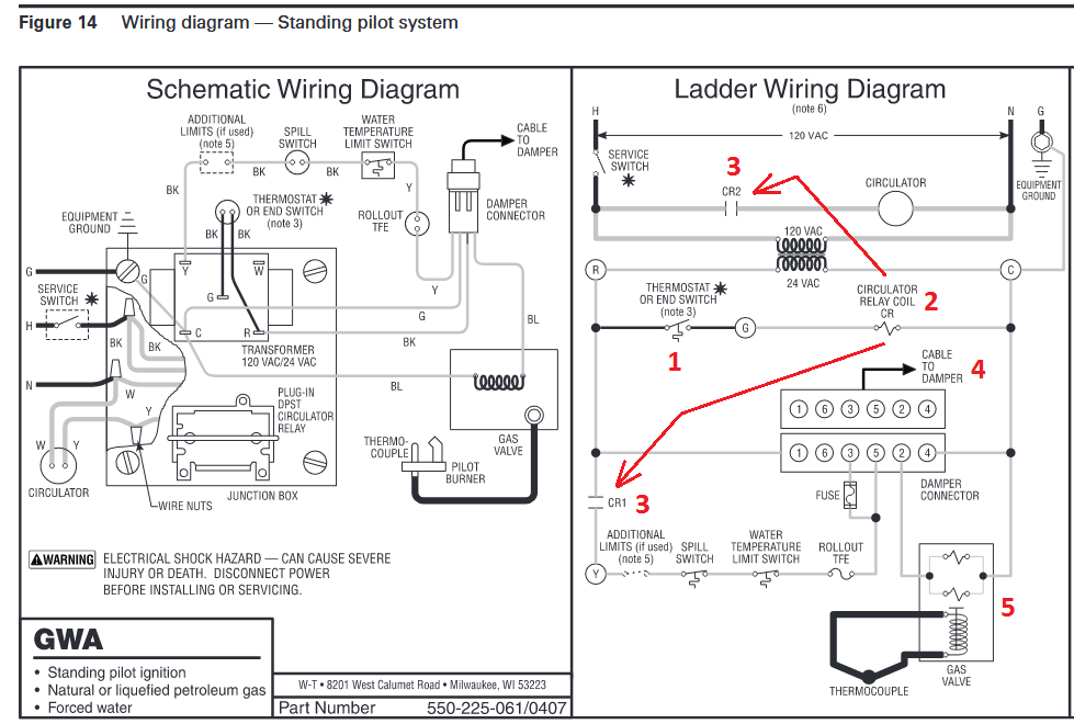

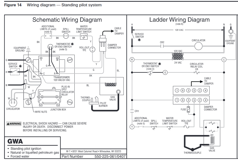

    I would say the Damper may be wired in wrong. Looking at the wiring diagram the 'click' the relay activating should be first then the damper should open. Once the Damper opens then the Boiler should fire up.
  • FrankMaraschino
    FrankMaraschino Member Posts: 47
    Hmm. Let me compare the actual wiring for the damper with the diagram
    109A_5 Member Posts: 3,691
    edited September 2025
    1. Thermostat closes in your case the thermostat via the Taco SR501
    2. The coil of relay CR is energized.
    3. Contacts CR1 and CR2 (CR2 not used in your case) are closed.
    4. Damper opens, closing its 'End Switch' when fully open.
    5. Gas valve is energized.
    The Damper should not be activated until the relay CR is energized.
    As near as I can tell it looks like the colors are correct. I wonder if the Damper was changed and it is different, what make and model is it ?
    Also where do the coil wires of the relay go to, I suspect they are Blue and Black, from the pictures it looked correct.
    Also the set of contacts wires used. Maybe the 24 VAC is bypassed around the relay contacts CR1, then when the relay is energized (Damper 'End Switch') the relay contacts effectively latch the circuit on forever.
    Something is not right, the event sequence is wrong and it latches on forever.

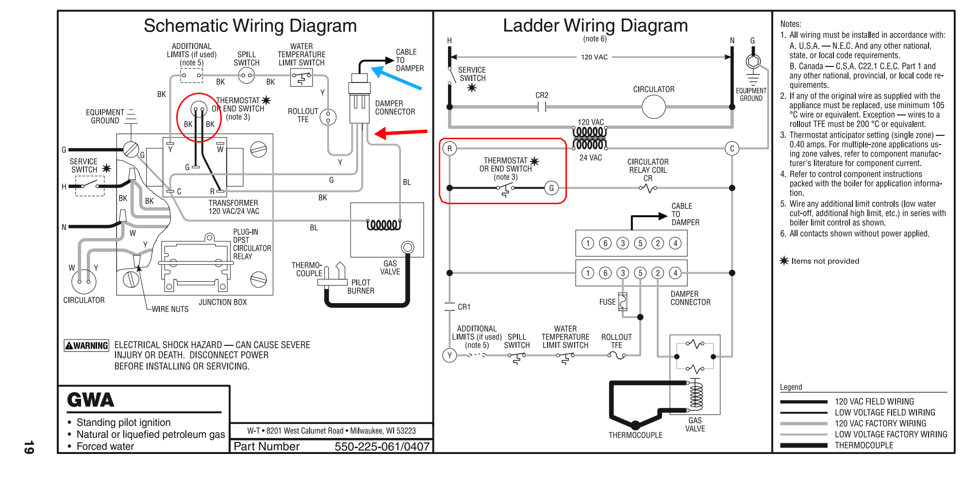

    EdTheHeaterMan Member Posts: 11,755

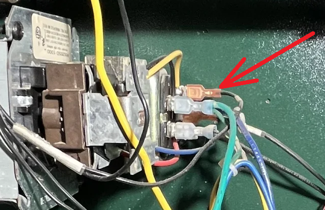

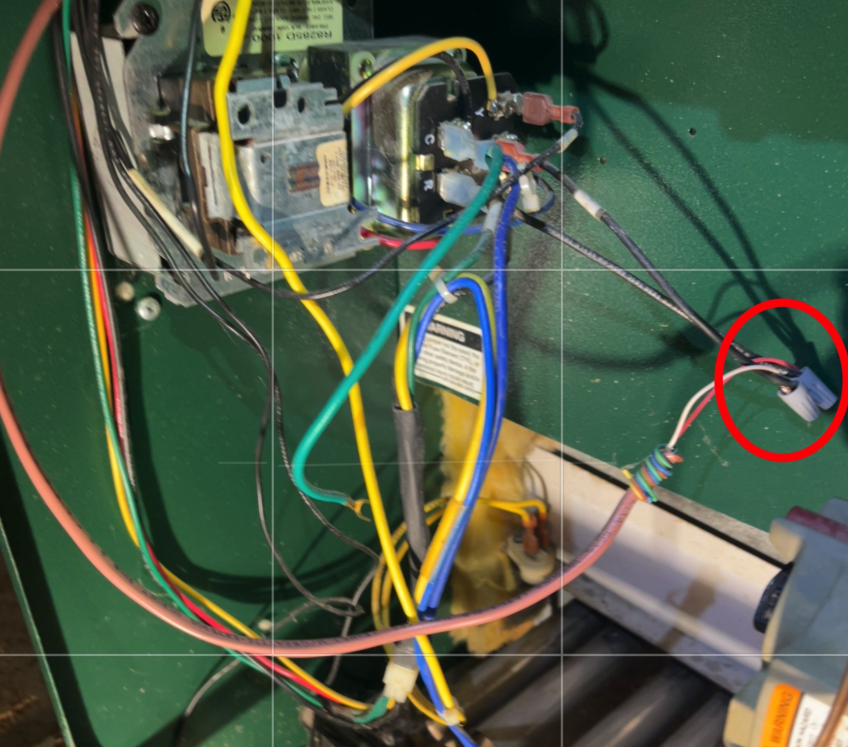

    The Damper wires are correct. There is some confusion as to what side of the connector is "To Damper"
    I have added a red and a blue arrow for clarification above and in the photo.
    The Y, G, Bk and BL are inside the black shrink wrap. Look past the black shrink wrap to see the wire colors
    Regarding the Click you heard in the video just before the flame "woosh", that click is the sound of the gas valve clicking open. that was not the sound of the relay click.

    It almost seems to me like the Orange and the Blue in the drawing are reversed or their functionality in the Damper cable. But that does not explain all the symptoms.
    I would disconnect this wire (Orange above, Red arrow below) with all the rest intact and see what it does. Does the Damper still open ?

    @109A_5 has the Sequence of Operation correct on the diagram.
    1. Thermostat calls for heat
    2. SR 501 pulls in and
      1. the circulator operates
      2. The 5 and 6NO close to call for the boiler CR relay to operate.
      3. The boiler CR relay will close the CR1 and CR2 contacts. Screenshot 2025-09-14 at 11.57.44 PM.png
    3. The burner will then operate if all the limits and the vent damper end switch are closed. (the vent damper end switch will make at the 6 pin plug at pin 5 and 2 to complete the circuit). I have added the wire color codes to this ladder diagram for clarity. The gas valve circuit starts at R on the transformer > CR1 > Y > Spill Switch > Water temperature limit > Rollout > Pin 5 on damper plug > Pin 2 on the damper plug > gas valve > back to C on the transformer.
    4. The thermostat circuit has only the CR relay coil on it

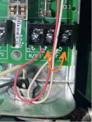

    I believe there is an easier test for verifying the relay clicking.
    Just take the 2 black wires at the wire nuts here and touch the wires together and then disconnect them. There should be a click every time the wires connect.and another click when disconnected. You can even send Morse Code with those wires if you know it. _ _ _ . . . _ _ _

    @FrankMaraschino You could also jumper here. The thing is even if the relay clicks it still could be defective. The meter will tell you what is really going on in the circuit, but you have to work on it live and that has risks of its own.
    With relay in the socket I believe you can measure the coil voltage here, Yellow arrows.

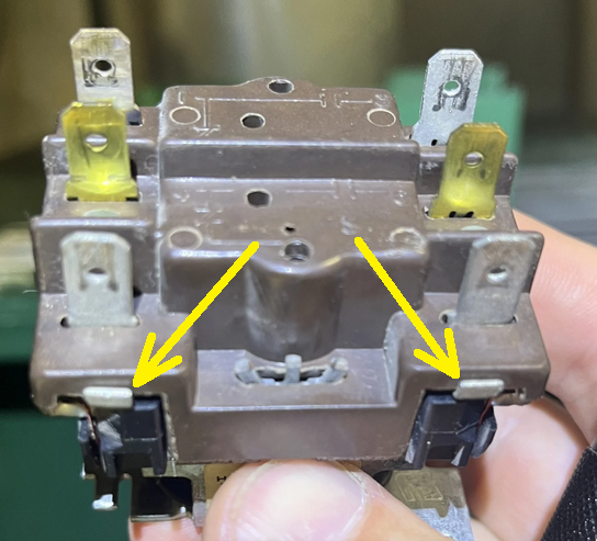

    @109A_5 Great Video! I believe the opposite happened to @FrankMaraschino's relay. The contacts are not open like in the video, but they are closed or welded together so they do not open when the coil is not energized.

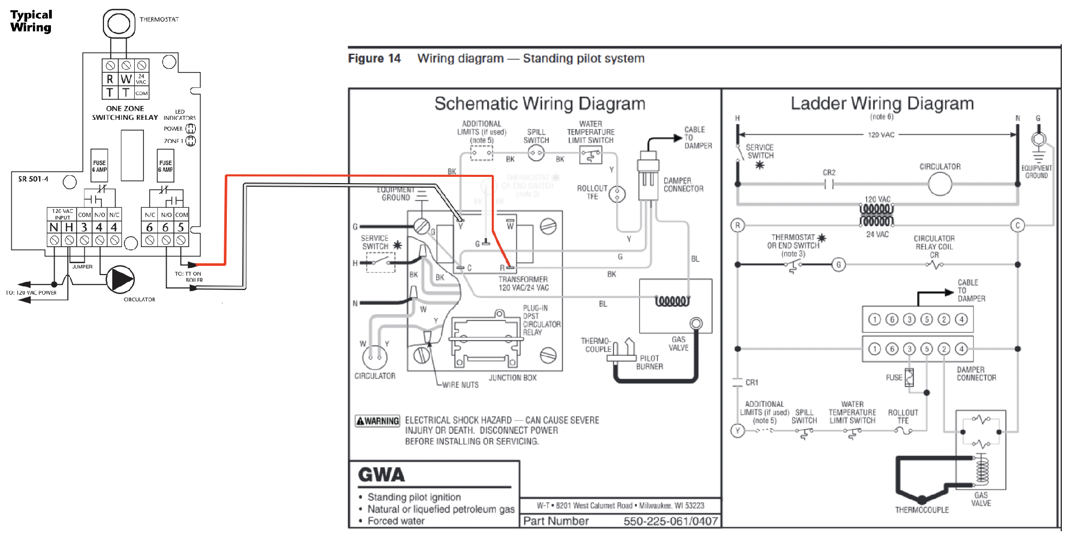

    I just thought of a fix for this that will not need any parts. If you use the 5 and 6NO on the SR501 to do what that general purpose relay is supposed to do.
    Diagram to follow:

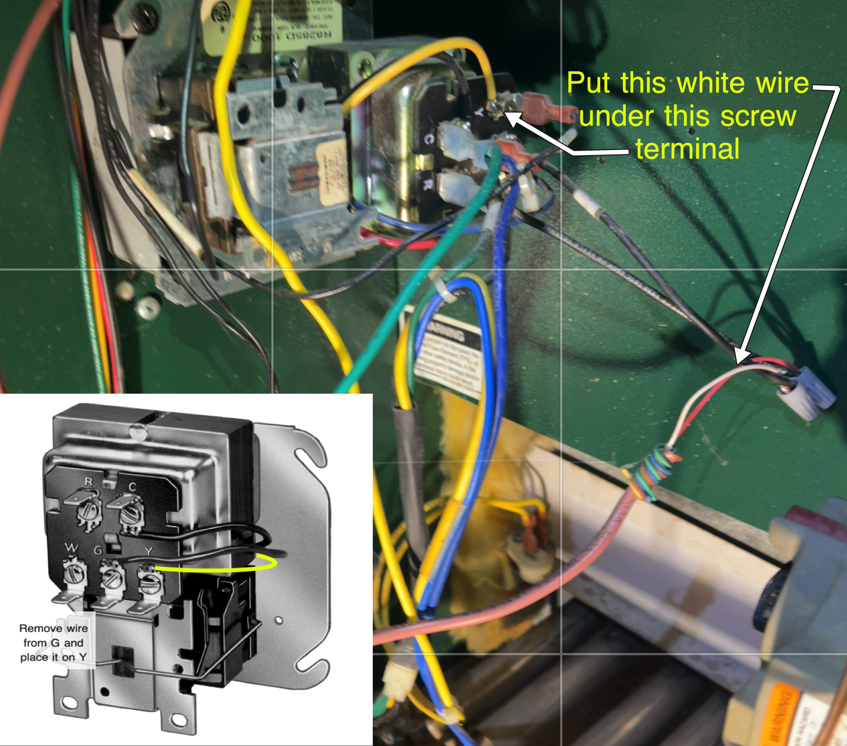

    Since all the CR1 contacts on the problem relay do is connect Y to R on the Transformer terminal board, then we can just use 5 and 6NO to connect R to Y on the transformer terminal board. The SR501 is already doing what the CR2 contacts are supposed to be doing, just use the SR501 to do both jobs.
    It is easy to do… Just take the wire that is connected to G on the transformer terminal board and place that wire on Y on the transformer terminal board. Very simple fix…. Just remember to leave the CR relay out of the socket.

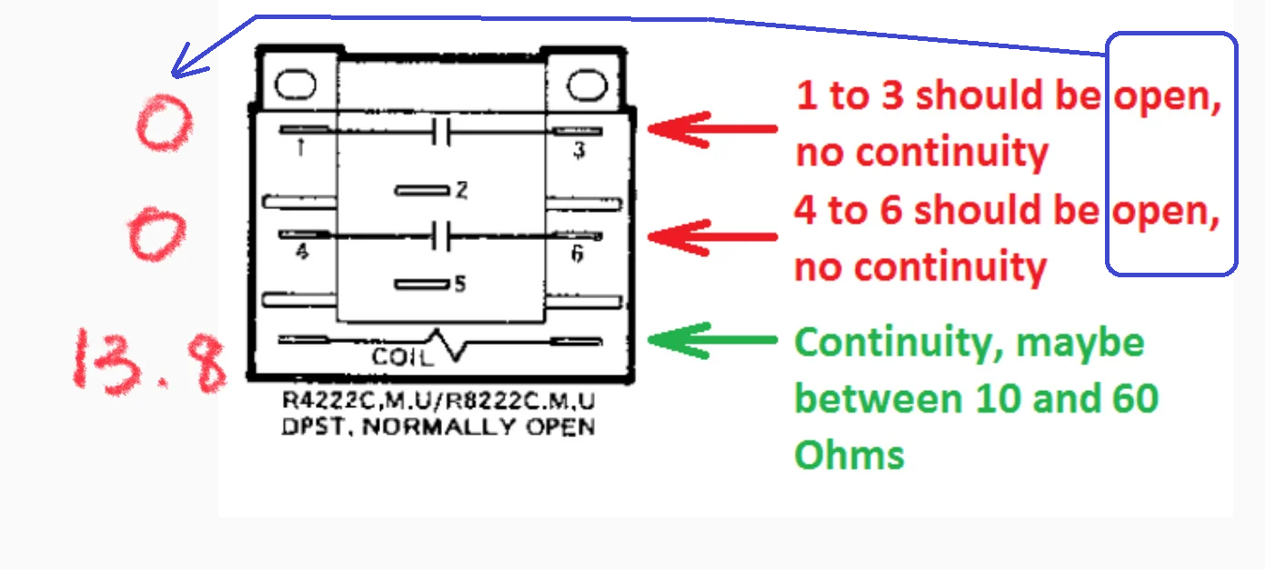

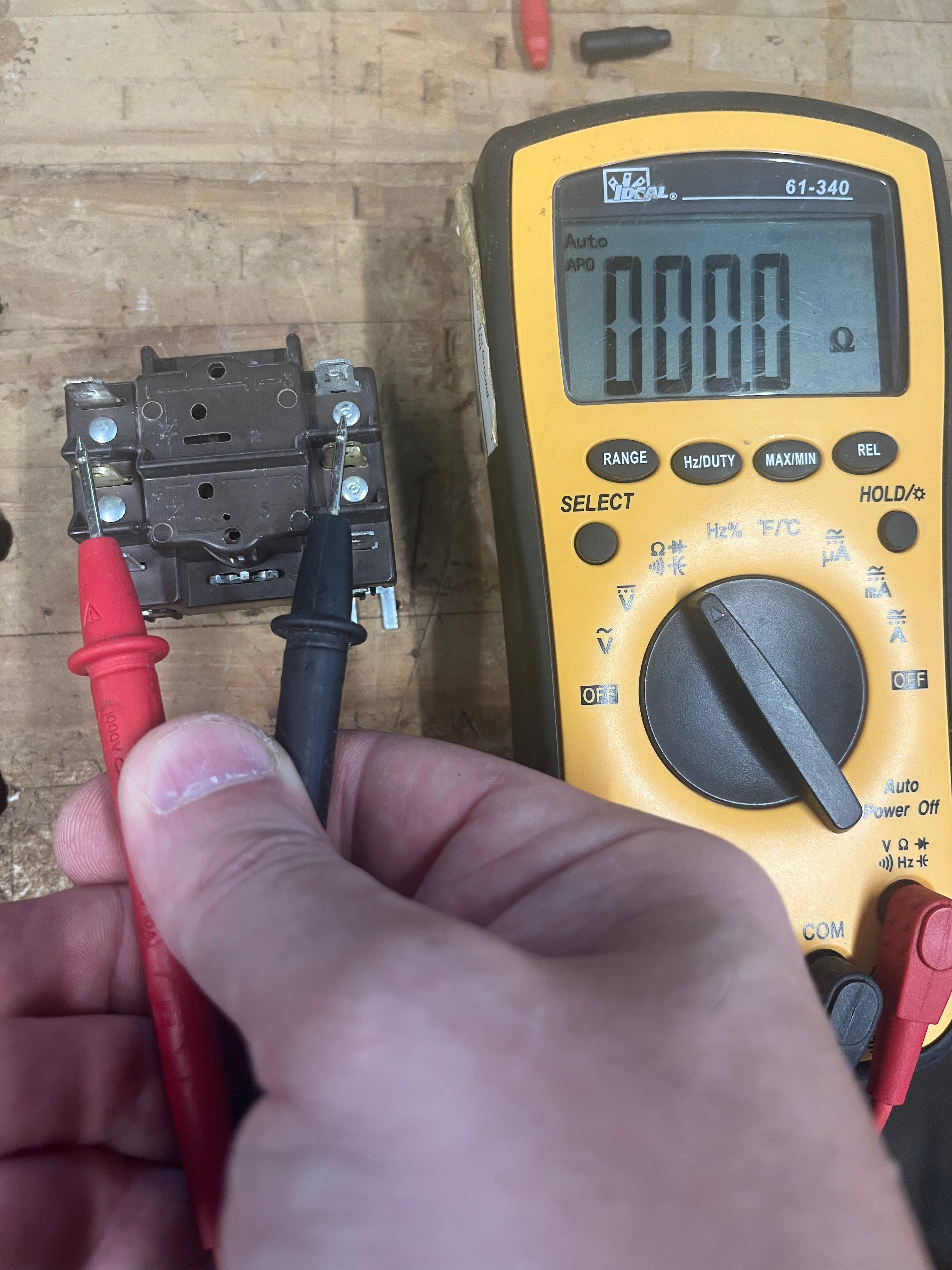

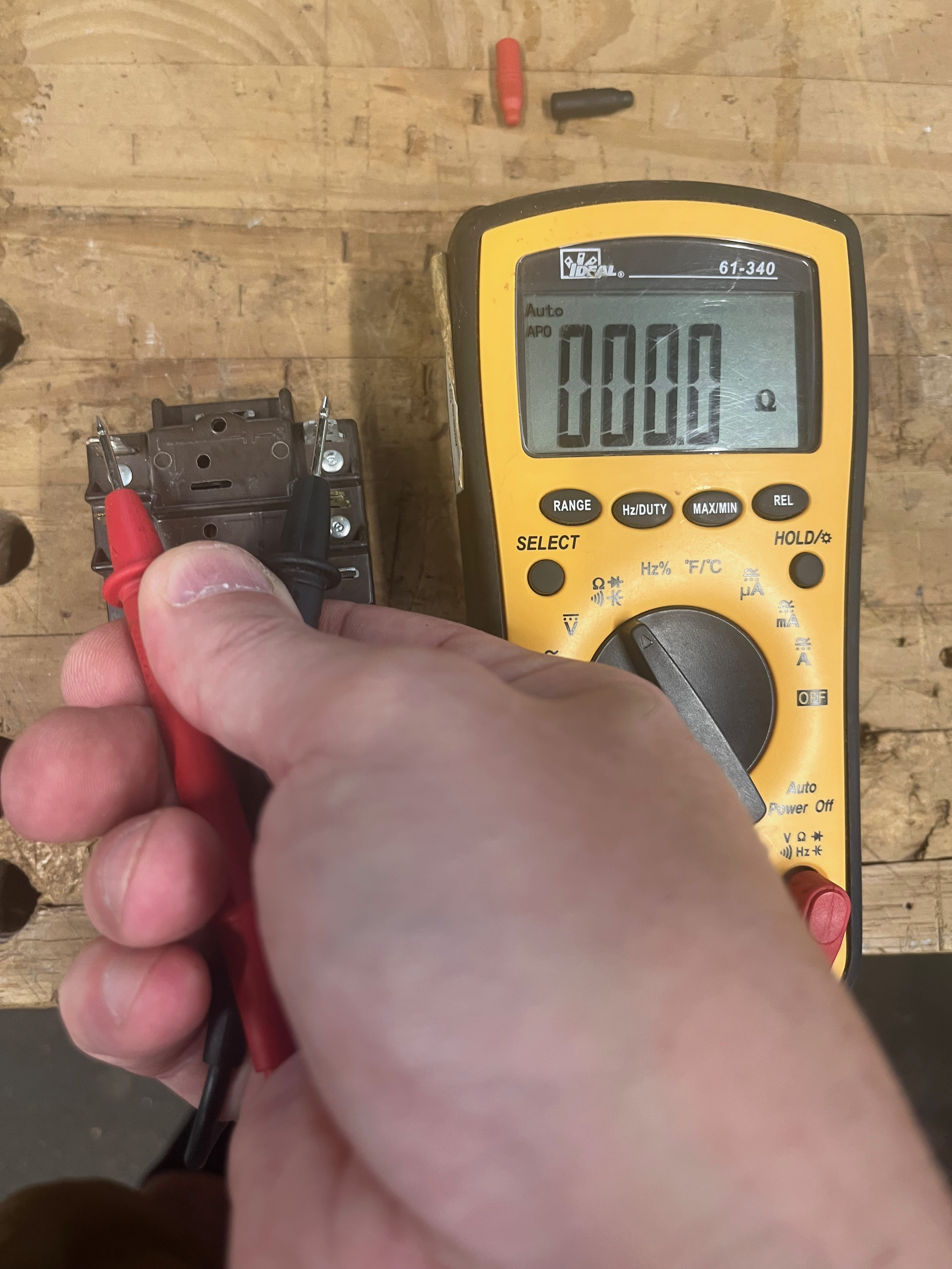

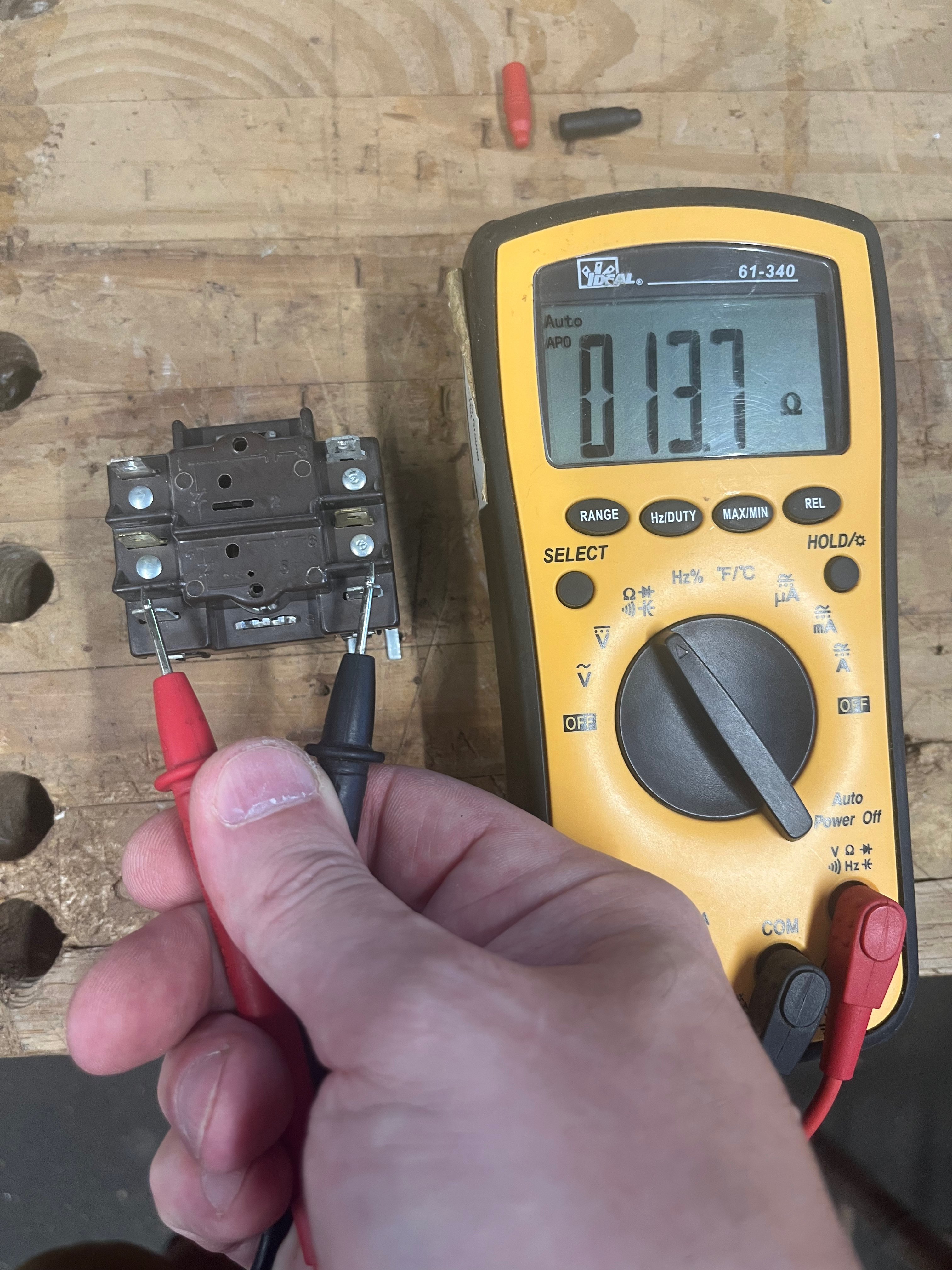

    @109A_5 I removed the CR relay and tested resistance using my multimeter, following the procedure in the video you linked. The results:
    For proof of concept of @EdTheHeaterMan's no parts required fix, remove the 'CR' relay and jumpering R to Y should have control of the boiler. R to Y closed boiler fires, jumper removed R to Y open the boiler shuts down. Seems promising since the boiler did not fire with the 'CR' relay removed.
    FrankMaraschino
    O means Open or Zero resistance (0.0 Ohms) ? If Zero Ohms the relay is bad. Probably a mechanical problem if both sets of contacts are closed.
    mattmia2 Member Posts: 16,033
    relay is bad. once one contact welds it can hold the other contact closed or it could be a broken spring or dirt making it stick.

    I ordered a replacement from Supply House. Will arrive tomorrow

    I think OL means open and zero (0.00) means closed.
    Just making sure, OL without the L is O. O could mean Open.

    @109A_5 You give me ideas and I try to give you ideas back. I think the SR501 can do the job. …and it is just moving one wire on the transformer terminal plate.

    You need to know your meter…. on my digital meter 000.0 ohms means no resistance. Closed circuit. For an open circuit my meter would read OL which was translated from the infinity symbol (∞) on the old analogue meters in the original instruction manuals. But that was back in the day when old farts were converting from analogue Simpson multi meters to Digital stuff and they thought we needed to be told that ∞ = OL.
    That's the same as my Ideal meter, which also has an optional audio tone to indicate anything other than an open circuit
