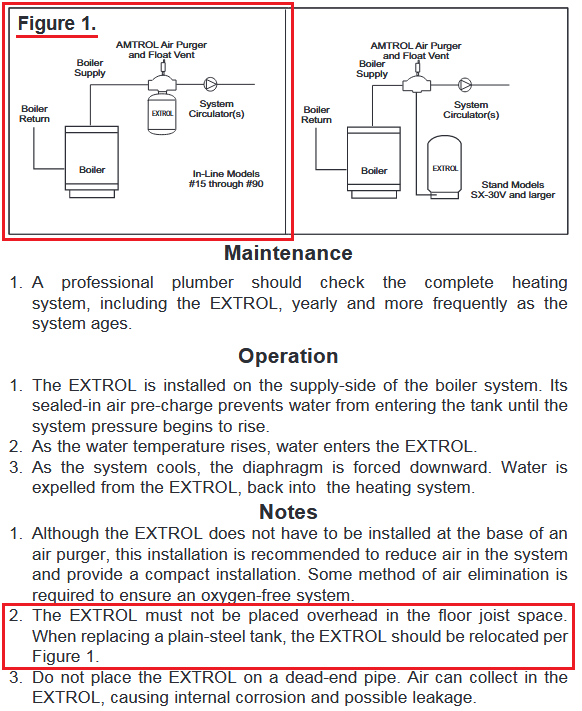

    The extrol location is ridiculous.

    IMO Extrol wants the vertical position so air is not trapped on the water side of the diaphragm. Air on the water side of the diaphragm against the steel housing may lead to premature failure and property damage.

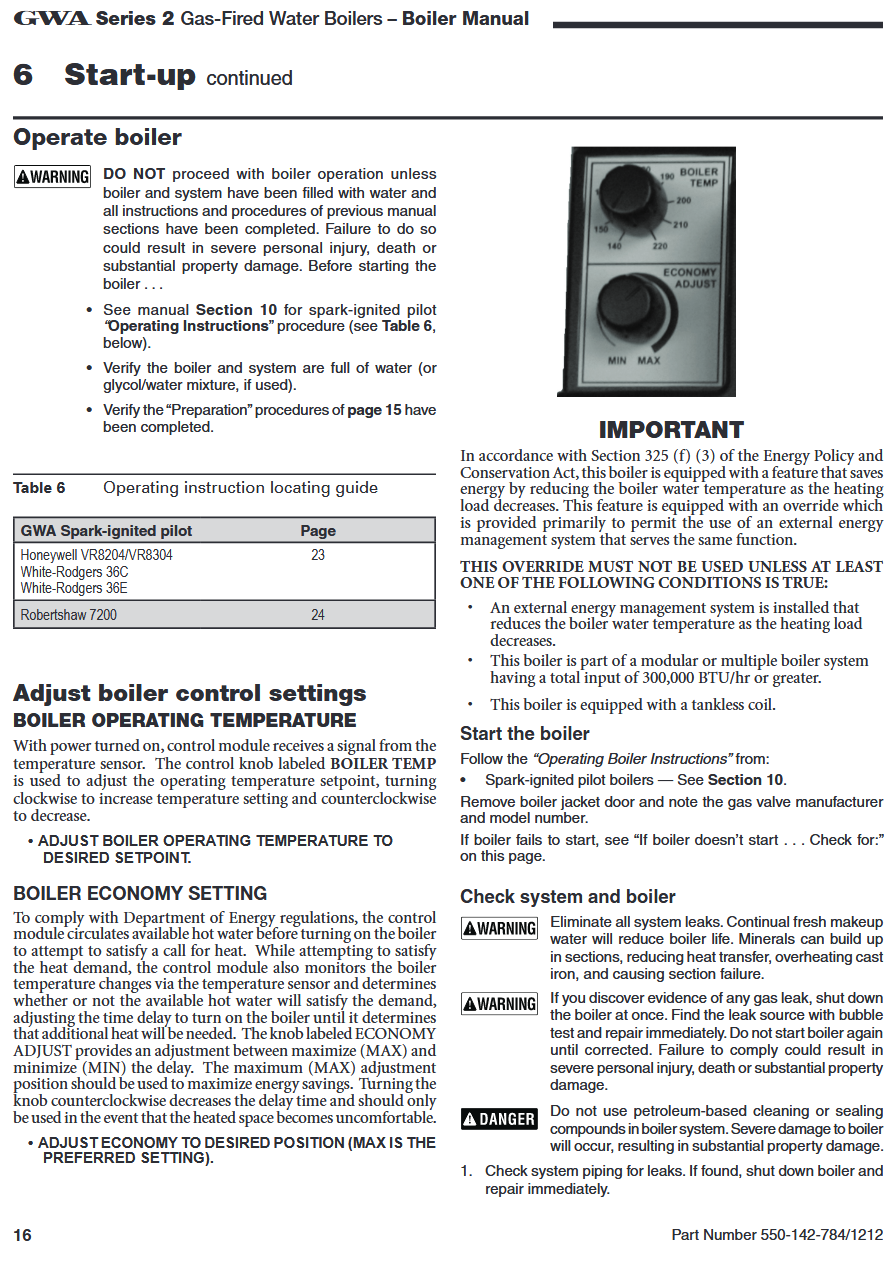

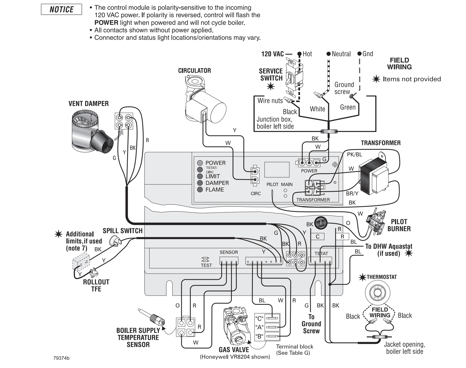

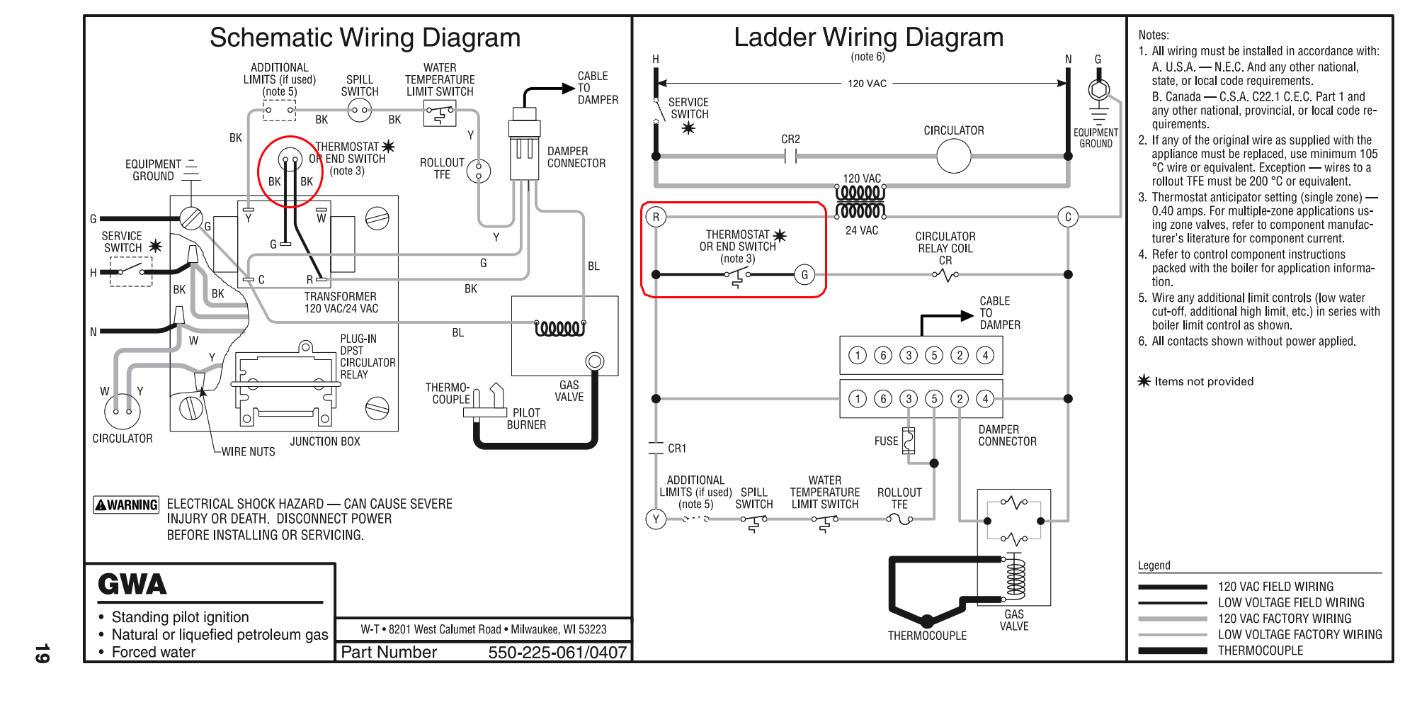

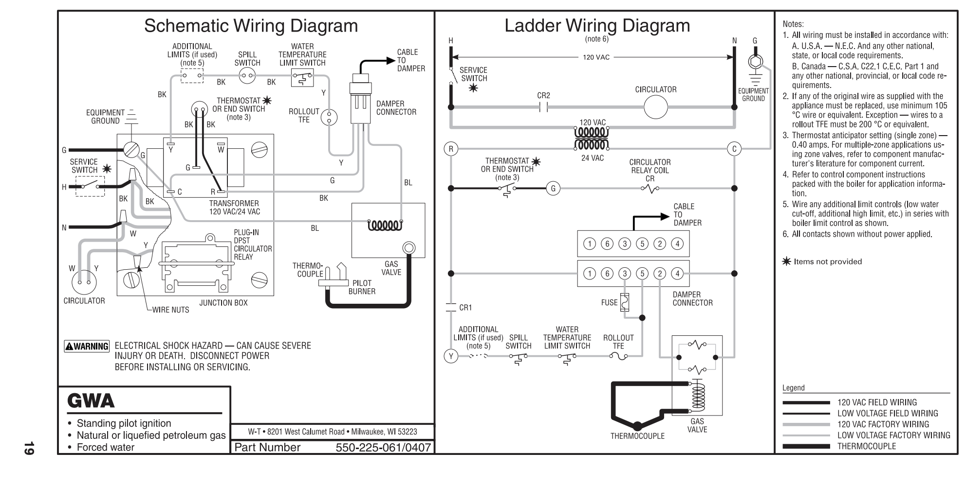

  • @FrankMaraschino, So, I just looked at the wiring diagram for the Williamson GWA series 1
    and the GWA series 2 boilers
    There is no provision for maintaining any temperature, 140° or 180° or any other temperature, in either diagram. I think it is a good thing that you found your home like a sauna and that caused you to come here for some advise. You would not have found out that you are wasting fuel by maintaining 180° in the heating season. During the fringe seasons when the call for heat may only last a few minutes, your burner may not even allow the water temperature to reach 150° before being satisfied.

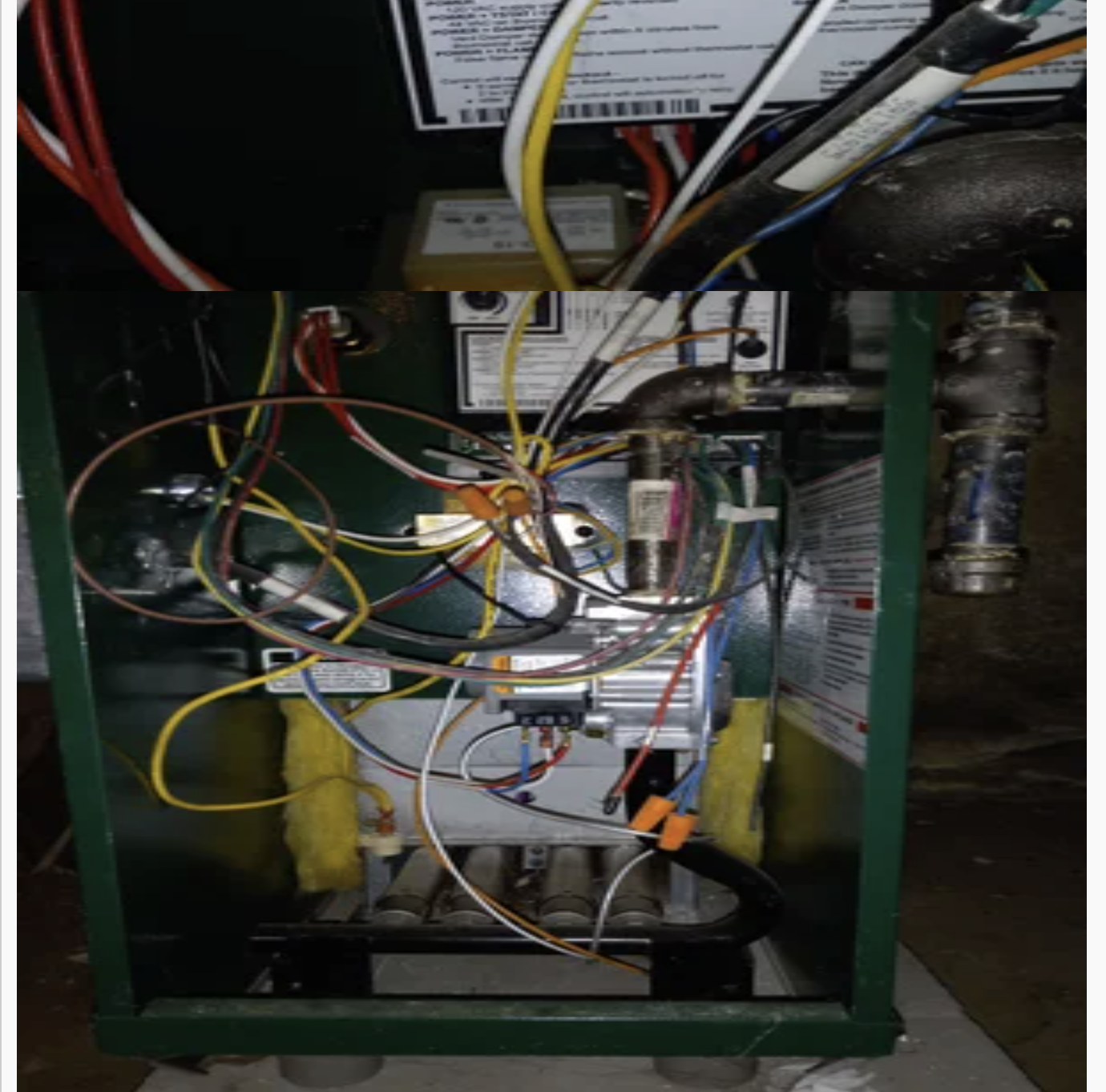

    Can you find out why the boiler is maintaining 180° all the time? If you open up the control compartment and post some pictures of the wires inside there, like this:
    I can usually see what was done incorrectly and maybe even get you back to a more efficient cold start design as the manufacturer intended. Please try to make the photo as clear as possible by not moving the camera when taking still photos. A video can also help however, there is more involved to post a video and not everyone has the ability to do so.
    Also, tank more than one angle so I can see behind stuff that may be blocked in the first pic you take

    Series GWA-1 maybe the CR relay is stuck closed
    GWA-2 they could have wire nutted the DHW blue wires together

  • Thanks, Ed! I’ll go down and post some photos right now. I can make a video too and upload it to my YouTube and post the link

    Working on those pics and video

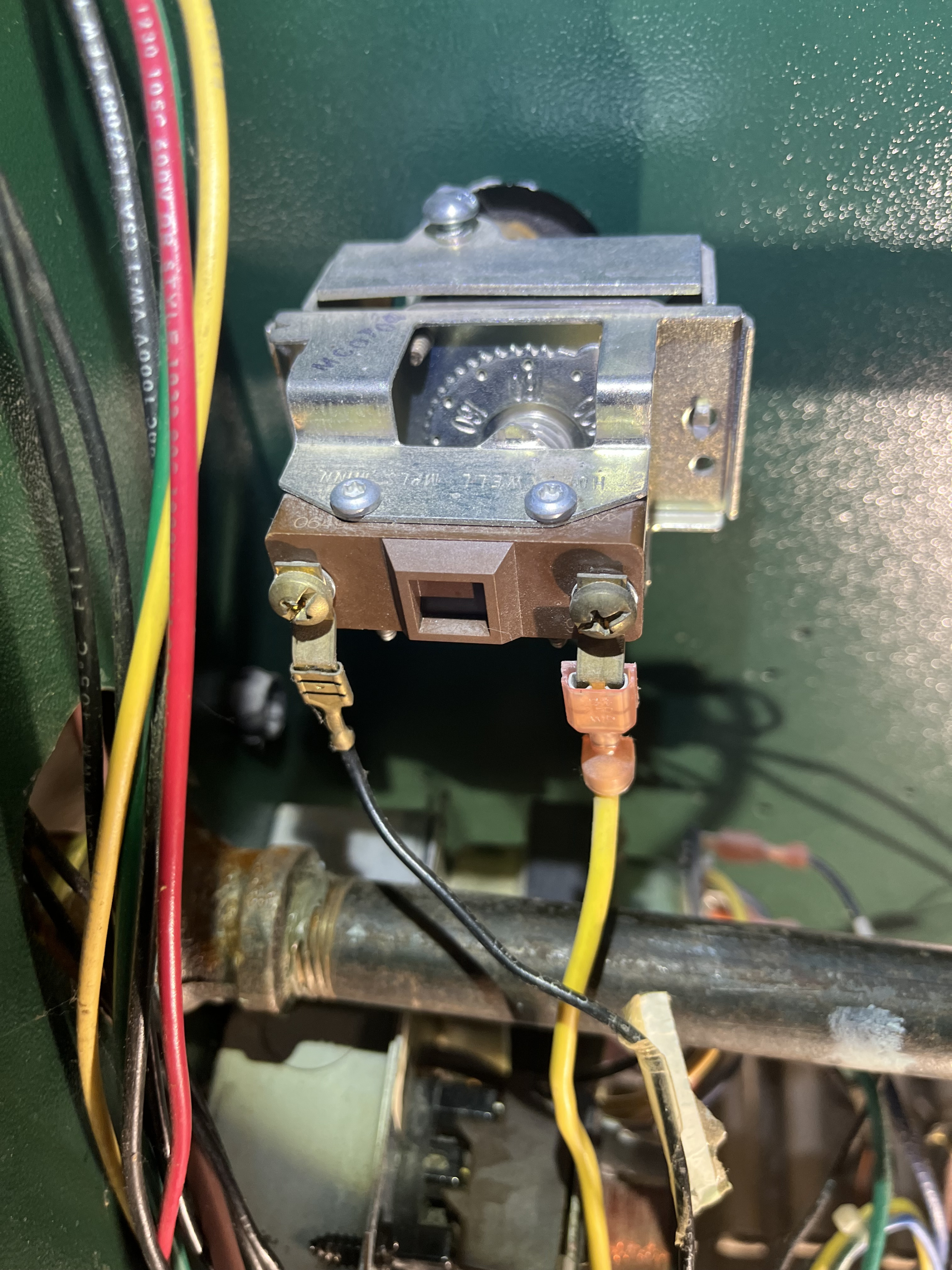

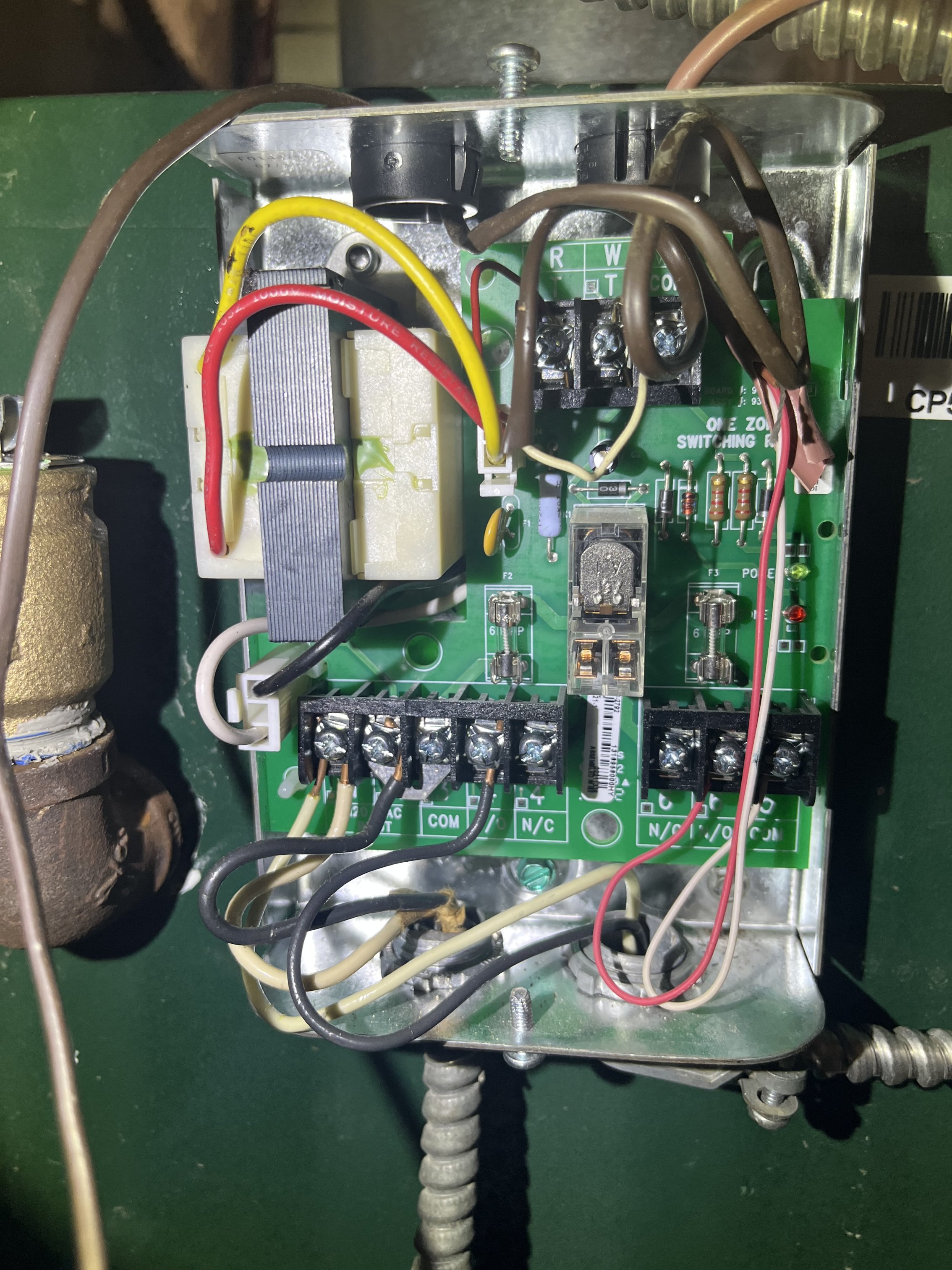

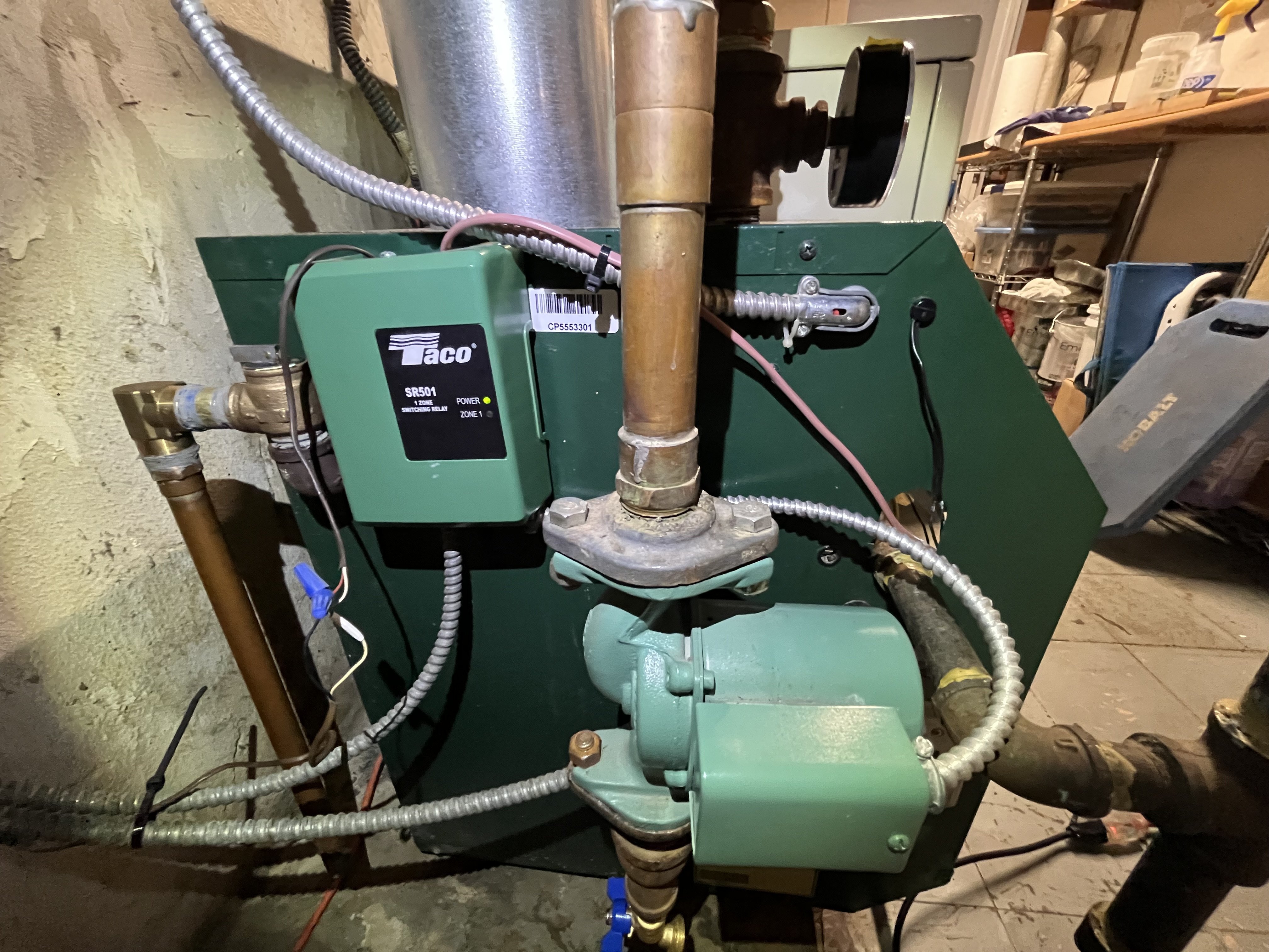

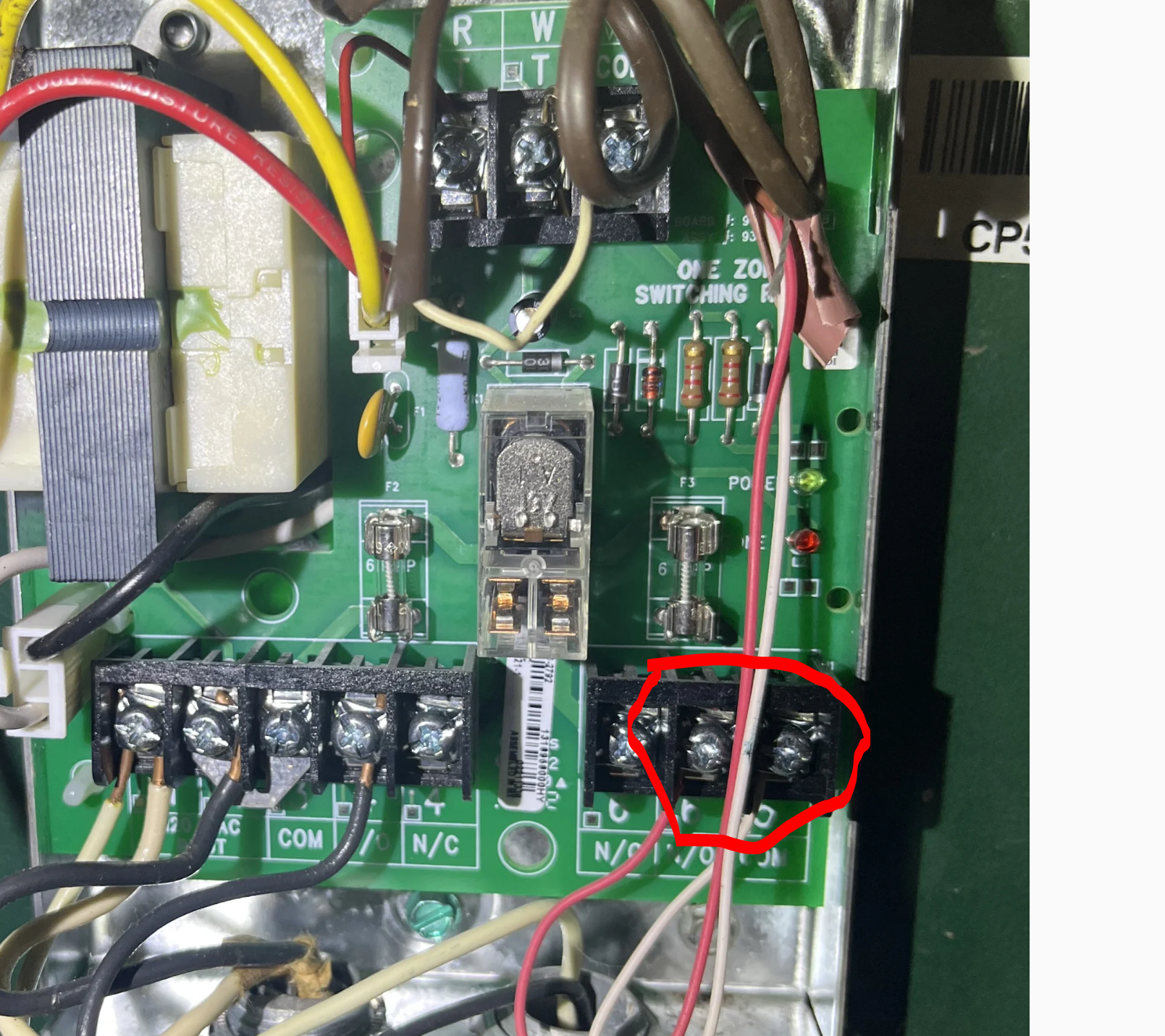

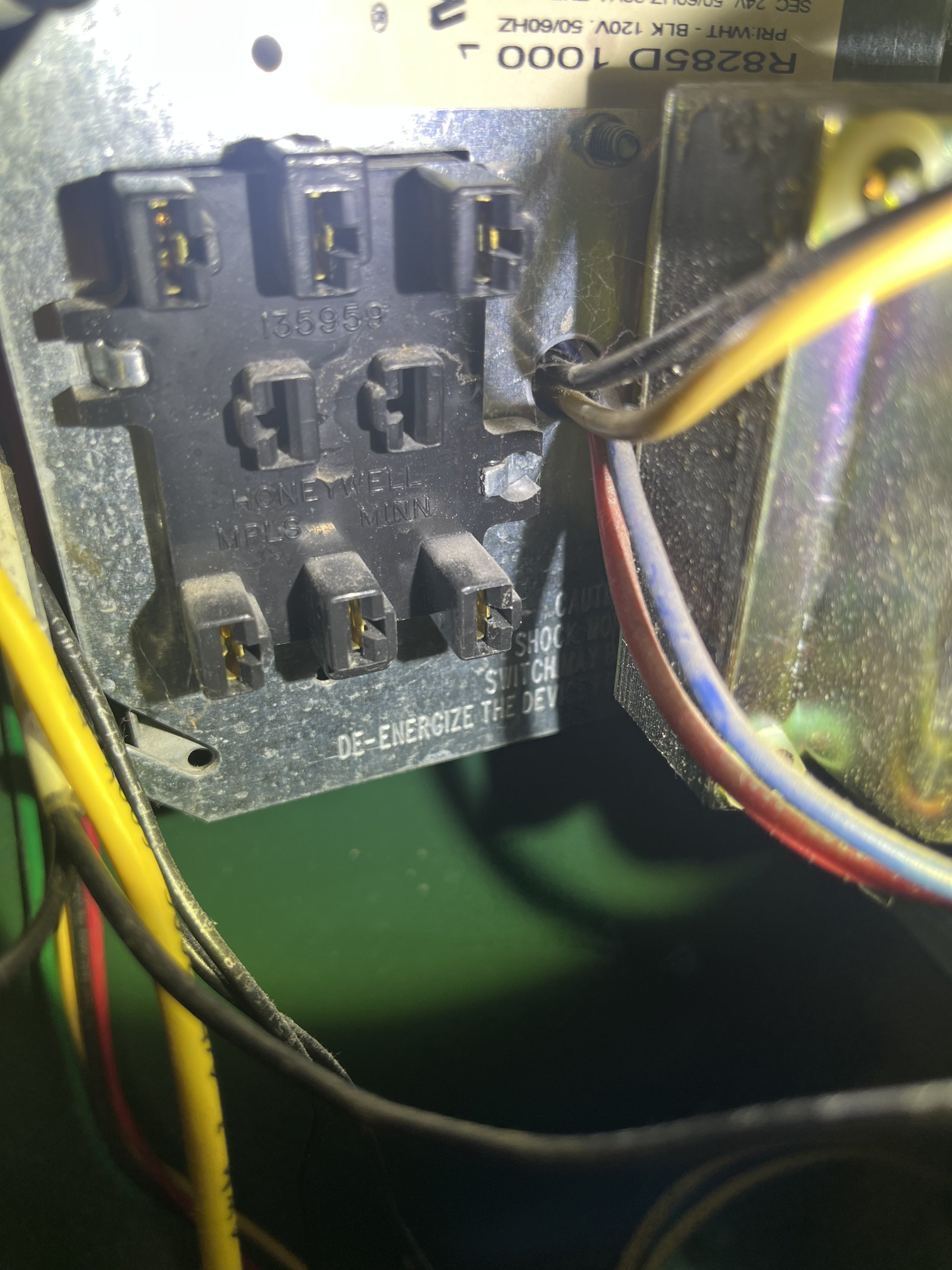

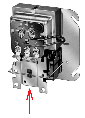

  • Taco SR501-4 Relay
    Disconnect one of these and see if the boiler still fires(turn the switch off before disconnecting or connecting wires so you don't short something and burn something out)
    if the boiler still fires someone did something weird in the boiler wiring which isn't immediately obvious.
    109A_5
    109A_5 Posts: 4,761
    edited September 2025

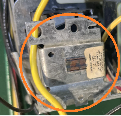

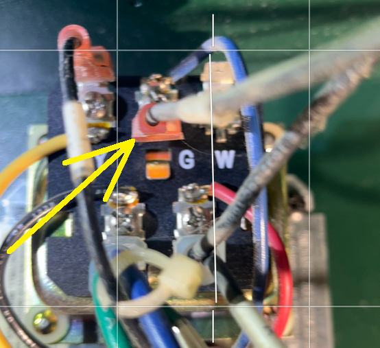

    Looks like your boiler is the Williamson GWA series 1 and it should not behave as it does (similar to a warm start configuration). The boiler and the circulator should follow the thermostats command.
    Looks like the Taco SR501 is wired correctly.
    To start to determine troubleshooting direction start where @mattmia2 stated.
    As @EBEBRATT-Ed stated the relay inside the boiler "CR" (Red Arrow) could be stuck, contacts welded, coil energized, or other mechanical defect. Note on your unit the connection plate on the transformer is spun 180 degrees compared to this image.

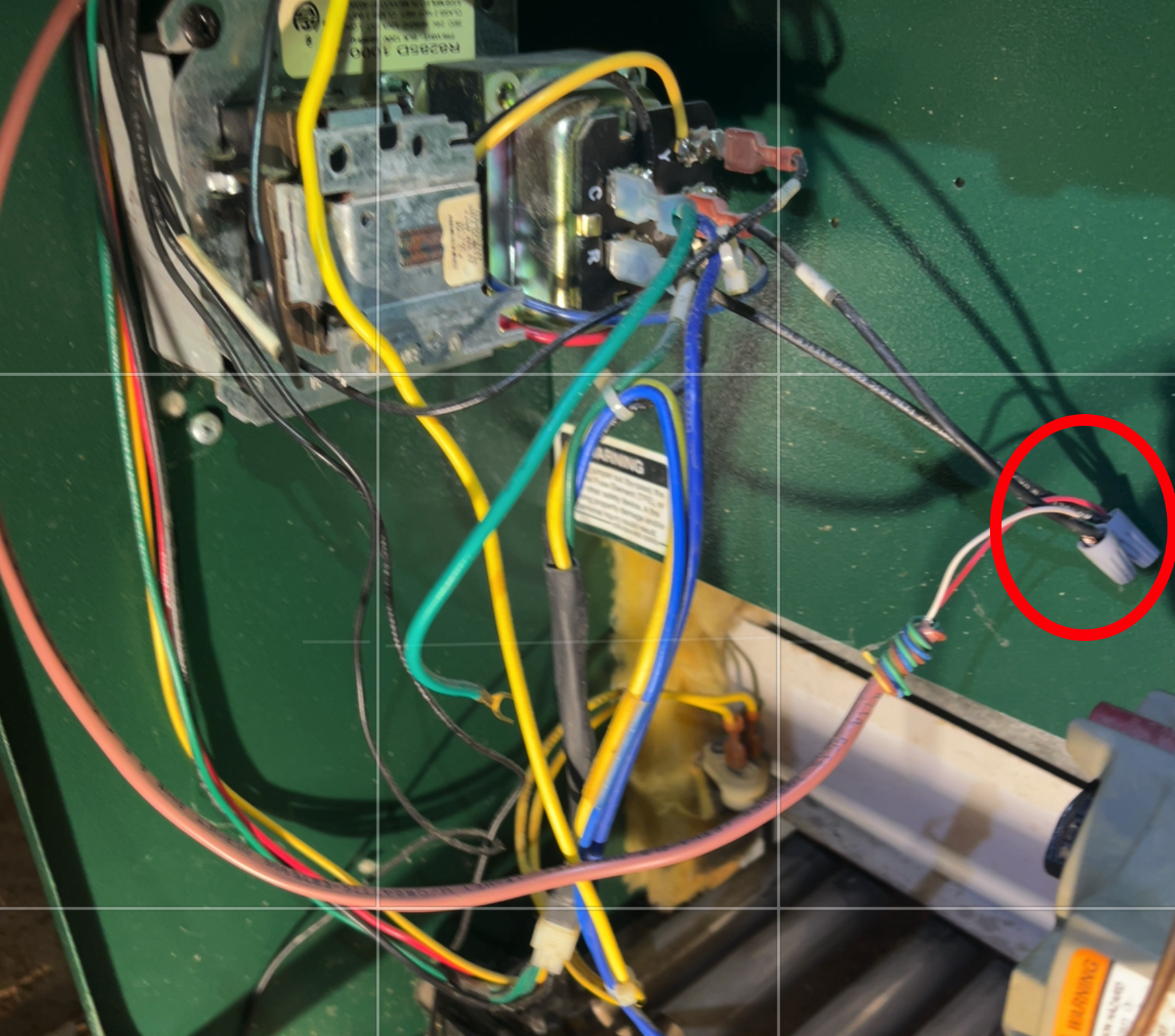

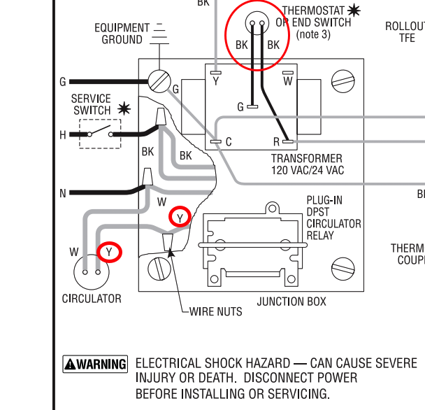

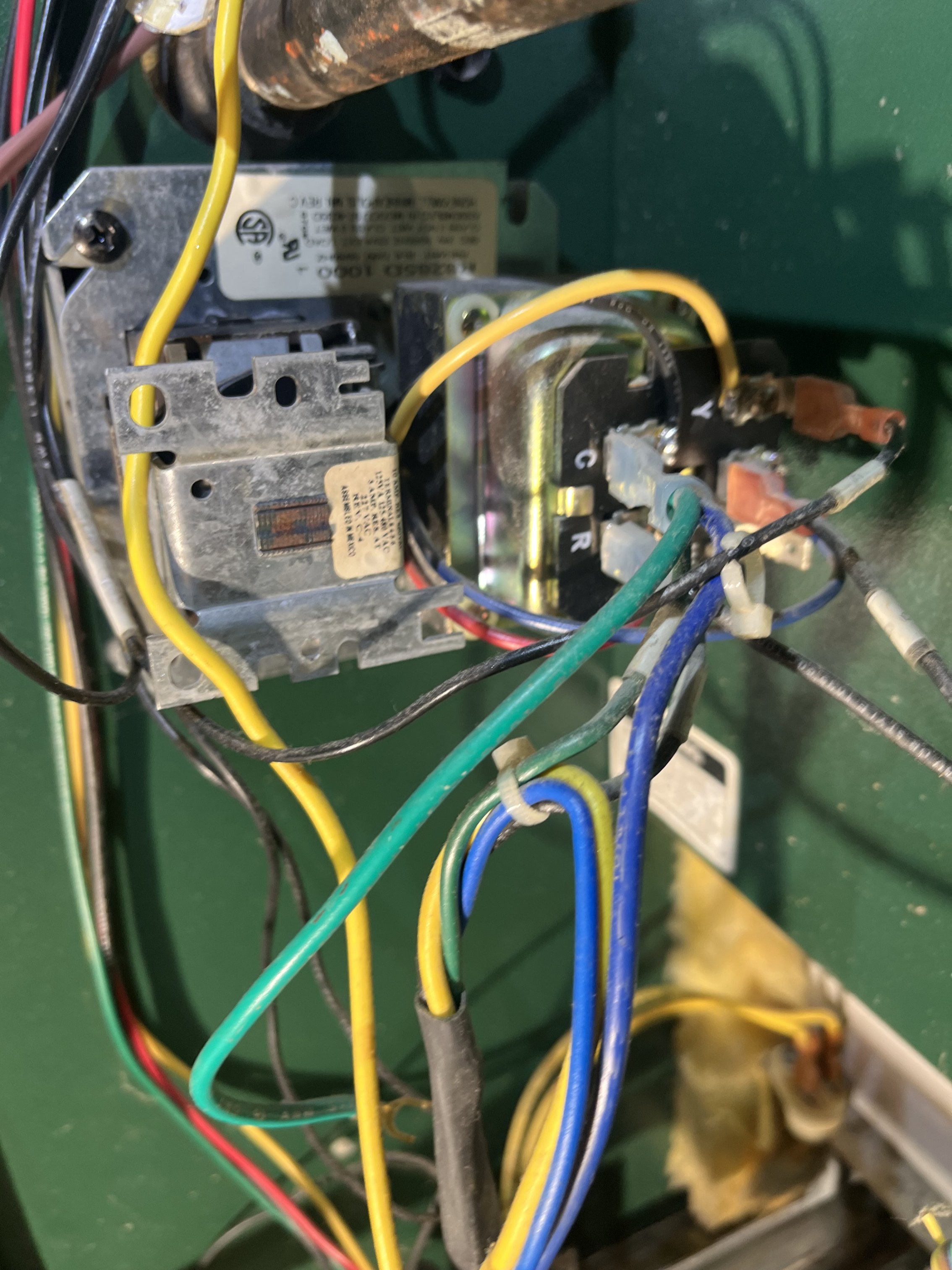

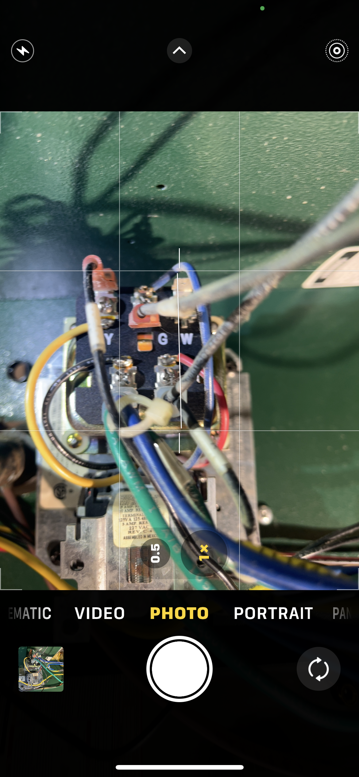

    As @109A_5 indicated, you have a series 1 boiler with standing pilot so this is your wiring diagram
    I wouldn't be surprised if that is not posted on your boiler somewhere. I have a red circle on this diagram where the thermostat is supposed to be connected on the diagram. Here is that connection on your boiler.
    In your case that is not the thermostat wire. Possibly because there were 2 zones at one time and each zone had a switching relay to operate each separate circulator. Since you no longer have two zones that control is not needed. The fact that it is still there means that you have more than one place to look for your problem. That thermostat wire has 5 or 6 conductors. Only the red and the white are used and they connect to the switching relay where @109A_5 indicated in this picture.
    Untitled Image
    1. The place to start looking for the problem is in the TACO SR501 switching relay.
    2. With the power off to the boiler and the boiler cold, remove both the red and the white wire from the SR501 in the red circle.
    3. Power up the boiler. The burner should not operate.
      1. If the burner operates then the problem is not in the SR501.
      2. If the burner stays off, then the problem is in the SR 501.
    Based on your findings, we can take the proper steps to solve the problem.

    EdTheHeaterMan Posts: 12,950
    EDIT:
    Since this did not stop the burner from firing, then this is not your problem but I will leave it here for others with similar problems to see in the future
    Move on to diagnosing the boiler CR relay problem.
    - - - - - - - - Original Text - - - - - -
    If you power the boiler with the Red and White wired removed from 5 and 6NO on the SR501, and the burners stay off, then your SR 501 is defective. Since you do not need that control, it can be eliminated easily.
    1. With the power on, touch the red and the white wire together and the burner relay should click and the burners will start. This indicates that boiler is operating properly.
    2. Turn the power off to the boiler
    3. Disconnect the red and white wire from the thermostat to the SR 501 relay and connect it to the red and white wire to the boiler as indicated by the blue wire connectors. OR, If the thermostat wire is long enough you can connect directly to the boiler wires indicated in this photo: Both will accomplish the same result. Screenshot 2025-09-14 at 9.34.27 AM.png
    4. The next step is to connect the circulator wire to the boiler relay as it was originally connected at the factory indicated by the wiring diagram.
      1. That is done by removing the wires from the Taco SR501 N and 4NO terminals that go the the circulator motor
      2. Now remove the transformer relay from the mounting box Screenshot 2025-09-14 at 10.57.17 AM.png
      3. Locating the two places to connect the circulator wires. If the diagram is correct then that should be a yellow wire inside that junction box and a white wire that already is connected to other stuff inside that box
      4. Connecting the wires from the circulator
      5. Replacing the transformer relay back on the mounting box.
    5. Now you can power the boiler on and see if the burner and circulator are off.
      1. if they are off, then set the thermostat higher than the room temperature and the burner and circulator will start.
      2. If the burner and circulator are on then set the room thermostat lower than the room temperature and the burner and circulator will turn off.
    This is easy and does not require any additional parts to solve the problem.

    It is starting to look like the relay "CR" in the boiler has an issue (could be stuck, contacts welded, coil energized, or other mechanical defect). Power down the boiler, remove the Red push on connector (Yellow arrow), restore power to the boiler and see if it still fires. This just eliminates all the wiring that goes to the SR501.
    FrankMaraschino
    109A_5 Posts: 4,761

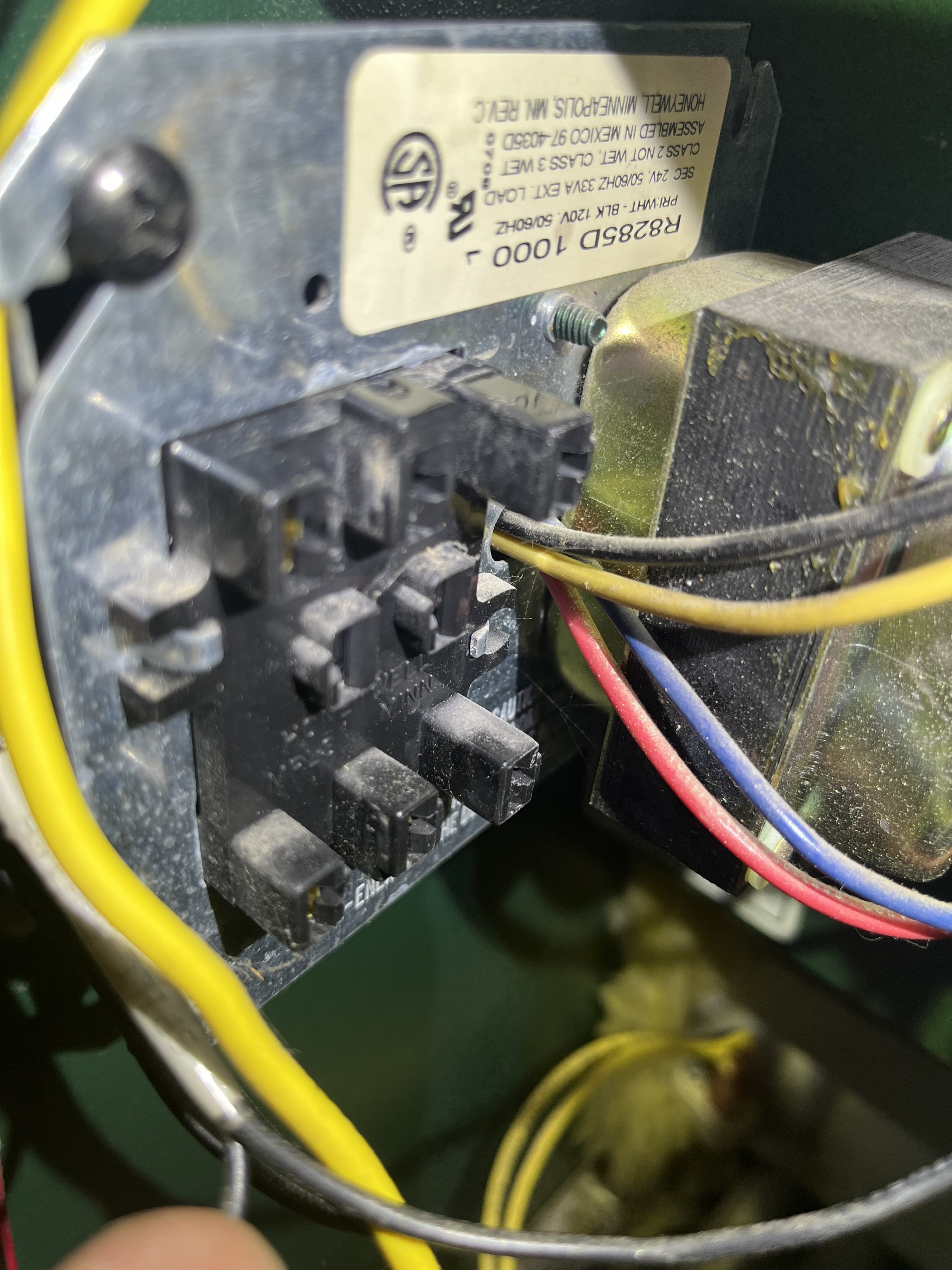

    If the boiler still fires I would next power down the boiler, remove the relay "CR" (Orange Circle), restore power to the boiler and see if it still fires up. While the relay is out I would inspect it for welded contacts or other mechanical defect that would keep the armature in the active state.
    If the boiler still fires with the relay removed you have a wiring issue.
    109A_5 Posts: 4,761
    The buzzing if excessive could be a mechanical defect with the "CR" relay. You may want to verify where the buzzing is coming from and when, it may be a clue.

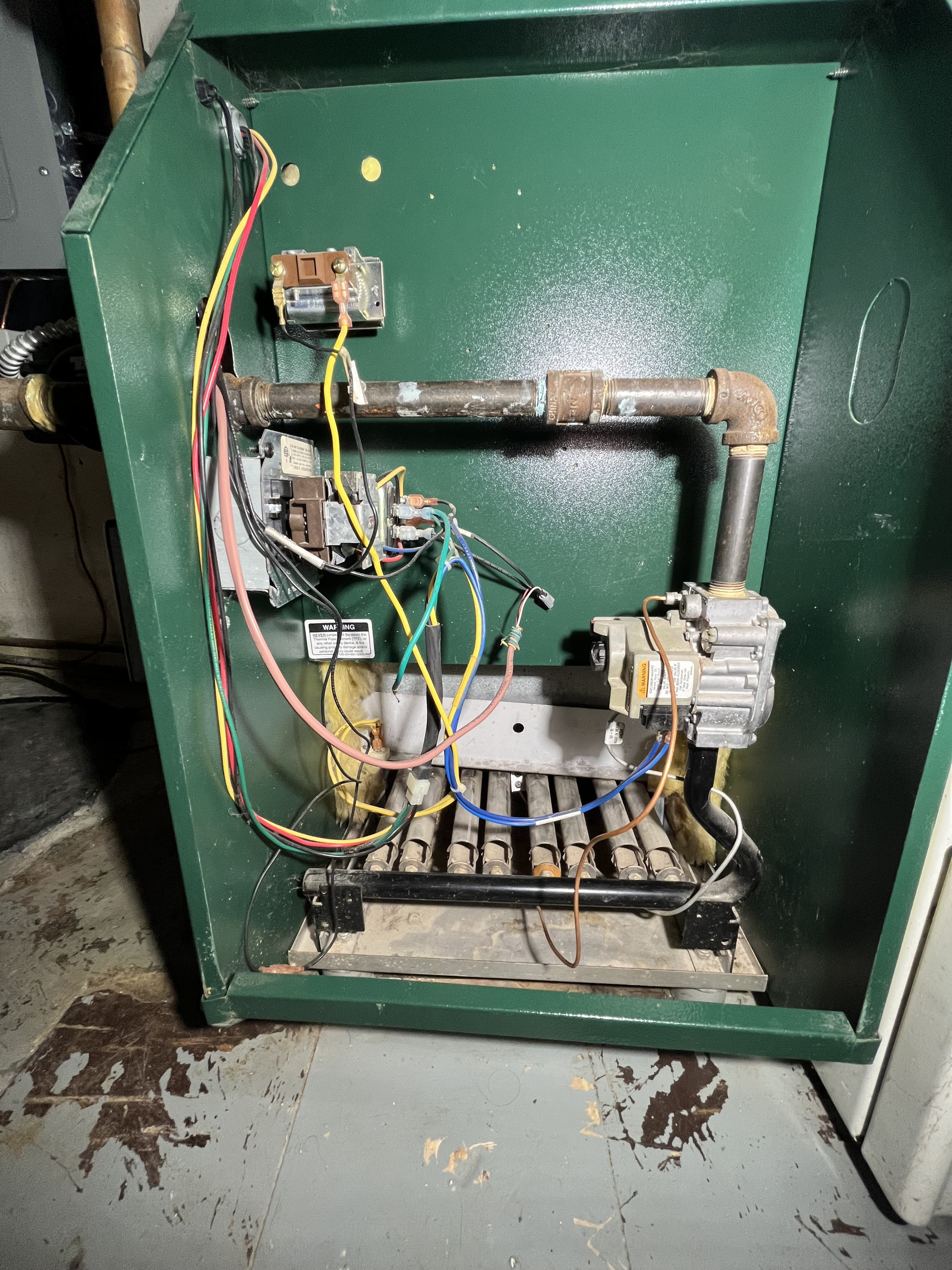

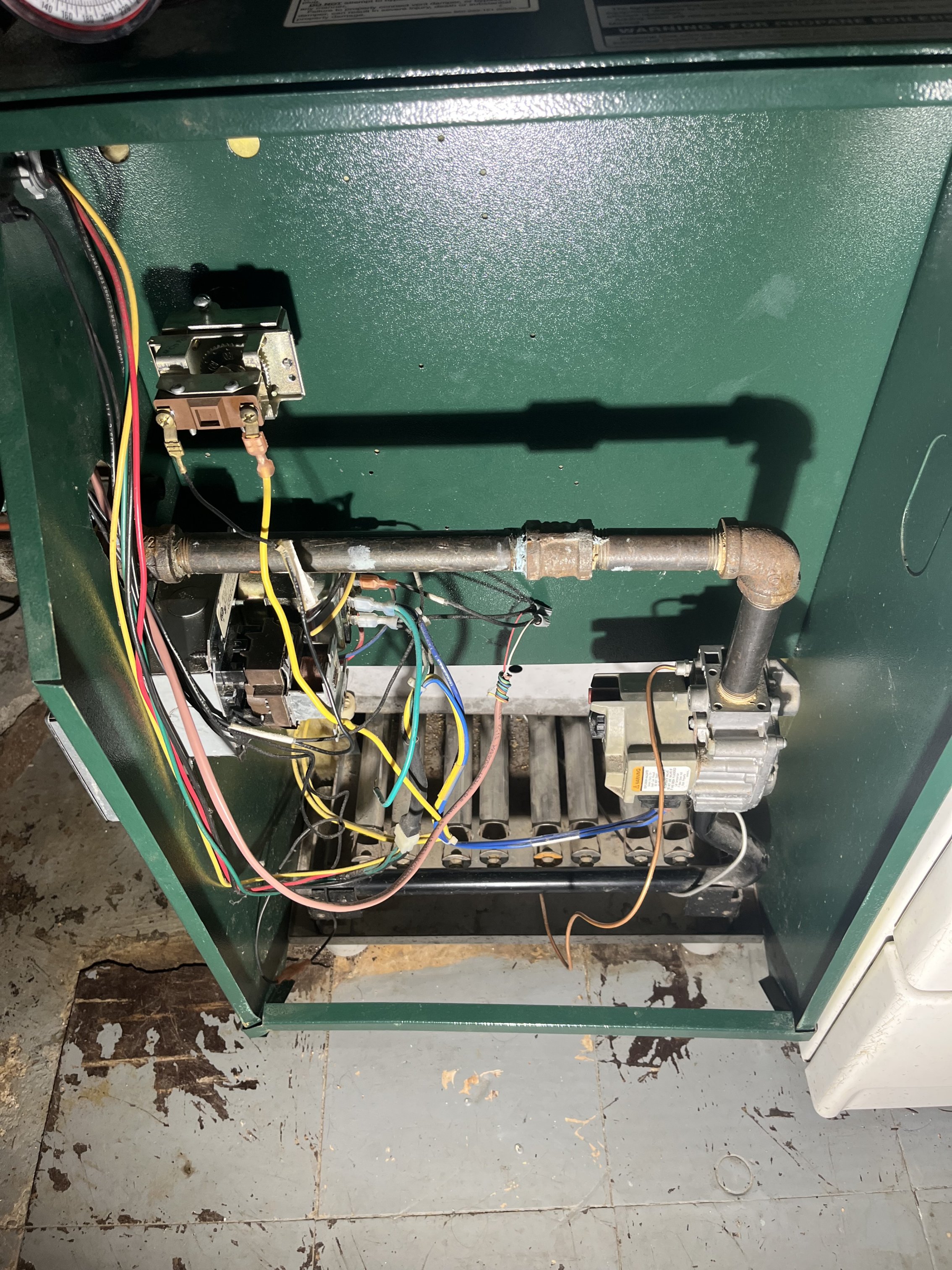

  • @109A_5 I removed the red push-on connector from the G tab as you indicated, then powered up the boiler. Damper opened and burner fired until the 180 temperature limit. I’ll move on to the next step you laid out and report what I find.

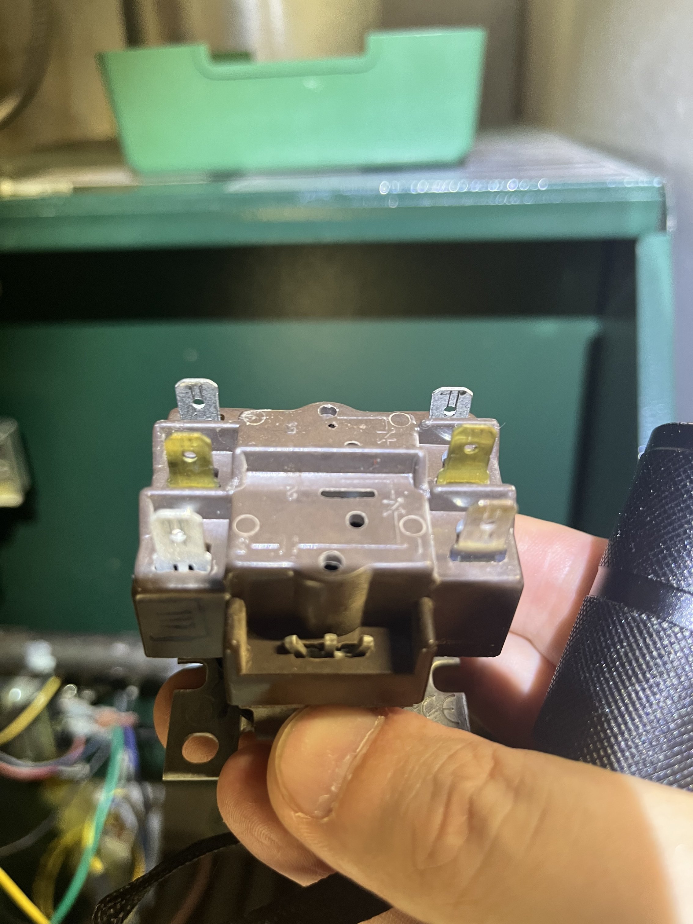

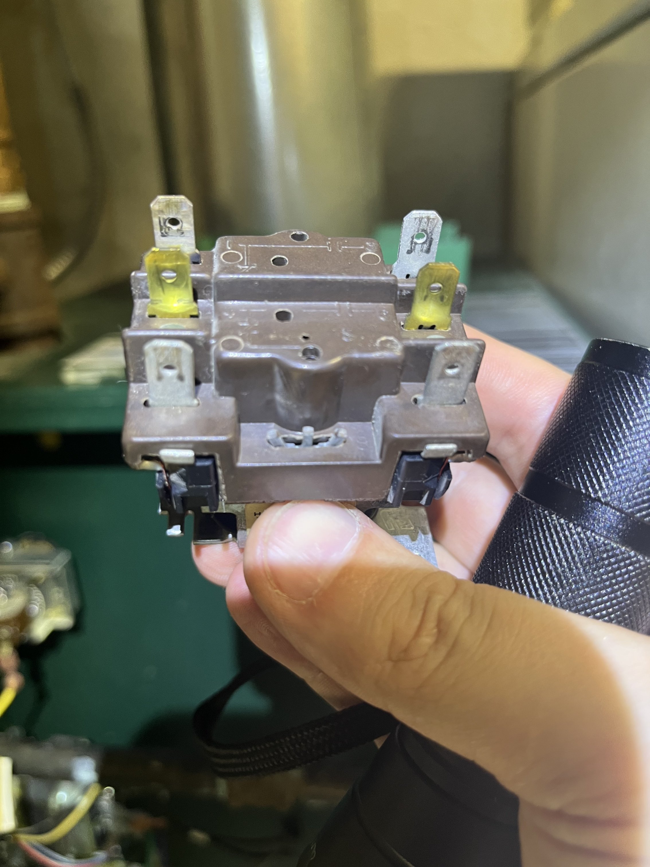

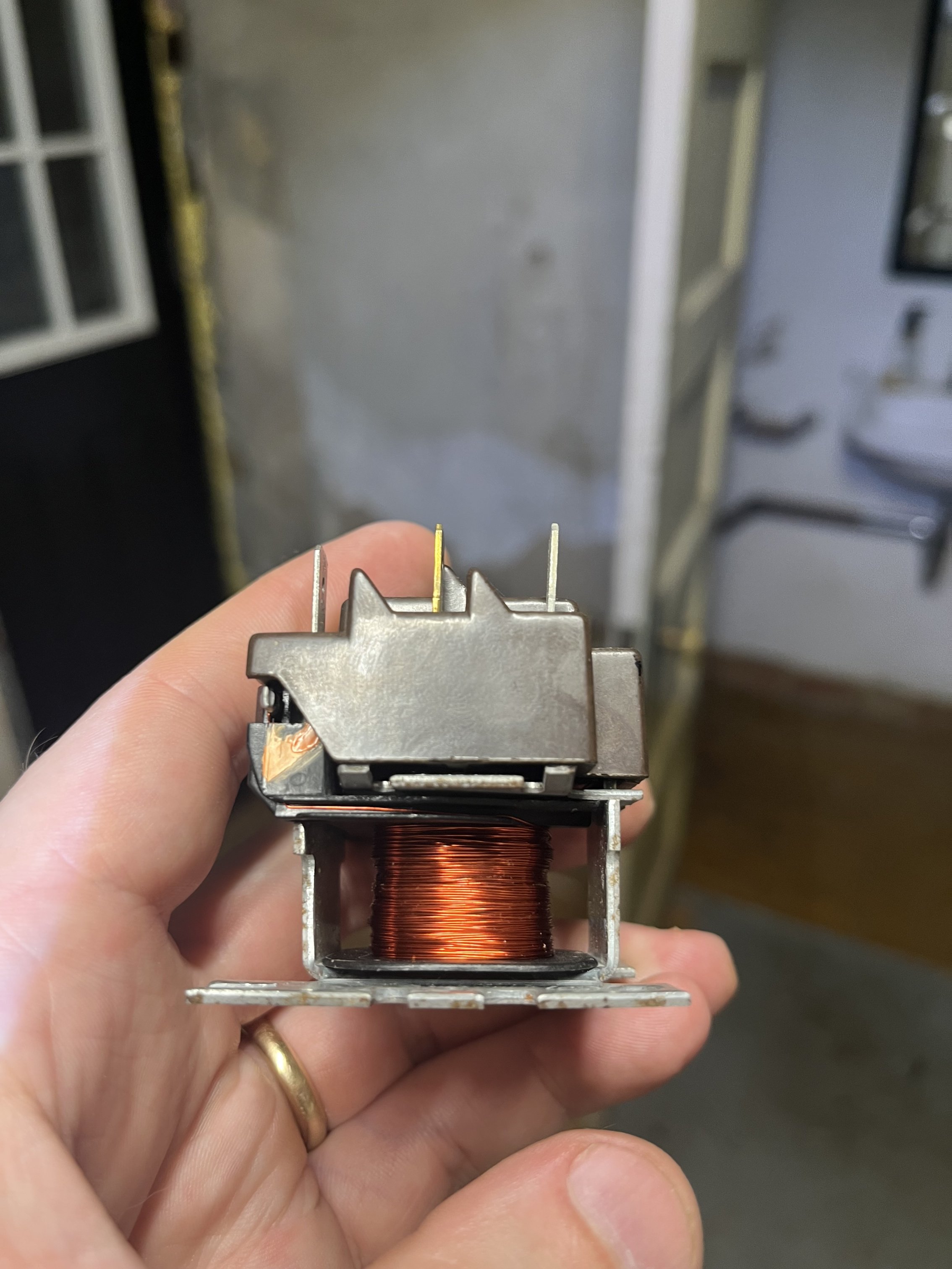

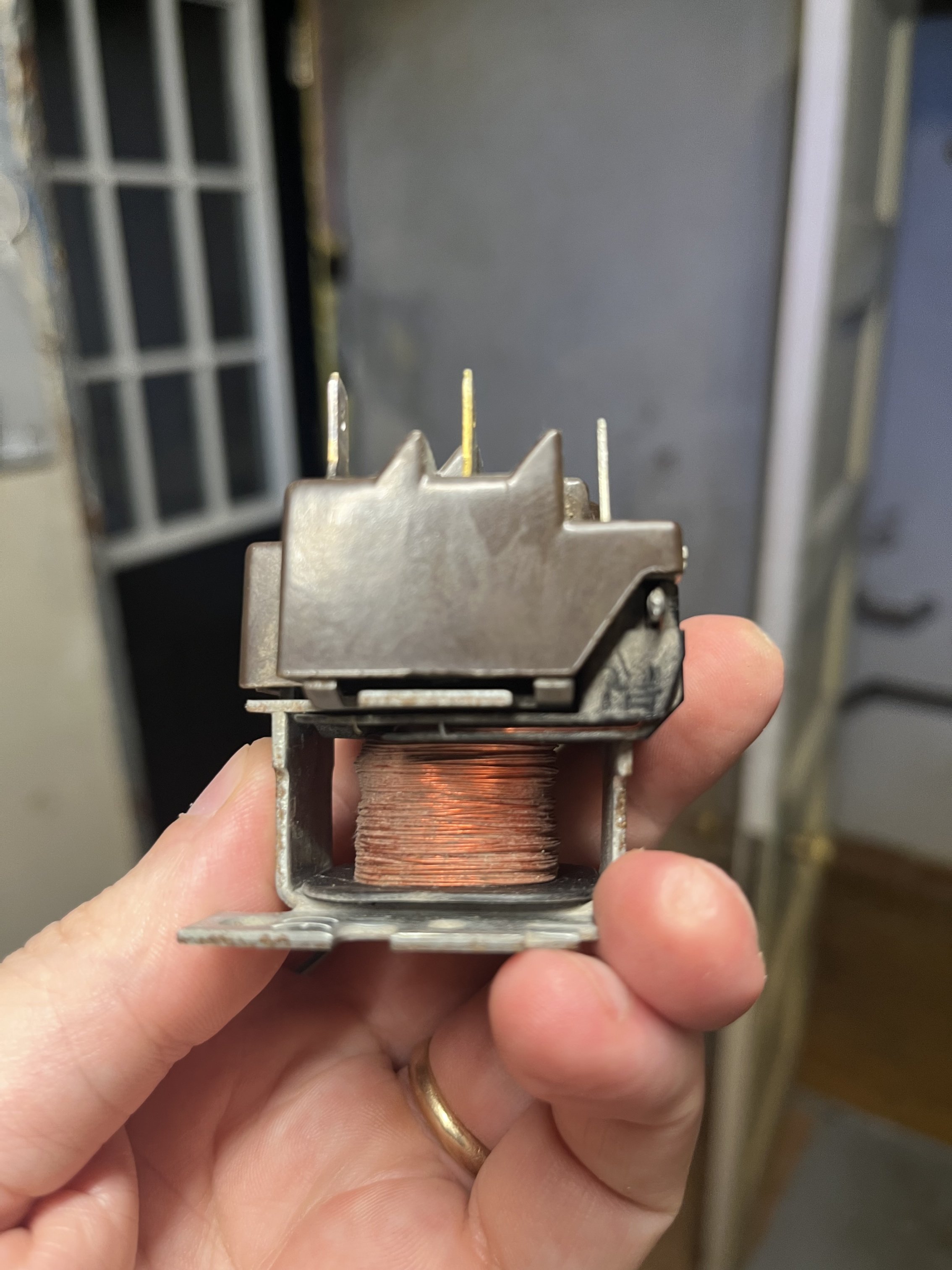

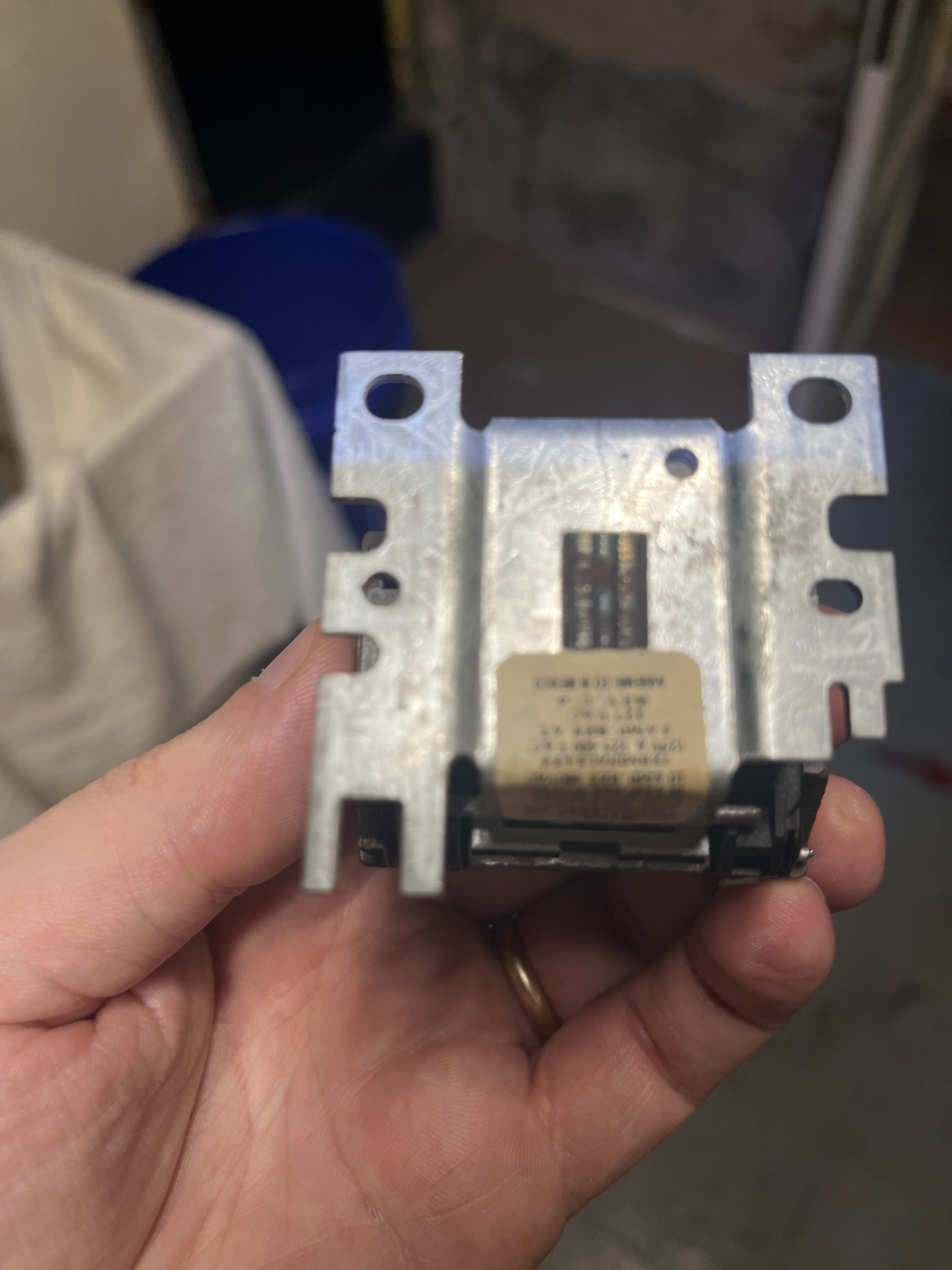

  • I removed the CR relay and inspected it. I didn’t see any evidence of arcing, etc. though to be fair I don’t really know what I’m looking for. I’m very familiar with home wiring but relatively unfamiliar with boiler wiring.
    I did notice that there are no ground wires connected to the Taco relay or the boiler power switch box from the armored cable coming from the circuit panel. I know the armored cable does have ground wires since it’s connected to the neutral/ground bus bars inside the circuit panel. Not sure if that’s relevant to anything or not.
    Anyway, I’ll let the boiler cool down a little and then try to fire it up with the CR relay removed.

    When you had the wire on the G tab removed and the boiler fired up was the buzzing you mentioned there still ?
    BTW with these tests you don't have to wait for the boiler to get to 180, just does it fire up or not.
