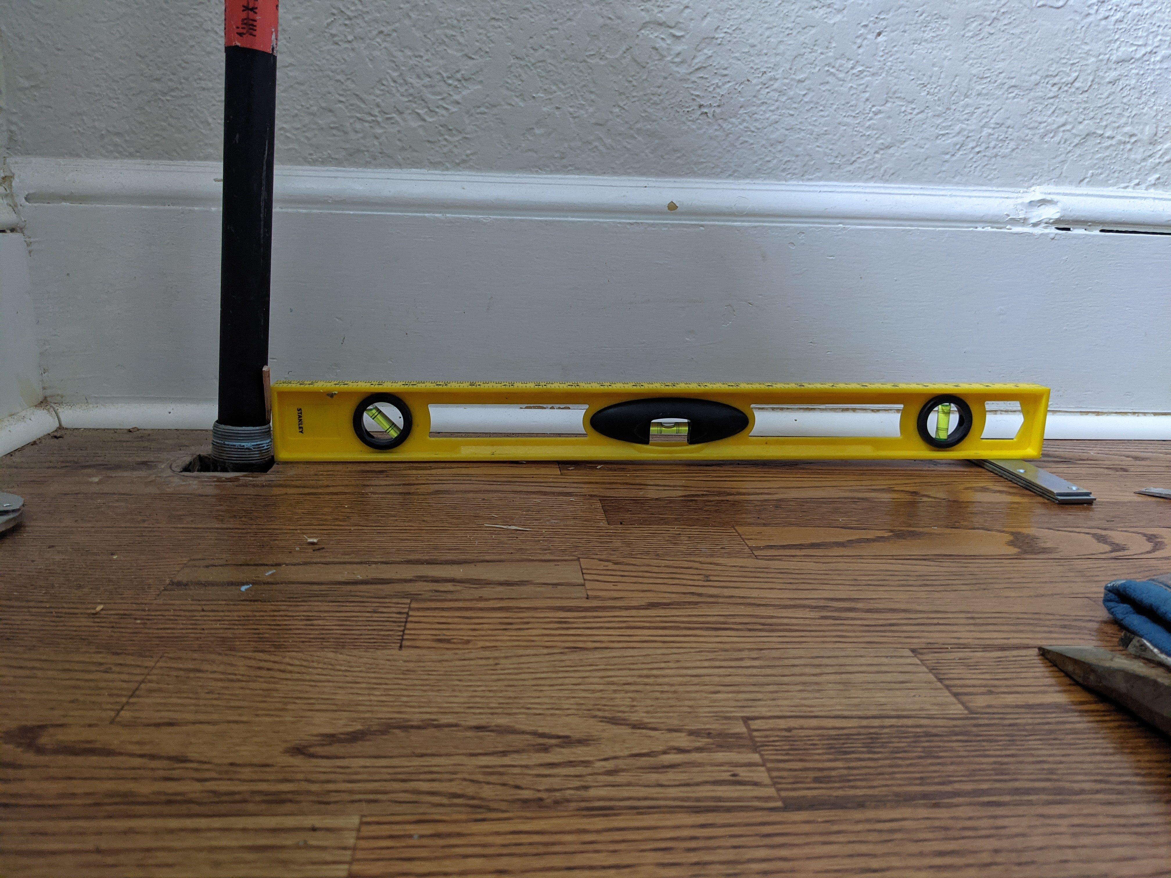

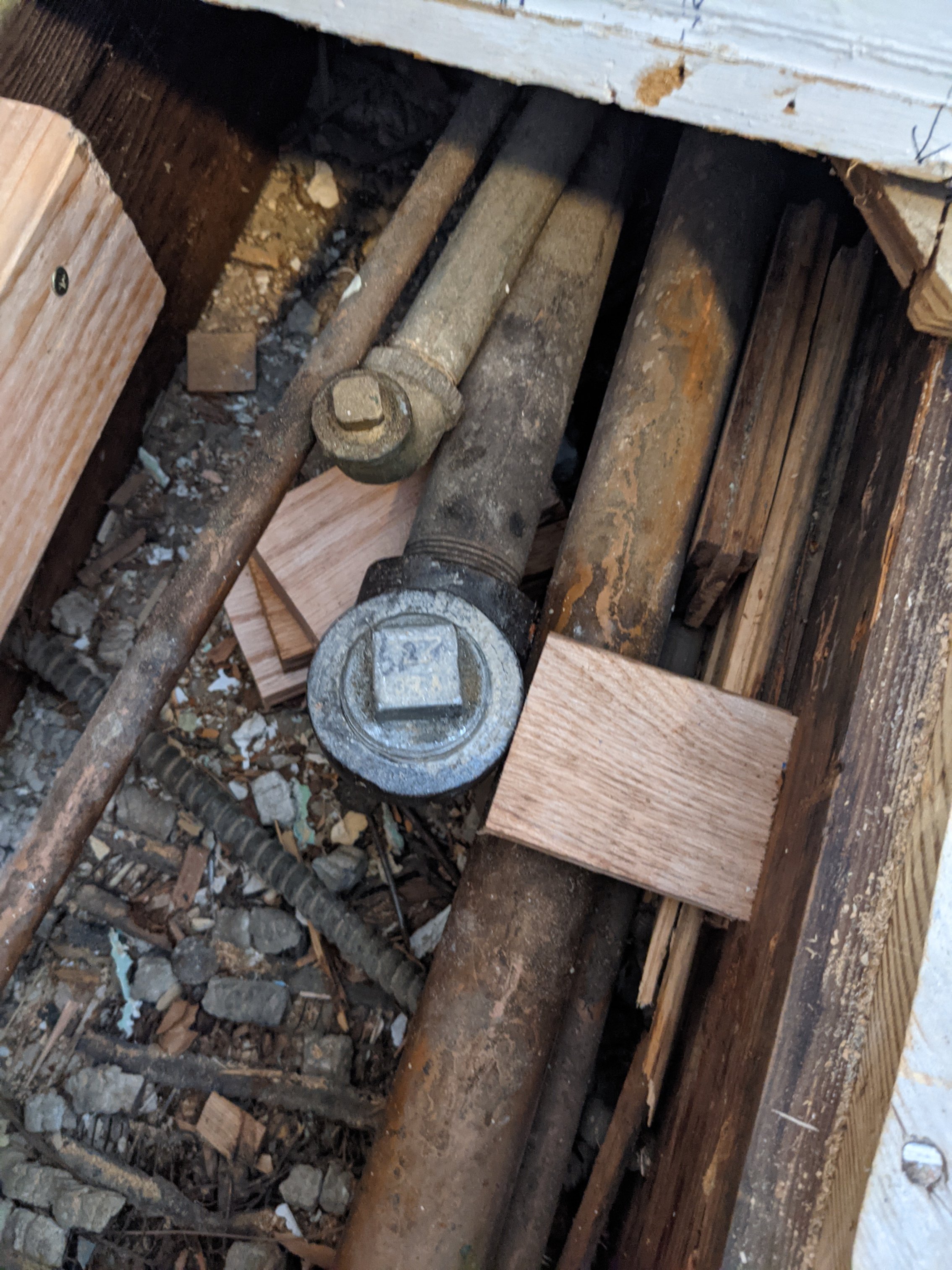

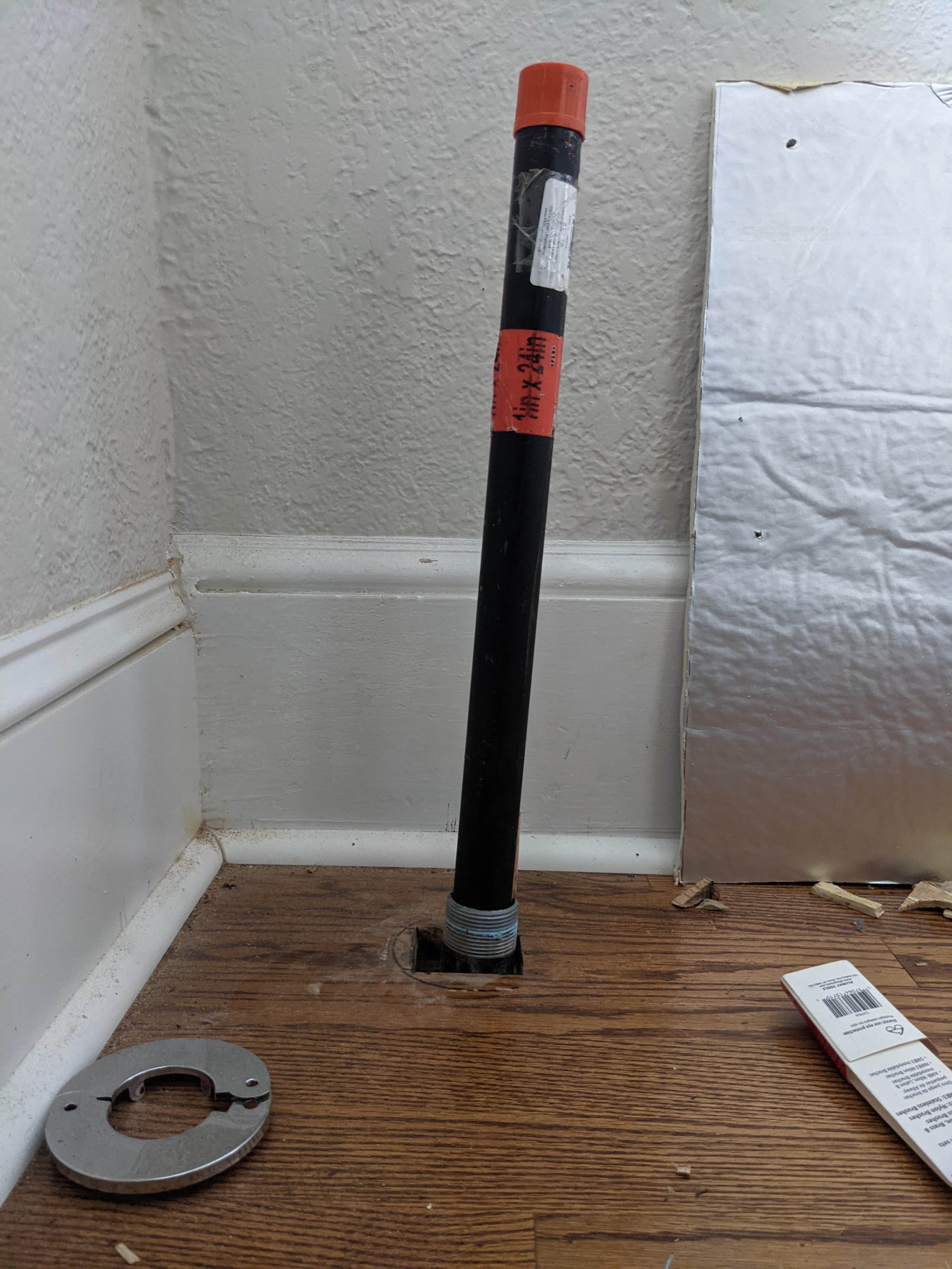

During a house renovation, in a room that used to be a kitchen, I discovered a number of pipes beneath the floorboards. One of the pipes was for steam heat, so I decided to add a radiator to this room. I opened the pipe by removing the cap and added a short extension pipe as a starting point for a future radiator connection. I then finished the floors around it.
Somehow—naively—I assumed that the extension pipe would be plumb, but it turns out it’s not. Since the floors in this old building aren’t level, I’m unsure how to proceed. If I attach a valve to this crooked pipe, the angle between the pipe, the valve, and the radiator might be too steep for a proper union connection.
Should I try using a longer extension pipe and attempt to make it vertical? Or should I consider a different method for connecting the radiator?
EDIT (extra details):
1. the pipe you see under the floor IS slopped back towards the main (one of the few things i did check)
2. the steam pipe is coming from under the wall (the wall you see behind), so if i put the radiator where the yellow level is, it would be 90deg from pipe to radiator
3. i played with putting the radiator as Mad Dog suggested close to the wall on the left of the picture BUT then i would have 6in gap between radiator and the wall…

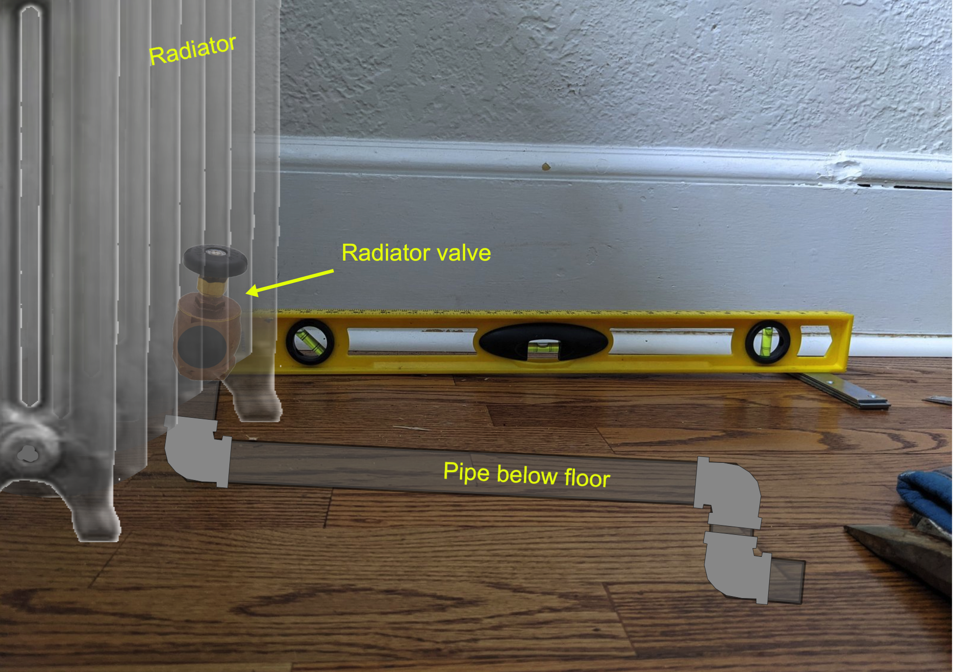

    Jamie Hall Member Posts: 27,224
    With any kind of luck, that means that the more or less horizontal runout under the floor isn't horizontal — that it's sloped back to the main, as it should be. That would be very nice…
    And no, that is WAY too much out of line for a union to work. In fact, any alignment error is too much for a union.
    However, there are ways… and the best is create a swing joint with two elbows at 90 degrees to each other (or one 90 and one 45) and a straight, rather than angle valve. With two elbows — I'd use street elbows — one can correct any amount of alignment error.

    Can you swing radiator along adjacent wall? Mad Dog
    EdTheHeaterMan Member Posts: 12,018
    I like that idea!!! Then the valve will be plumb to the angle of the radiator and no need for a swing joint above the floor

    delcrossv Member Posts: 2,200
    Swing joint(easiest for the homeowner) or cocked threads (need a good fitter to get that right).
