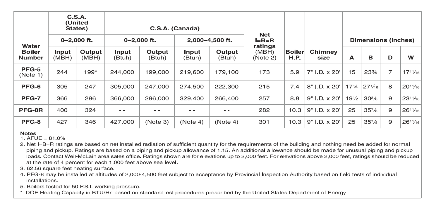

    @2x_Tom, you mentioned that you have a "255k net". the word NET is important, because that means something in boiler sizing. Input can be as high as 350,000 input. and there is no way a boiler with that much gas input can be vented in a 5" diameter flue pipe.
    There are several BTU ratings on every gas fired boiler.  there is the input.  That number is how you size the gas pipe and the vent system.  If you look at the PFG-6 boiler above, you can see that it has a 305k input number.   Now look all the way over to the Net I=B=R rating of 215k. That is the Net number you are talking about if you are using the correct terminology.  That boiler is slightly smaller than the 225 NET you stated in your original post.  If you look at the last column on the ratings, that heater requires an 8” vent.  So unless your chimney is over 50 feet tall, that 5” liner will not be able to properly vent that heating appliance.
    If you can get the manufacturer's specifications on your customer's boiler, then you can show the customer where the chimney company is mistaken.  Then you can let them deal with the problem.  You gave them the proper info and you deserve to be paid for that information.  The chimney Company is now responsible for getting the heater to vent properly with the work that they did and probably got paid for by now.  If the customer used a credit card, they may have some recourse.  Otherwise that chimney company will just walk away with the failed repair and keep the money.

    Even a 225K boiler needs a 7" diameter x 20' high vent.  So, reducing from 8" to 7" might be OK but you have the right idea.  That 5" is not going to work.
