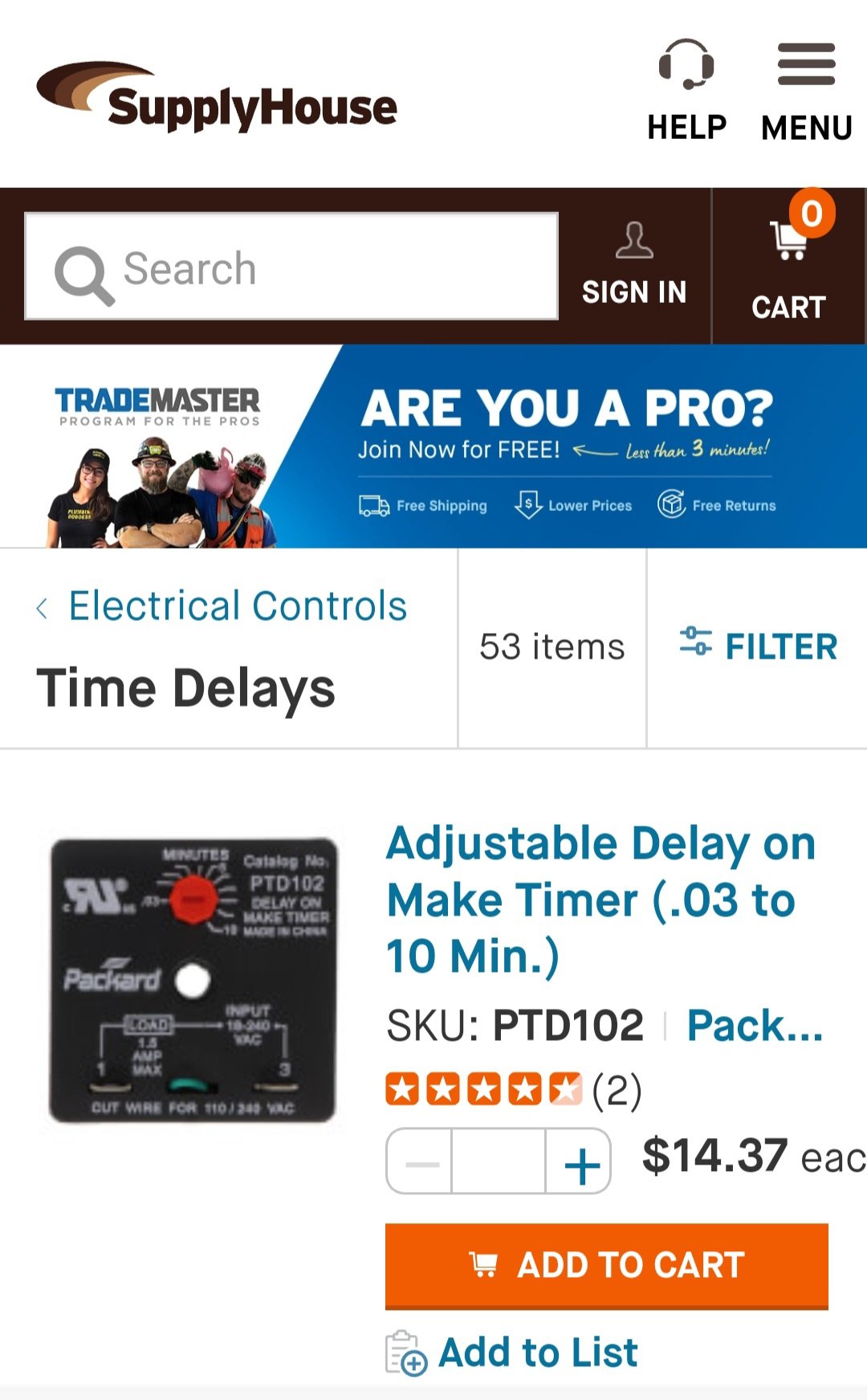

    HVACNUT Member Posts: 7,308
    This would work, but…
    it strictly time. It doesn't know what the load is. It would be nice to work off temperature. Can you explain or show the wiring?

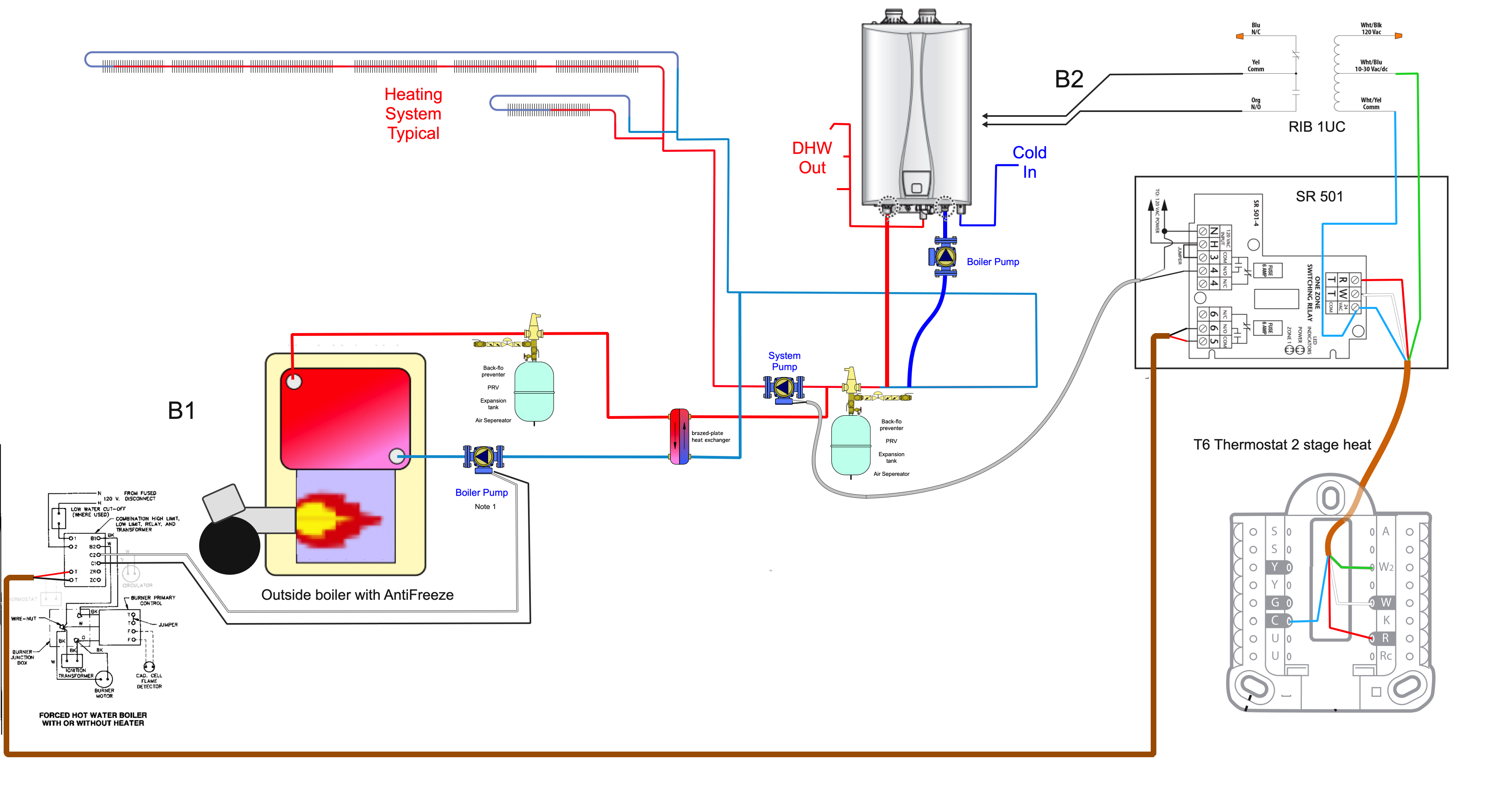

    Without the actual model numbers of your actual equipment, i have used some generic wiring devices to illustrate what I believe you have existing, although I do not know what is making the oil boiler call for heat to operate the burner and circulator pump.
    User: "Screenshot 2025-08-18 at 11.05.11 AM.png"
    A WiFi thermostat is operating a typical ModCon-Combi boiler's Central Heat (CH) circulator pump and the gas burner. It was installed as the manufacturer recommended.  After that system was installed and operating properly, there was an auxiliary outdoor oil fired boiler added with a heat exchanger so that the antifreeze water and the indoor CH system water were separate systems.
    I do not know what might make the call for heat to the oil fired boiler might be since the room thermostat is operating the CH by way of the Combi boiler.  That is why there is a question mark (?) on the diagram where the oil burner control thermostat is supposed to be connected.
    If you can provide the model number of your Oil boiler, your Combi boiler, and your thermostat, I can draw you a diagram of the best way to operate your system.

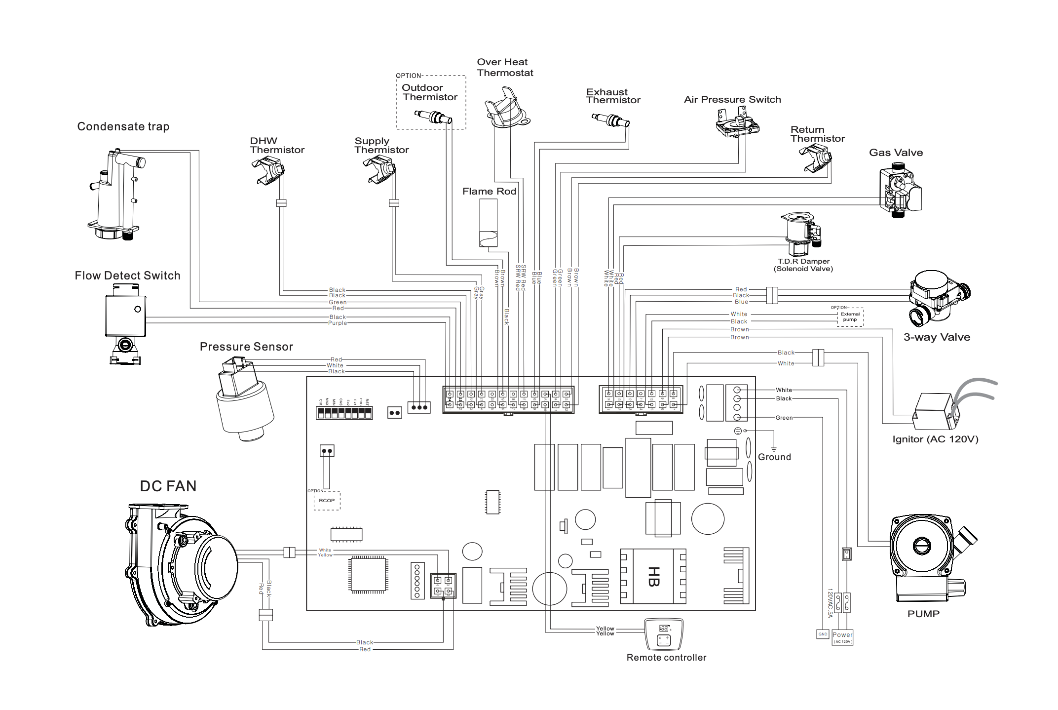

    I looked at the VESTA Combi Boiler instructions. It appears that there is no room thermostat with the standard wiring of this boiler. Since you indicated that you have a Honeywell WiFi thermostat, I was interested to know where it is connected to, on your boiler.
    Also, does the oil boiler have a control that a thermostat might be connected to that also operates the circulator pump? Perhaps a Honeywell L8148 aquastat. If not then how does the burner know when to stop operating at 160°, and how does the circulator know when to move the water from the boiler to the heat exchanger? Is the oil boiler circulator always operating constantly?
    A cold start oil boiler will use less fuel, or perhaps one that is set at 80° and a call for heat will ramp it up to 160° will keep the boiler warm on the off cycle but not use as much fuel.
    I believe that the Beckett AFG burner is equipped with a primary control that has a manual reset button for flame failure. That control may have a thermostat terminals labeled T T. Those are not the thermostat terminals I would like to use. I would like to use the thermostat connection that will operate both the burner and the circulator pump.

    This is the wiring diagram that I might recommend. I'm not to sure about how your piping is connected, but you should have a system circ pump, and a boiler pump for each boiler. You may even have another pump from the oil boiler HX to the system, and I can make that circ pump operate with the oil fired boiler if needed.
    If your actual controls are different, I can re-do the diagram with your AS BUILT specifications.
    The Sequence of Operation will be on a call for heat from thermostat stage 1, the oil boiler (boiler #1) will fire from the low limit base temperature of 120° and be allowed to get as hot as 170° before the high limit cuts off the burner. The call for heat from stage 1 will also operate the #1 boiler circulator pump and the system pump until the call for heat is satisfied (Even if the boiler is off by the high limit). If for some reason the oil boiler fails to maintain the room temperature for any reason the second stage of the thermostat will kick in and the gas boiler will automatically heat the system and the #2 boiler circulator and system circulator will operate to heat the home.
    This is a better way to operate your system using staging and if you already have the proper parts, you may just need the inexpensive relay to complete the job.
    Looking forward to finding out what controls and relays you already have.

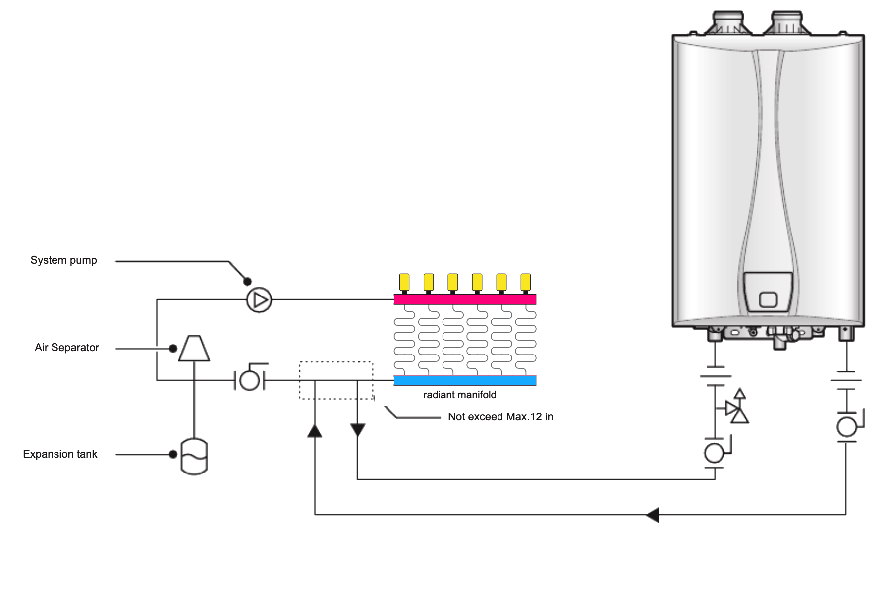

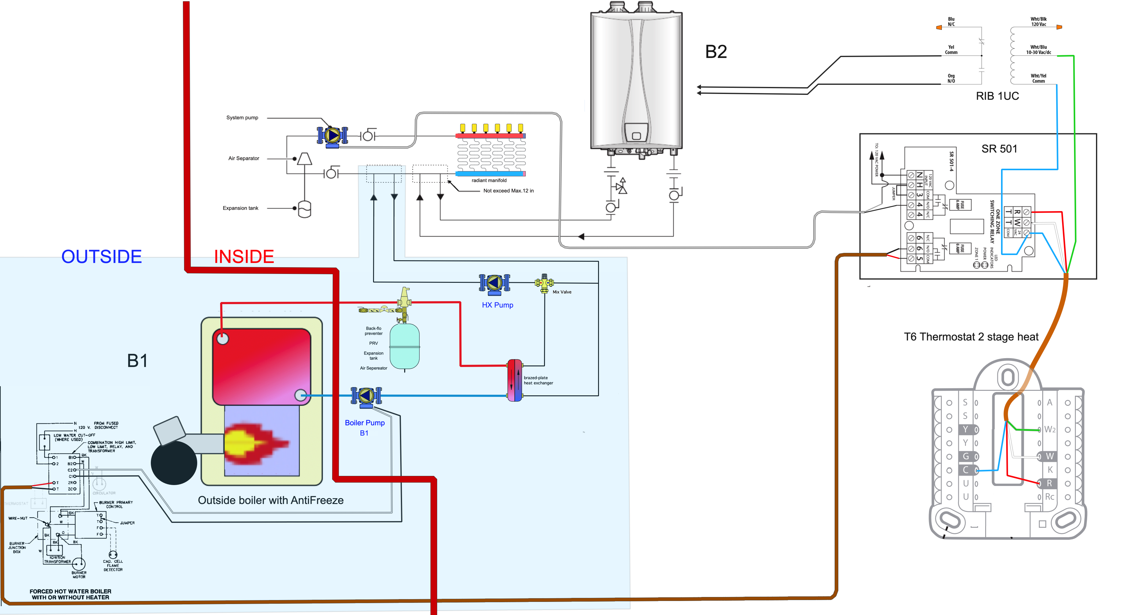

    Here is a basic piping design that will get you where you want to be with the lowest cost components. Bob may have improvements. The wiring design still looks good for this arrangement. I just need to bring on the HX pump with the outdoor boiler call for heat. The outdoor boiler pump will operate whenever the oil boiler is firing so the water circulates to the HX which should be located inside the Vesta gas boiler room.
    The blue shaded area is the oil boiler additional piping added to the Vesta boiler's I/O manual drawing for a one zone system …where I added the radiant heat emitters and removed the baseboard emitters.
    EDIT: I might make a note here that both boilers will not run at the same time. This piping is for an either or scenario. The Gas boiler will come on when the oil boiler fails to operate by the second stage of the thermostat. That will usually be when you run out of fuel or if there is a flame failure condition with the outdoor waste oil boiler. The Combi boiler will operate as a backup. I would change the system connection for the HX if both boilers were designed to operate at the same time in order to maximize the output of both boilers.
