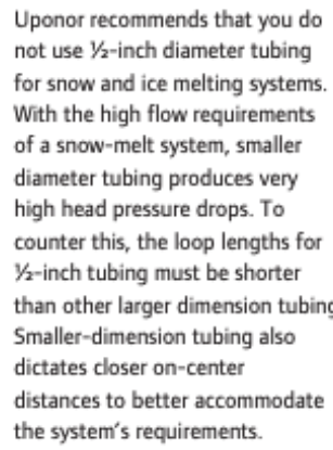

    You need to move a lot of BTUs of cold glycol in a SIM. Uponor suggest 5/8 or larger tube. 1/2 maybe for some stair treads where loop lengths are very short, you need a tight spacing.
    Assuming the bays are covered you are designing more of an ice removal or anti-icing protection system, no real snow load to speak of.
    So the tube and spacing as well as loop length dictates and SWT/ gpm dictates how many BTUs you deliver.
    All the info about SIM design here.
    https://www.uponor.com/getmedia/50a684b6-091d-4044-b8f7-c06f7705668c/snow-and-ice-melting-design-and-installation-manual.pdf?sitename=USA

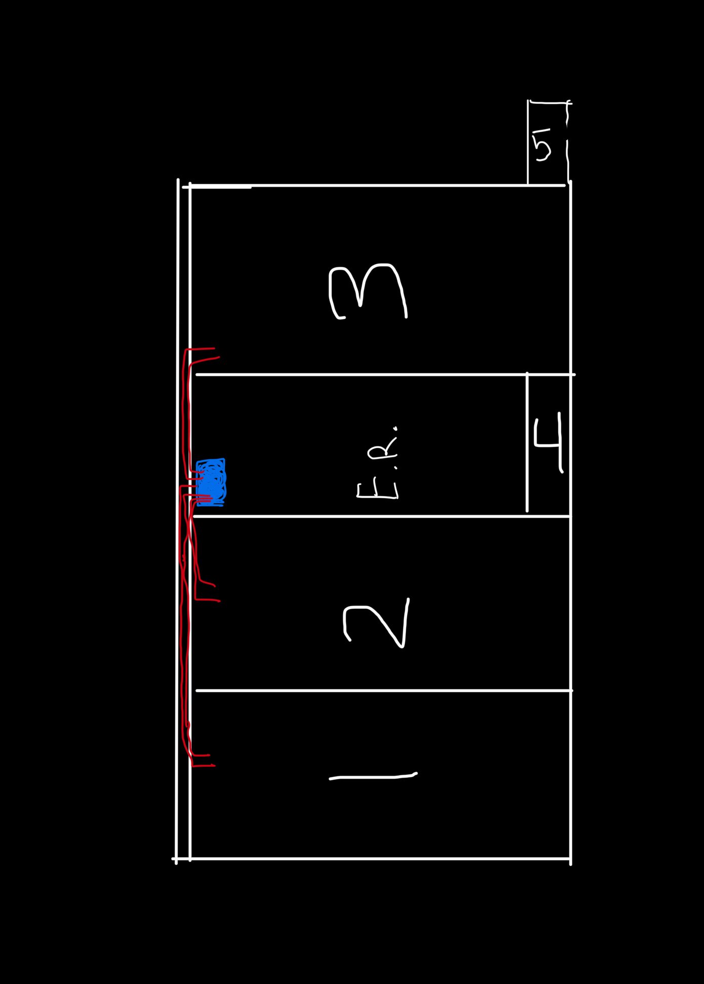

    Some more information: This is in Michigan with an average winter temperature in the 20s. Each bay is enclosed by 3 walls with the 4th being the opening to the bay. There is no door, it is constantly open to the elements on the opening to each bay.
    There is a roof to prevent most of the snow from entering the bay but some does blow inside with the wind. Also each car that uses the bay blows off piles of snow that needs to be melted from the floor heat.
    We will be pouring a 6 inch pad with R10 insulation at the bottom of the slab.
    Below is a picture of the layout with the bays labeled 1, 2, and 3. Areas 4 and 5 are where customers can walk to for vending items and will be heated as well. The label of E.R. Is the equipment room in the center of the building.
    I have colored in the blue area for where I would like to put the boiler. The red lines and where the pex will be running out to the bays. There are paver stones in that small gap leading to each bay that I can remove to lay down the pex and make the runs into each bay.
    Total is 1900 square feet.
    Currently I'm torn as do either 1/2, 5/8 or 3/4 pex. And then depending on the size whether to do 6 inch or 9 inch spacing.

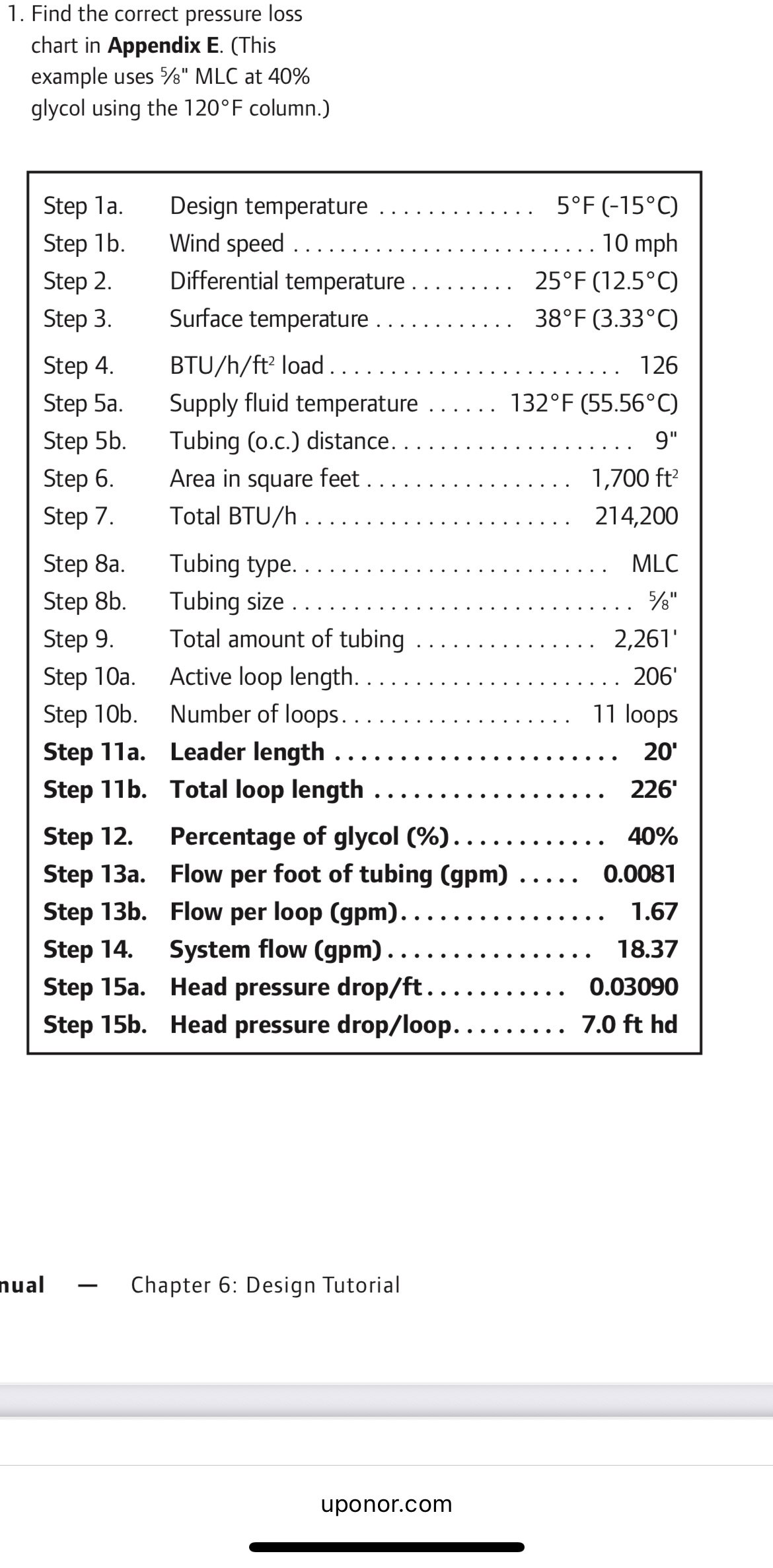

    Here is a design from that Uponor design SIM (snow ice melt) book that is fairly close, for an example.
    You have a bit more square footage so call it a 240,000 load
    126 btu/ ft at a 5 degree design, 5/8 tube, 9” oc
    I think something like 2700’ of 5/8, 12 loops at 225’ Bay 1 will take more leader length, bay 2 hardly any. A loop layout design will show this

    Now that 237k load needs to be divided by the loops and the btu they can carry
    12- 1/2” loops need 1.6 gpm per loop to move 237K. Agsin using the PPI calculator
    With 40% glycol at 60f, in a 200’ loops that will take an expensive high head circ. This is one reason that SIM generally uses larger tube, minimize the pressure drop that the cold glycol penalizes the flow.

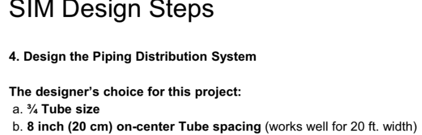

    Search around, all the major tube manufacturers have some design examples online
    The non biased PPI, has a easy simple SIM calculator also, link below
    An example of their design attached, again with 3/4” at 8” oc
    https://www.plasticpipe.org/common/Uploaded%20files/1-PPI/Divisions/Building%20and%20Construction/Division%20Publications/Presentations/Design%20and%20Installation%20of%20Hydronic%20Snow%20and%20Ice%20Melting%20Systems%20to%20Optimize%20Performance%20and%20Efficie/BCD-presentation-design-installation-sim-systems.pdf

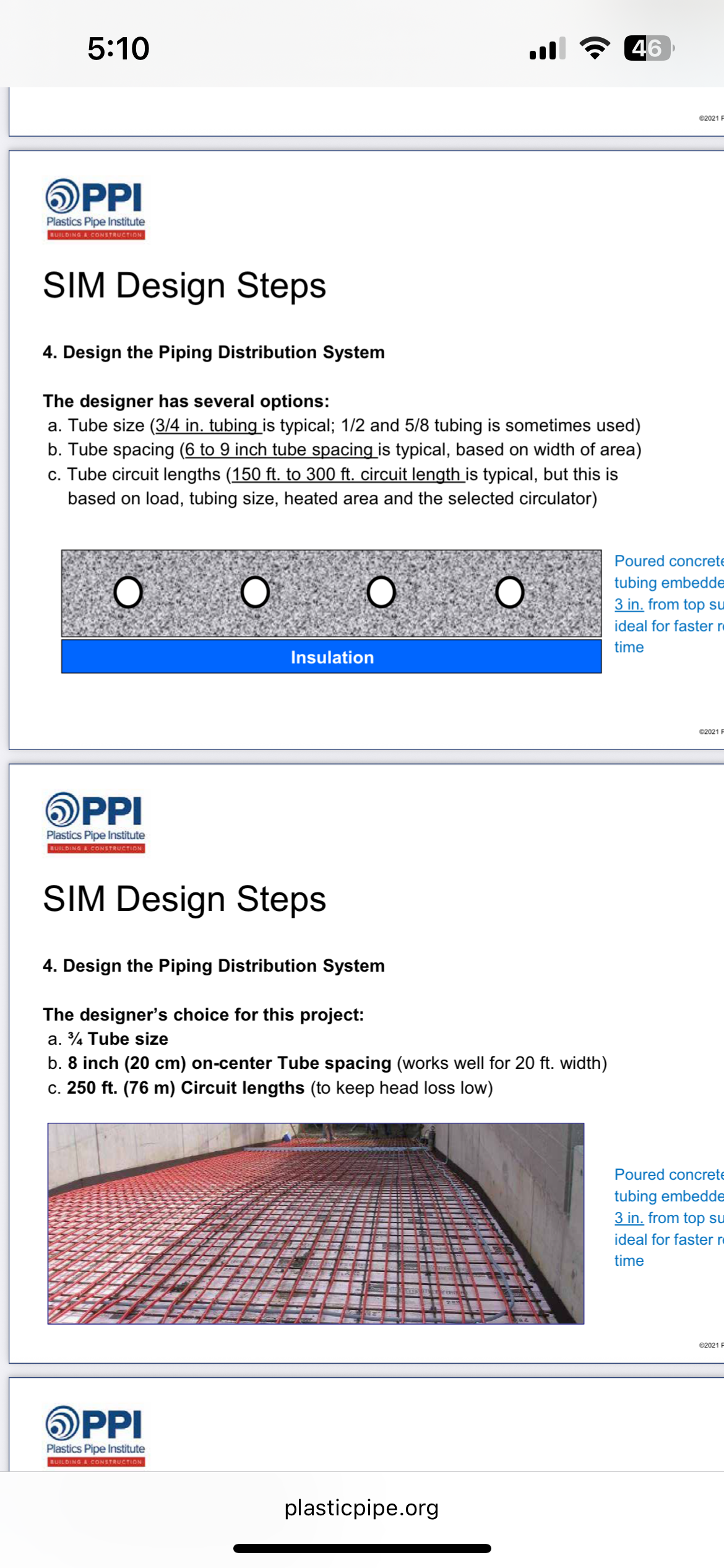

    I suspect the screenshots I offered throughout this post were generated in SIM software from Uponor, PPI, Rehau, others.
    There is no specific way SIM HAS to be done. But there are industry guidelines based on hundreds of systems that perform to expectations.
    The tube size recommendations, the 25-30 delta, tube spacing, loop length, SWT, flow rate, etc, etc all come from the manufacturers design example. These are not numbers I'm pulling from thin air.
    When you have a load calc done by one of the reps or manufacturers, and sign off on the assumption doc., they guarantee the system will perform as designed.
    If someone designs for a 25- 30 and only attains a 50∆, they missed something. A 50∆ in a 200' loop seems awful high?
    While running tighter delta increases the slab btu output a 20∆ probably isn't juice worth the squeeze for melting snow, considering the pumping power required to get there. An example attached of 3 different ∆Ts and their output change. Same SWT in all cases. I'm seeing a specific pattern from the 3 or so examples I have shown which is 5/8 or 3/4 tube size, 25- 30 delta.

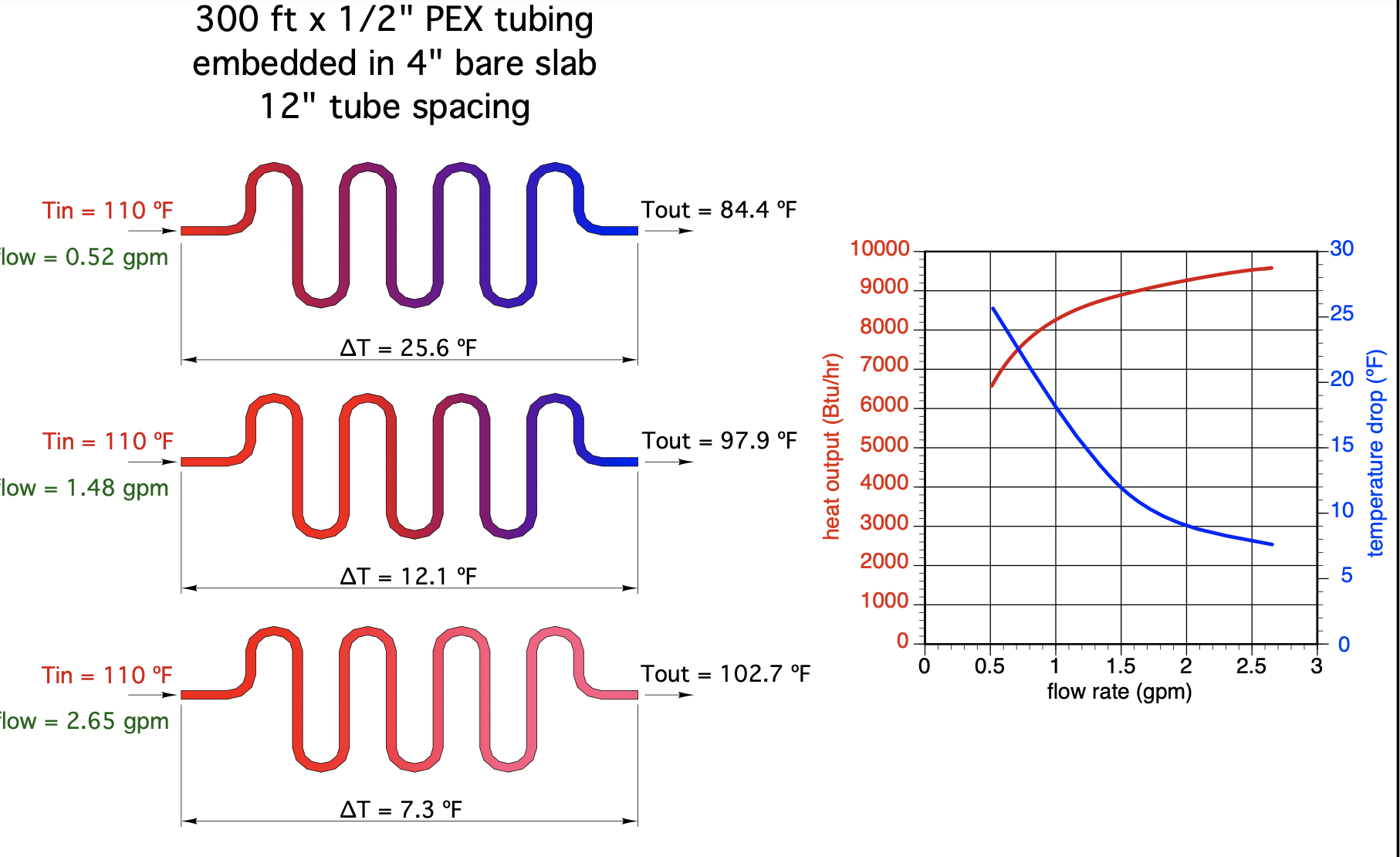

    ( a heat transfer demo example, not intended for a SIM design) Tighter ∆ obtained by higher flow rate= higher BTU output in the loop and section of slab it is in. You would see the same variance if you plotted a 20, 30 and 50∆ for a SIM example. Which is why I suspect the industry looks at 25- 30 ∆ in SIM designs, reasonable output, reasonable pump requirement. Which is mentioned in all the manufacturers guidelines.
    Pinning down the BTU required for the OP specific job is best accomplished by the industry guidelines, in my opinion.
    I did check around some carwash forms and found even wilder suggestions of 100,000 btu/hr/ bay!?
    Although in the OP case the 125 btu/ hr I suggested comes out to 75,000 BTU/hr. per bay. A bit shy of what the owner/ operators on those forums suggest.
    Granted these attached designs are snowmelt, the concept of melting snow or warming a slab to melt ice, and turn to liquid, or keep the floor ice free, maybe even dry after evaporation, within the same temperature ∆ would be similar in my mind. At days end we are trying to keep the slab surface around 38°F at a specific OAT.
