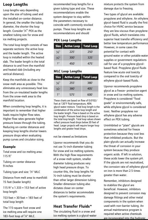

    You need to move a lot of BTUs of cold glycol in a SIM. Uponor suggest 5/8 or larger tube. 1/2 maybe for some stair treads where loop lengths are very short, you need a tight spacing.
    Assuming the bays are covered you are designing more of an ice removal or anti-icing protection system, no real snow load to speak of.
    So the tube and spacing as well as loop length dictates and SWT/ gpm dictates how many BTUs you deliver.
    All the info about SIM design here.
    https://www.uponor.com/getmedia/50a684b6-091d-4044-b8f7-c06f7705668c/snow-and-ice-melting-design-and-installation-manual.pdf?sitename=USA

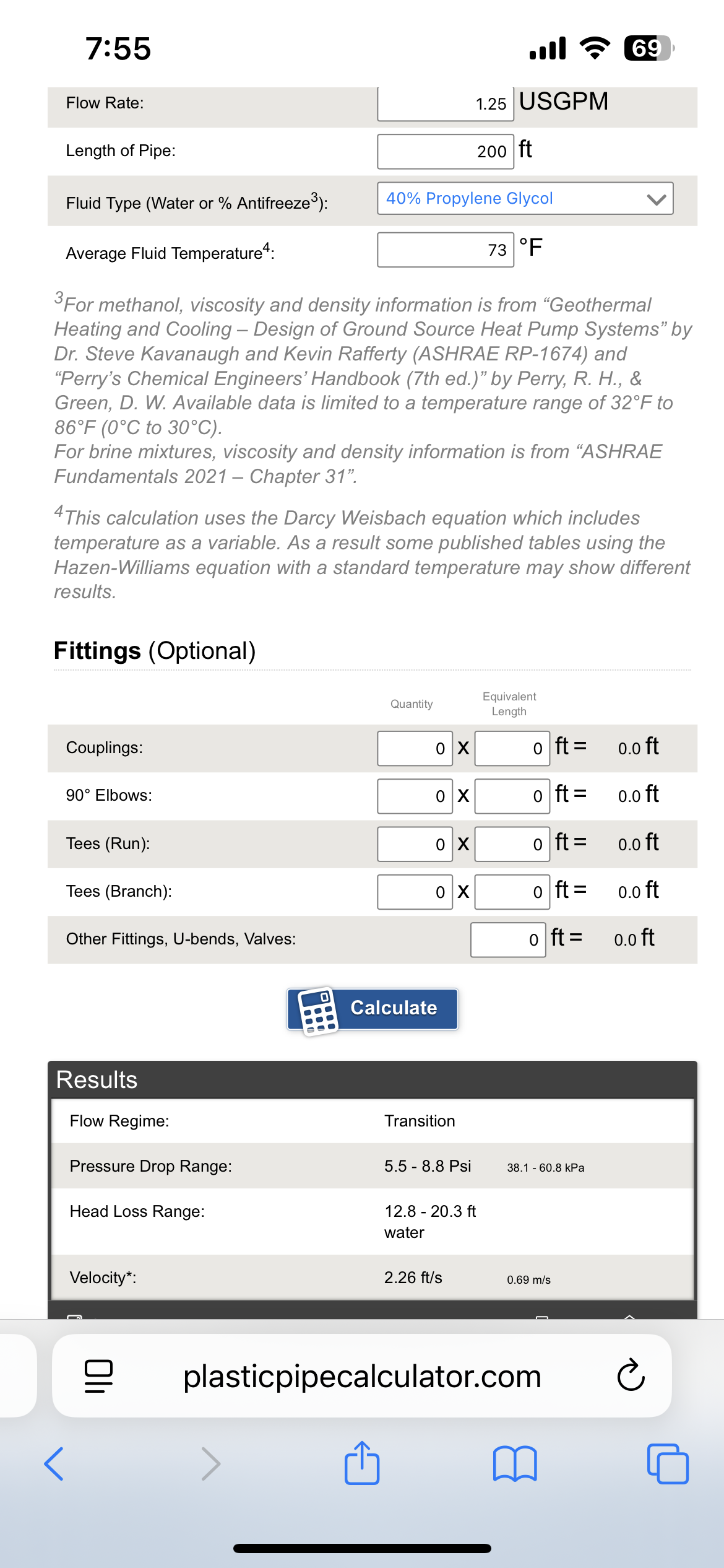

    hot_rod Posts: 28,704
    1.25 gpm, 200’, 1/2” loop with 40% PG around 20’ head
    300’ of 3/4 is about 1/2 that at 2 gpm
    pex manufacturers will do a design for you based on your location and needs

    12- 1/2” loops need 1.6 gpm per loop to move 237K. Agsin using the PPI calculator
    With 40% glycol at 60f, in a 200’ loops that will take an expensive high head circ. This is one reason that SIM generally uses larger tube, minimize the pressure drop that the cold glycol penalizes the flow.
    The pump cost difference alone will offset the tube cost difference.
    The longer loops help with coverage also as you burn up loop length traveling from manifold to bay. A 200’ 1/2” loops will not get you as much coverage you end up with 24 runs clustered at the manifold. The loopCAD will show this congestion
