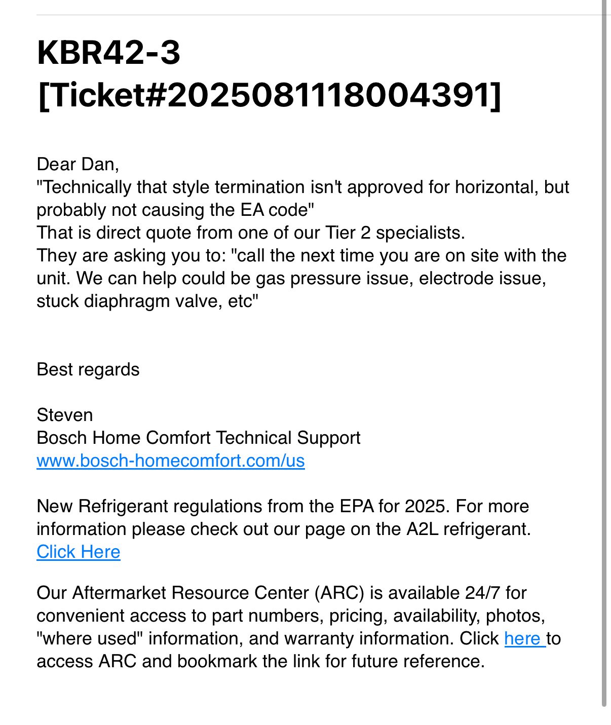

    I spoke with Bosch this morning and after explaining to the rep everything I’ve done - he said I need to get a licensed tech out here with proper tools to diagnose further.

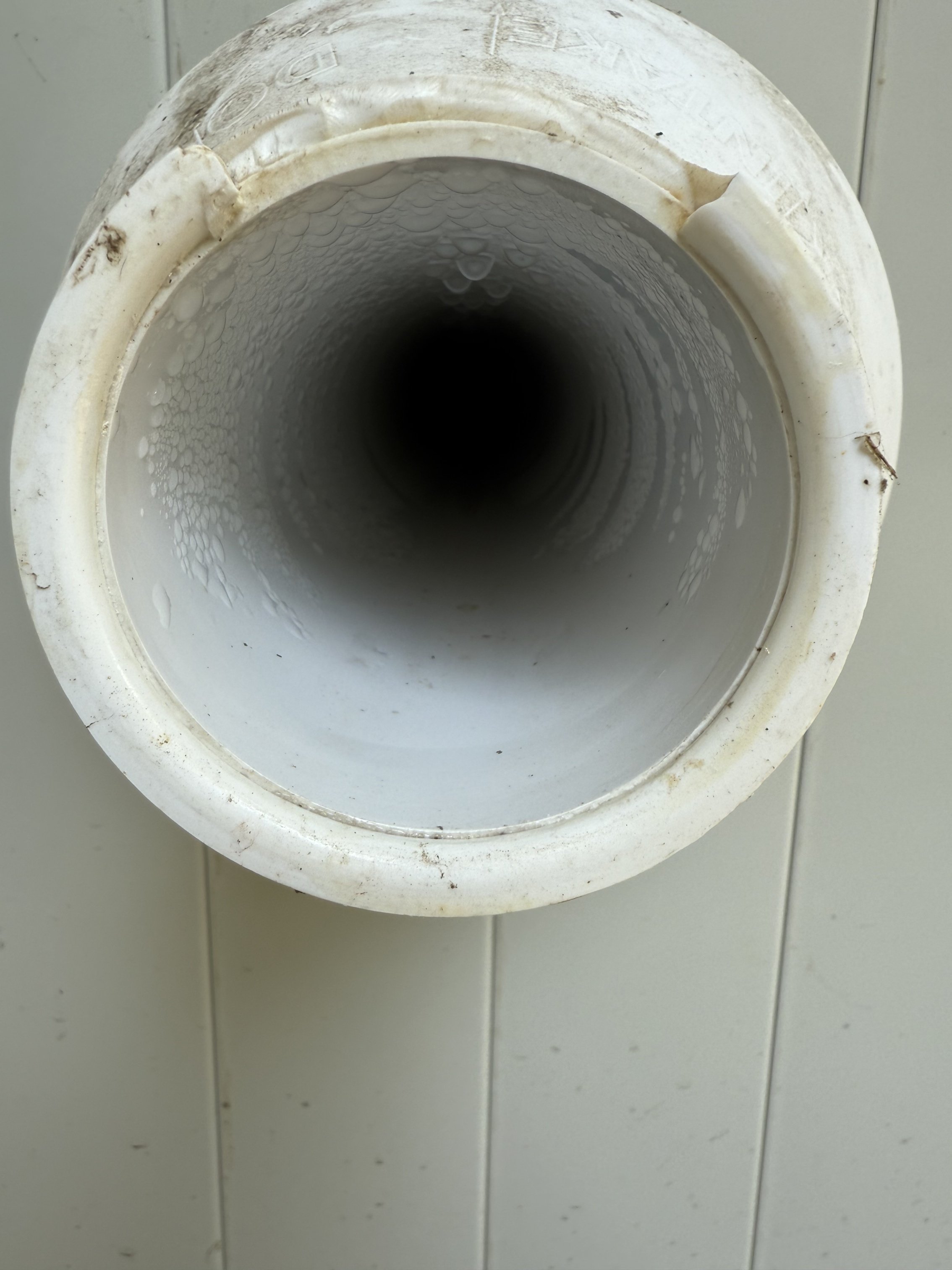

    For curiosity sake take a picture of the outside venting terminations. I am guessing either concentric kit or close piped.
    I would check the diaphragm on the air and get somebody to test the gas valve to check those off your list
  • Sukhoi29SU
    Sukhoi29SU Member Posts: 204
    Thank you; First picture is taken from outside. When boiler is running it seems to be adequate venting, but I guess I could put a snake down there to confirm no clogs…
    Concentric venting - second pic is just before piping exits wall.

    The install manual says not to use that specific concentric vent unless you are going thru the roof.
  • Sukhoi29SU
    @yellowdog thank you , I’ll ask Bosch about this. I agree that it doesn’t show a picture with that used in a horizontal application - I just don’t see anywhere that says it can’t be. The boiler ran for about a year and a half with this venting application with no issues… but it might be something to look into. The guy that I installed the vent with said they use these in horizontal applications often. Going through roof wasn’t an option (I have a garage above this room) and drilling a single hole through the 10” concrete wall was much easier than drilling two.
    appreciate you pointing this out - I’ll ask the reps at Bosch !

    This install is only 1 and a half years old?
    I've found with concentric vent terminations that they tend to have a better chance at recirculating flue gas (when the exhaust gets sucked back into the intake) Even if a manufacturer approves the vent termination it can still happen

    It should be fine, those Concentrics do their job.

    IF the concentric is recircing its own gas, that isn't normal for that type of concentric. Need to figure that one out.
