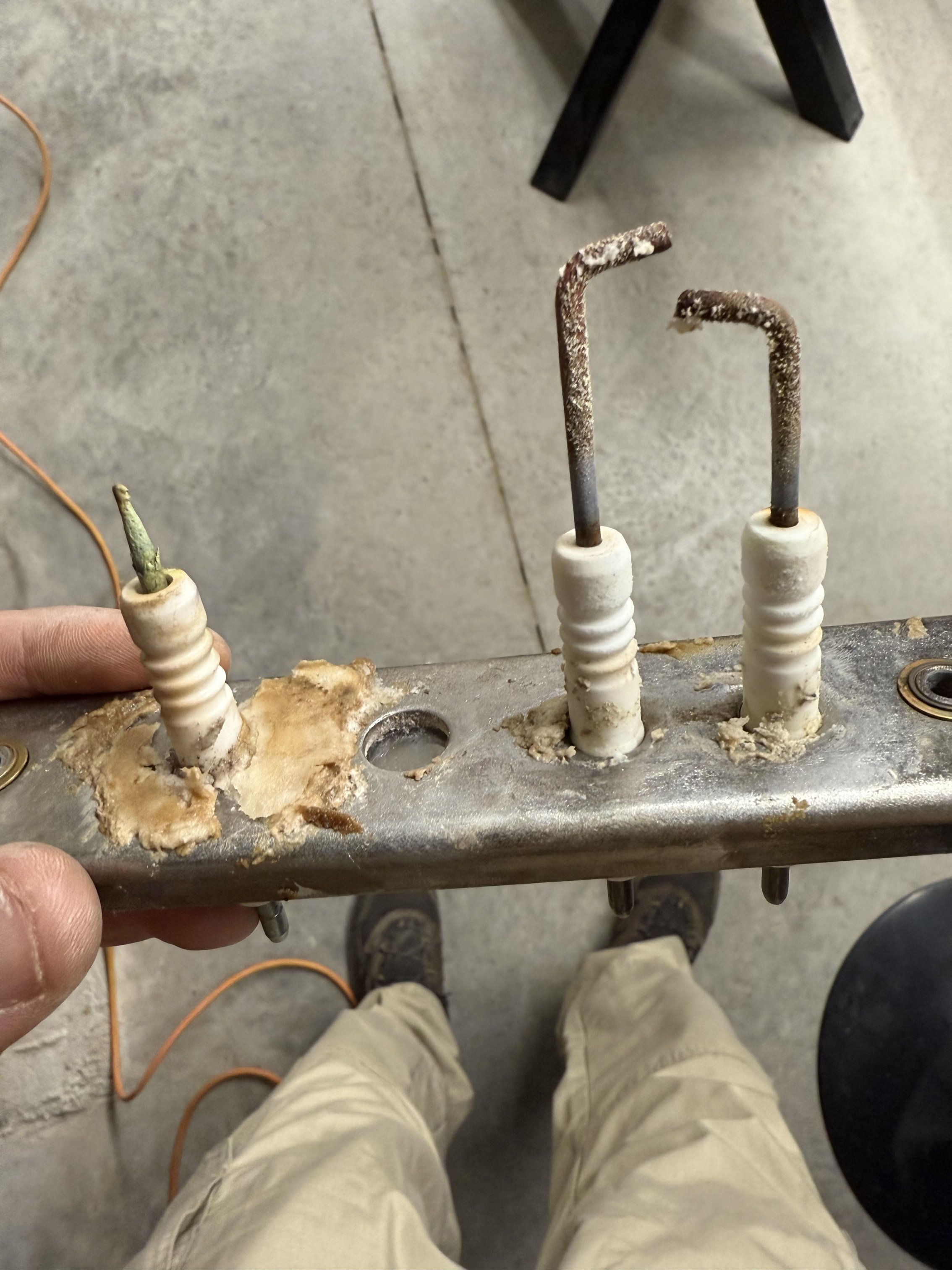

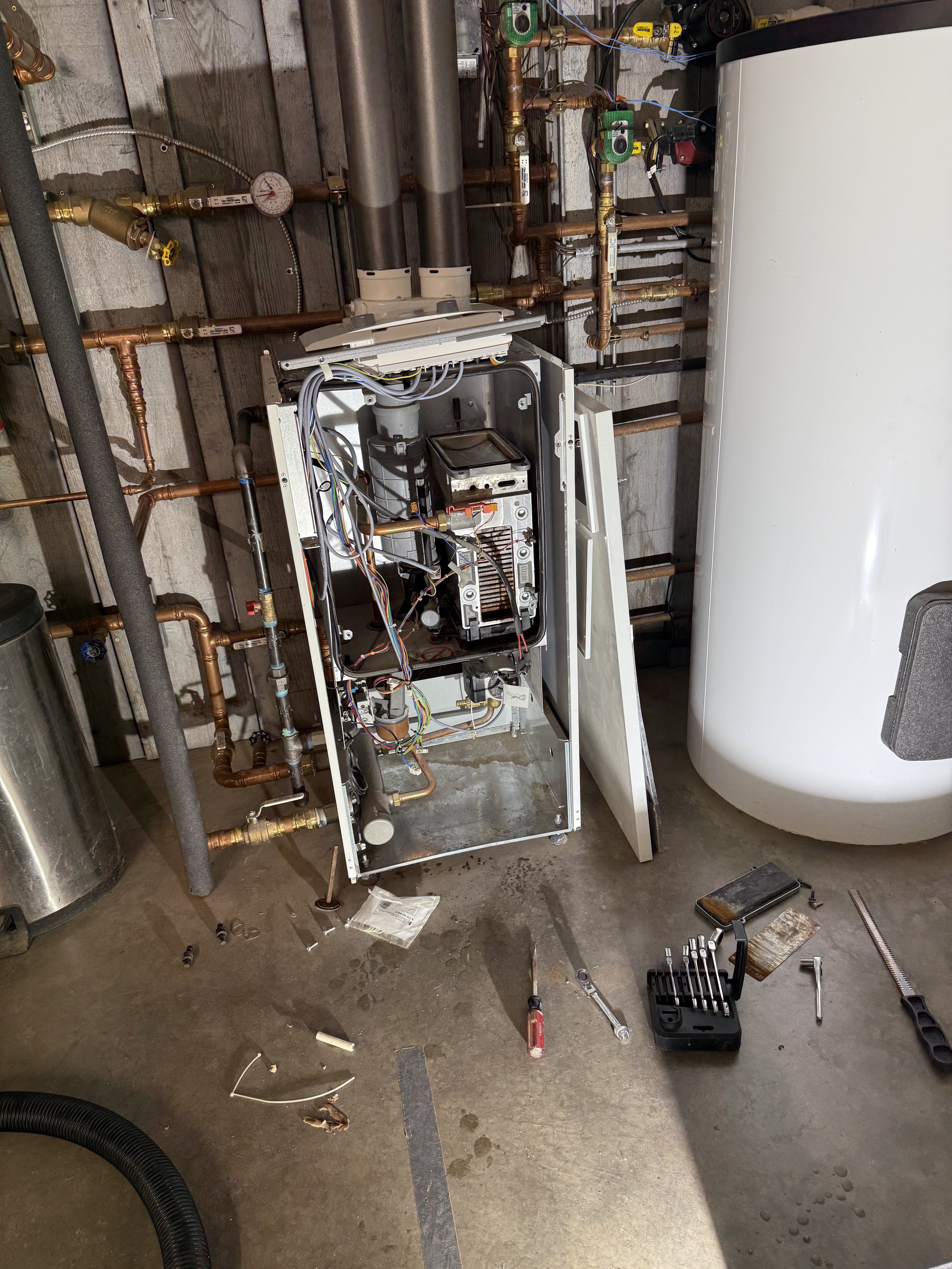

KBR 42 3 Bosch running on propane for radiant heat application and domestic hot water.
Over the past couple months I started to occasionally get the boiler to shut down with an EA error code and a flashing reset light.
Bosch rep wouldn’t give me much info on the phone because I’m not licensed, and finding anyone in the area (north central Illinois) that works on boilers has been a surprising challenge.

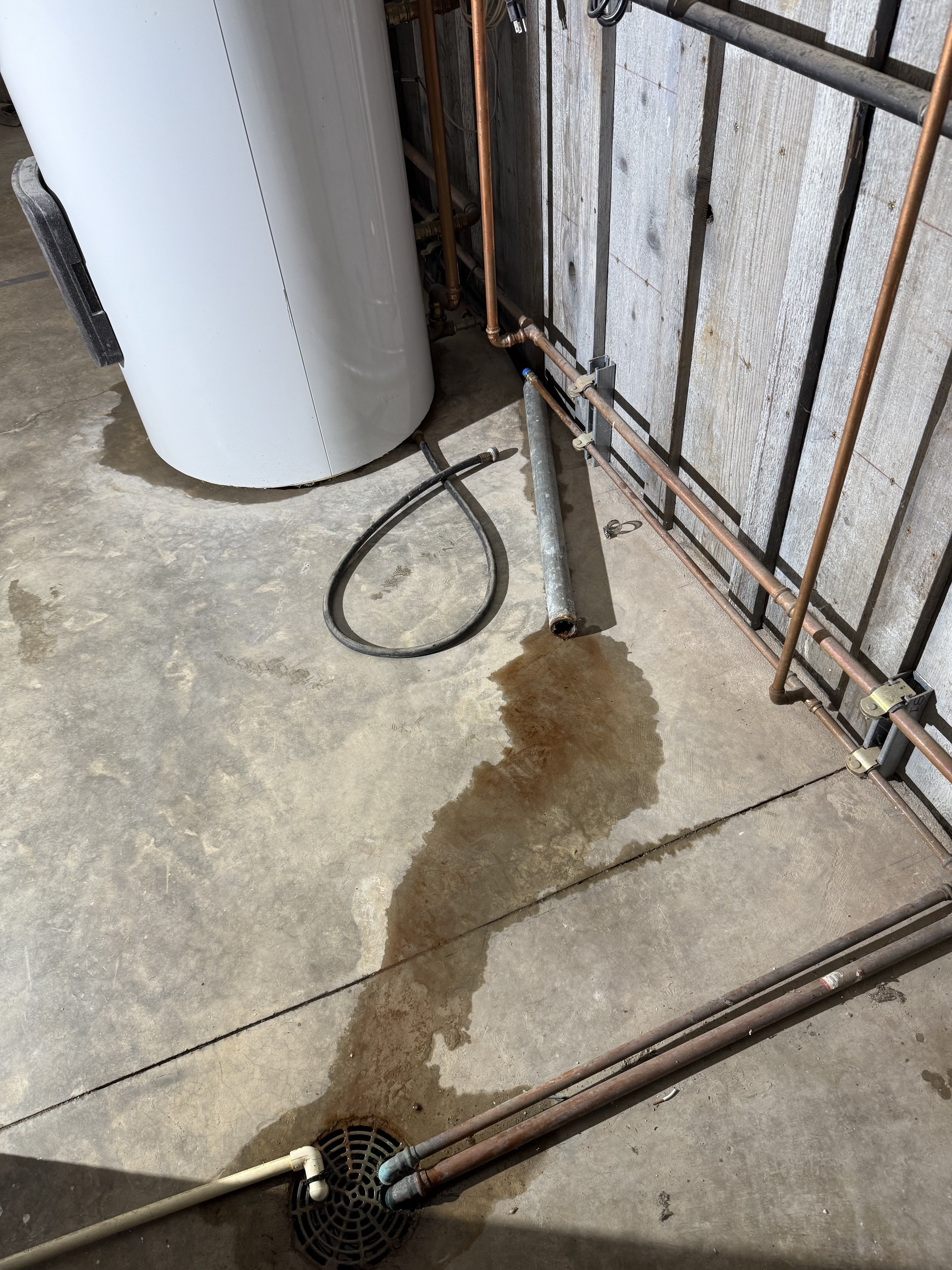

I found that my condensate line which is about 10’ in length and simply drains into my lower garage floor drain (no risk of freezing), had sagged in the middle, making water have to flow a bit uphill before hitting the floor drain. With that fixed, I was still running into the same problem.
I did find one YouTube video on how to clean a Bosch boiler - similar model.

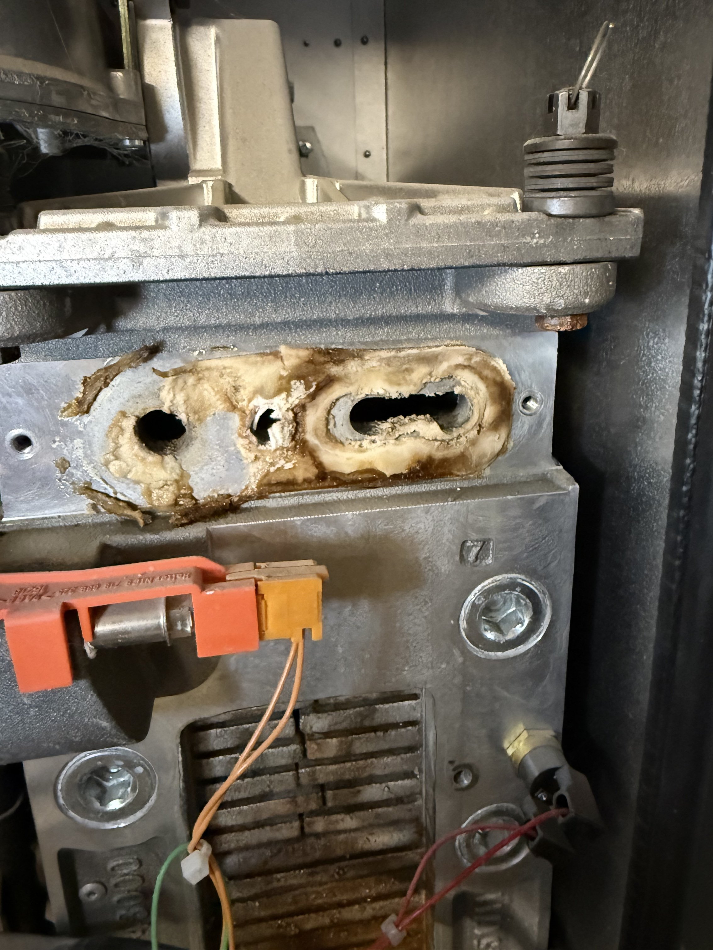

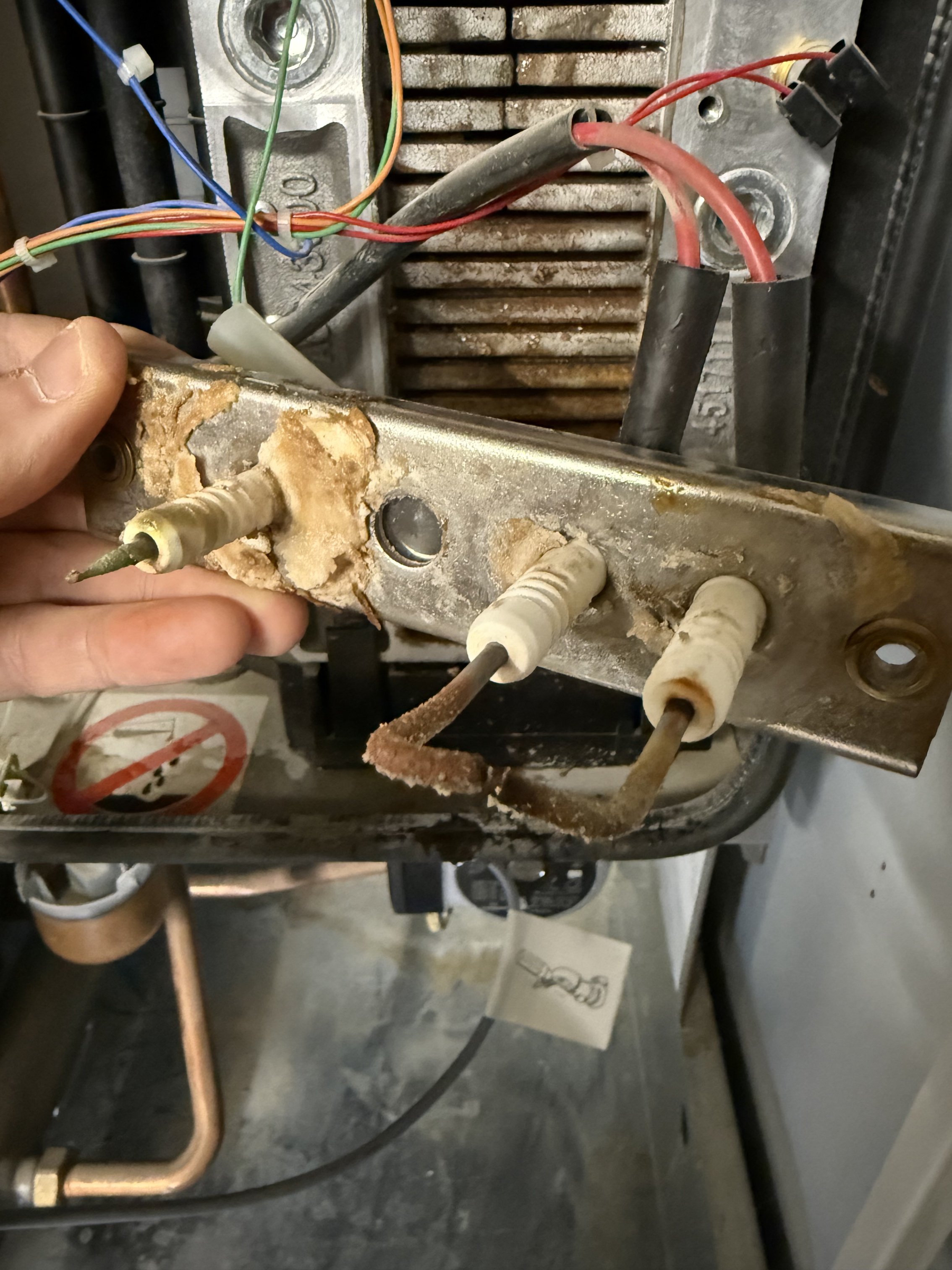

I purchased the Bosch cleaning tool to clean out the heat exchanger and started to take the boiler apart.
The igniters look horrible. I have a new set arriving this afternoon, but mine were in much worse shape than his in the video, so I was able to find a set at supply house.
I’m confident this is the problem and should fix the boiler. Spoke with one guy about an hour away that works on Canadian boilers (not much Bosch) and he said these igniters are advertised to be good for about five years but should be checked every year and if you have the boiler running year round like I do for domestic hot water as well as radiant heat, they will probably need replaced every two years or so.
Mainly posting this for others that run into same issue - I had a tough time finding info on this and it was frustrating I couldn’t get Bosch rep to give me info because I’m not licensed- and I’d probably need to venture into Chicago to find anyone that works on these things.

    it's the first thing that comes up googling that error code, no flame detected on ignition. For any failed ignition on modern condensing boilers the procedure is relatively the same. Clean and check burner/heat exchanger, clean/replace electrodes, check gas supply and combustion analysis to correct any underlying issues. Fouled electrodes are typically a symptom not a cause!.
    Once the new parts are installed and heat exchanger cleaned I would want to set up the burner properly. gas pressure, gas valve adjustment, check for flue recirc etc. those parts will foul up over time, but in my opinion if its happening before the 5 year point I would be looking into why.

    Unfortunately replacing the electrodes did not solve the issue. I’ve managed to get the boiler to fire since then, but sometimes it takes multiple attempts / resets. Results in same error code. Outside of a combustion analysis, is there anything else I should check outside of your aforementioned?
    I plan to call Bosch again in the morning and let them know what I’ve accomplished thus far and see if the next guy might be a little more willing to provide some potential solutions.

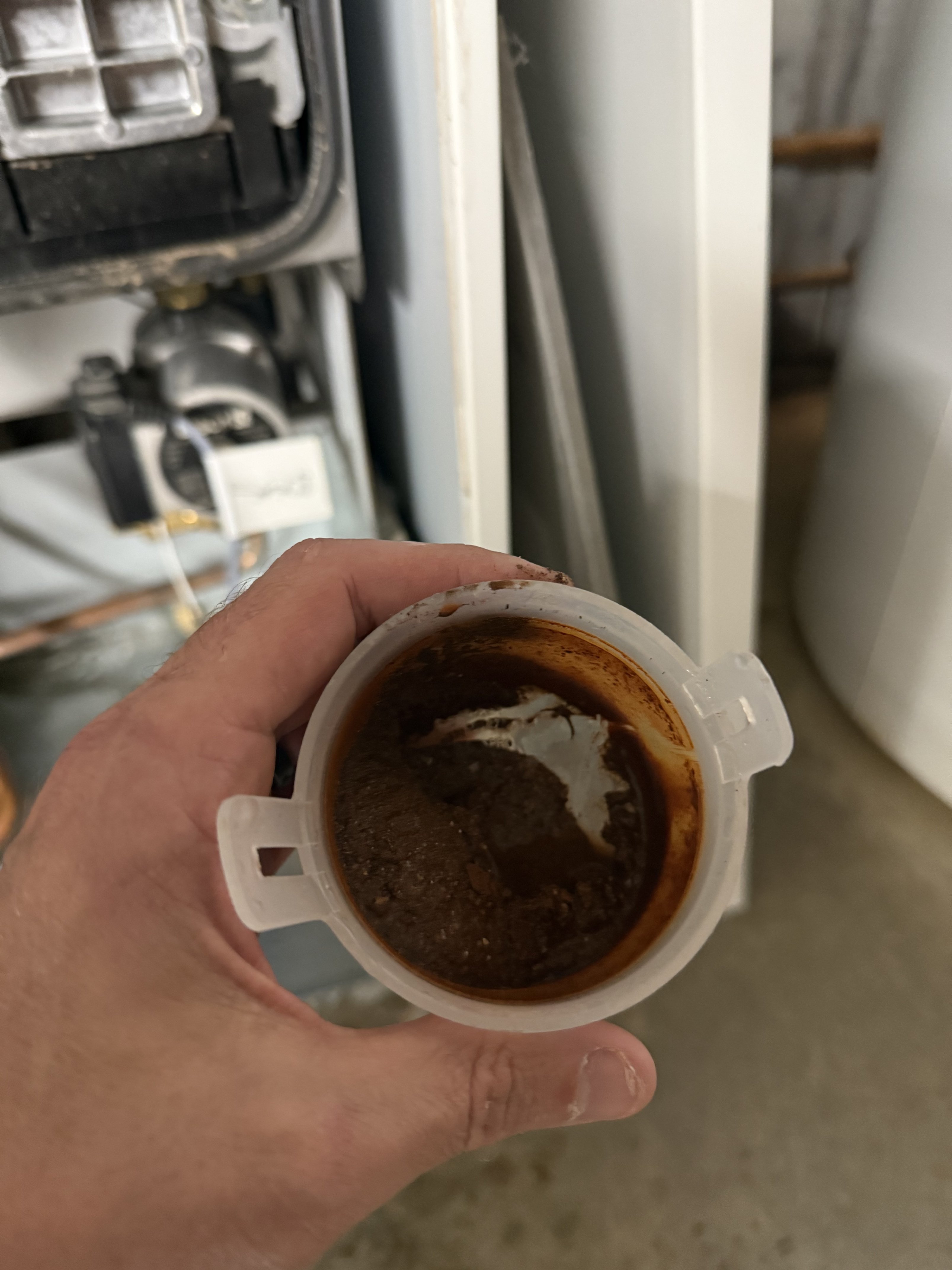

    • Edit : Condensate trap looked pretty bad. Sludge at bottom. Wasn’t in video but as directed in manual I cleaned it out. Tomorrow I will put vinegar solution through entire line - I think the copper pipe that the condensate line ties into might be blocked

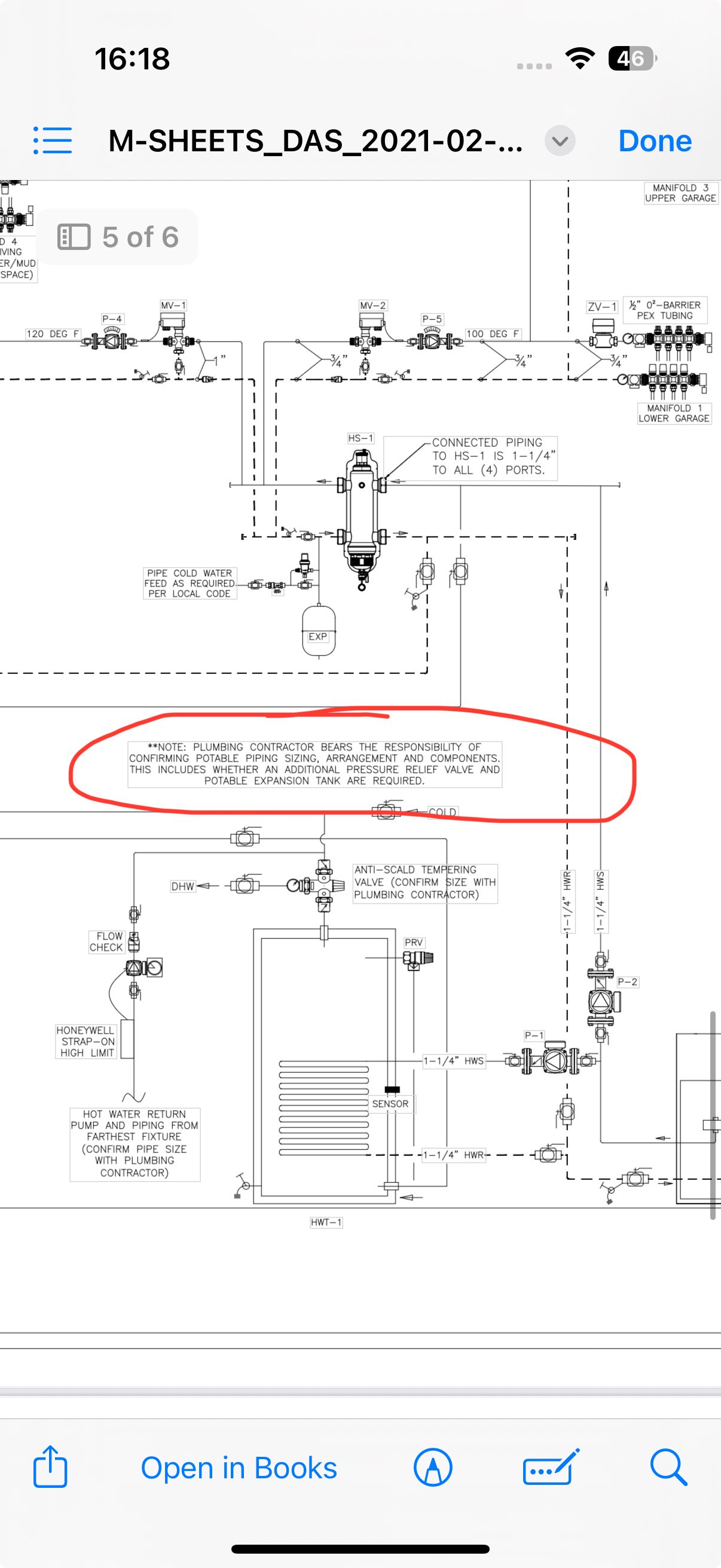

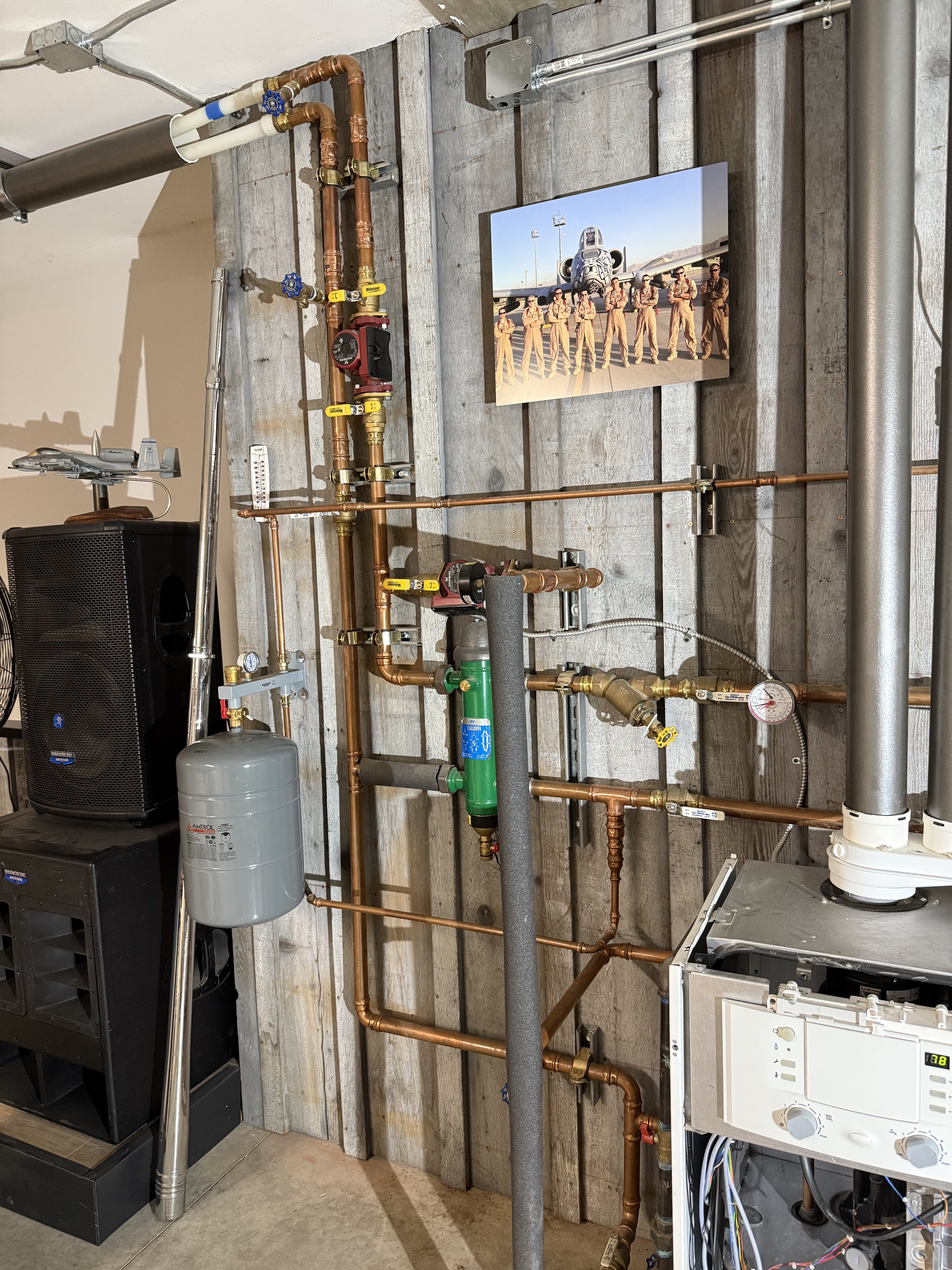

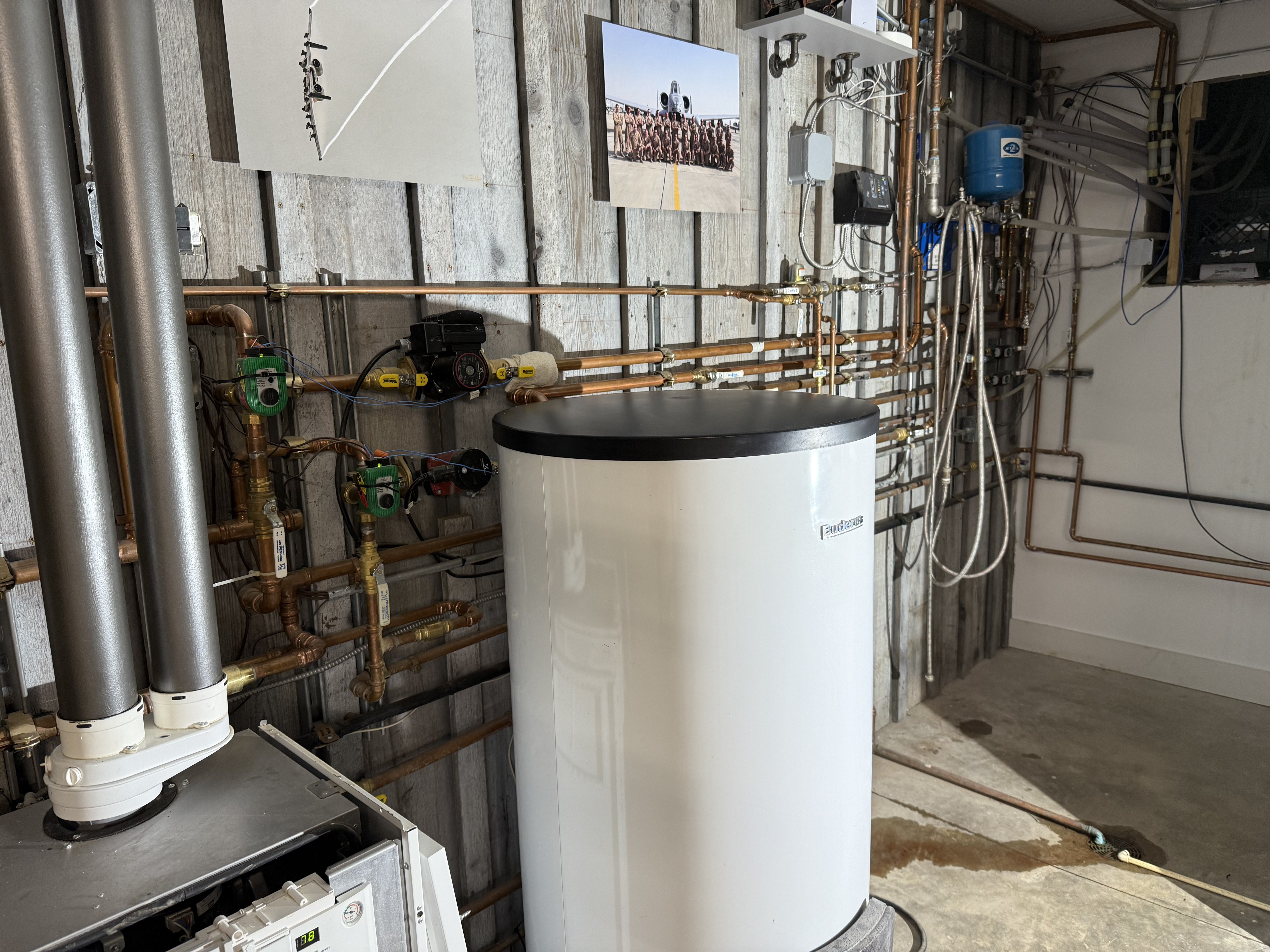

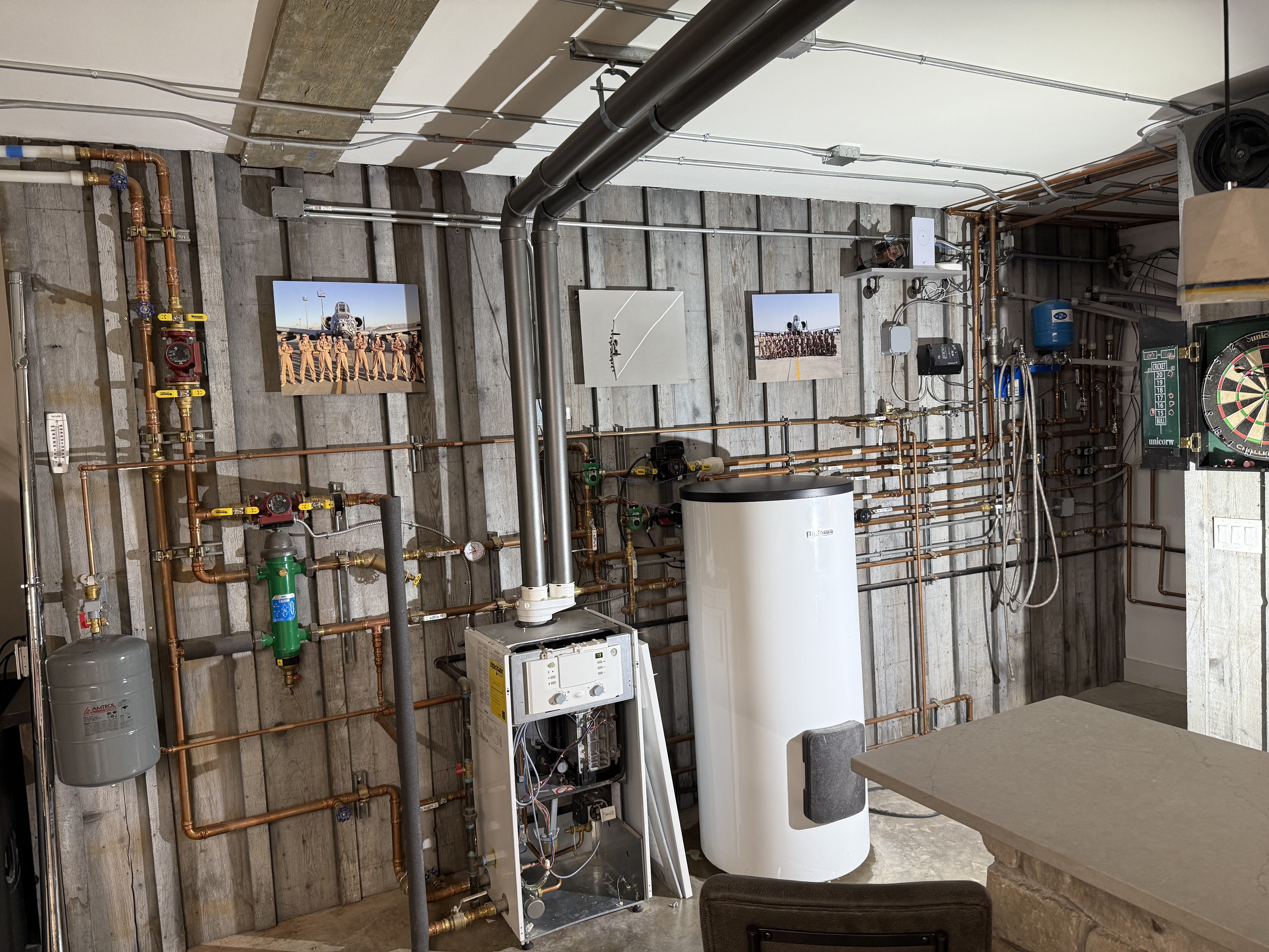

    IMG_3105.jpeg IMG_3106.jpeg IMG_3107.jpeg IMG_3109.jpeg IMG_3111.jpeg IMG_3113.jpeg IMG_3114.jpeg IMG_3115.jpeg IMG_3102.jpeg IMG_3110.jpeg
    @GGross
    I spoke with Bosch this morning and after explaining to the rep everything I’ve done - he said I need to get a licensed tech out here with proper tools to diagnose further.
    Water quality has been a problem since the first installers opened this system to a well with a brand new pump that introduced unfiltered water with debris from the bottom of the well into new components.
    One thing I plan to talk to the reps about tomorrow is getting the system flushed , cleaned , filled with filtered water and brought to correct ph with inhibitor. The amount of sludge in the boiler’s condensate trap is concerning.
    I cut the condensate line from the 1/2” copper and put temporarily into steel pipe so there’s no chance for restriction.
    When the boiler was fired up I went outside to make sure it is venting properly. Doesn’t appear to be any issues there, it seemed to be venting fine.

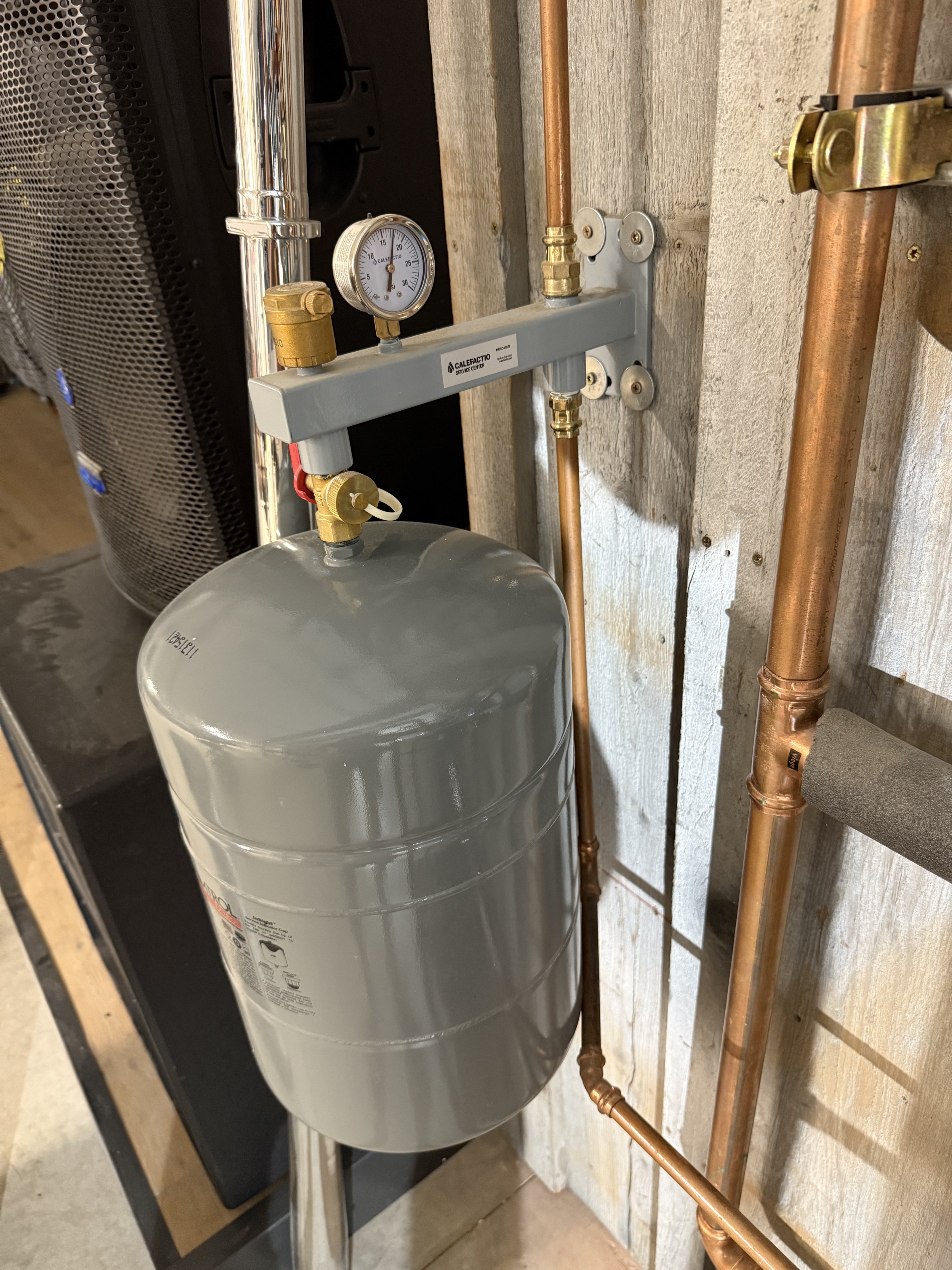

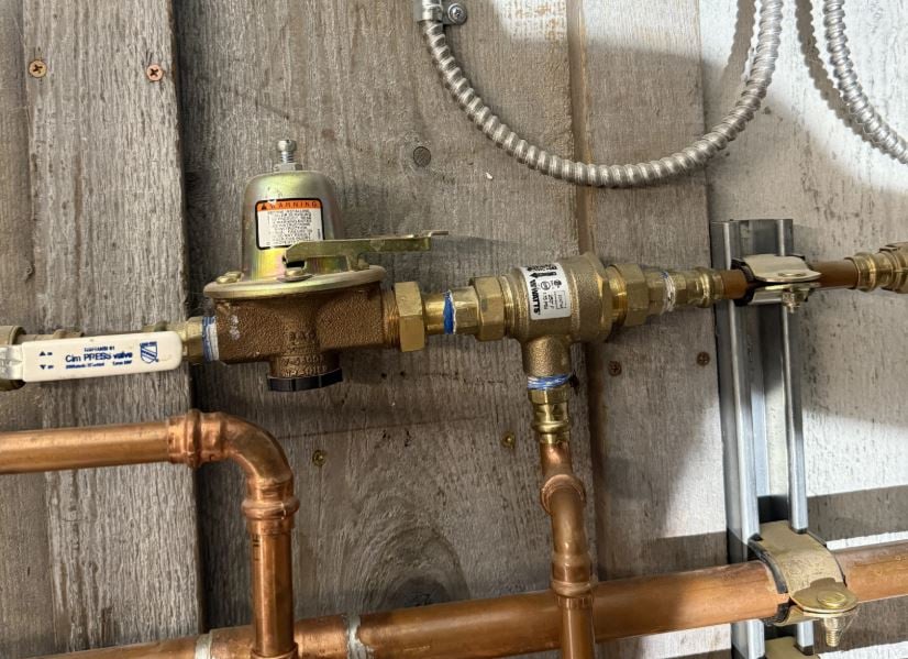

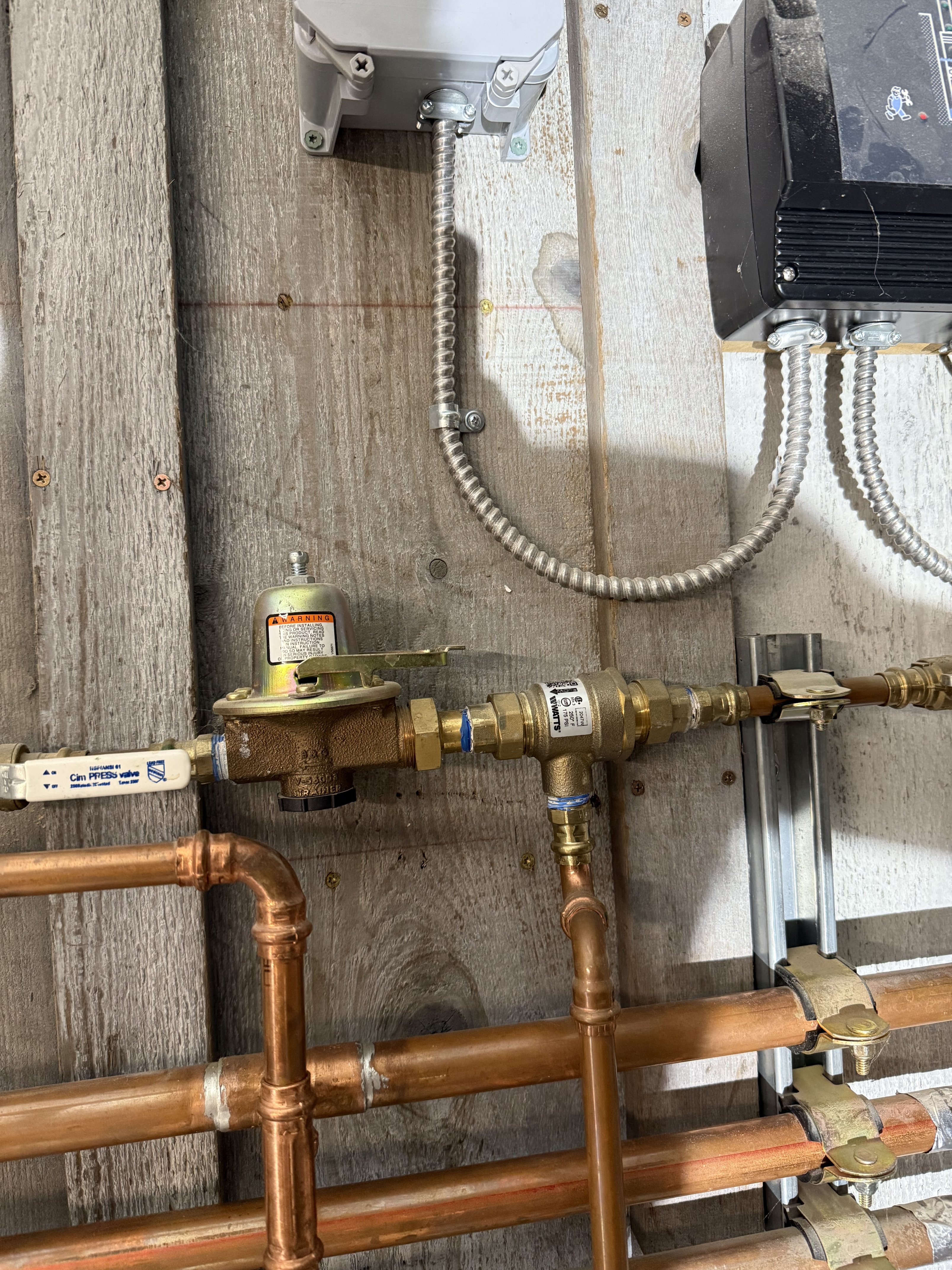

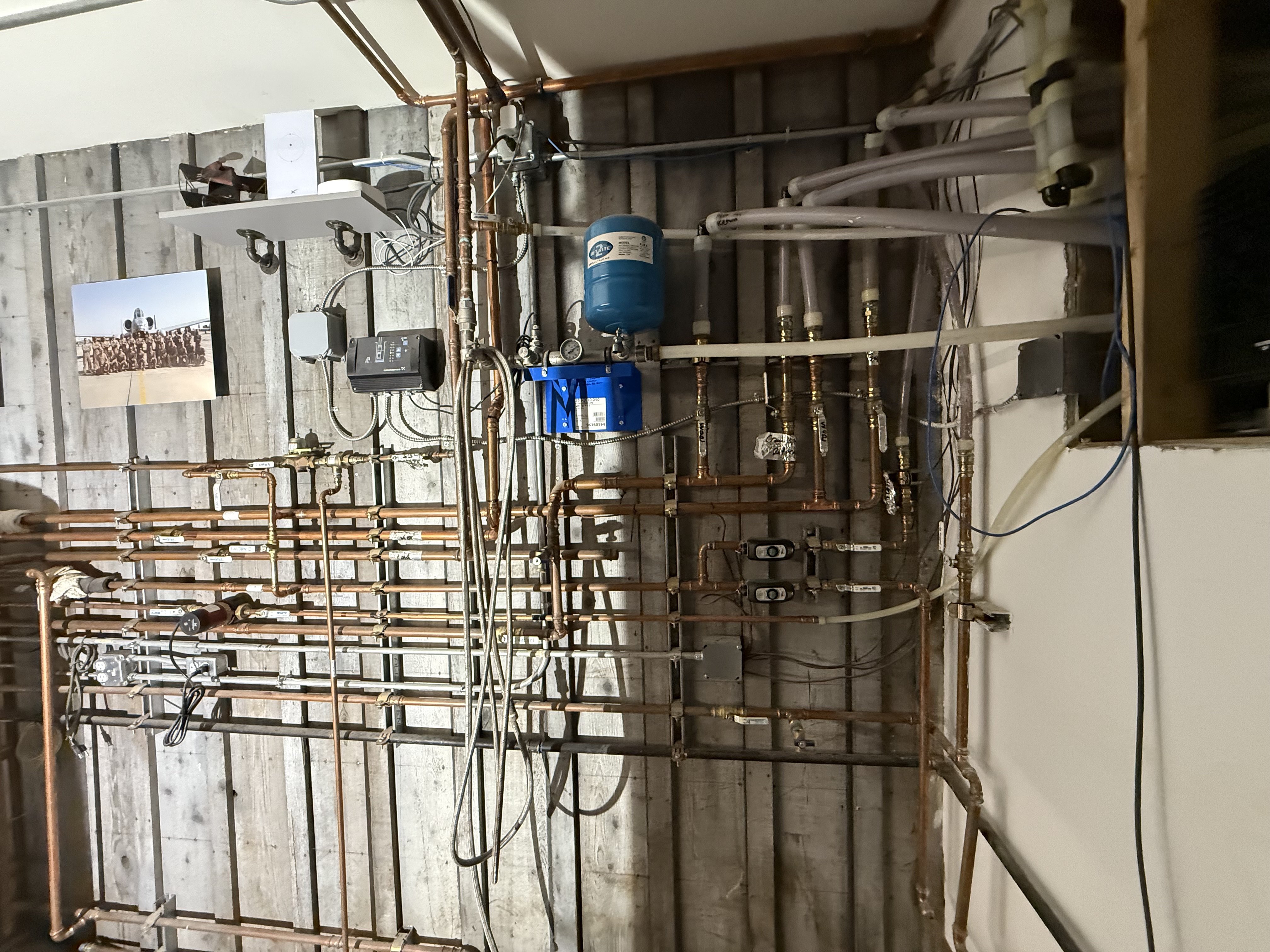

    I attached the plans and some pictures of the full system (minus the manifolds). The water comes in from the well through a constant pressure system set at 70psi. There is a 100psi pressure relief valve and I’ve been down here a couple times when for some reason that pressure is high and that valve opens up and dumps water into the floor, right near the drain.
    The water goes through that cap looking thing (pardon my ignorance) which restricts / reduces the pressure, and passes by the expansion tank, through the caleffi hydro sep and then into the boiler. After closing some of the valves to the floors manually, I did witness the boiler operating in the red around 40psi , though. I noticed in the design that the designer said its onus on the installer to determine whether another relief valve is necessary.
    I wish I had a few more tools and more knowledge. This definitely isn’t my trade, but I am learning.
    hopefully these guys that show up tomorrow know what they’re doing and I’ll definitely be providing them with the advice you’ve laid out here. Thanks again!
  • GGross
    GGross Posts: 2,104
    edited August 2025
    You have the right idea here. The safeties are piped and thats the important part!
    The system is piped a little funny, that big green device with 4 ports on it is a caleffi hydraulic separator, your boiler has a simplified version of this inside the bottom of the cabinet. so you kind of have a primary/secondary/tertiary piped system, not really necessary. If the system works as intended other than the ignition issues I would leave that as is, it will make any future changeout easier if the contractor has the caleffi separator there.
    you do have a fill valve on the system in your photo, and it is open. This would be the standard "set it and forget it" approach so the boiler doesn't go off on a low water fault. Personally I like to close them to be able to control the makeup water a system is getting. One thing I might recommend, if there are leaks in the system and you can't find them. You can hook up a controlled filling station to that fill line, so rather than just putting new well water with new minerals to destroy the system to replace the leaking fluid, you can use a controlled demineralized fluid as makeup water. Depending on how bad the leaks are you may need to service the filling unit regularly. always best practice to fix leaks. I would bet the sludge you see is a result of the makeup water, I would have a contractor check to make sure the heat exchanger on the boiler is not leaking, it seems like a very possible culprit here.

    yes sir, the designer had a reason for utilizing both the boiler low loss header as well as the caleffi hyd separator but I can’t recall what he said, now.
    The system will eventually be hooked up to a wood gasification boiler as primary heat source and the propane boiler as a secondary, that might be the reason…

    2 years is a very short amount of time for a boiler. Look at those pics you posted, you are having these ignition issues after only 2 years. Thats typically when a boiler gets serviced for the first time with no failures. Issues with poor combustion, recirc, water quality etc take time to manifest. usually a couple of years. I would not write off anything at this point, 2 years and it looks like THAT in the heat exchanger tells me that a whole lot of problems have existed since install. I'm still more concerned that there may be a heat exchanger issue given it looks awfully wet in the fire side.
    to be clear flue recirc is NOT going to cause an immediate failure, It will slowly destroy everything the flue gas comes into contact with. you would need to sample the intake air with a meter, or look at tell tale signs in the cabinet, the venturi etc to confirm this is happening. wind load in the exhaust can cause issues, and can cause more flue gas recirc.
    Poor water quality and too much makeup water will kill your heat exchanger, but it will NOT happen immediately. The amount of time this takes depends on several factors. How hard the makeup water is, the exact chemistry of the boiler fluid, how much makeup water is going in, and even flow rates and supply temp can affect this.
    Poor combustion will destroy igniters, door seals, plug the fire side of your heat exchanger etc. it will NOT immediately shut down your boiler
    all of these issues need to be looked at, a boiler firing and doing its job on install is not indicative of there being no problems. The majority of boiler issues take a couple years to do their damage. That's where you are now.
