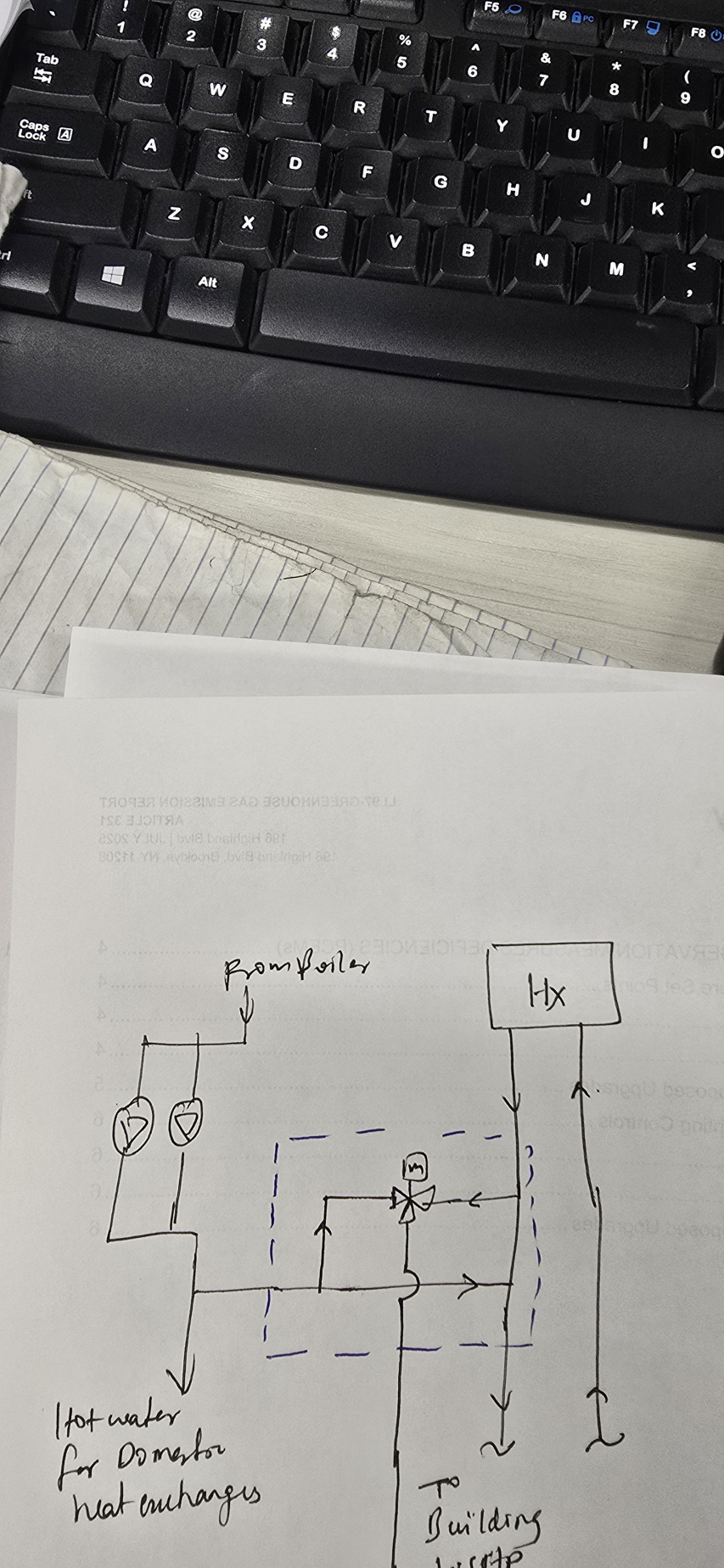

Hello, I am working on a project which has Water Source Heat Pump (WSHP) as their main system. The building has boiler for heat injection into the WSHP system and for domestic purposes. The building also has cooling tower for heat rejection for the WSHP system. I came across this piping arrangement shown in the picture below highlighted in the dotted box. It shows water going in (called heat injection incorrectly) upstream of the water going out.
Is this piping arrangement correct? I always thought that the water should come out before going in to maintain the hydraulic continuity and also it doesn't make sense to inject heating before going out.
Please let me know if this correct? Thank you.

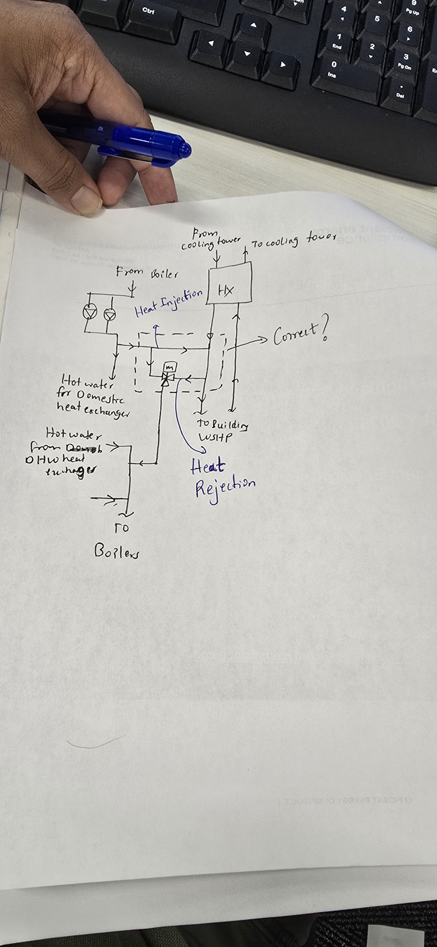

    Suchitapage Member Posts: 26
    Hi,
    Just to clarify, I am talking about the piping arrangement in the dotted box. I have pasted another piping arrangement which I think should be the right way (in the dotted box). Can anyone let me know which one is the more efficient and correct arrangement?
    Thank you.

    EBEBRATT-Ed Member Posts: 20,397
    IMHO neither drawing is correct
    I will say it again. if you making DHW with the boiler it will have to be a minimum of 140 deg to make domestic HW probably higher.
    You can't put 140 into the heat pump loop with a diverting valve. Every heat pump will trip out on the refrigeration pressure controls if you try that.
    You need to come out of the boiler supply and go to the DHW HX. A tee in that line will feed the heat pump loop through the diverting valve (if you keep that). Before it gets to the diverting valve the boiler supply needs to be mixed down to 90 degrees etc with a 3 way mixing valve.
    SEE THE ATTACHED
    You don't need the Diverting valve . You need a 3 way mixing valve to control the boiler water temp so you don't send 140 (or higher) into the HP loop.
    You don't separate the boiler from the tower wit the diverting valve. The same water flows though the boiler and water tower (or hx) and the heat pumps. The controls sense the loop temp and then tell the boiler to add heat or tell the tower to reject heat.
    The Trane drawing has no mixing valve because they are not making DHW off the boiler and there is no diverting valve
